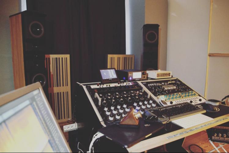

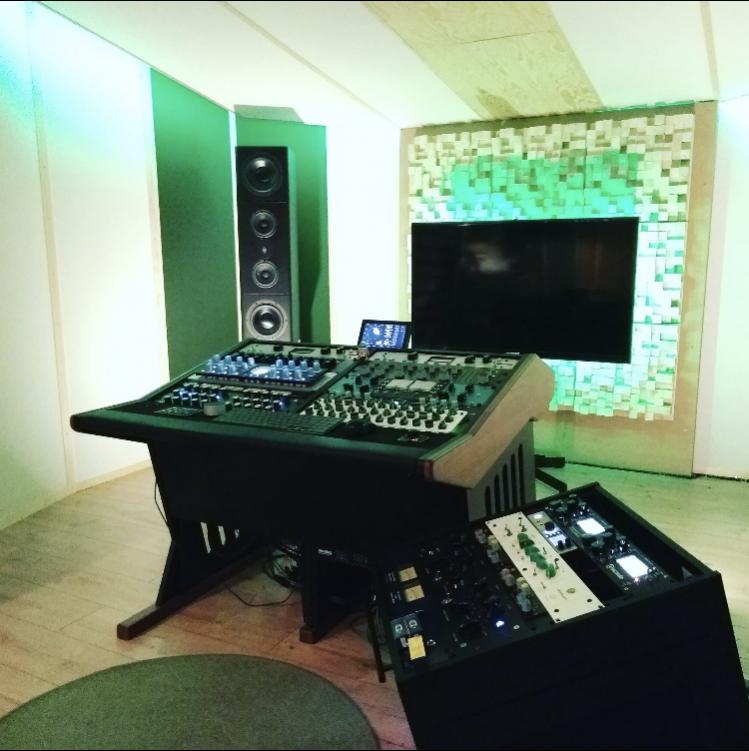

Given the amount of costly hardware i wouldn't qualify them as home studio ( the last photo especially, gml, spl, dangerous music, probably a Crockwood console... yummy) .
The room are tiny but this is the trend for the last 10 years.

These are pictures submitted from Mastering Engineers, with no specification what they were mastering.

so far it looks like two pictures of post prodution A/V control/editing suites but not music studios...?
Those are typical mastering studio of the moment. Check the gear, those are typical units, Manley, Gml, Neve limiters,Elysia, Cranesong, Adl,...no Weiss unit nor M6000 though, i'm disapointed... all on two tracks. Focusrite seems to have disapear from racks as well as Millenia. Not much of R.Neve portico too...
Amphyon loudspeakers... you could see B&W. Really typical rooms since 10years. There is trends within mastering and those pictures are the one of the moment. Visually they all looks like Thomas JouanJouan's design of ten years ago but most doesn't have the distinctive points of his acoustic treatments *( he used CID to create RFZ. His latest design use inwall ATC. A guy i know got his room like that 2 or 3 years ago in Paris. I haven't heard it though. Must sound good).
Camplo this is a bit provocative no? I mean there is a lot to learn from everyone.
* maybe the last one is with the diffuser on front wall.

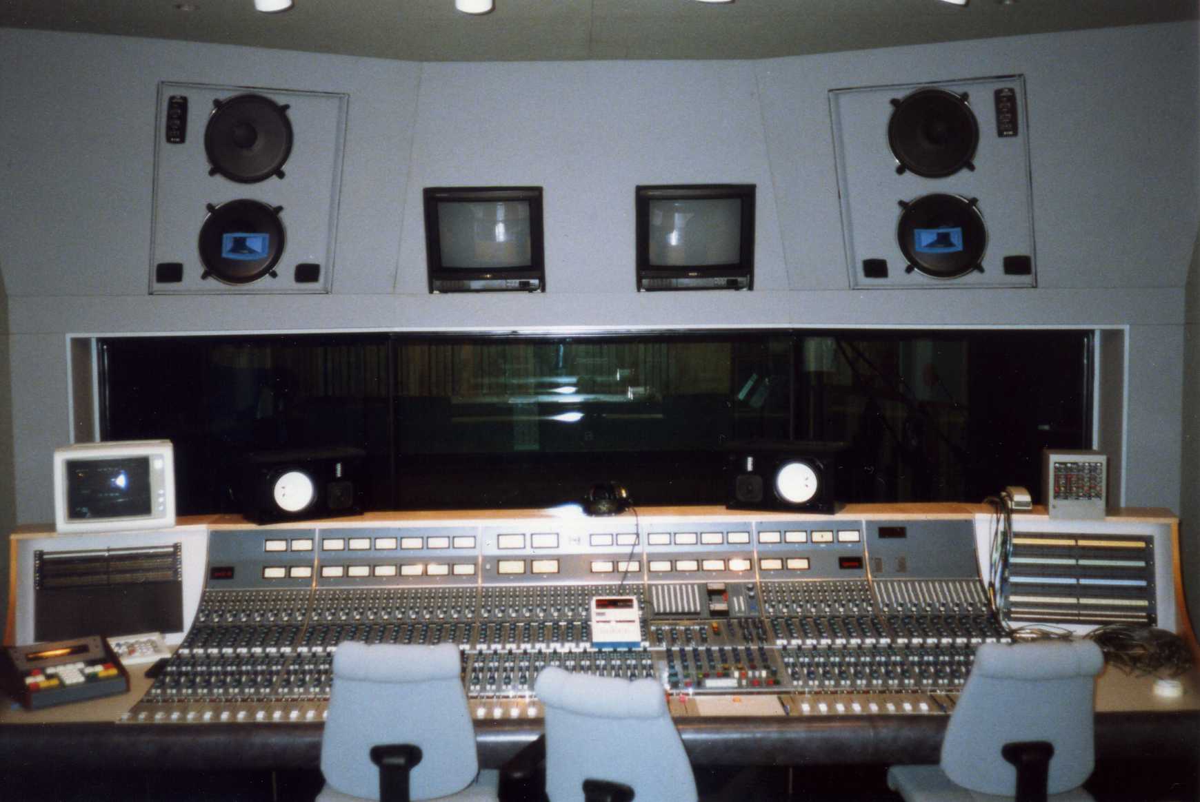

Anecdotal note: I worked ten years sitting in the recording/mixing (and sometimes mastering) chair at a variety of studios many years ago. I was lucky to be involved in the ground up build of two Chip's Davis designed LEDE control rooms:
attachment.php
These are specially designed rooms and were ground breaking at the time. The room is designed so that you heard the direct sound of the mic plus early reflections (i.e. coloration) in the studio room "before" you heard the sound of the mixing room.
While there are many design properties worth reading and discussing about LEDE, one property is the concept of a room within a room to deal with standing waves below Schroeder. The idea is below Schroeder, the waves would pass through the inner shell and based on geometry are reflected and trapped by the outer shell and would not reenter the inner shell.
I spent quite a bit of time in that room and it's bass response off the big JBL'a-fied UREI time aligns was tight and smooth with no external eq. However, the diffraction and HF beaming were awful for a studio monitor.
In most other control rooms, the large format control room monitors were almost always eq'd to EBU 3276 or equiv ITU standards. The idea is for translation, not only during mixing, but also tracking or mastering. So in the middle of a recording session, you pack up your tapes and head off to another studio. Feeding the mix back into another console with your settings, should sound similar over the in house calibrated monitors. And in most cases, it did reasonably well, especially the LEDE rooms had not only the best room to room consistency, but also produced the best mixes and translation.
The big variability is that below Schroeder the room is in control of the low frequency response response, not the loudspeakers. I wrote an article on it.
Because most folks could not afford LEDE studios or equiv, or how to properly deal with room resonances, folks started putting small monitors on the mixing bridge. First is was to mimic a car radio (e.g. Auratones) and then because of the bass issues, near field monitoring was born.
I have used countless "bridge" monitors from NS10 to JBL's to Hifi speakers to you name it. There are many Pro monitors like Genelec and others that are designed for accuracy both in the frequency and time domains. All using the latest design, engineering, manufacturing tools and DSP tech to produce the ideal on and off axis frequency response, smoothest directivity, extended frequency response, all within a tight tolerance. Just like the specs call for in the ITU and EBU standards, but even better.
Most audio engineers I know have their own preferences to which monitoring solution they like. I was (and still am) a JBL fan boy. Some like a more refined sound like a KEF or Tannoy or one of the zillion monitors available today. Heck on Sweetwater there are 209 active monitors from 25 manufacturers.
My viewpoint is not from a loudspeaker designer, but from an audio engineering perspective of whatever loudspeaker will give me the highest quality recordings, the best mixes and best possible translation to the widest possible range of playback systems. The studio industry guidelines calls out speaker specs to be met with respect to frequency response, directivity, distortion, transient response, etc.
Of course, it is all the things we already know, smooth on and off axis frequency response, extended frequency response, low distortion at monitoring level SPL, etc. It is simply really hard to do as we can see in some independent testing of loudspeakers against a modern standard. And this is not taking the room into consideration...

Mitchba: it was a Neve? I don't recognize the model ( but flying faders!).

I see none of that in the rooms you show, I see cosmetic room treatment, a huge reflective surface in front of the speakers I see no ultimate listening environment. Why is that? Because the desk has to be there to work and most are aiming to listen in a room that is somewhat representative of where the work will be heard by consumers. Probably why you see auratones on the desk too.
