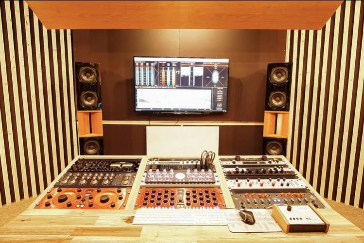

in thinking about it some of these pic's of mastering studios they only appear to have one pair of monitors, so how do these guys expect to develop a product that should sound good on various playback media and devices when there seems to be nothing else available for that purpose?

Hi Turk,
This comes to habits of this particular field. It could be resumed to ' as close to perfect is my monitors and because i know them ( and my room) i am able to make quality assesment with them and the correction the source signal needed'.
An other point suggested by B.Katz is that multiple loudspeakers may induce your client in 'error' as he doesn't know the difference between them.
All this can be argued upon, but this is the habit...
That said once done ( the mastering) serious engineer ask the client to listen results on his/her own equipment ( hifi, car, whatever,...) to agree on choices made. And they keep everything recallable to change things.
One of the guy i worked with had a mini hifi chain ( Consumer hifi with tiny speakers Sony or Jvc or Samsung) which always had loudness on and was set to a defined level on which he validate his work...always. He called them 'le juge de paix'.
There are very good plugins that can simulate cheap earbuds, car environment, radio station compression etc.
If the studio setup is good, you can simulate bad environments / equipment.
If it's bad, you can't simulate a good environment 🙂
