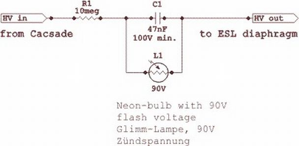

In case circuit diagrams make more sense than words to you, the links below might be useful.
Neon bulb circuit and brief description on how/why the neon bulb flashes -
http://www.diyaudio.com/forums/planars-exotics/76222-esl-build-thread-12.html#post952272
Neon bulb circuit as implemented in Quad ESL63 and trouble shooting hints -
http://www.diyaudio.com/forums/planars-exotics/153773-esl-technical-questions.html#post1958015

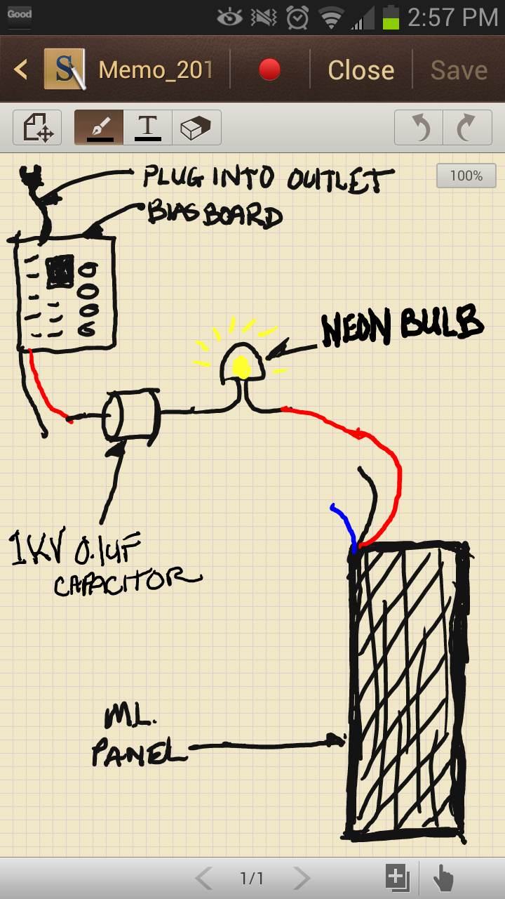

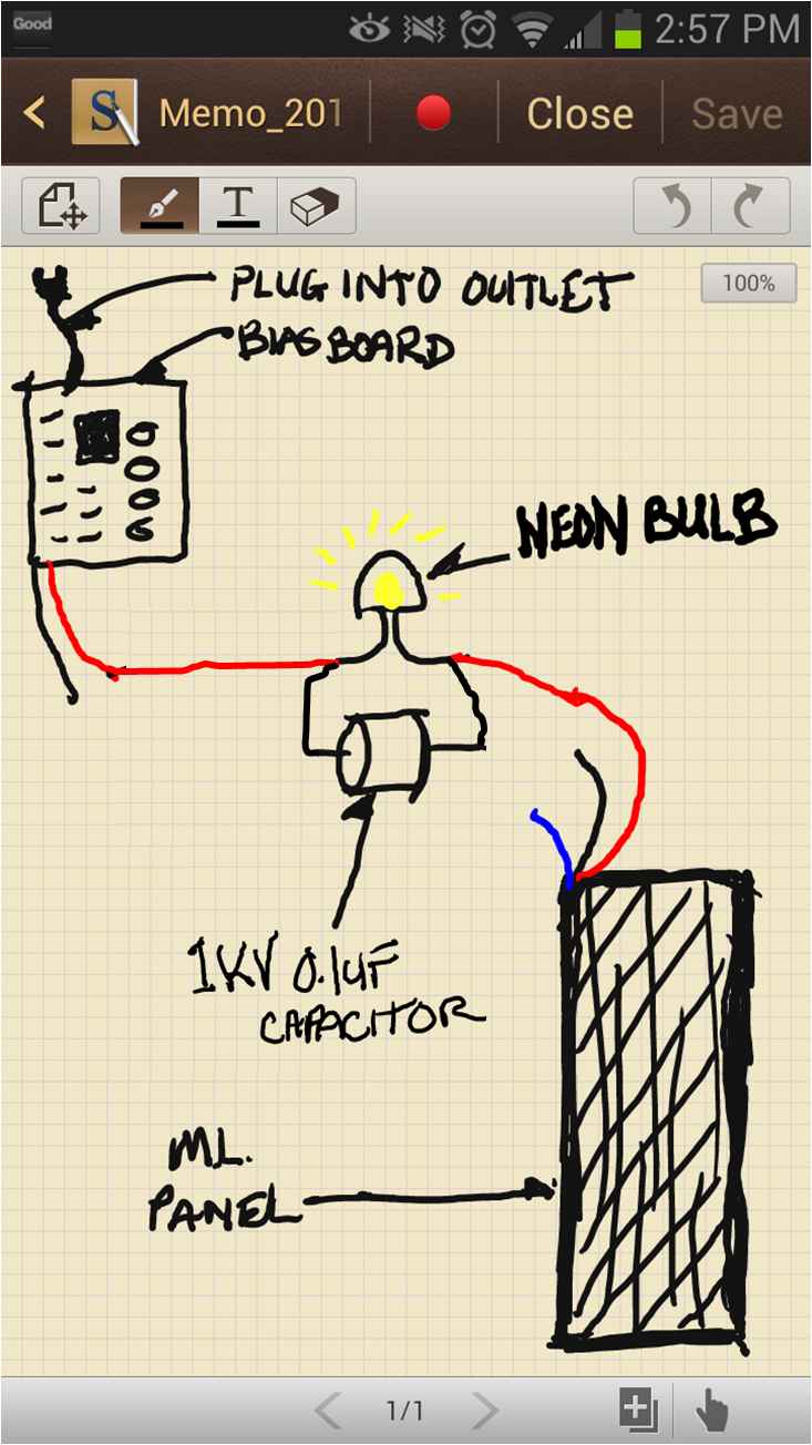

What do you mean when you say "in parallel and in series" in the above statement? I understand the terms but not as they relate to the bias boards leads and panel leads. I drew a very basic diagram and I will try to attach it if I can figure out how. ...even so, it sounds like I only need the red wires from the board and the panels...what happens to the black wires and the blue from the panel in you test described in previous comments. I really need this explained without electrical engineering terminology for me to understand. I'm sure that this will not impress anyone but it will really help me. [image][/image]
Here is my basic drawing. ...please let me know what I'm missing. Thanks.
I thought the words alone might be confusing...you have the neon lamp and capacitor in series not parallel in your drawing.
Did you look at the diagrams in the links I put in post#65?
Attached is a corrected version of your drawing, and the schematic diagram from the first link for comparison.
NOTE: You will need to have the step-up transformer wired up to the bias board and panel for the panel to charge and the neon bulb flash.

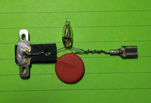

Back in the early 90s I wired up a neon charge indicator to quick-disconnect terminals.
I still have it in my test kit...very handy for troubleshooting ESLs that don't have one built in.

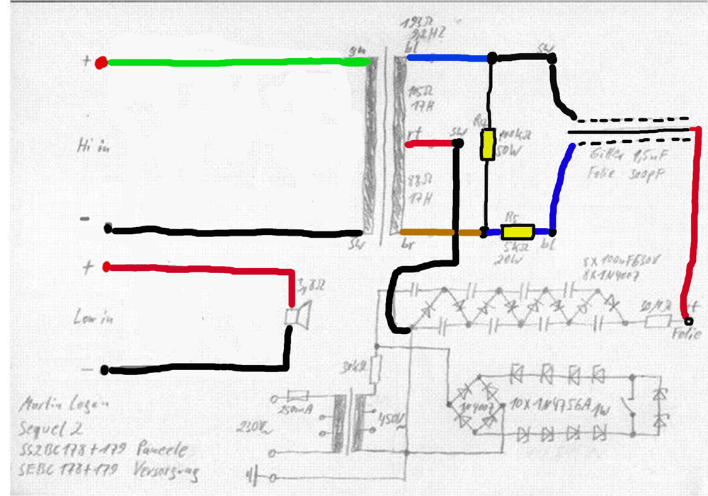

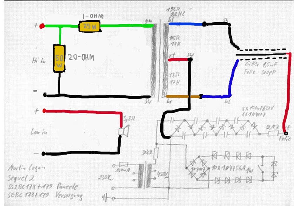

Why was it suggested that the resistors be moved from the secondary side to the primary side? I thought it was 'standard' practice to place a resistor in series with the primary?
Why don't you just remove the toasted crossover board and keep the step up transformer with the R4 100K-ohm 50W & R5 5K-ohm 20W resistors on the secondary side of the circuit and use an active crossover?
Okay they have both been damaged and you should use a lower ohm value on the other side of the transformer.
I would order two Dale NH-25 25-Watt 1-ohm 1% resistors and two Dale RH-50 50-Watt 20-ohm 1% resistors.
You can install them both on the primary side of the transformer and it will make wiring them much easier.
I was wondering this myself ... my SLIIs have experienced almost the same exact failure, and I will convert them to biamp with active xovers ... I'll make a replacement PCB to keep things tidy ...
