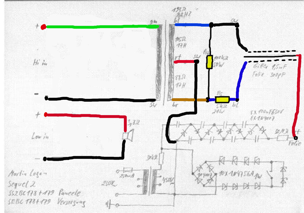

Why don't you just remove the toasted crossover board and keep the step up transformer with the R4 100K-ohm 50W & R5 5K-ohm 20W resistors on the secondary side of the circuit and use an active crossover?If I change the rest of the components, it may cost more than a new and I may still have a short in one of the traces.

It's just very simple wiring & soldering with the addition of another set of speaker binding posts.
- Remove the step up transformer from the crossover board.
- Remove the R5 5K-ohm 20W black colored ceramic resistor.
- Remove the R4 100 K-ohm 50W gold colored aluminum resistor.
- One set of binding posts gets directly hooked up to the woofer with the red (+) & black (-) wires.
- The other set of binding posts gets hooked up directly to the transformer with the green (+) & black (-) wires.
- The transformer red wire gets hooked up to the black ground wire going to the high voltage bias board.
- The blue color transformer wire and black stator panel wire gets soldered to one side of the R4 100 K-ohm 50W gold colored aluminum resistor.
- The brown color transformer wire gets soldered to the other end of the R4 100 K-ohm 50W gold colored aluminum resistor along with one end of the R5 5K-ohm 20W black colored ceramic resistor.
- The other end of the R5 5K-ohm 20W black colored ceramic resistor gets soldered to the blue stator panel wire.

I've used this method for all my Martin Logan speakers with an active crossover setup and it works much better than stock. Just make sure you keep the 100K-ohm resistor across the secondary's for magnetic inductance to keep the transformer from saturating and the 5K-ohm resistor on the front stator side for leakage inductance ultrasonic filtering.
I would ohm check the transformers once you have them removed between the blue & red wires which should be around 105-ohms. Then between the red & brown wires should be around 88-ohms. Then check to see if there's resistance between the green & black wires. If the transformers are defective you should consider replacing them with the Antek or VTX 230/6V power toroids which have about the same 1:70 step up ratio.
You will need to find an active crossover with a -24db Linkwitz/Riley filter and set it to around 250Hz. Also make sure the crossover has RCA or XLR or both type inputs & outputs then connect it between your pre-amp & amplifiers. You will also need use two stereo amplifiers or one four channel amp to power your speakers. If your pre-amp & amplifiers have XLR connections I would consider using the Art-CX310 or DBX-223s or Rane-AC23s or Ashley-XR1001 analog type active crossovers.

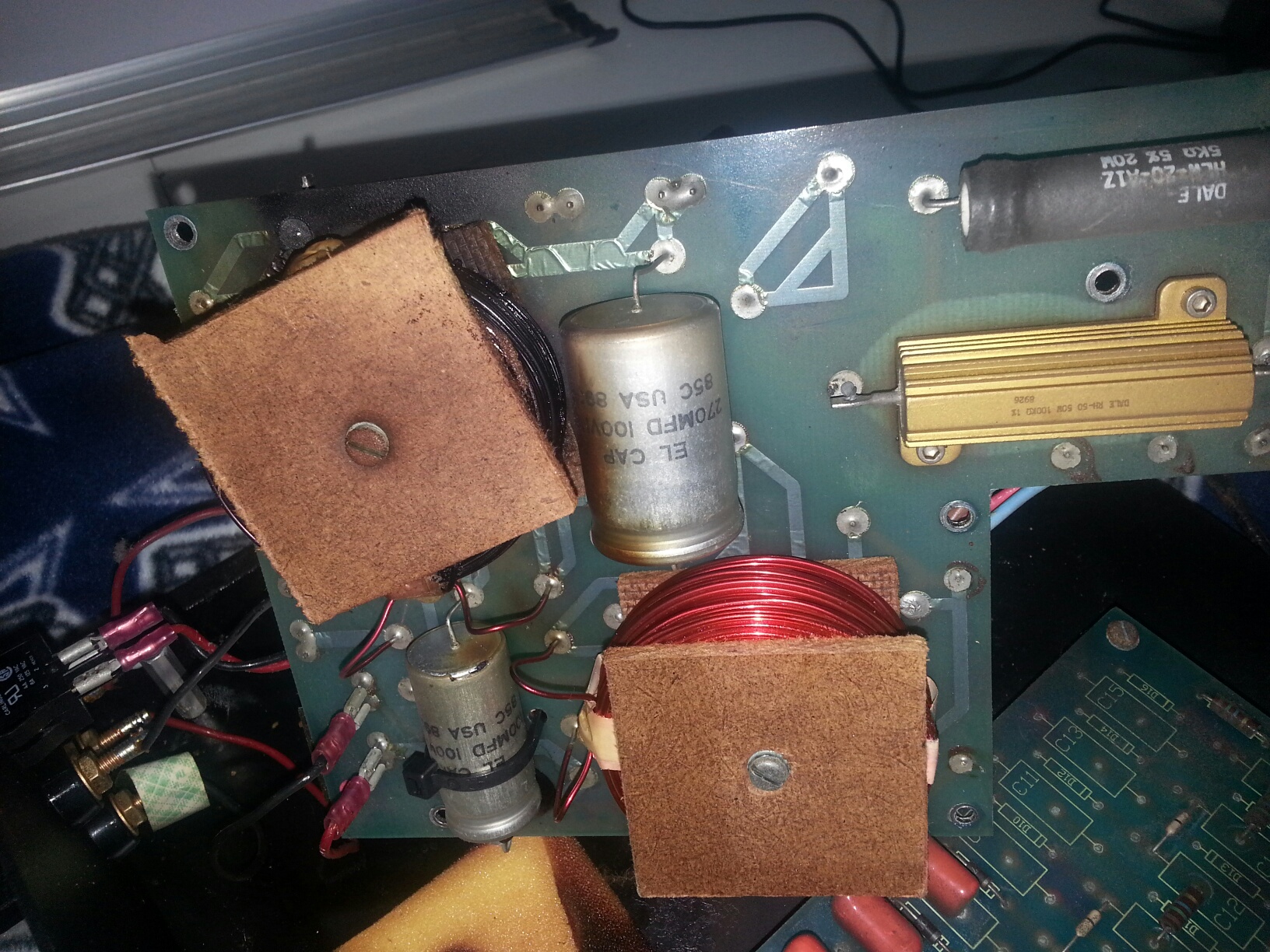

The two resistors are on the back side of the crossover board in this picture. One should be the Dale RH-50 50W 100K-ohm 1% #8926 gold colored aluminum resistor and the other is Dale HLW-20-A1Z 5K-ohm 5% 20W black ceramic type resistor. Make sure they're both within ohm specs.x83.
I just want to clarify that when you refer to the "100 k - ohm gold colored resistor" that is the same as my gold colored resistor which says "dale RH-50 50W 5-ohm" resistor?
Found them....good news is the the ceramic ones check out at 5.8 but the gold ones read nothing. BTW, the other transformer checks out okay. Looks like I'll need to pick up a couple of Dale RH- 50 50W 100k-ohm 1% resistors.

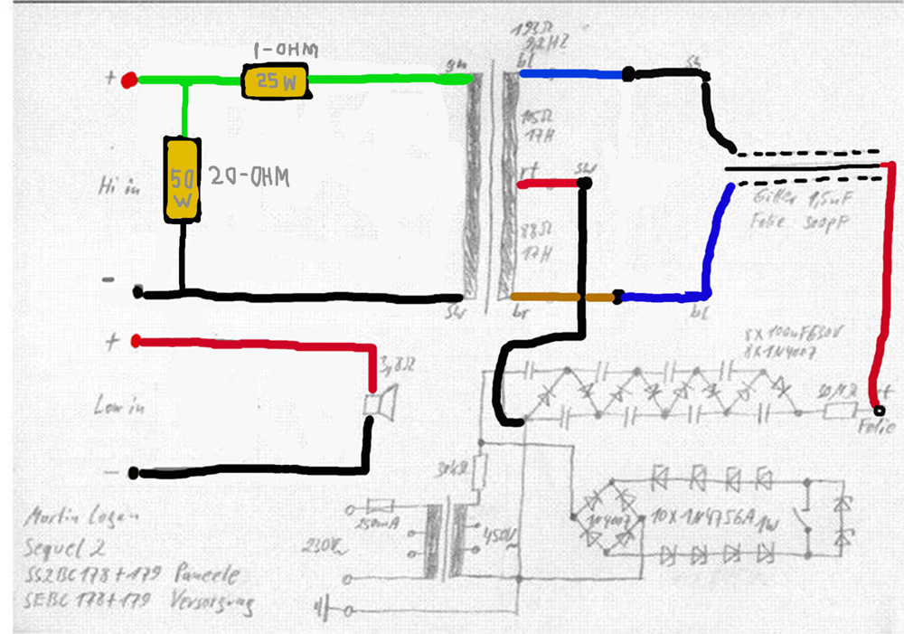

Okay they have both been damaged and you should use a lower ohm value on the other side of the transformer.
I would order two Dale NH-25 25-Watt 1-ohm 1% resistors and two Dale RH-50 50-Watt 20-ohm 1% resistors.
You can install them both on the primary side of the transformer and it will make wiring them much easier.

Ok, I'll order them. ...look inexpensive enough. I'm not sure want you mean by the "primary side" of transformer? Also, just so I have this right. ..at the end of the day I'll have the transformer connected to these resistors and the binding posts. Then I'll have the preamp feeding into the avtive 2 way crossover at about 250hz. From the crossover to the two amps...one connected to the hi pass feeding the panels and the other to the low pass feeding the woofers. I will not be using any other parts of the original electronics....rest of the crossover section and what I call the bias side with what looks like a smaller transfomer? Do you have any pics of a similar project that you can share with me?
