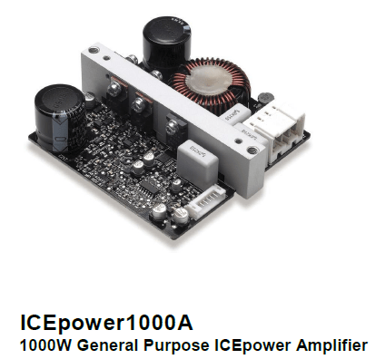

According the the schematic you posted, you should find an ICE 1000A amplifier module underneath the main circuit board attached directly to the back plate with bolts circled in red.
View attachment 1136411 View attachment 1136406
I'm guessing this is what Martin Logan thinks is wrong and is no longer being manufacturing.
They show as "no longer available" pretty much everywhere on line. For example:
https://icepoweraudio.com/buy/a-series/1000a/
https://www.parts-express.com/ICEpo...Amplifier-Module-1-x-1000W-326-202?quantity=1
But I did find one place that still showed them available. You would have to contact them to see if they actually have any.
https://shop.ampman.co.uk/icepower-1000a-amplifier-module-2061-p.asp
If you can't get a replacement 1000A module, you have might consider replacing it with a 500A module which is still readily available and has the exact same input/output connections. It is slightly smaller so you would have to drill one new attachment hole in the back plate for mounting.
https://icepoweraudio.com/buy/a-series/500a/
https://www.parts-express.com/ICEpo...-Amplifier-Module-1-x-500W-326-200?quantity=1
According to the schematic, the filter capacitors of the main power supply for the amp module are rated at 63V, so this should put it well within the allowable voltage range of the 500A module.
You would want to measure to confirm, but it is in line with the 400W RMS rating for the output power in the manual.

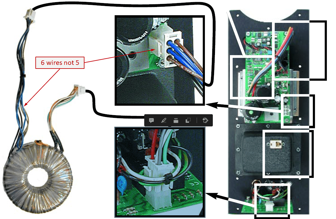

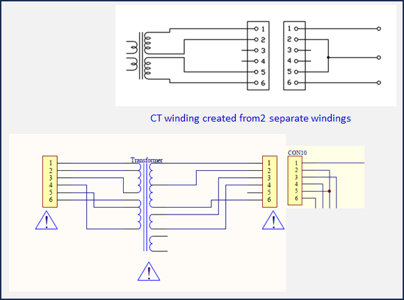

I was just putting some directions together for you on what wires to remove/swap on the power plug and noticed something.
In the schematic it shows pin 5 of the power connector as not having anything connected to it. But in the service manual pics, it shows 6 wires...looks to be 2 blue, 2 brown and 2 black.
Can you confirm this is what you have? and can you measure the AC voltage between each of the wires pairs?
Blue - blue (pin 5 to pin 6)
Brown - brown (pin 3 to pin 4)
black - black (pin 1 to pin 2)
I think they have two separate high voltage windings and made them into the center-tapped configuration shown in the schematic by connected pin 2 to pin 5 on the circuit board side of the connector.
Only 5 wires coming out of the transformer to the 6 pin harness and pin 5 is not connected. Voltages are as follows, with the harness unplugged:
Blue/blk 1/2 35.7 VAC
Brn/brn 3/4 13 VAC
Blk**/brn 2/6 35.6 VAC assuming 2 and 5 should be tied via the board and are ground.

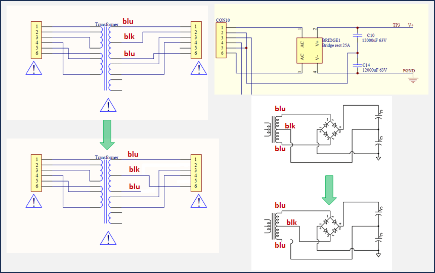

Great! thanks for the detailed results including pin numbers and wire colors.
So your transformer matches the schematic not the service manual pic.
Here are the steps to lower the voltage from ~100VDC to ~50VDC for the 500A:
1) Remove pin 6 (blu) from the transformer side of the connector and cap it off or carefully cover it in electrical tape.
2) Remove pin 2 (blk) from the transformer side of the connector
3) Insert the (blk) wire you just removed from pin 2 into the now vacant pin 6 location.
4) Before plugging things back in check the voltage at pins 3 and 4 of the 1000A. If it is > 50VDC I would recommend discharging the 2 power supply capacitors by connecting a resistor between pins 3 and 4 of the 1000A connector. I usually use something like a 10K resistor. Monitor the voltage until it decays to < 50VDC...would likely take around 30 seconds if it was up at 100VDC.
5) Plug in and turn on power, verify you now get ~50VDC at pins 3 and 4 of the 1000A connector.

Looks like it worked! I'm getting 50.6VDC at the 1000a connector. My old pin 6 is taped and swapped pin 2 as directed. So I should be good to give the 500a a shot? I have the correct 8 pin connector wired with leads coming for the 500a so will need to cut the old 1000a 4 pin and match it up the 4 needed wires. I'd rather make an adapter but can't figure out what the existing 4 pin connector would be to replace the 1000a end.
Thanks for your help. Appreciate all your help so far and any insights for the rest of this if you've got any.
Yes, you are good to go to try the 500a.
Best case scenario you turn it on and it works and is completely stable.
If you notice some instability (ie woofers flapping about with no signal input) the schematic(pg 8) shows a rotary switch to adjust the servo gain that could be turned down until stable.

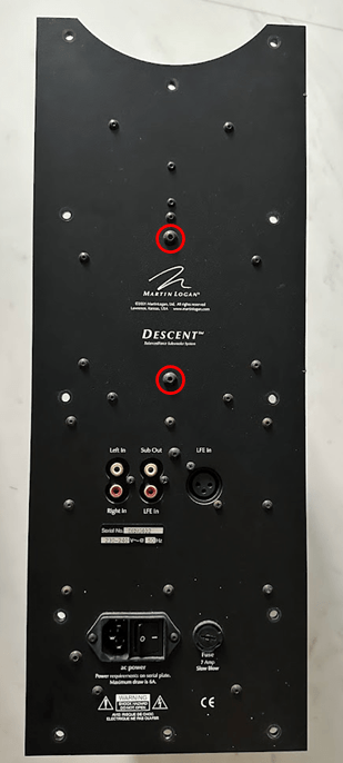

Speaking of heat, just wanted to make sure you were able get 2 mounting screws thru the back plate into the heat spreader on the amp board.
This is important for efficient transfer of heat away from the amp's electrical components for best reliability.
It looked like you might have to drill a new hole for at least one of the mounting screws.

Regarding sharing the signal through two wires, I only attached one of the two wires. I did not believe it was good practice to run two wires of same signal to the same place. If you think it'll help, I can rework that. For now, the 2nd wires are just taped over the end and zip tied to the harness to be secure.
Yes, I drilled a second hole to line up with the shorter distance between mounting holes. A surprise for me was the mounting hole was an M4, while the 1000A was larger, I assume M6. Had to make a last minute run to the store to get some screws.
