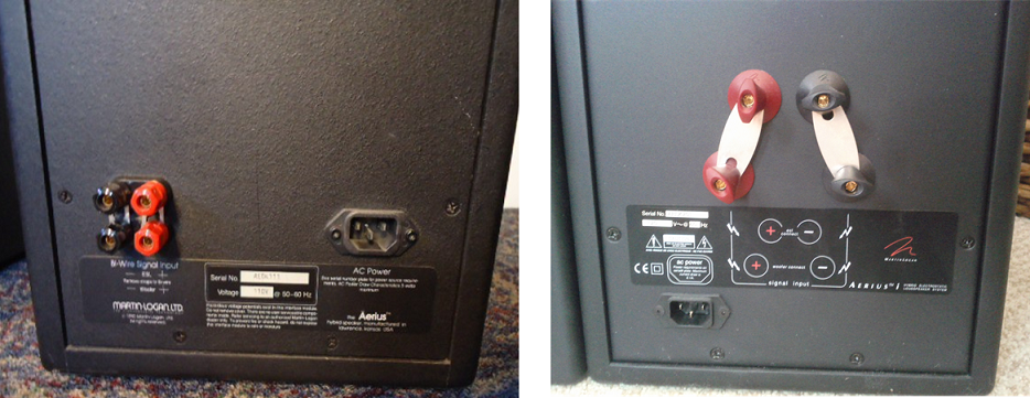

Martin Logan Aerius --no sound from ESL section
Should be a label on the back of the base.
The binding posts are also different...if the labels have been removed.

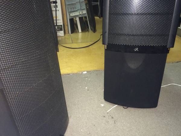

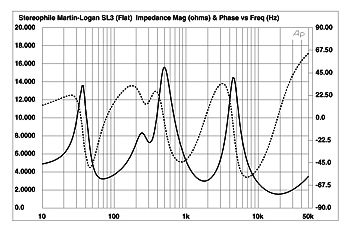

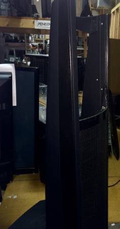

Just got 2 pr of ML....SL3.$100 for the pr... one bad 15meg res in the bias feed pulled the panel output down...fixt got $1k for pr.............$20 for the pr Ascent....panels fell out ripet the wires....there playing now........I never pay more than $100...for used ML over 15 years old..... some eze fix.....most ownres think even if one panels has low output there worth more.....but new panels from ML.....2k.....
All the ML have rubber surround......out of over 15 pr only one bad bias....never bad woffer
As for reworking the panels....I have got most open with out riping the mylar.....pain in my but....to put new mylar on....you got pull all the old 3m tape off..an I would say recoat the medal.....I have never re-mylard a pr of ML....it could be done

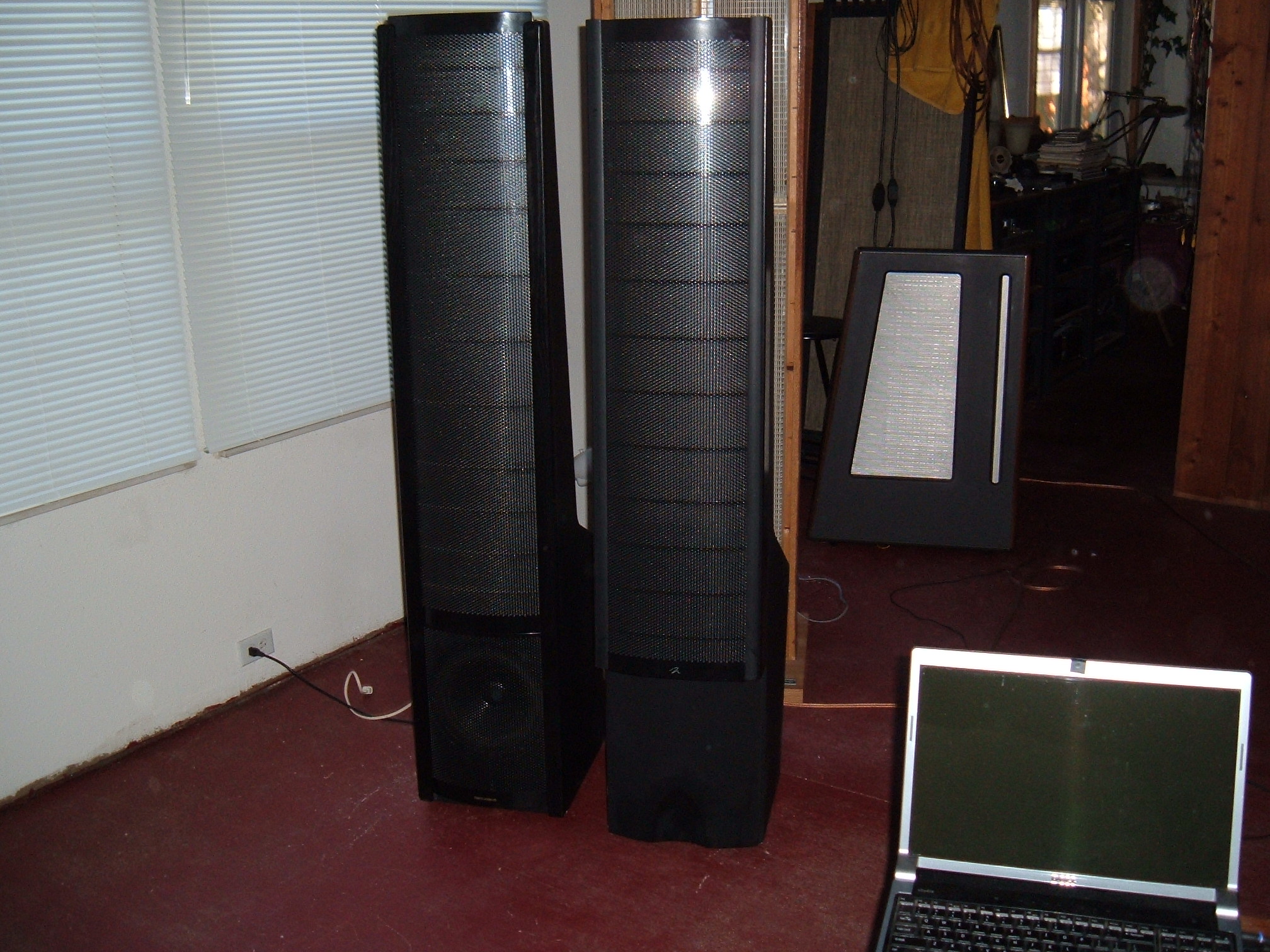

Gents, can I throw in a slightly OT question: what are the typical effects of a diaphragm losing tension? I have a pair of vintage ML Aerius and I find the sound from the panels constricted and much lower in level than the woofer. Should I replace the foil?
Losing tension will lower diaphragm resonance and often cause diaphragm to collapse to the rear stator which will result in lower SPL in general, and reduced output in the midrange(ie lower end of the ESL response). That being said, this is not a common problem with ML ESLs.
Typical causes for loss of ESL sensitivity in ML panels are:
1) leakage currents from dust accumulation on the spacers which pulls down the HV bias supply output.
Some folks have had luck cleaning off the dirt by giving the panels a shower.(seriously)
http://www.diyaudio.com/forums/planars-exotics/243508-building-large-curved-esl-19.html#post3993807
2) poor connection between diaphragm coating and HV bias supply contact
3) loss of conductivity in part or all of the diaphragm
Fixing these last two would require taking your panels apart.
Tyu probably has the most experience dealing with low output ML panels.
Hopefully he will chime in.
BTW, can you take an on-axis measurement @ 2m so we can see what the panel vs woofer output looks like?

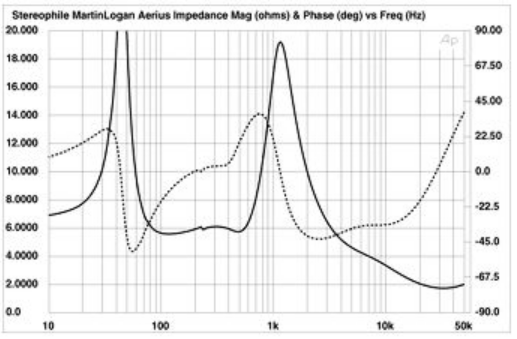

If Re = 5 Ohms, that suggests it's an 8 Ohm woofer, but I'm sure the Aerius has a 4-Ohm woofer....?

I tried to measure the bias but I think the meter drew it down, as it is high impedance (the bias source is). I measured about 1.5kV.
