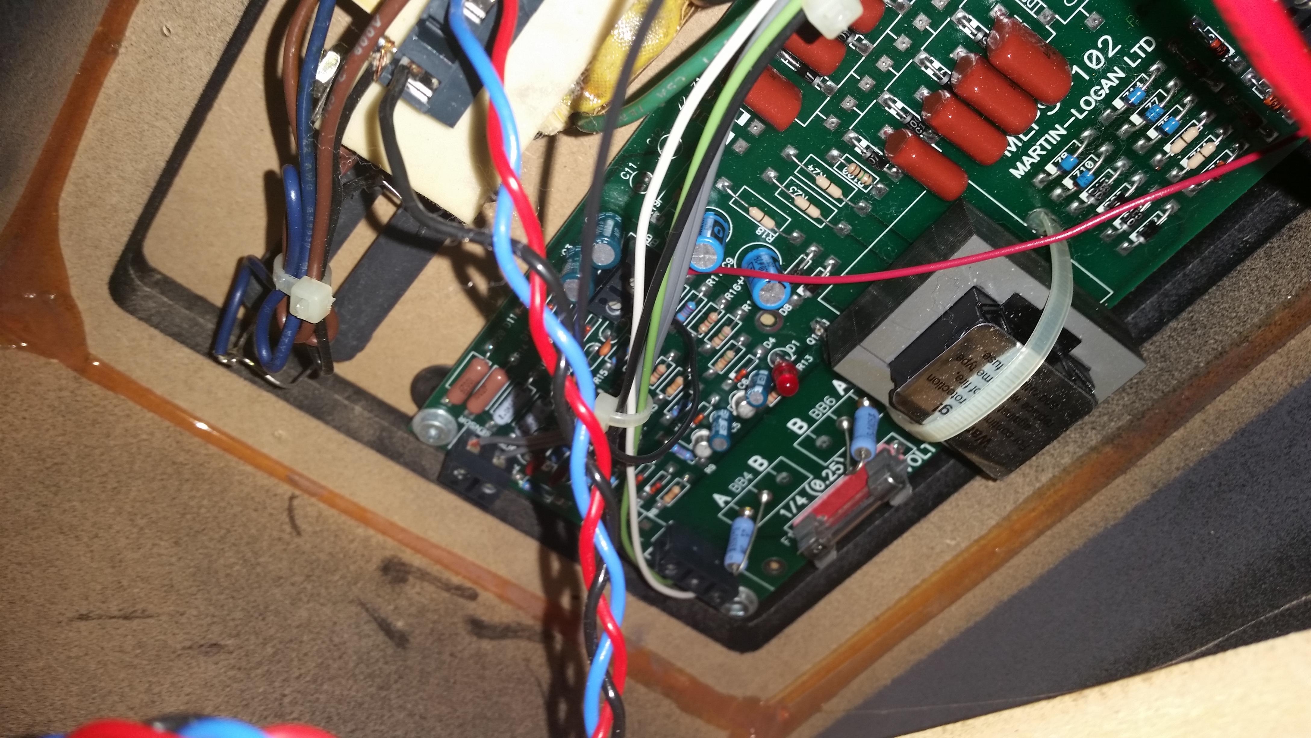

Hi. First post. I purchased a pair of martin logan aerius speakers which were sold as having outstanding sound. After paying over 550. for safe,fast shipment. I received a pair of huge boxes for each packaged by ups store and delivered in 2 days . The boxes contained no padding other than 1 layer of bubble wrap but tons of room to bounce around in transit. The seller said that the no sound situation from 1 was probably loose or broken wire. I switched panels, transformers, and then finally the circuit boards where the problem was discovered. One works, one doesn't but both show signs of contact heat blistering under an as of yet identified component which is purpose of my rant and post. Could someone please identify component on circuit board with zip tie around it.and where might it be purchased.. Pic enclosed

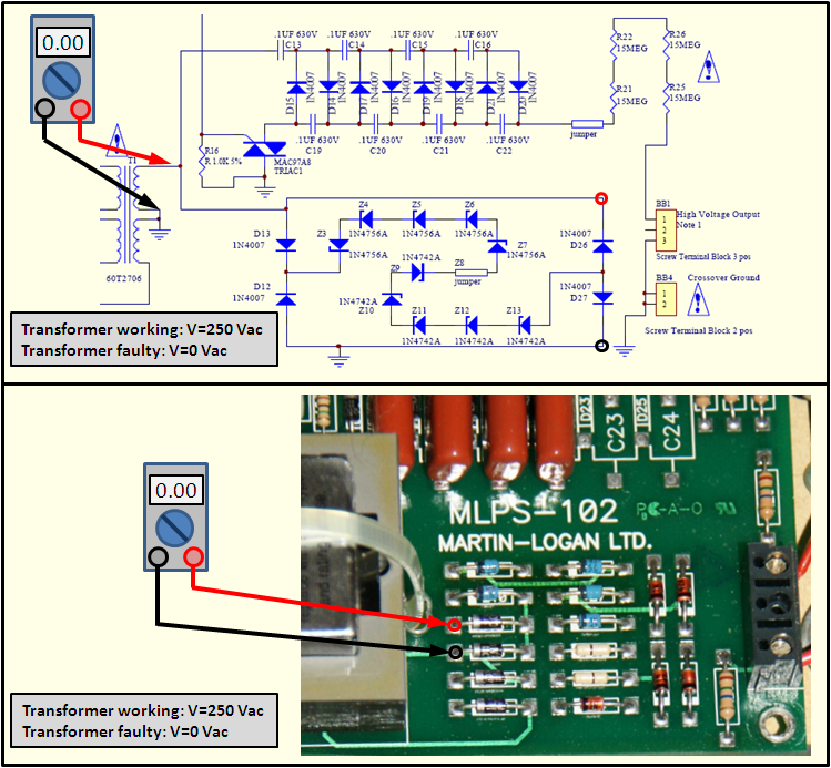

You can make measurements from the component side of the board...I will post an image showing test points when I get home tonight. The transformer is the most likely part to fail, but there have been other components go bad.

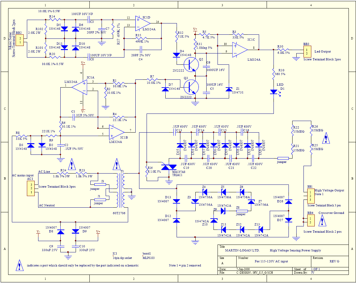

A first step before measuring anything is to make sure the signal is getting to the triac switch to send voltage from the transformer to the voltage multiplier stage. Does the red LED on the board light up when power is plugged in? You may need to feed an audio signal to the speaker binding posts for it to illuminate.
Circuit posted for reference.

Hi. I'm not where meter is but it is fluke 175 I think. Light stays on when audio signal is detected. i swapped out panels, then transformers,finally circuit boards. Only when circuit boards were swapped was the problem found. somewhere in 1 of the boards. Although, when viewed underneath there is heat bubbling at solder points under each of the zip tied components on each board. But one works, and the other board does not.

Light coming on with audio signal lets you know that transformer is receiving voltage from the mains supply and the low voltage winding is working properly.
Next, check the output of the transformer High Voltage winding.
The attached image shows an easy place to put your meter probes to measure.
Voltage should be around 240VAC - 260VAC if the transformer winding and Zener regulation is working correctly. A very low or zero reading lets you know either the transformer HV winding or connection from the winding to the PC board traces has failed.

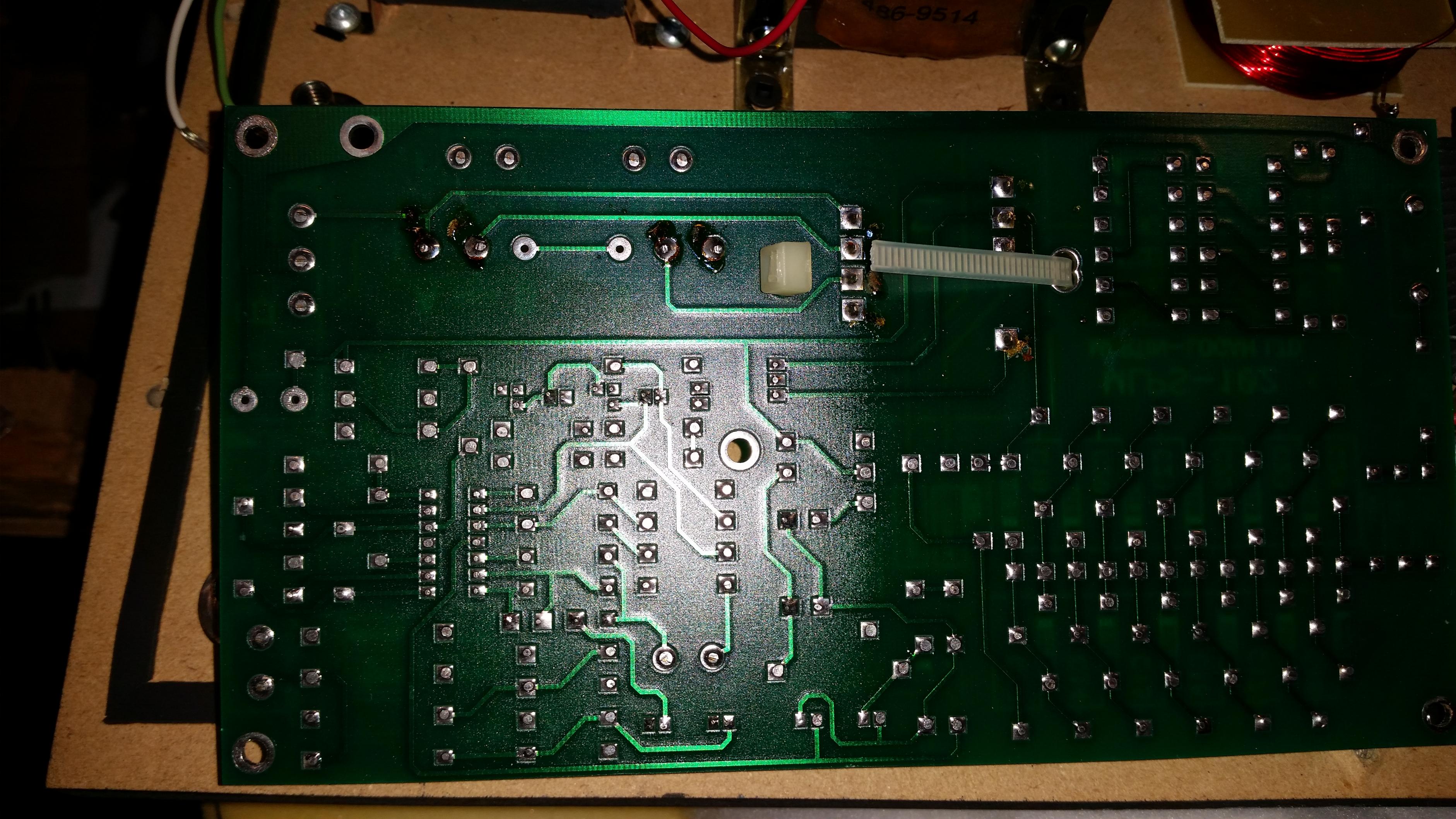

Hi. I just checked voltage between 2 points on the working speaker and had a 250v reading. Meter between points on non working one and 3 or 4v showing. Is that it? Or should i test something else while in this area. And if the answer is check something else, please use picture of board as was done before. And if no more checking is answer, do you know where best place to purchase this transformer? Also, is it normal for solder points on underside of board where this part connects to show blistering? Thank you
You have isolated the problem, nothing further to test.
Voltage is going into the transformer, but not coming out.
Can you post picture of the blistering you are talking about? I have not seen that before.

I think what you are seeing is the flux used when hand soldering some of the larger components to the board.
A Qtip dipped in acetone or similar solvent will remove the excess flux from around the solder joints if it bothers you.

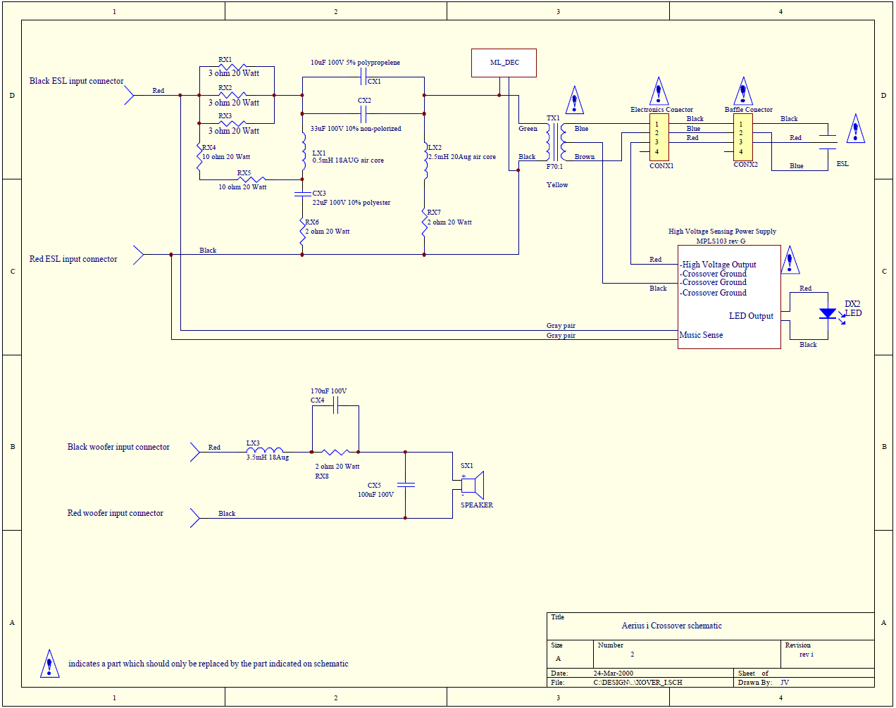

Does anyone have a schematic of the xover? I have a copy of the HV bias and auto switch on schematic, thanks for that, but not the xover.
Also, any info on that woofer type and or brand would also be welcome.
Jan
I don't have an "official" copy of the Aerius crossover, but here is an owner drawn circuit which may or may not be accurate.
Came from here: ESL
Attached also is the crossover for the Aerius i.
