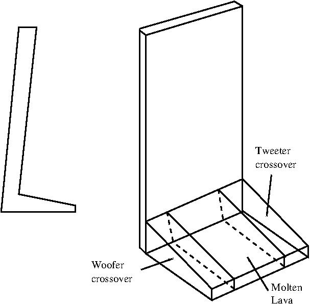

Searching the net now for sand filled baffle making as I had it planned before also when I came to know about Wharfedale speakers.
May be I will give a try. Say two 12mm- 18mm plys sandwich the sand. Some bracing inside also to hold the plys together as the sand will pressurise the plys and may be it swells. Totally it may become 40mm or more in thickness. Is it as simple as that to make sand filled baffle? Has anyone here made?
Yes 12mm should be OK, but as you say it can swell under the pressure from the sand. Normally a few small wooden blocks are used to tie together front and back panels. Yes, the wood blocks do transmit some sound, but so do the baffle edges. In practice, the sand filled panel is so dead that the small connections are not a worry.
Thank you for the information. The below part is ok as there is the big circular bracing of the woofer hole. The problem is the place in between the full range and woofer and the opposite side of the full range as it's circular bracing is off center. Therefore other than the side bracing only two small (circular) wood blocks in slight diagonal fashion above the woofer will suffice. The picture in my mind is taking shape. Seems doable.
Yes the woofer ring will hold strongly in that area. And for sure the mid/tweeter mounting isn't going to be easy. Not only do you have to deal with the sand core, there is the baffle thickness and problems of resonances and diffraction around the opening. A thin one piece sub-baffle might work there, as it does in a solid baffle.

The shaded areas are the wooden blockes gluing the front and the back baffle together, other than the four sides bracing. The shade around the
full range (tweeter) hole is big compare to the ones around the woofer hole, so that 45 degree curving is possible on its rim. The white area is filled with sand.
Couple of more issues come to mind:
1. The bottom part of the baffle will be much less heavy compared to the top. This is because the woofer is large in size. So the baffle
will be unstable and may easily topple. A solution is that a heavy plinth (e.g. sand filled) must be attached at the base, to give stability to the whole structure. The plinth also may house the crossover network, hidden. Will look nice.

Thanks again Pano for following my thoughts and for the crucial information. The earlier baffle I built (35mm two ply glued) had this problem, the top part was much heavy, that is why I had to make the strong back support starting from the center. This this time I would like to avoide that, and keep the back of the woofer free from any obstacle. The Eminence Alpha 15A has small light magnet so does not give much of a weight. The sand part is understandable,. It should be dry, otherwise may affect the wood.
I have to now think how to build a heavy base.
Reactions: Pano
My stretched thought.
I have to say, XRK's "The XSD Speaker" has a woofer design that puts quite a spine in place to hold up the rest of the baffle. I'm sure I've seen center spine designs that go over the back of the conventionally arranged woofer's magnet. Thinking of a structure that will give that tall board some rigidity, w/o getting in the way of the speaker cones rear emissions.
