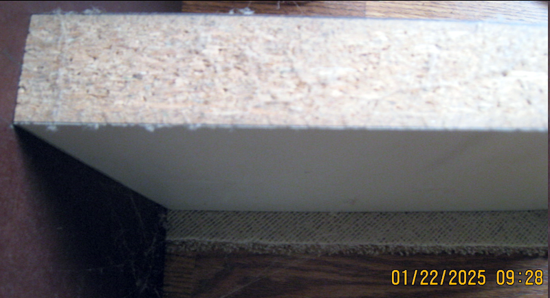

Sounds like a good idea to me. I used cork, which could use more mass to it. I bet it makes a nice, dead panel.It may be that mine does not qualify as a constrained layer, precisely, but maybe just “workable damping between two layers of wood”. I think the fact that the vinyl is dense, soft and flexible compared to the wood, it likely interrupts vibrations. The mass-loaded vinyl does not ring like wood when struck or otherwise agitated. The situation may be roughly analogous to placing a finger on a vibrating cymbal or drum-head, etc.
I have used OSB with a sizing step- diluted titebond 2 woodglue. Just dilute and brush thinly on the whole surface and let dry. The end product is much more stable and durable, but it takes space and hassle to do, but is a cheap way to turn nice flat, cheap OSB into a more workable product. The glue not only acts as a surface sealant but also prevents any flaking and adds some additional damping.OSB is ugly but cheaap and rigid as well as well damped if you suit the front of the baffle with nicer looking : faux leather, felt, veenering and so on.

Thick and light. 30-40mm XPS as core with wood veneer skins as baffle for very dead OB panel seems perfect in conceptI think thicker baffle will solve the problem.

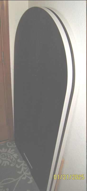

MDF. I was able to make a pair of 42" "tombstone" OB panels, along with extra material to make front tip-toes and back legs from the table tops. I also had enough extra material to partially surround or "hood" my upper Lii Audio F15s and add some significant mass about the driver at the panel top. Later I added Goldwood 18"s on the bottom.What material are they made from?
I used a protracted router to score the cutouts, then chased that with a Jig saw to get cleanish circular cutouts. The backside of the speaker flanges simply mount to the front baffle surface, which is a bone white color. They're wrapped with "T" plastic molding all around the outside edge, so no work was needed to dress the panel edges. I was able to find a spray paint can that matches the color, to get 16" and 18" metal pizza grilles looking nicer against the baffle. Assembled, I need to use a hand truck to move them, so there's some heft there for the drivers to push against.
