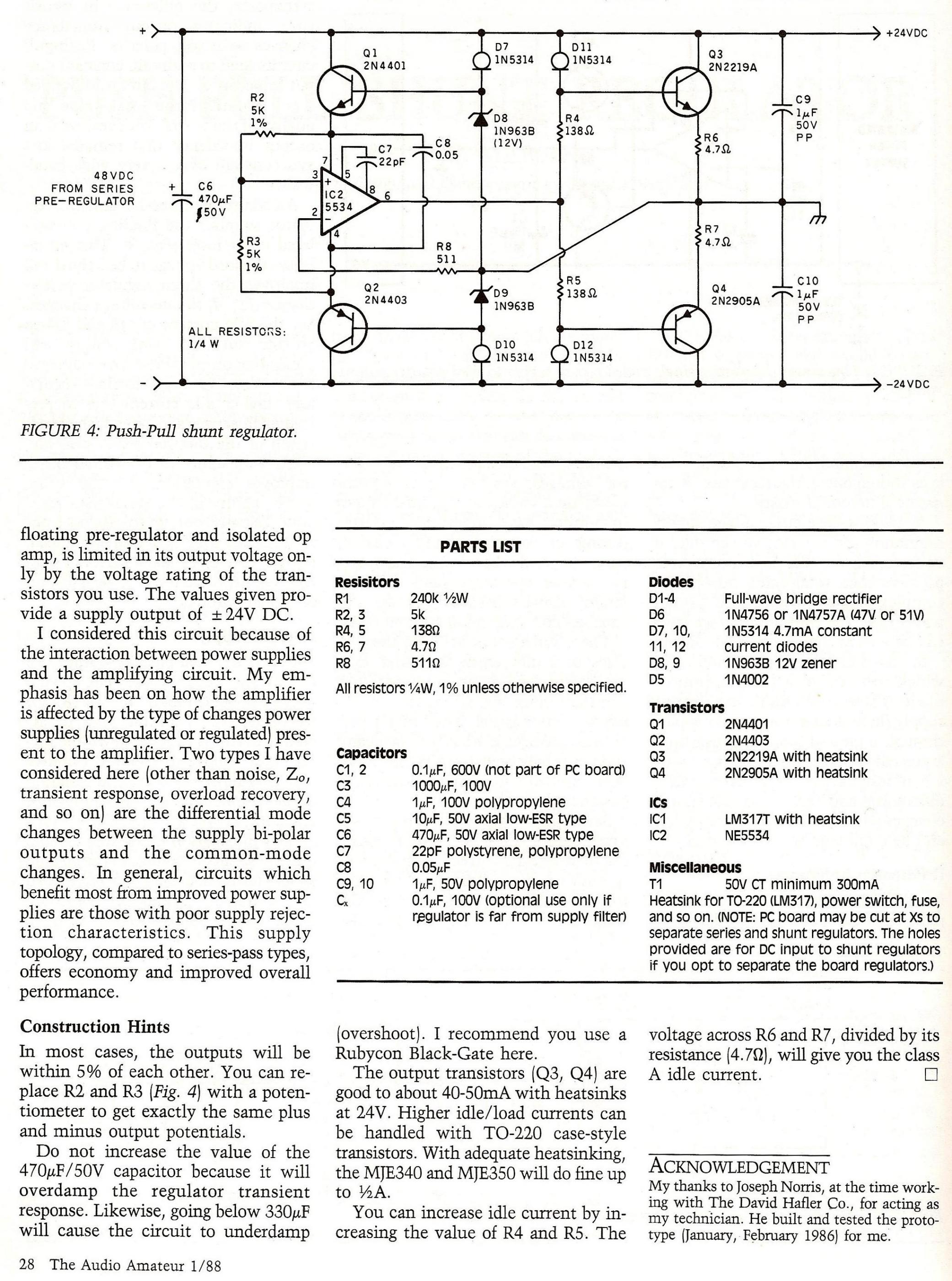

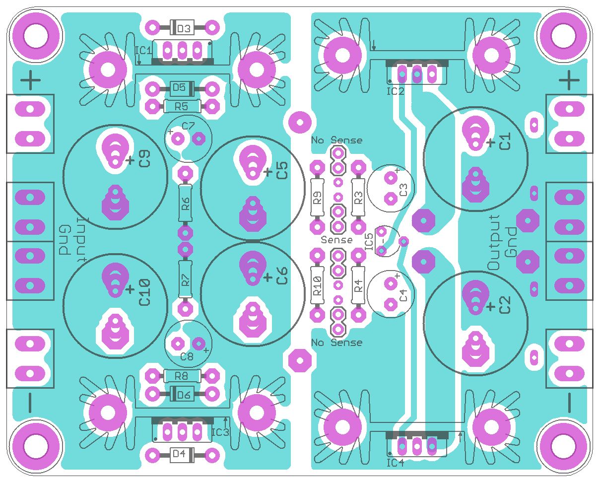

You don't have to re-invent the wheel for the amplifier power supply in this case.
Well, this is in the spirit of Mr. Marsh, see atachments, reposted from here:
http://www.diyaudio.com/forums/anal...amp-rail-splitter-question-2.html#post3416555
Corrected version.

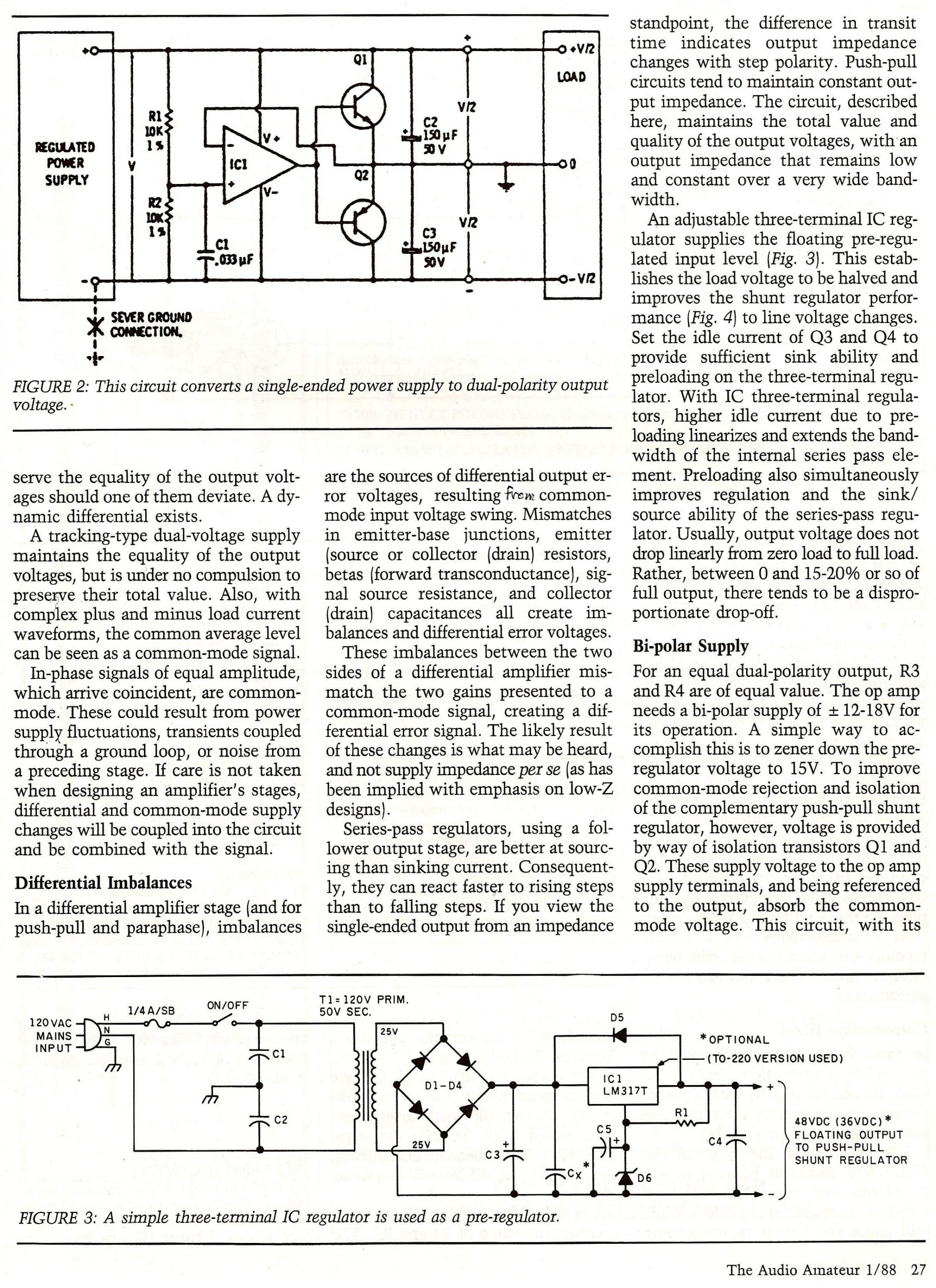

Rail splitter lifted from here:
Virtual Ground Circuits from Voltage Regulators
Virtual Ground (regulated!) - and Rail Splitter Circuits!
I believe this was the first publsihed application for audio use. It has been my favorite topology ever since.
THx-RNMarsh

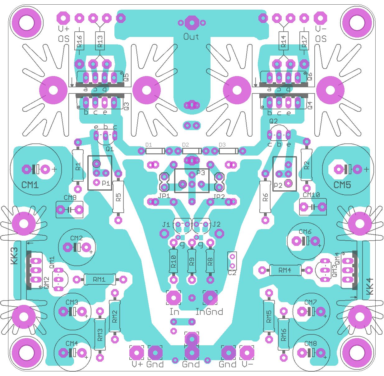

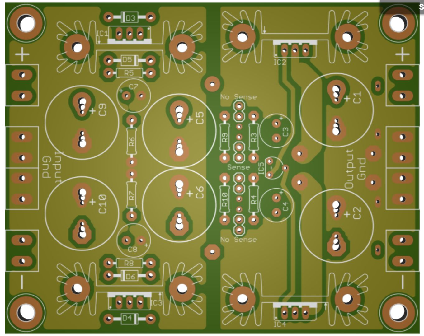

Are there any pcb for these available to us?
TH-RNMarsh
Not at the moment, but I will put something together in a day or two.

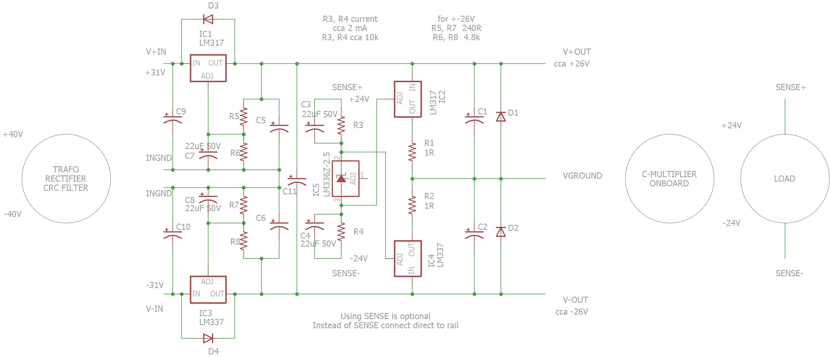

How well does it deal with ripple at the higher frequencies?

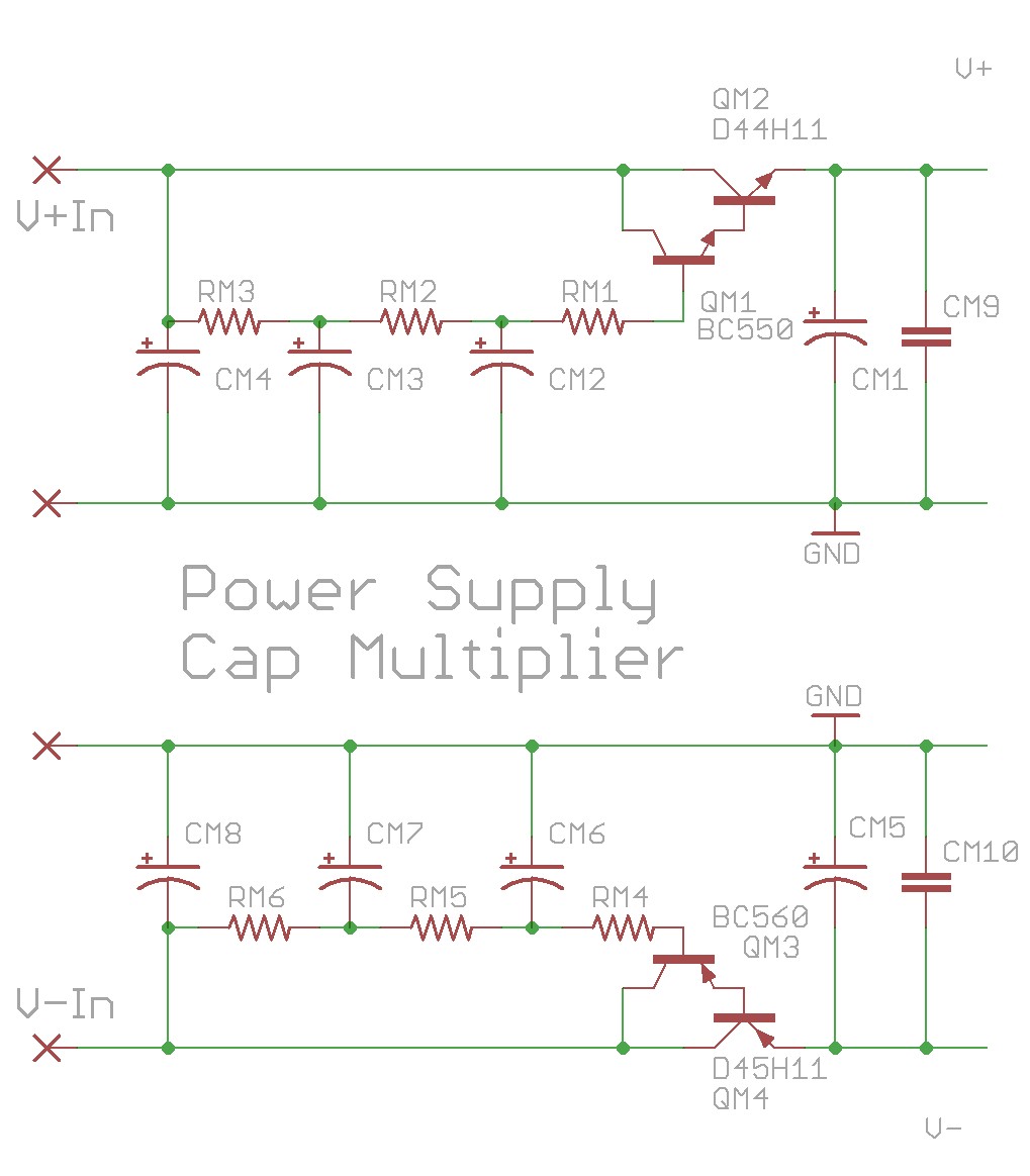

On board C-multiplier will filter all the remaining HF noise.

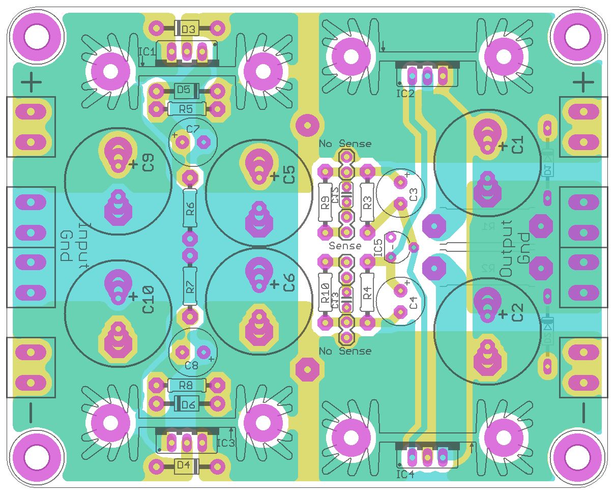

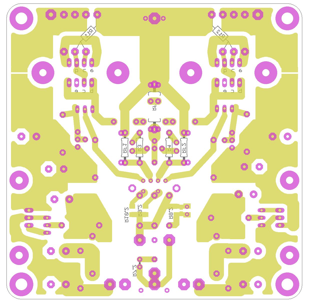

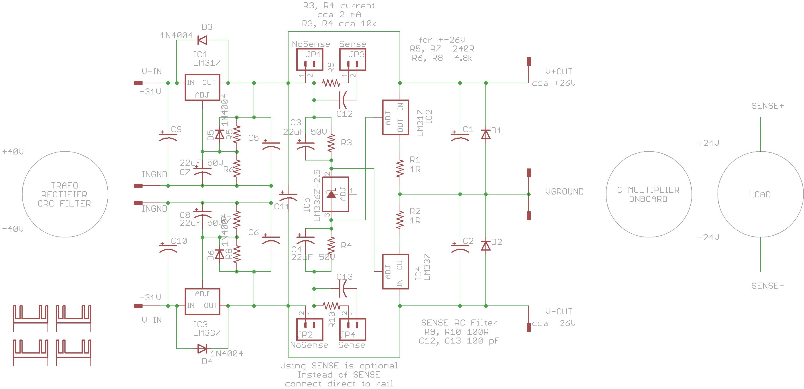

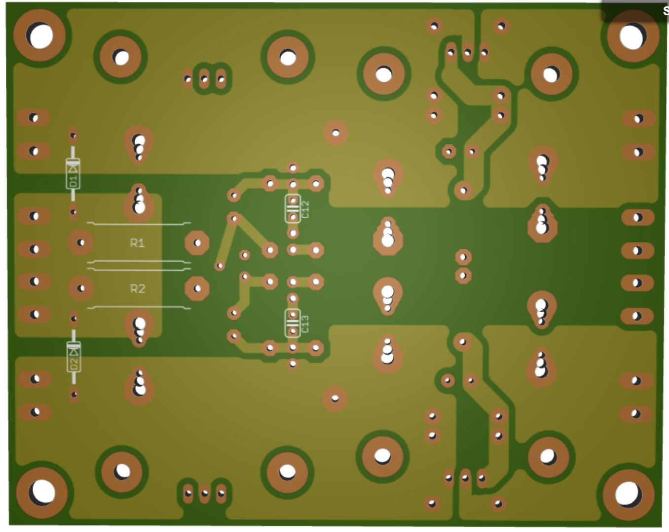

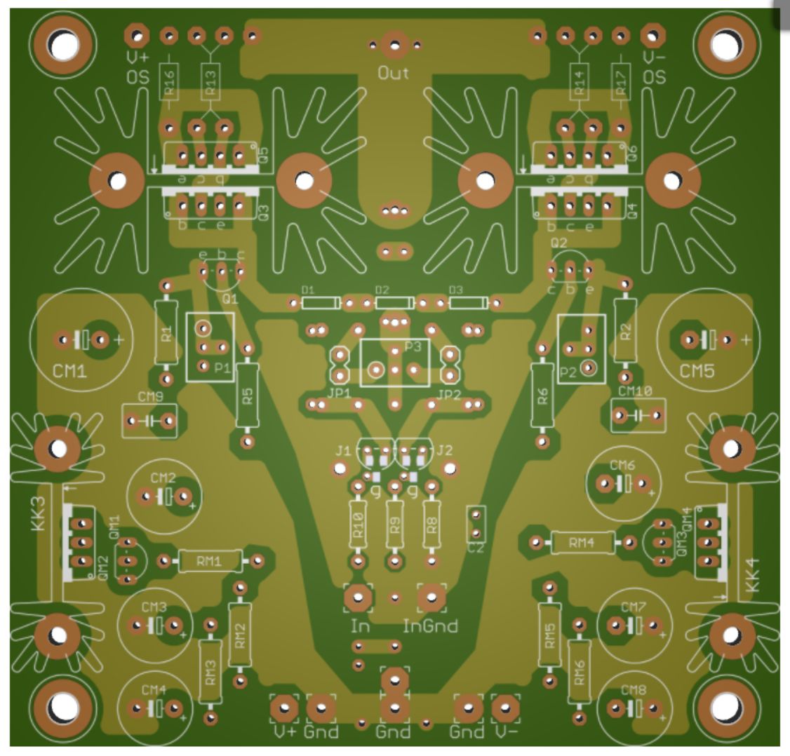

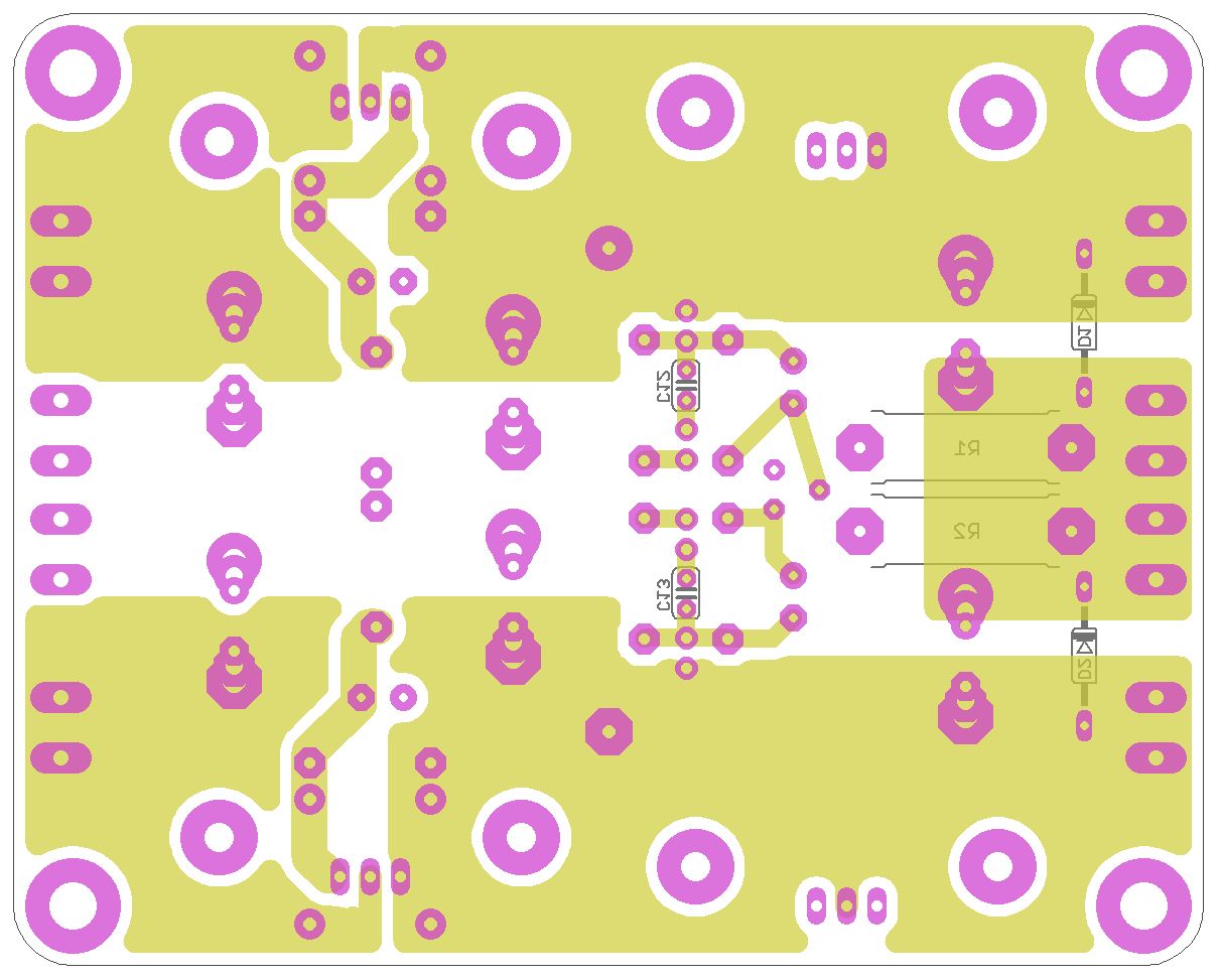

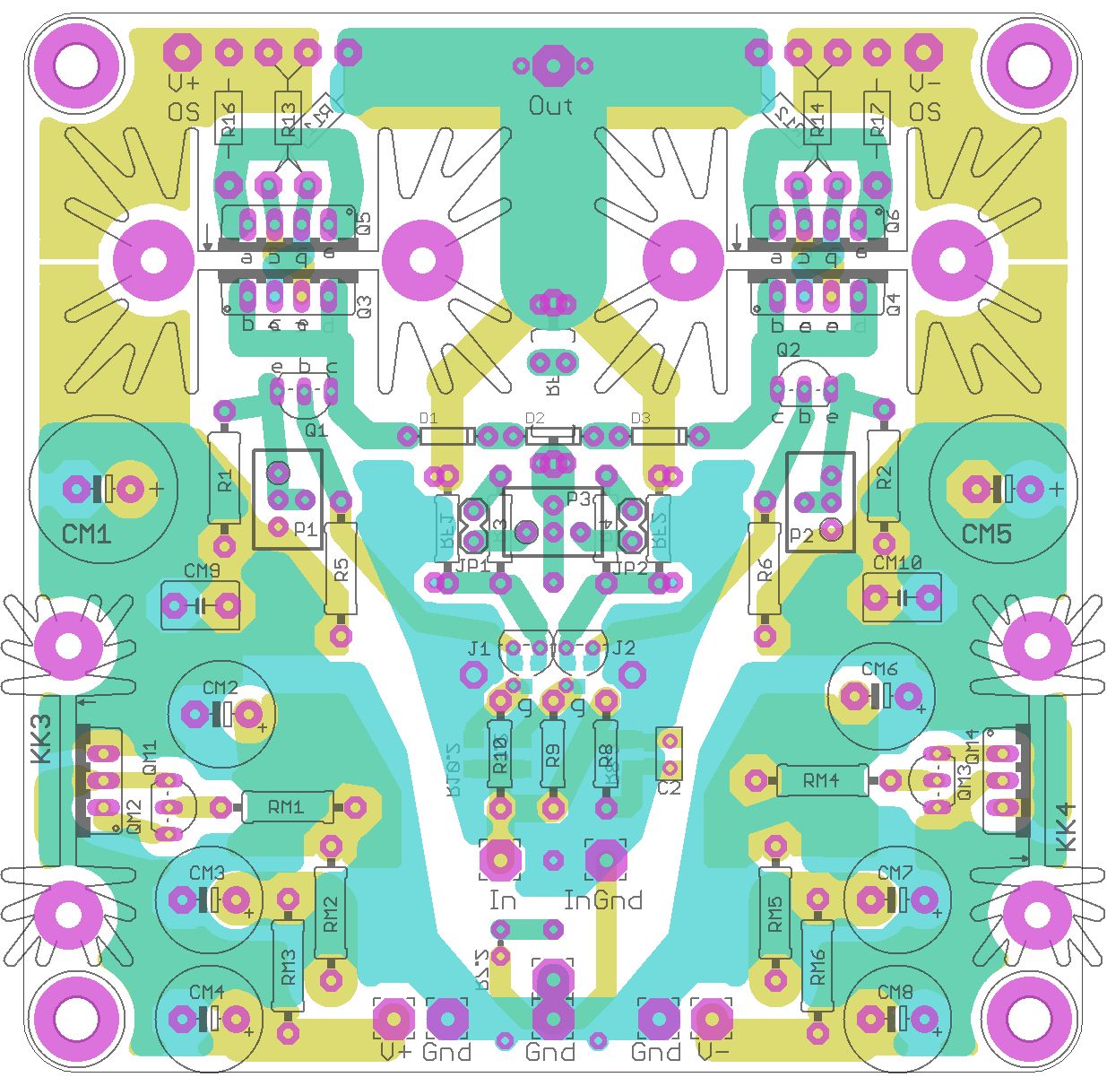

Peace of cake, Mr. Marsh, I don't expect You to do your own layouts.
I post layouts asking for help from others in verifying design & checking for errors.
As soon as layout is verified, I will order my PCBs&enable ordering for others.
My past PCBs as examples:
10x8 Dual Power supply DC board with RCR(L)C filter
Keantoken Kuartlotron
5x5 Super regulator
Keantoken K Multiplier
