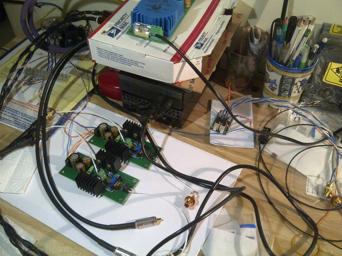

I had the time to listen to the amplifier, but as I recently sold my DAC, I had to rely on my m-audio soundcard to do all the listening, so this made the task rather difficult.
Still, I can say that the amp sounds very very promising! It is very natural sounding, with perhaps a touch of warmth, fast and punchy, with excellent reproduction of tones. Soundstage is earthy and expansive, intruments feel real, palpable. I will be able to develop more when I find a proper source.

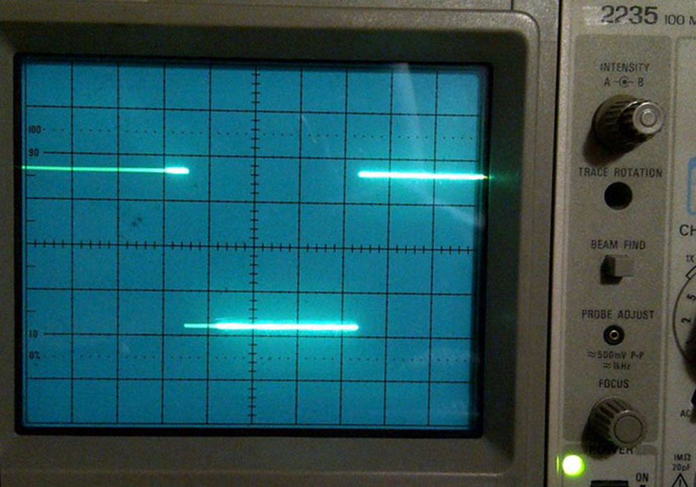

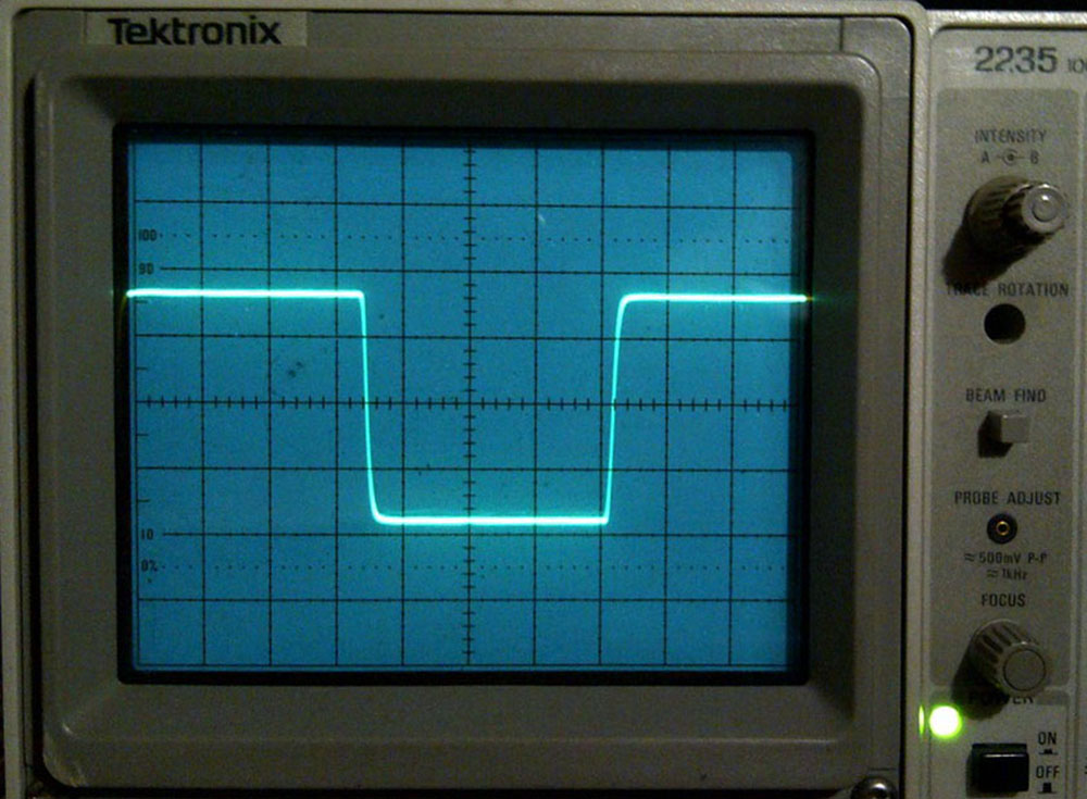

In the meantime, I made some measurements, here are the results...
Let's begin with sine/square wave tests on the scope.
From left to right: 10Hz, 10kHz, and 100kHz square wave output. I didn't install the input filter cap to allow full bandwitdh.

Those are picture perfect square waves. You will like the sound even better with a good DAC, I am sure. Thank you for sharing your results !!

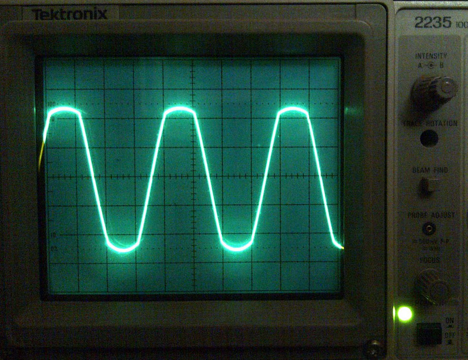

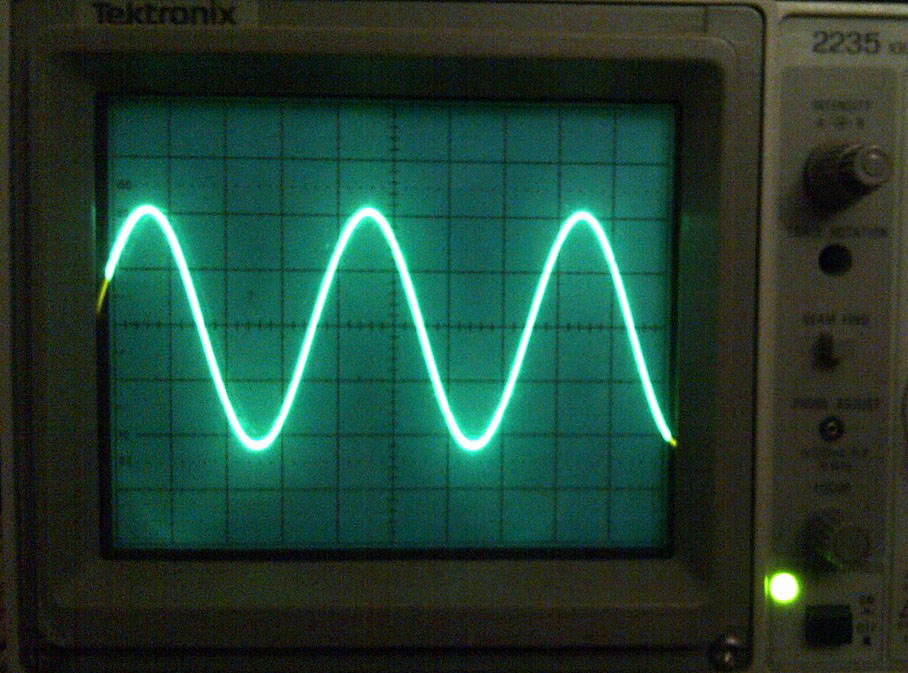

Thank you for publishing such an interesting design. I am impressed with the performance of the circuit, especially in relation to its simplicity.
Now I am curious how the performance could be improved further, did you manage to build the 12 transistor version you mentioned in your article?
Below, sine wave and clipping behavior...

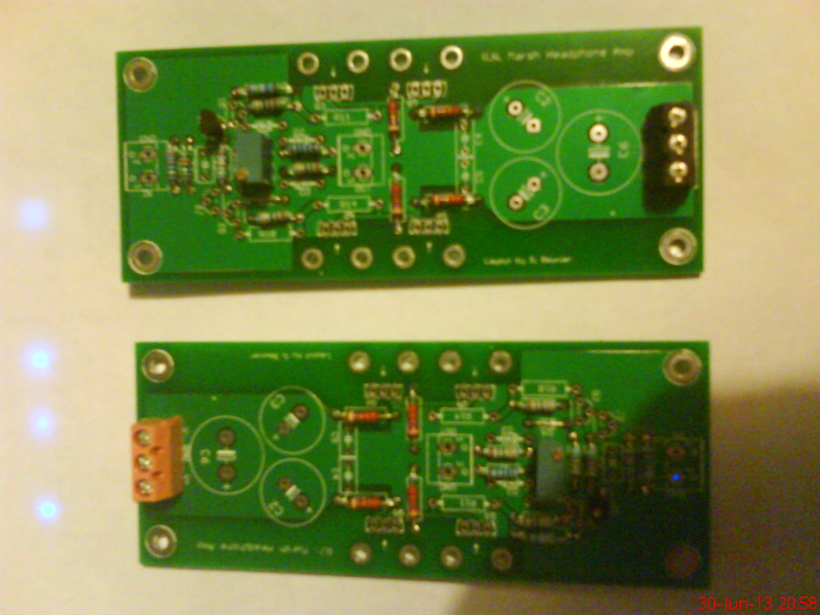

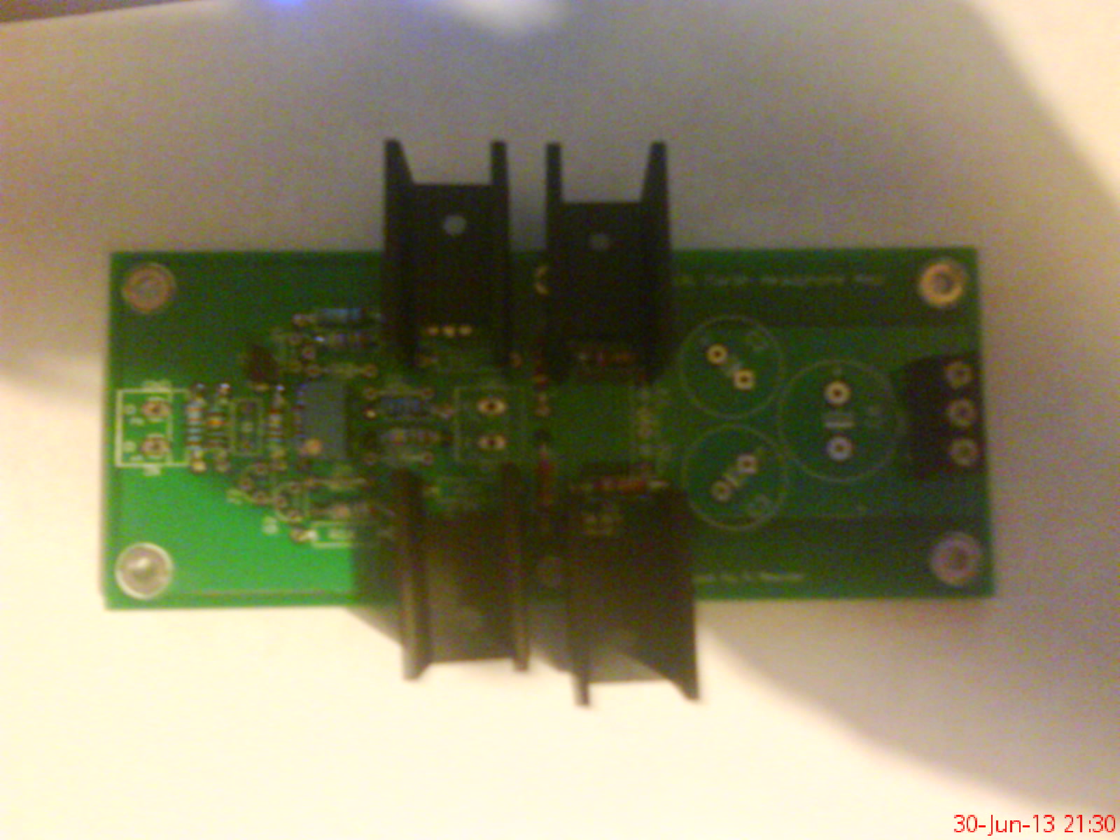

Construction so far, have to reorder R11/14 and still waiting Mouser order for the caps etc.
Pix not great on my phone.
The second is how the heatsinks will mount when the devices are soldered up and mounted to the bottom of the sinks. They will then be clear of any other bits on the board

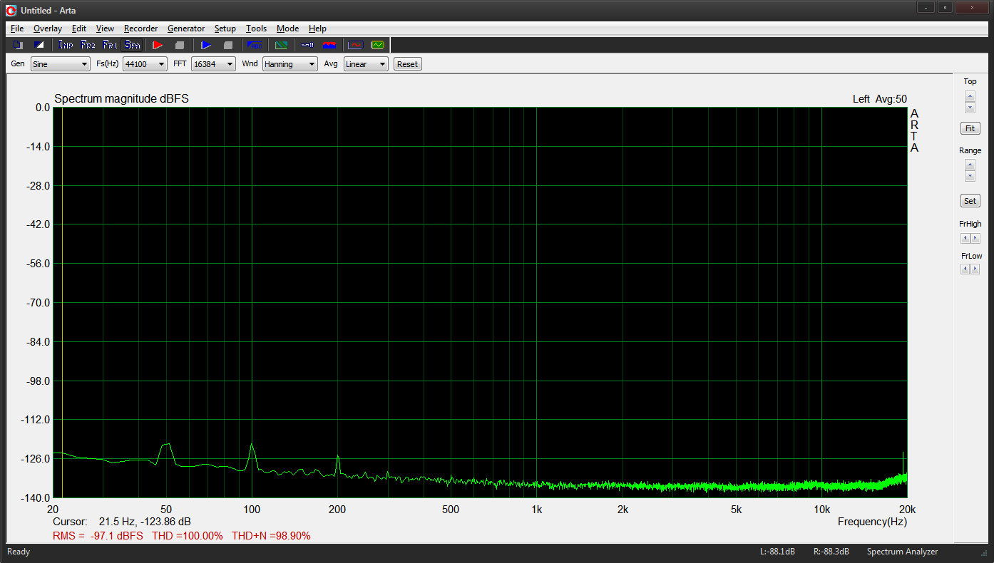

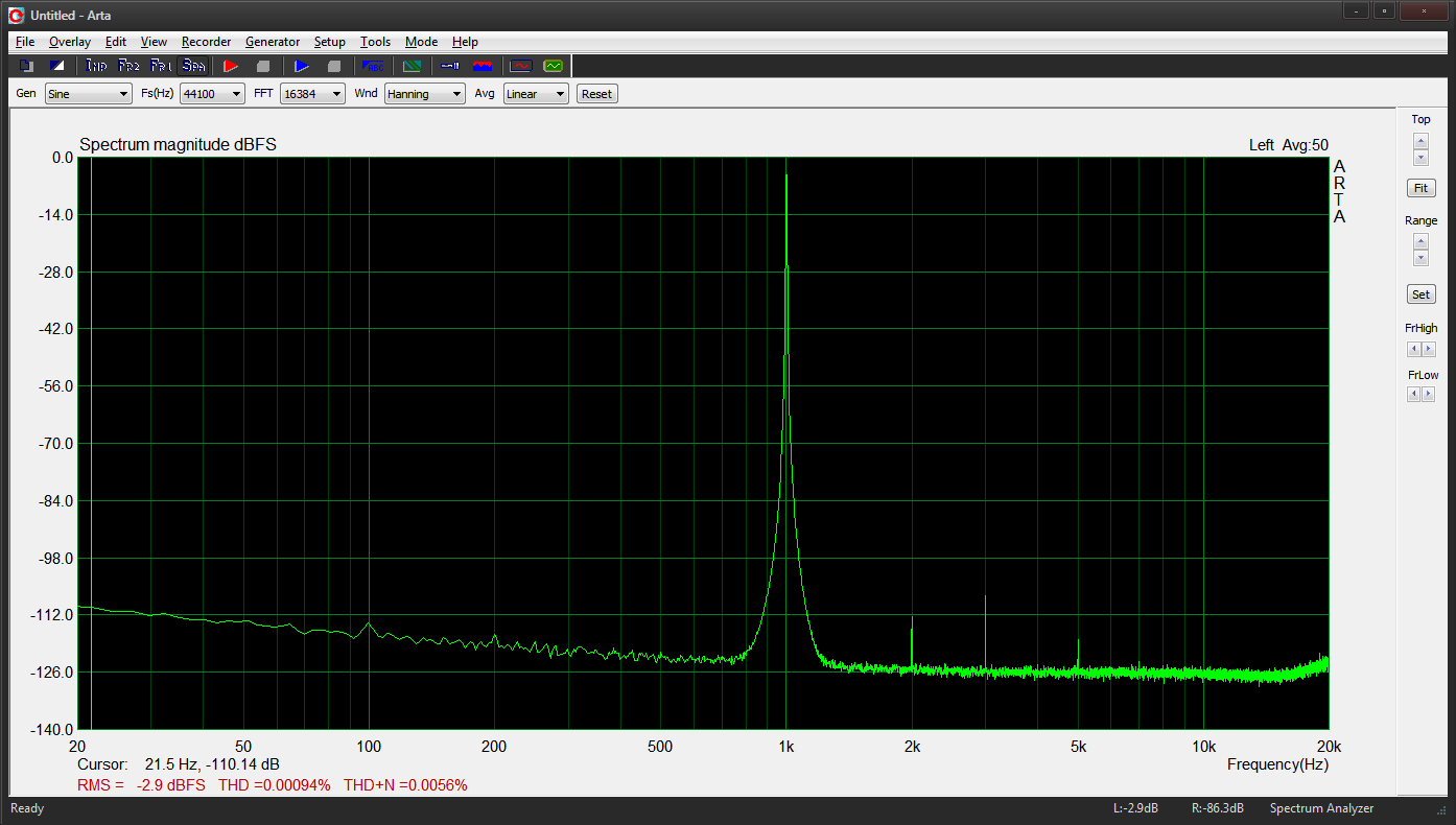

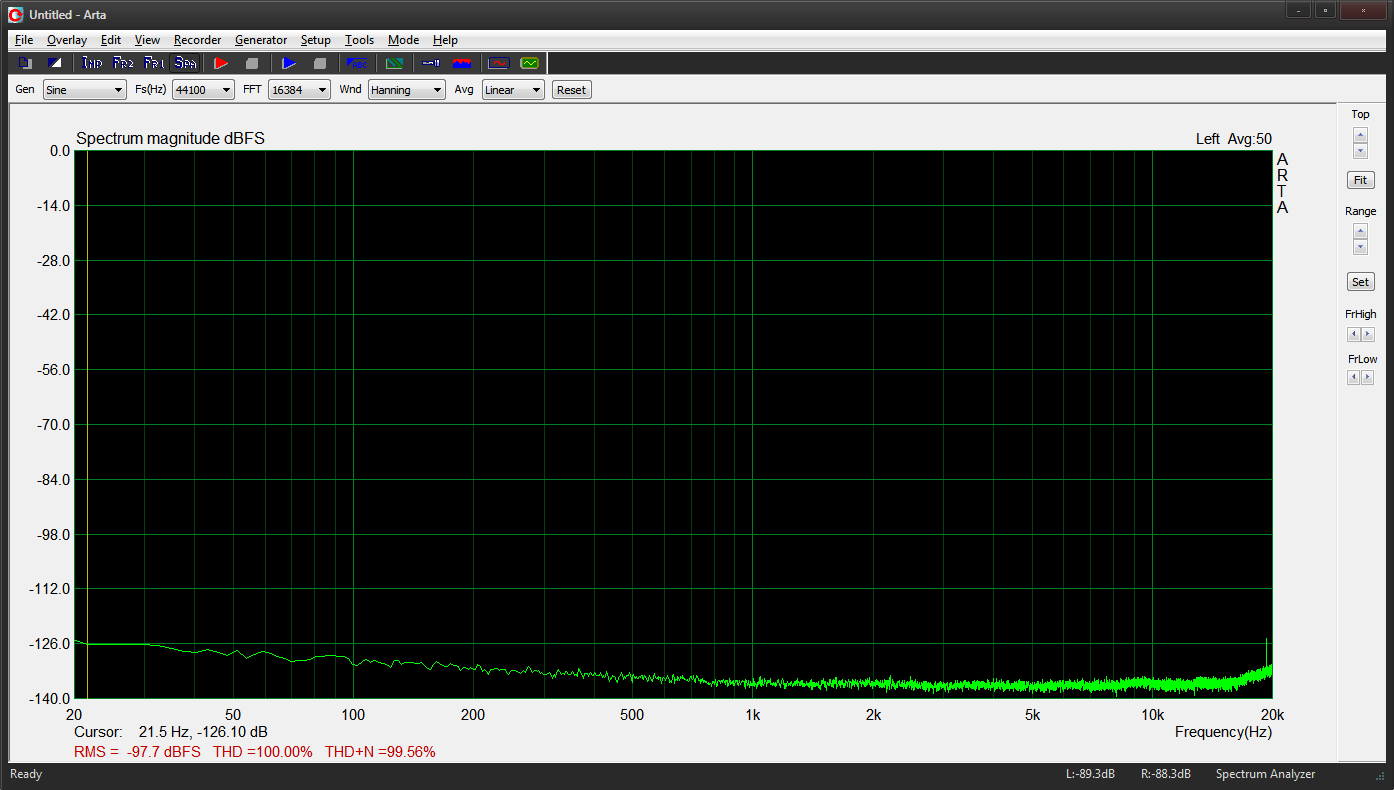

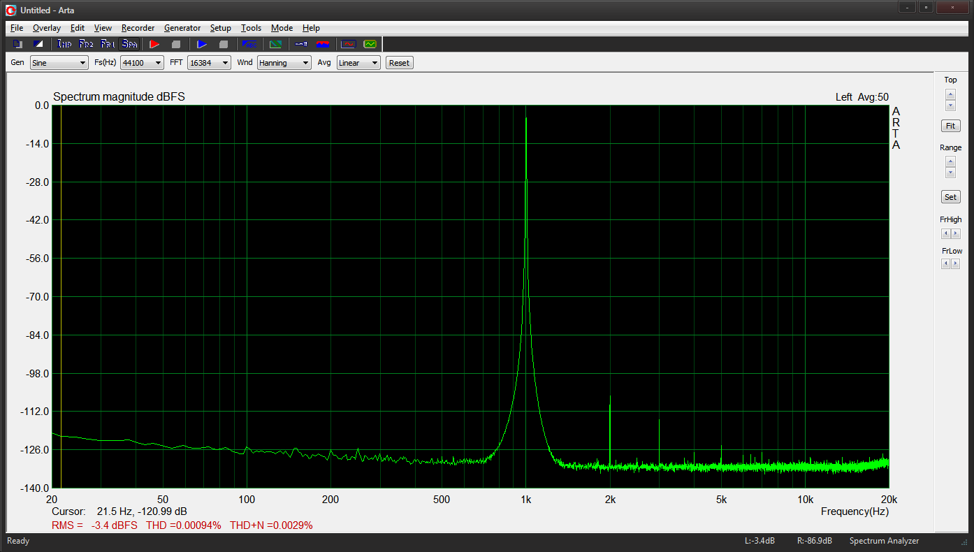

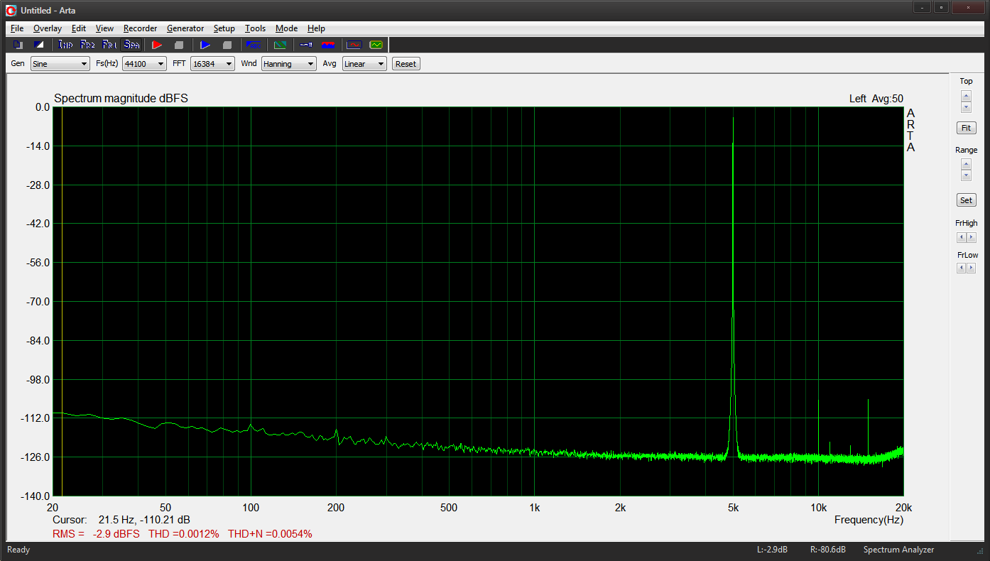

Thanks Richard, here are some more measurements that show great performance again. Those were taken at full gain (x4), so the noise floor of the soundcard is raised a bit. See the measurement with input shorted to appreciate the real noise floor. The headphone amplifier was powered with a sulzer type regulator.
Amplifier output load is 1kOhms. Performance is a bit worse at 30Ohms, because I forgot to adjust R9 with low impedance load... I will have to look into it.
All measurements were taken with the M-Audio Firewire Audiophile soundcard. They are linear averaged over 50 samples.
1. M-audio soundcard noise floor
2. M-audio soundcard loop-out 1kHz FFT at aprox. 0.75V
3. Marsh headphone amp noise floor (input shorted)
4. Marsh headphone amp 1kHz FFT at aprox. 0.75V
5. Marsh headphone amp 5kHz FFT at aprox. 0.75V
Can you use a notch filter on your ADC input to get more accuracy in the sub- 100-110dB area?
I think you are working up against the ADC measuring system and also need a cleaner input sine wave to get accurate harmonic measurement.
Your amp measured results shows others it can be done by someone other than myself and get great results. Next? Music listening?
