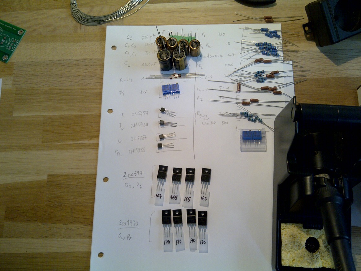

Output transistors

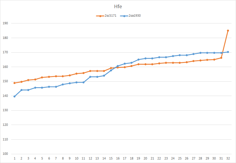

I wanted to try 2sc5171/2sa1930 transistors pairs for the output stage, as they have great characteristics, and are available on Mouser.
I am pleasantly surprised with the results: the whole batch has an Hfe within 10-15%. More importantly, NPN and PNP have very close characteristics (see graph below).
They have clearly become my favourite devices for the job: Beta and Ft is higher than MJE200/MJE210, and they can sustain higher voltage too. Flat Hfe as a function of current.
Really great transistors in my opinion.
The only issue is they have reversed pin, so they must be soldered backwards...

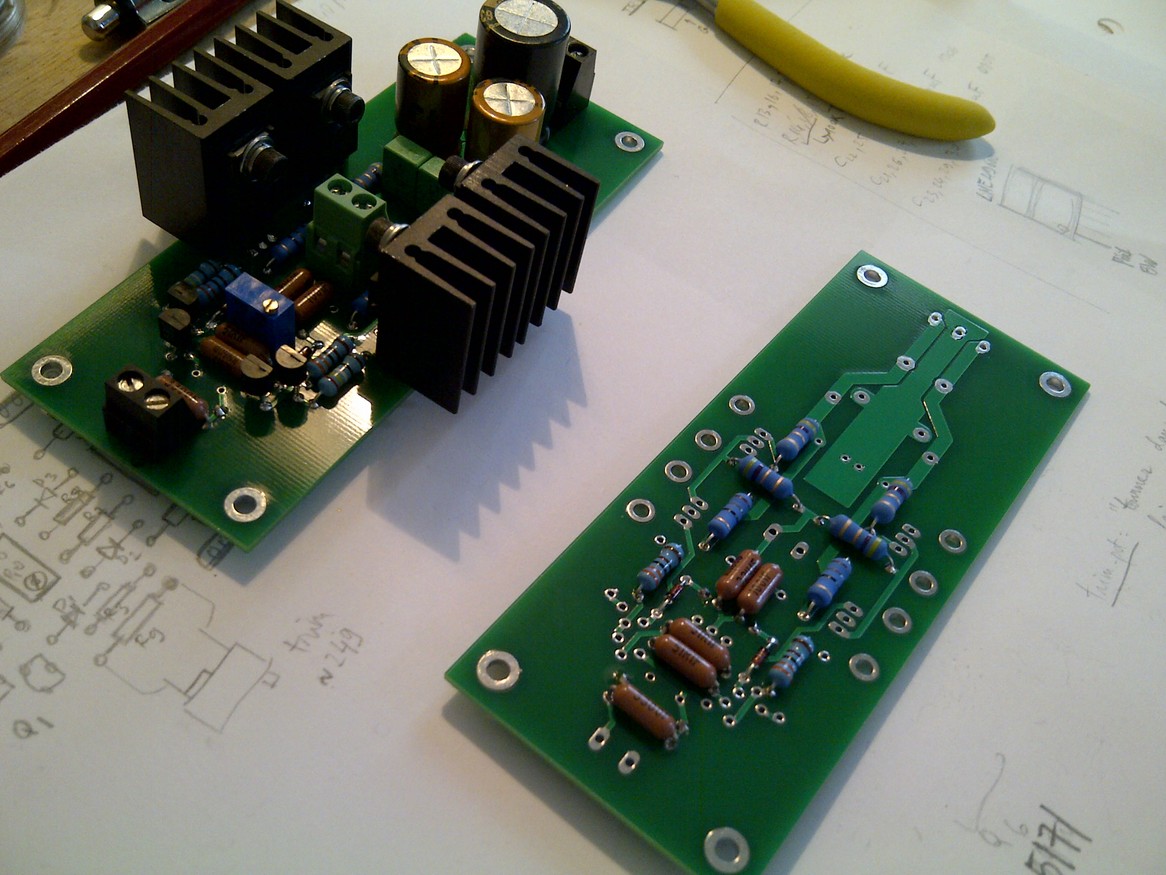

when you flip the board, all transistors will be reversed (except the output transistors, since their pins are already reversed)
Here is a sketch with component placement on the flipped board to prevent errors while soldering:

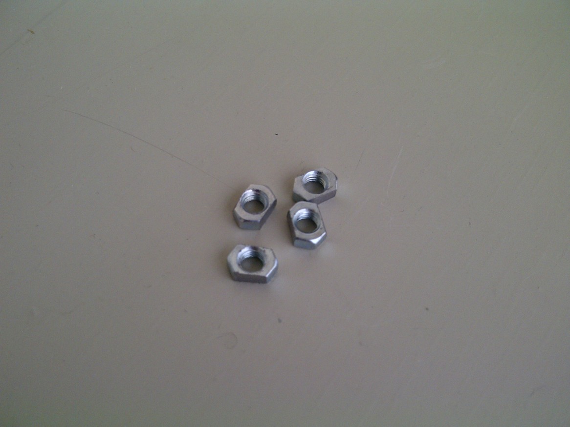

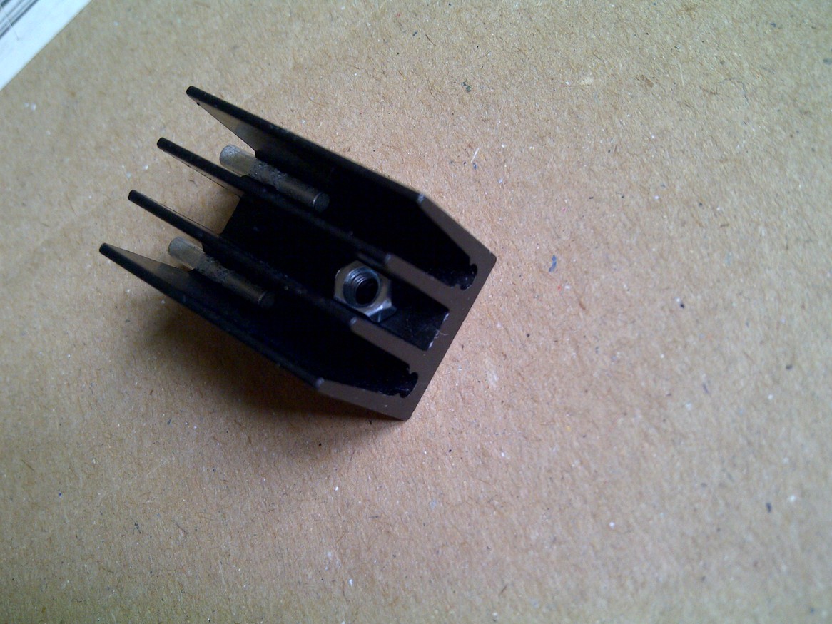

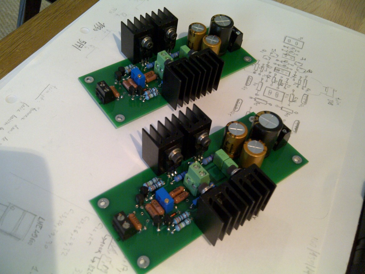

Finally, I managed to finish the assembly of the boards. One issue that I had was the Aavid-Thermalloy 581002B02500G heatsins are #6-32 tapped, which does not fit the to-128 package holes ( - If anyone knows were to find M3 tapped version of those heatsinks, I would be very interested).
The solution I came up with was to file small M3 nuts using a dremel, and fit them on the other side of the sink. That way the transistor can be securely attached with a regular M3 screw. 🙂

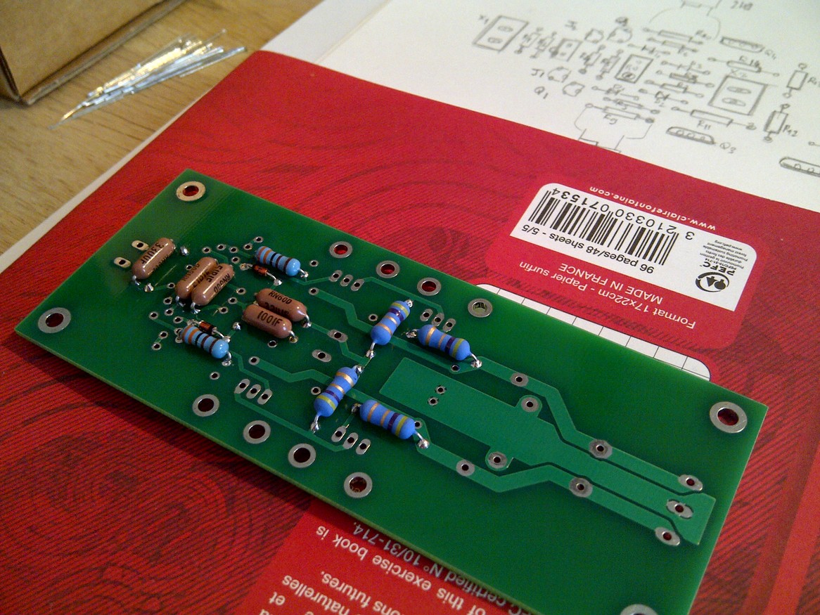

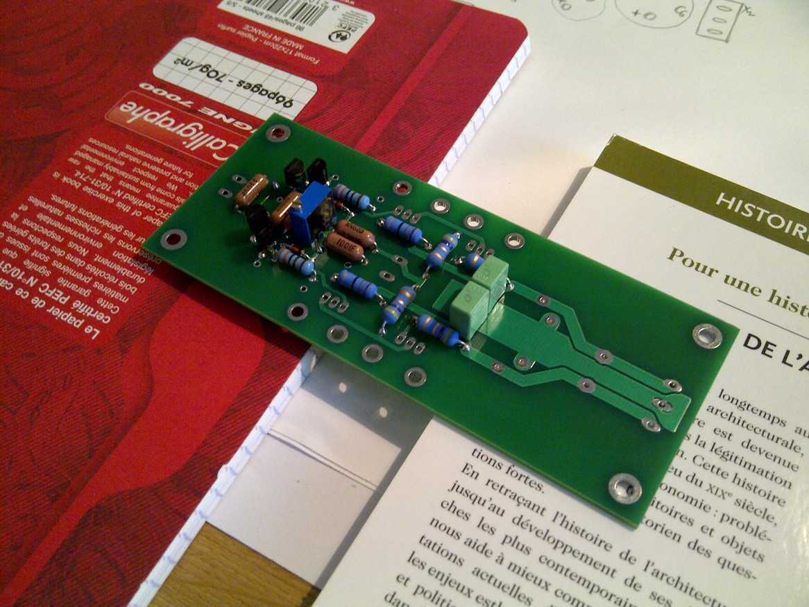

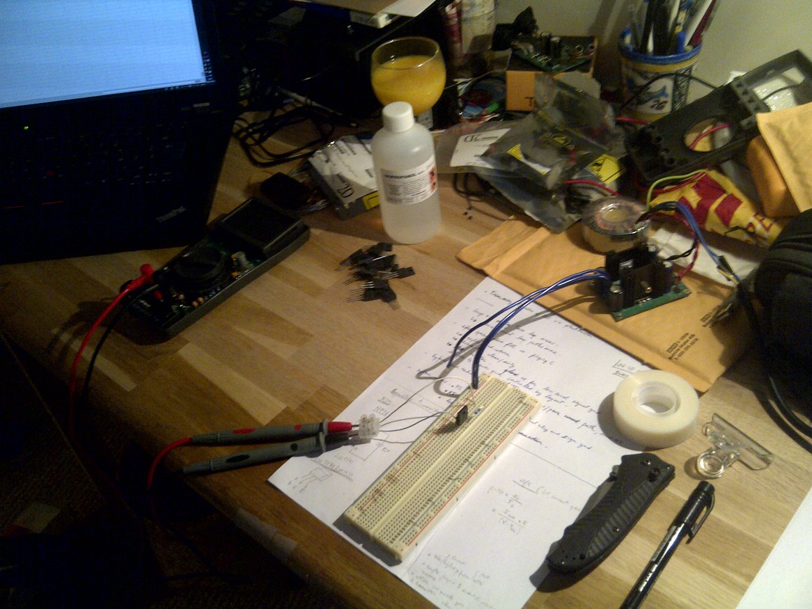

Construction pics...

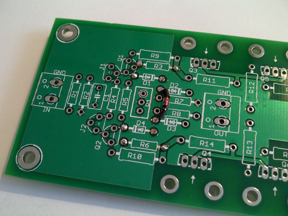

Hi, reason why you mounted that diode in the middle?
Since I use only 3 diodes for the bias, mounting this way reduces the trace length compared to putting a jumper on one diode's place.
Thanks for the pictures and layout sketch, your draughting skills are far better than mine, it's all a bit clearer now. I take it that you are building on the underside of the board in the last four pictures and that the top (correct) side of the board is the one with the center diode on it, picture three? (keeping in mind the transistor CEB pins)
Not sure about that center diode tho do I need to add it? 😕
