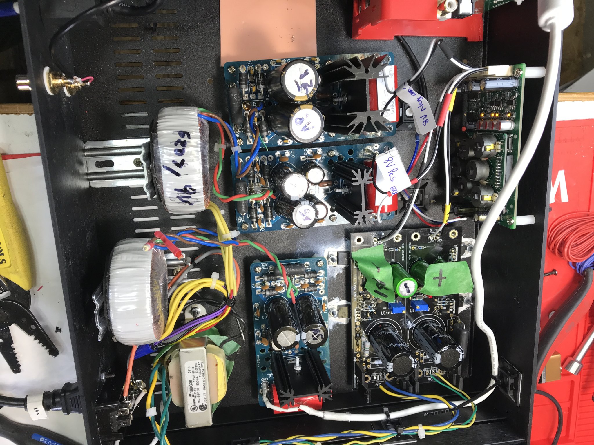

My music player is PiCoreplayer software for all my builds and I use Logitech Music server to subtend all the players. My players are built on the Raspberry Pi SBU. Power supplies are linear or shunt regulated depending on the dac. For the Marriner I have a +/- 18V shunt regulated supply running about 100-125 ma total per rail, for the Dac chips I have a dual linear +/- 8V regulated supply and two 5V linear supplies for the Rpi and asynchronous SPDIF to I2s adapter. Control is through the browser on my ios or android.

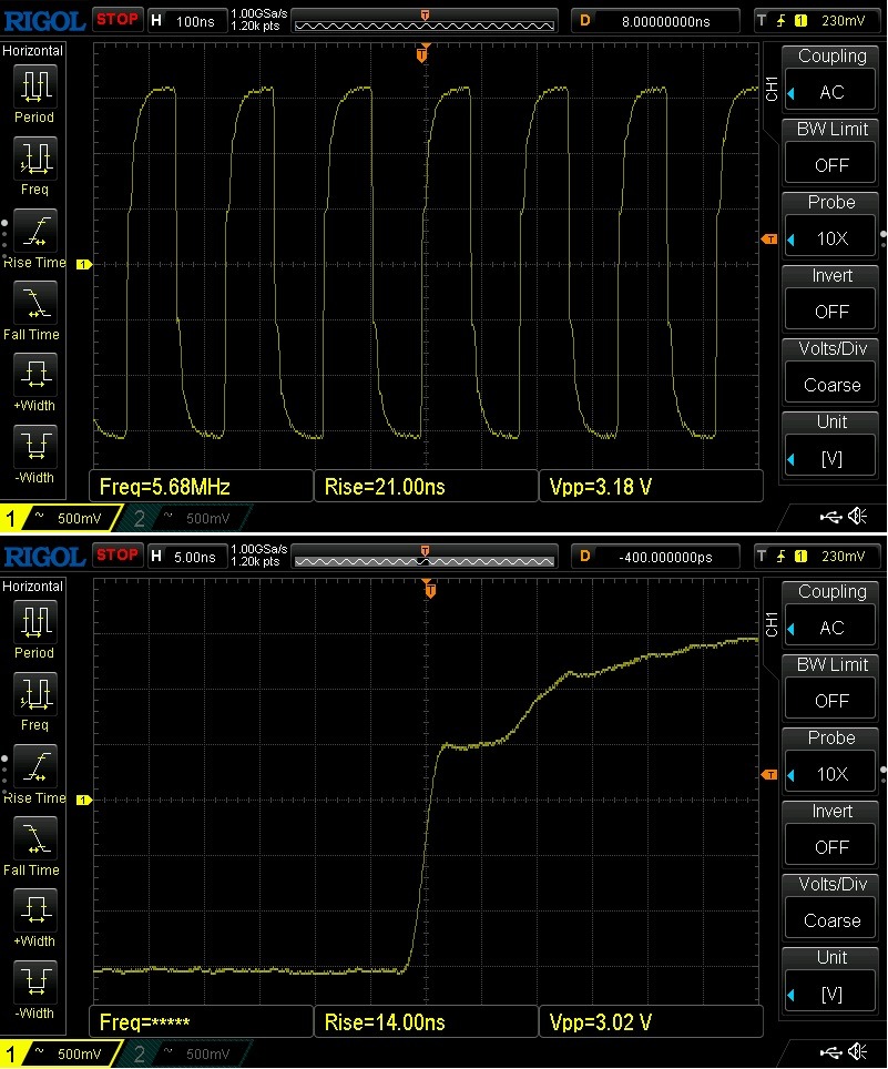

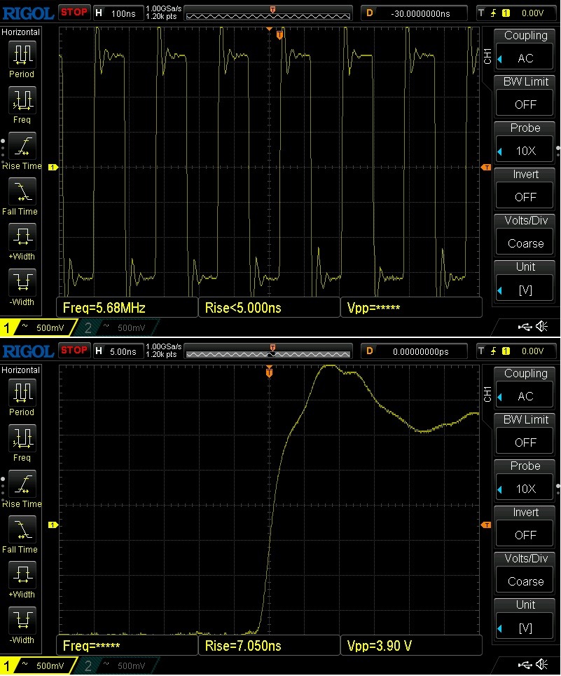

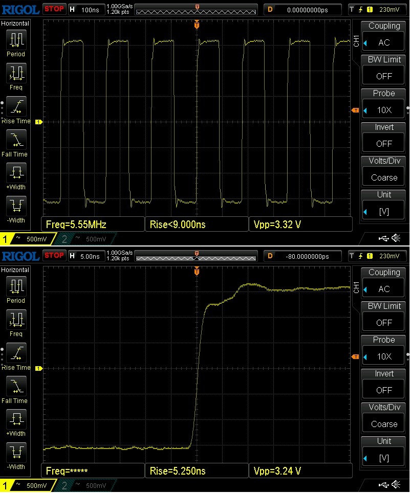

I have noticed that my USB connection now seems more fragile than before
A check of the I2S lines at the DAC input with an oscilloscope may show marginal conditions regarding signal integrity
(here BCK line with different cables)
George

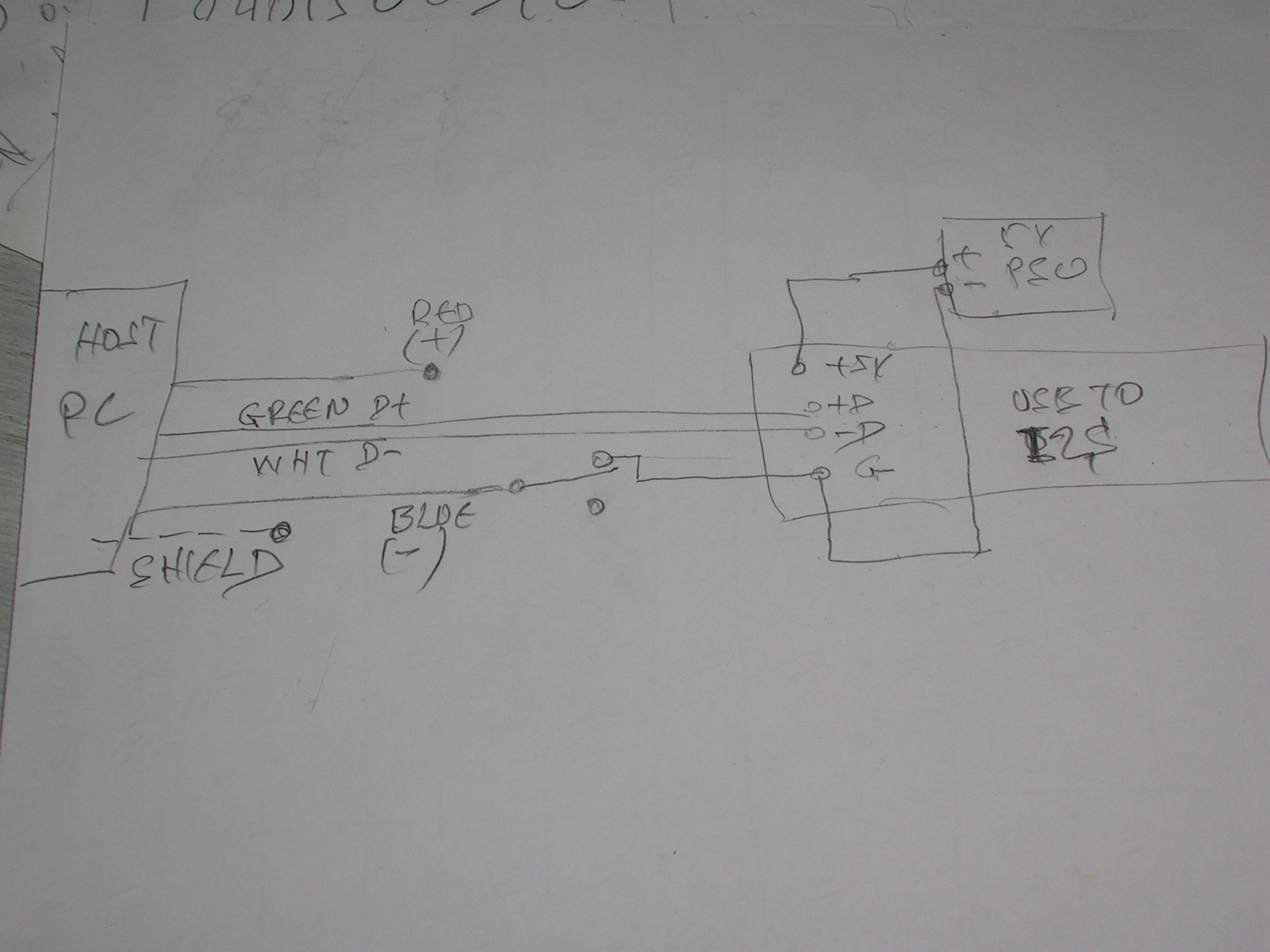

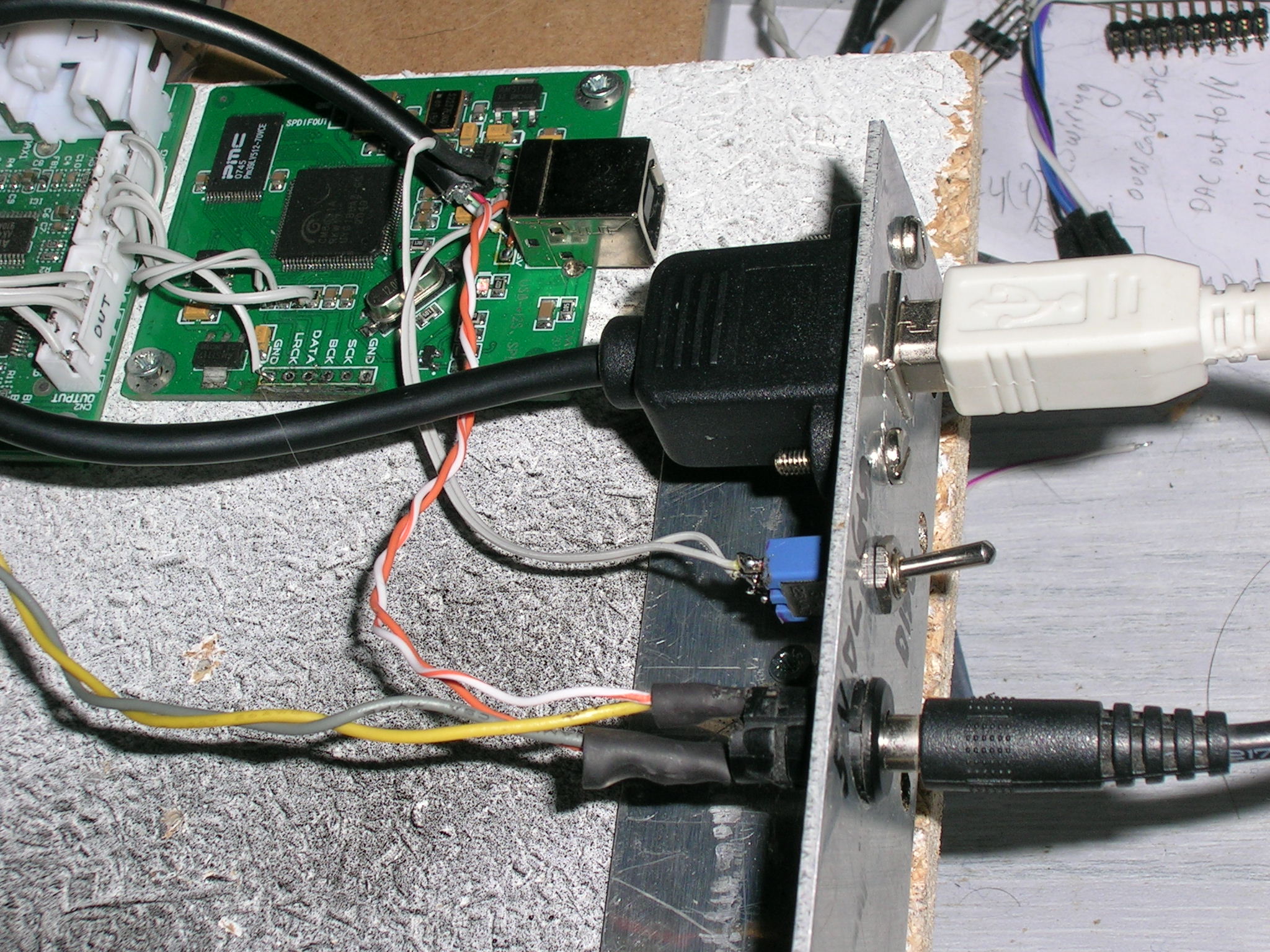

In an ordinary USB connection, not using an isolator, you can disconnect the ground after the USB handshake has taken place & this maybe shows the effect of full ground isolation. In my experience good USB isolators (particularly ones not using DC-DC conversion) bring some more sonic improvement
Great info. I will try it and see if communication still works. Thank you.
George
Reactions: 1 user
The tricky aspect of removing the GND from the USB is there isn't a way to ensure the common-mode voltage at the USB receiver is kept in check. If the receiver's 0V is connected to mains earth then there won't normally be an issue though as the PC's 0V also goes to mains earth.

True. This is always of concern when isolating grounds in a SE audio system, regardless of the way of doing the isolation.
Success or failure is system dependent.
Merill's proposal has the advantage of being simple, almost cost-free and instantly reversible (flip of a switch)
George
Yes, I know in theory this is the case but in practice it has never failed to work and never caused any damage to USB receiver or sender.
As George says, it is also possible to do A/B testing on the fly
