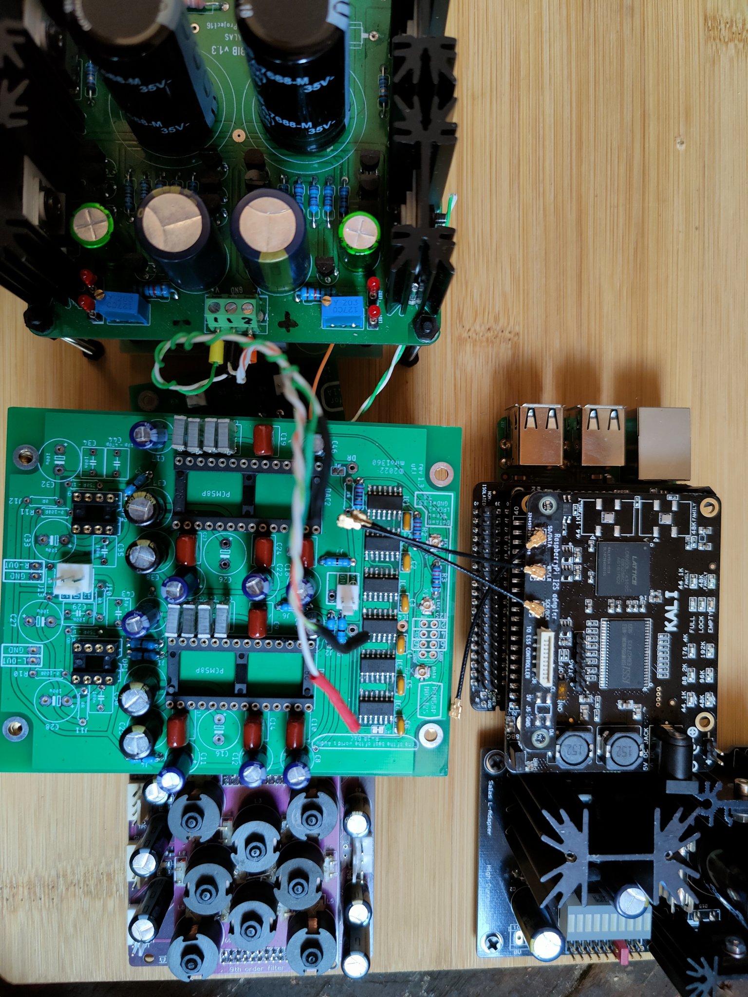

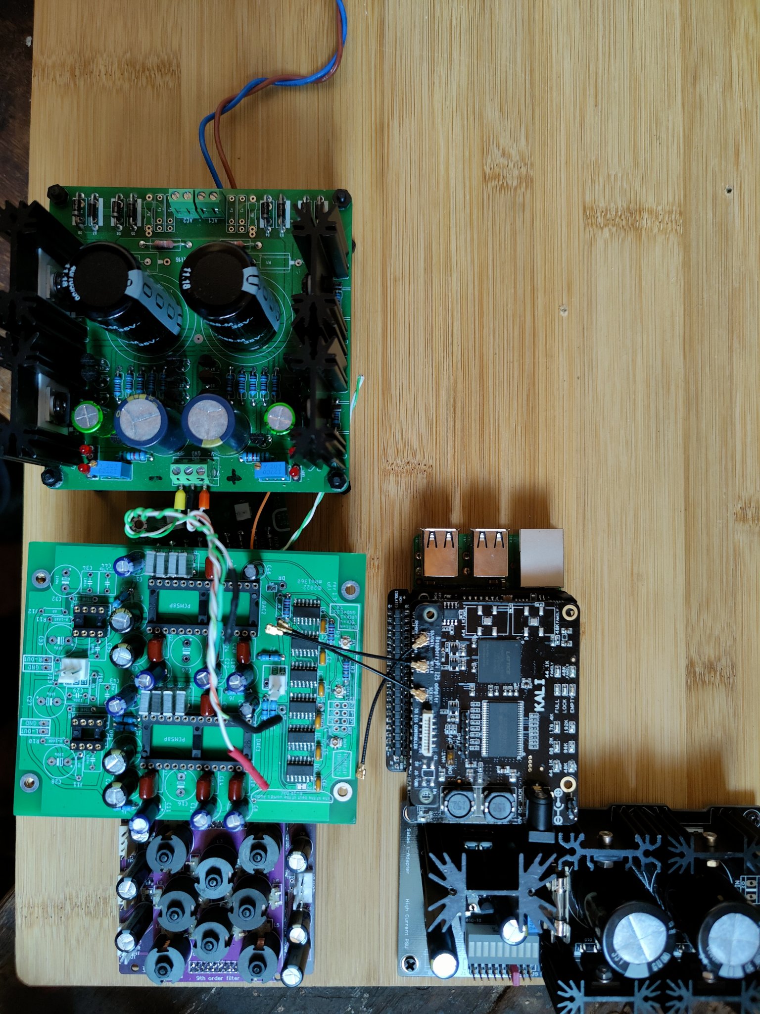

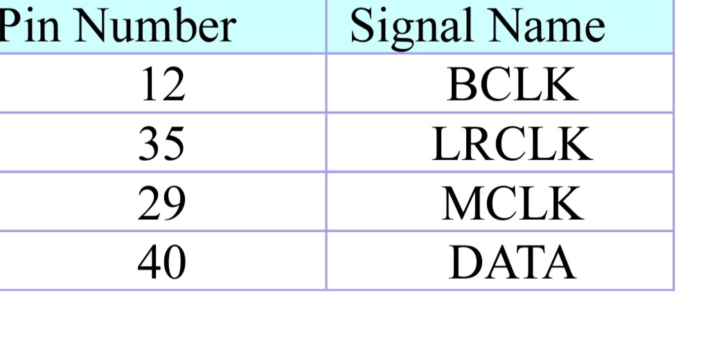

Hi, I want to use the marriner with a rpi4 streamer. Should I use the GPIO header on the rpi4 to get I2S?
I remember reading that rpi boards create interference. Is it ok to put the rpi in the same enclosure (on the other side ~30cm distance) or is a greater distance advisable?
Is there a preferred wiring/shielding to use for I2S? I saw that cat5 RJ45 can be used for interconnects. Or USB?

I think yes, there's I2S coming out of the header on RPis. I have been able to find the pinouts online in the past, just bear in mind there may be confusion between logical (GPIOXX) numbering and physical pin numbering on the 40way connector.
All CPUs are interference generators, I have had issues putting an early DAC design in the same box as an STM32F4 which runs at a much lower clock frequency than the RPi. As I have no direct experience of putting my DACs near to an RPi I can only suggest further away is going to be better, it could be that 30cm is enough but I'm out of my depth speculating on that. Screening would also be a useful option. Without an extra I2S interface board (I2S over LVDS) I'd hesitate to suggest an I2S cable longer than 30cm. Yes, twisted pairs can be used for I2S, but unnecessary for shorter distances, no experience to offer there though.
I was going to suggest that if you needed a greater distance between RPi and DAC that an S/PDIF connection might be the simplest choice. But LVDS would be another possibility, I don't know if there are any RPi hats that output I2S over LVDS. USB of course would be a third option, at least that's an interface already supported by RPis.

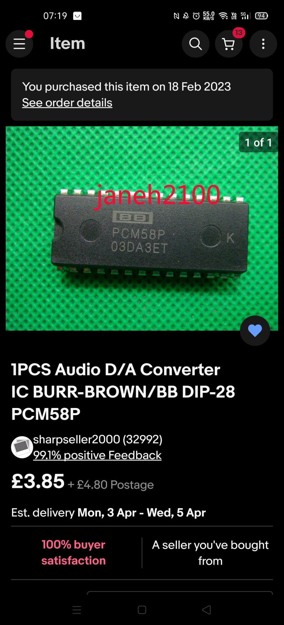

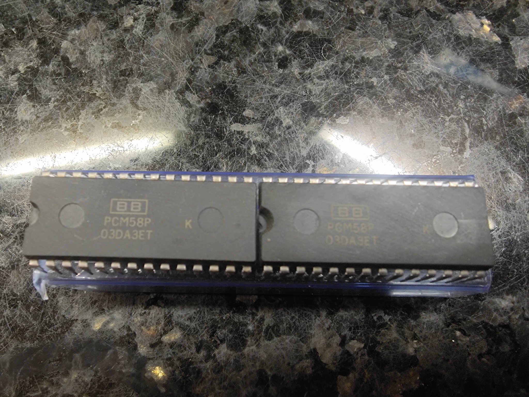

Slowly building 'the thing ' up so not tested yet Richard. Definitely suspect on those I linked to in the other thread .
Here are my assumed good ones from a reputable UK seller who is a vendor of ex military stock.
Here is an image of what I bought on eBay from the sellers page.
Here is what they looked like on arrival.. 😄😁.
Still got my PCM56 from 'polida' to check
