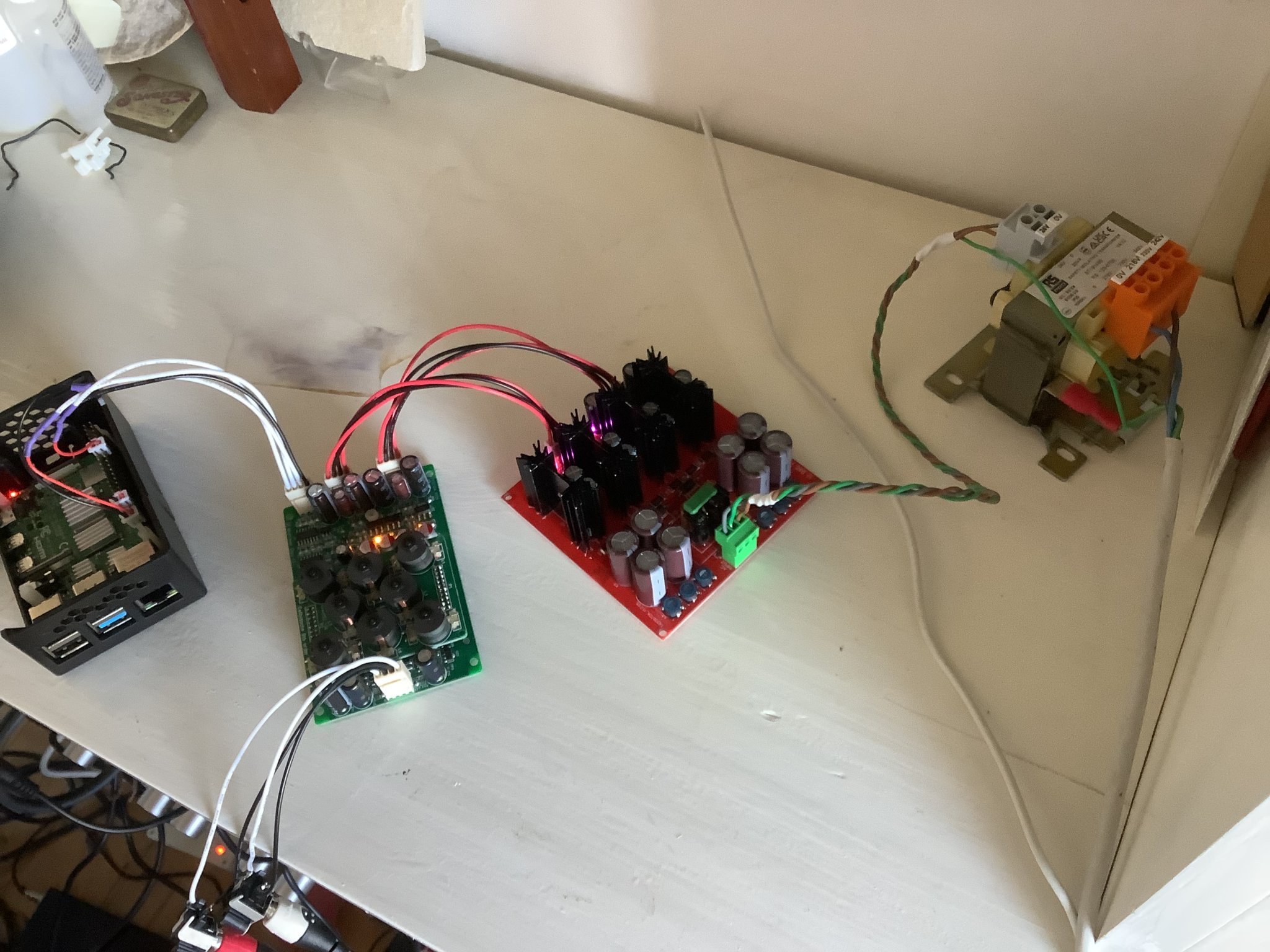

Thanks for the tip. Will it work with Rpi4? to implement it do you need to configure the Rpi or is it plug and play? would you put the rpi4 and dac in the same enclosure? HenryAwesome!
@henryyyy taking i2s straight from the Roi is suboptimal but will work. Look to get yourself an i2s isolator. (Ian Canada) . And then you get into the whole relocking malarkey. But serious gains come from all that.
Quick answer so as not to pollute Richards thread.
*Yes I assume so as Rpi GPIO pins didn't change from 3 to 4?
*Depending on what software then you probably choose generic I2s DAC.
*Many will tell you to keep i2s lines as short as possible.. . precluding the DAC in a seperate box. This is where the i2s over hdmi as LVDS can come in as Richard mentioned. I believe i2s as a non consumer level protocol was never meant to be transmitted down cable of any length, instead all at PCB and chip level. I have short i2s connections and DAC and Rpi pretty close. No problems

I hooked the marriner today and it sounds great. I use a squeeze box player and setting to Rpi Dac seems to activate the GPIO pins for IS2. I am Thinking about the isolator below, but what do you mean by relocating malarkey Jimk?
Nice work Henry. Sorry we both have typos in there...! I meant reclocking. It's something to do with the clock on the Rpi not being of a divisible frequency for audio..or something. And also the i2s direct from Rpi are deemed noisy or jittery or something.
An Ian Canada Isolator, or Fifo, or an Allo Kali are the sorts of bits of kit to help there. And I can say first hand that they do make a difference. All needing decent power supplies of course.
Thanks Jim. I am a novice at this, but I am not convinced. The isolator board seems to provide clean power, clock and ground. But the marriner has its own power and clock. Isolating the ground can be done with a few passive components. Perhaps isolators are for other dac applications?
