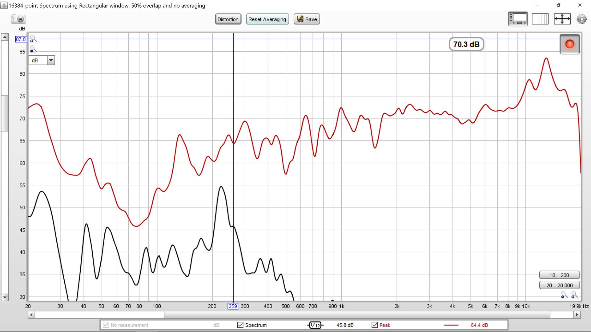

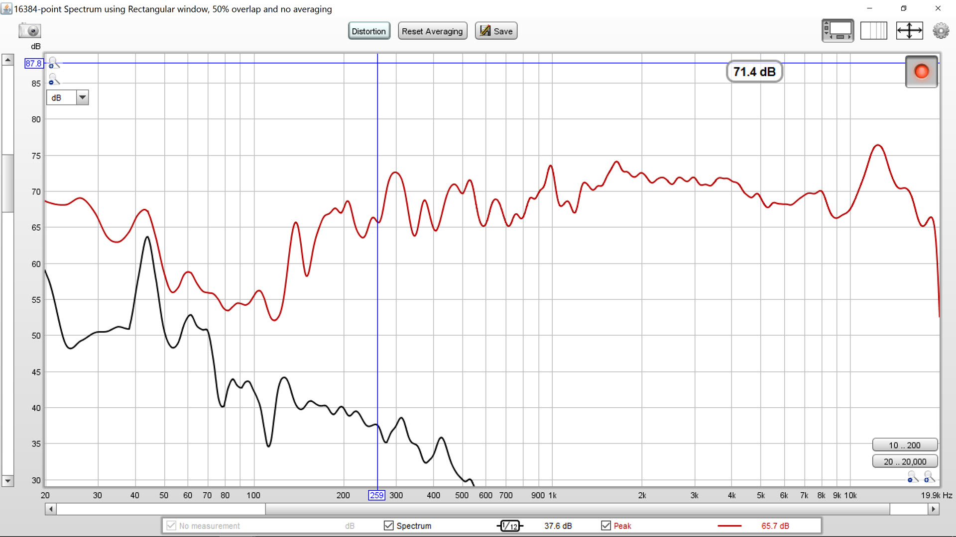

Here's a replot of the 7MS FR using 1/12 octave.

BTW those tests were done with no EQ, linear sweep was from 100Hz - 20kHz... The 7MS's are back in their box. Waiting... I took this time to put the 1 actively powered/EQ'd sub in the SPDIF loop. Also, double checked every enclosure for proper wiring polarity and fiberglass stuffing. This was a little tangent of a project, measuring the 7MS's, and it was well worth the time.

Question: why are you capturing from REW's RTA instead of using the built-in measurement system?
The latter produces a swept sine tone, and spits out frequency response, phase, distortion, and a bunch of other useful (derived) stuff like waterfalls, impulse, group delay curves, etc etc.
Chris
Chris
I would if I knew how. I'm not very experienced with REW yet.
