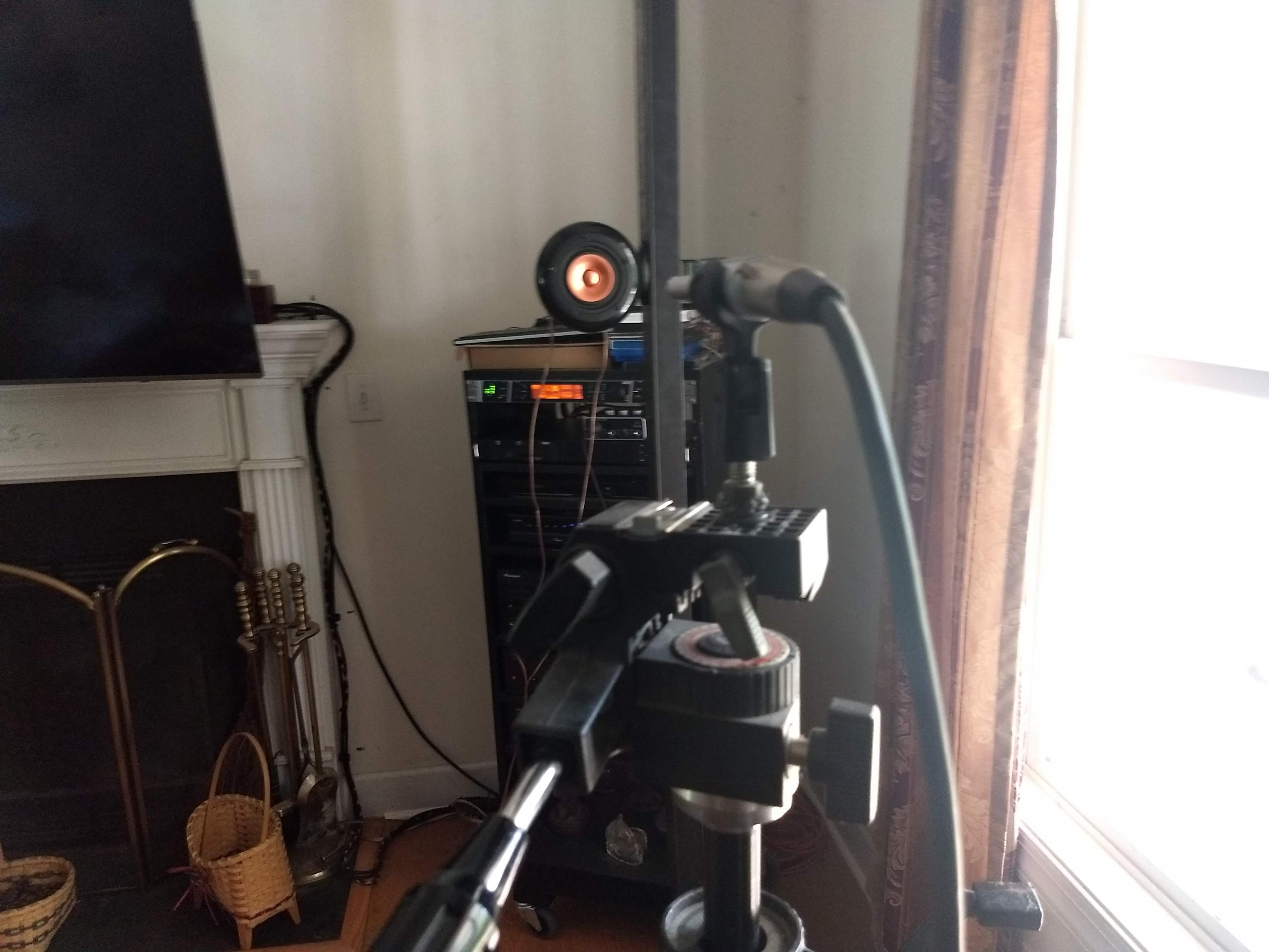

Have you got a boom arm for the tripod? I find such a bulky mechanism to hold a mic causes some squiggly bits in the reading. I normally hang mine from fishing wire which means I can get the mic stand stuff out of the picture a bit more. Looking forward to seeing the off axis, I've never been able to do it well enough to have repeatable results. Some sort of turntable with the acoustic centre marked would be best I suppose but then if I was going to those lengths I'd not be happy with domestic gated measurements either.
outdoors (if noise and wind/weather permit) works well. A plastic turntable marked 0-15-30-45 degrees is cheap/repeatable. (I've moved the mic in an arc before)
with my Karlson stuff, the mic could not alone discern much with aperture changes - probably due to a large source and perhaps varying time arrivals which can be easily heard but not seen/"understood" in a single mic point. Your little direct radiator should be easier in that regard. Your report will be interesting.
I'll try to be as objective as possible, but I'm afraid it will be nowhere anechoic. I have vinyl floors and a relatively small 15ft x 20ft listening room. Consider everything I post an 'approximation'. It's one reason I added 'subjective' to the title...
For the 0deg FR measurement, my technique will be placing the tip of the mic 1 meter direct and level in front of each driver cone and double check the SPL with a calibrated mic plugged into my cell phone using an App. Once it reads 86dB, I should be close to 1Watt. I'm assuming the Markaudio datasheets are correct.

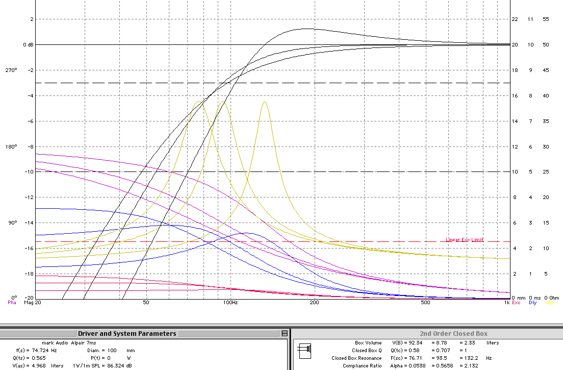

Here's a few pics of the enclosures I'm using. They're .1cuft or ~3litres. The rolloff should start at about 150Hz for the P7's. Not sure of the rolloff of the 7MS's? Had a real long day at work... FR measurements will start tomorrow!

Thanks Dave, looks identical to the P7. The P7's and 7MS's will be cutoff @150Hz after I do the initial tests.

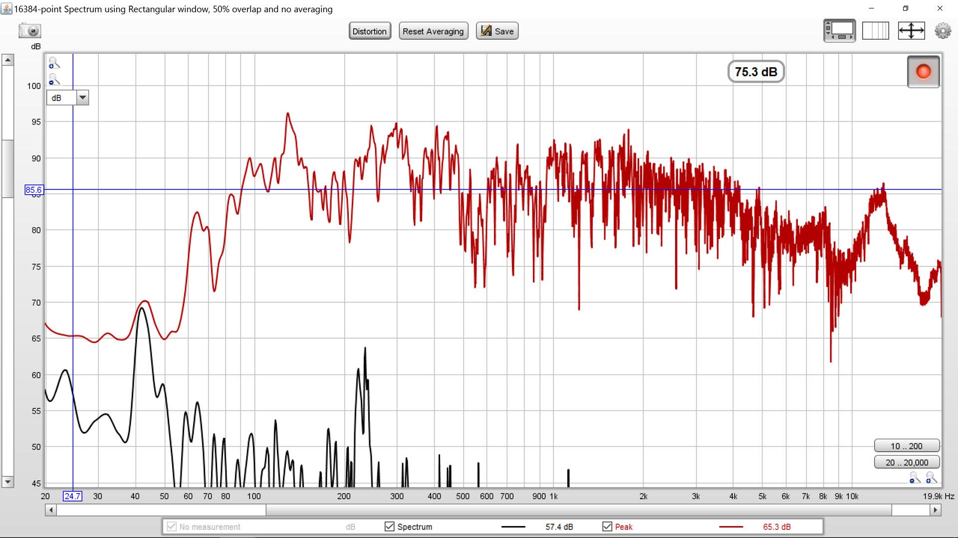

Then I ran some Log sweep tests and white noise FR tests with the mic 3ft away from the right side driver. Left side driver was not connected.
So if you look at both FR plots above they pretty much jive with Markaudio's datasheet: Hump @ 120Hz, dip @ 500Hz, dip @ 9-10kHz, and peak @12kHz...

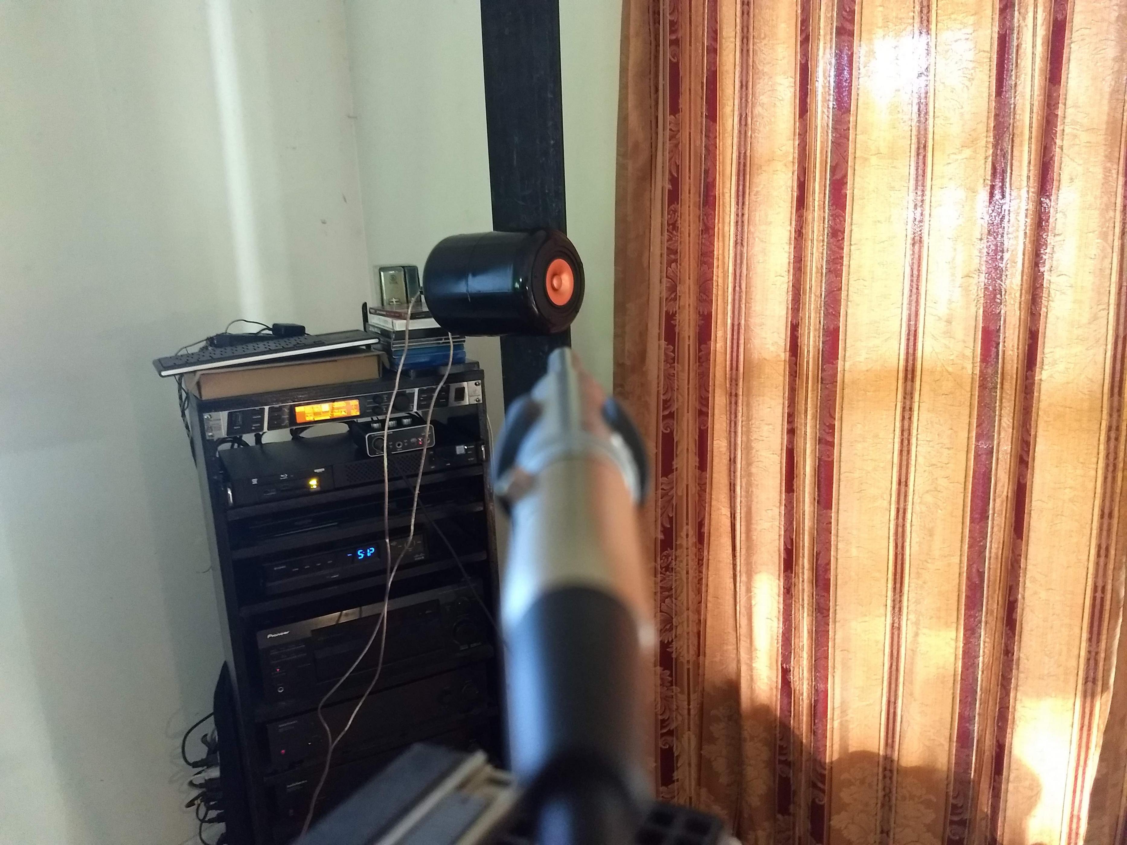

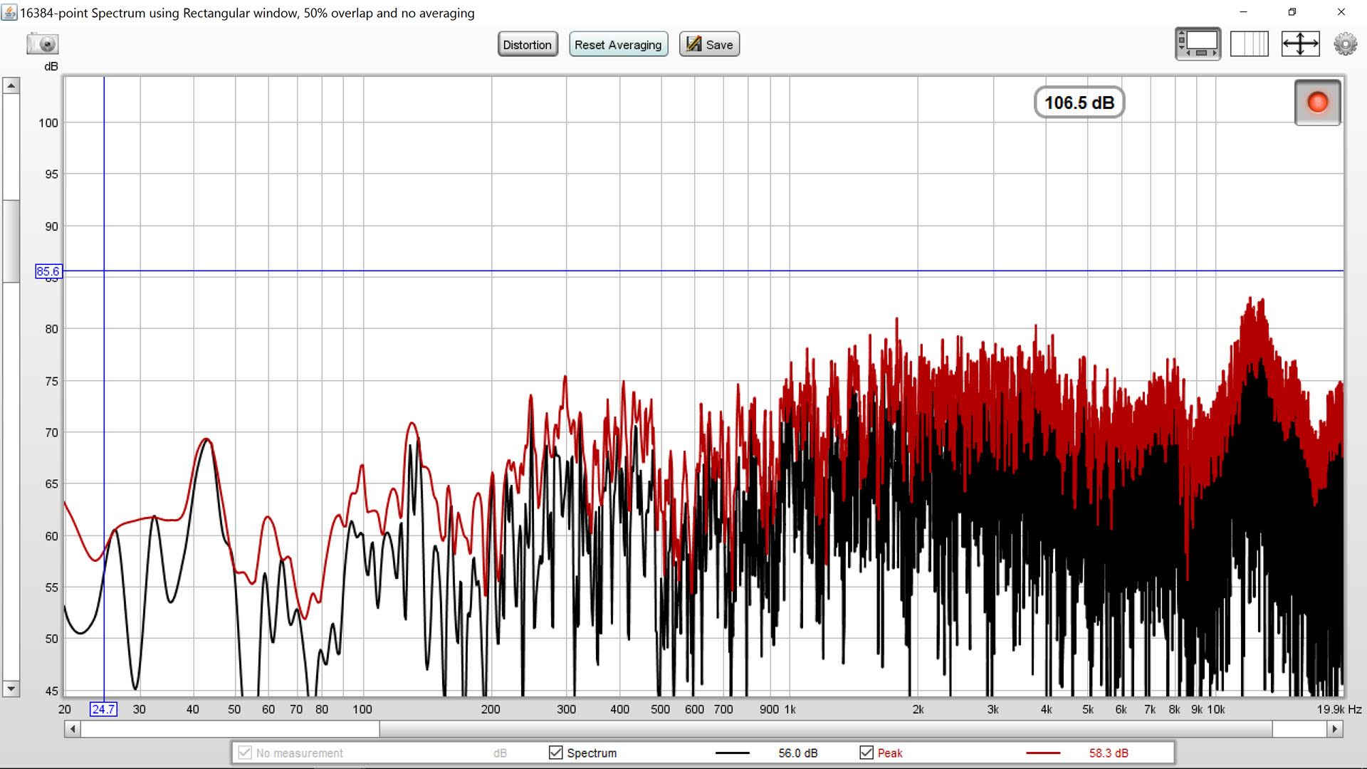

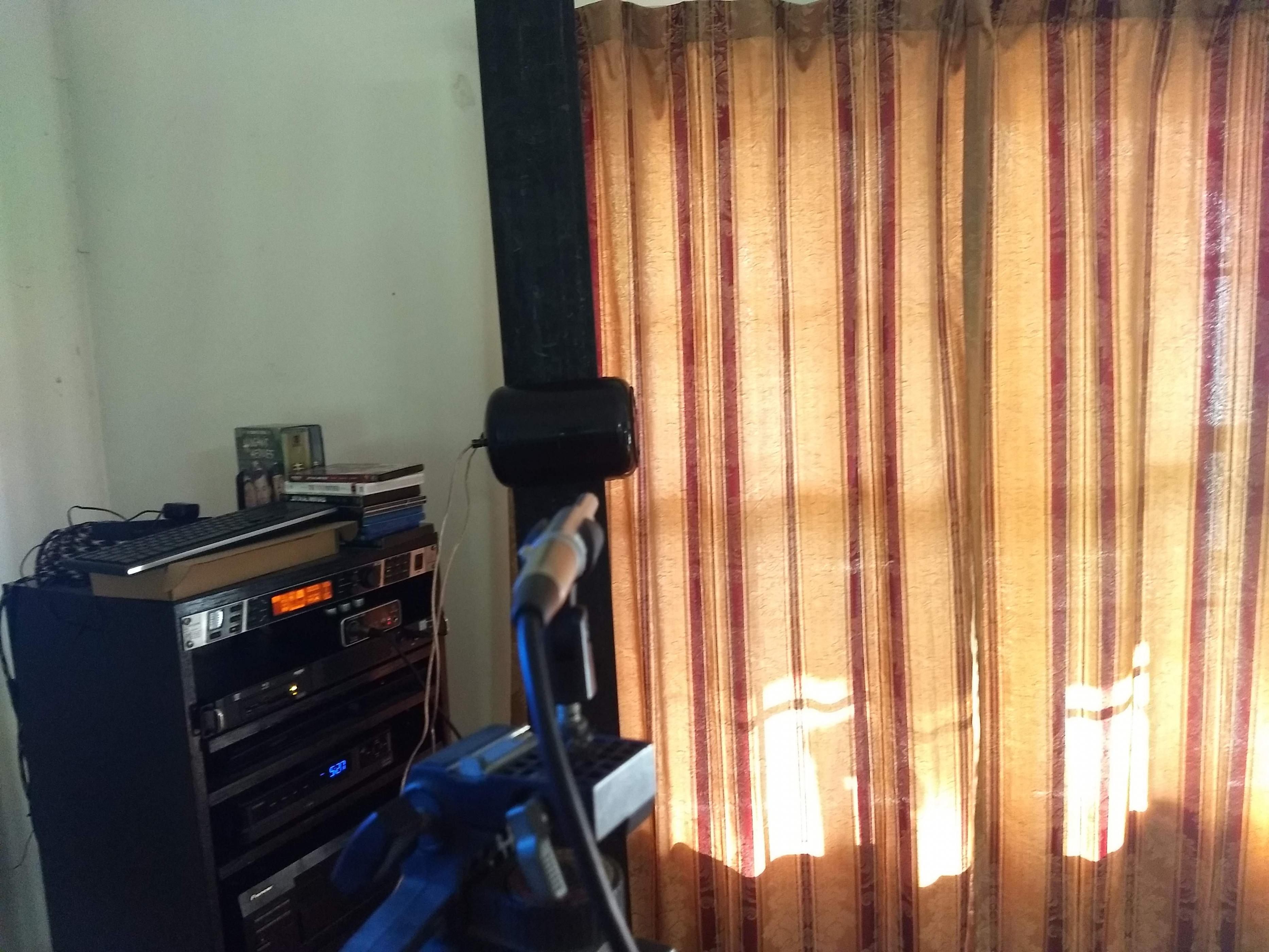

I chose a linear Sin Wave Sweep this time as it reveals more on the top end, 100Hz-20kHz sweep at 15deg, 30deg, 45deg & 90deg off horizontal axis. Very impressive results for the 7MS IMO. As expected.
