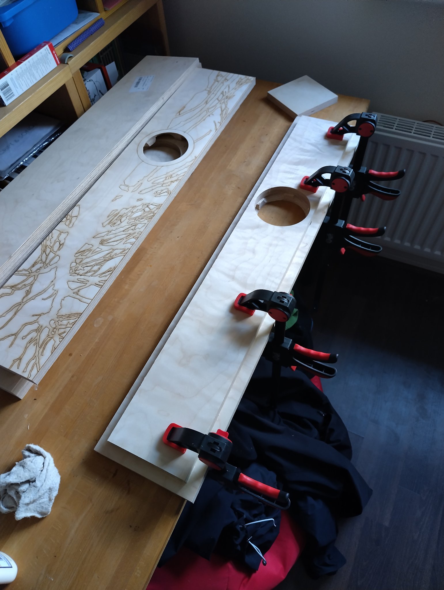

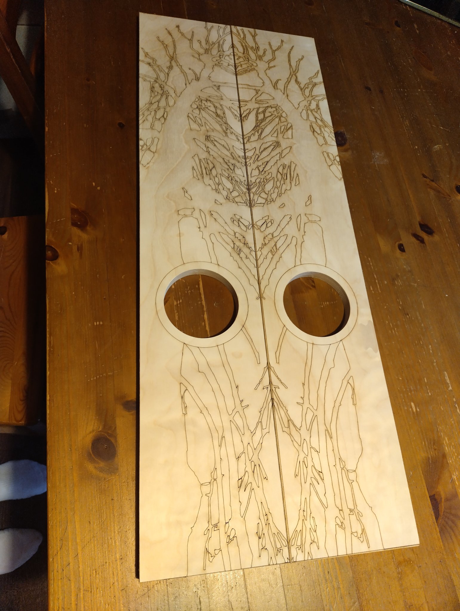

Since I do not have a workshop I ordered my plywood (18mm baltic birch) pre-cut online from cutmy.co.uk. I could even specify the circular cut-outs for the drivers and the reflex tube. Here is what came in the package:

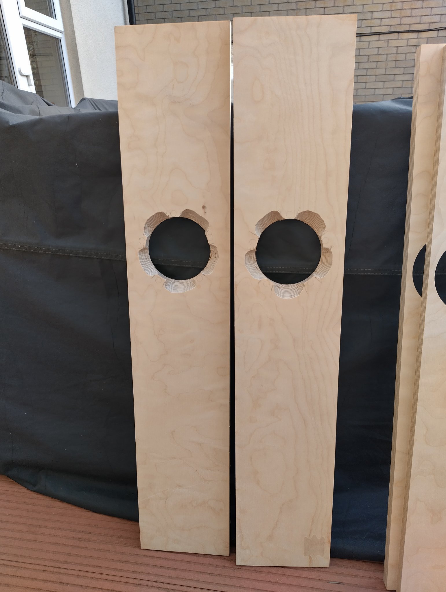

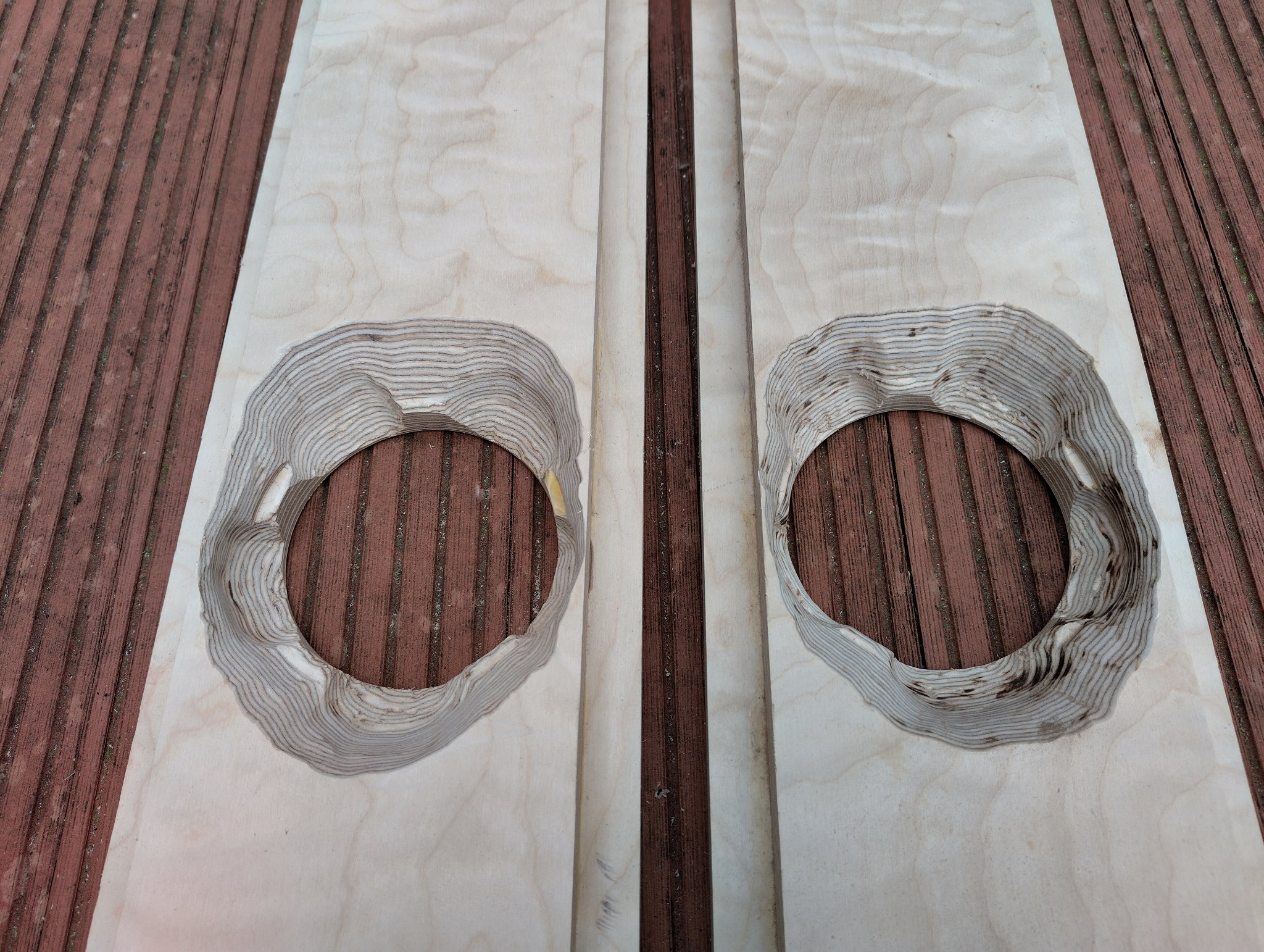

Thanks. I am still working at it and I will post pictures here of the different stages. Next stage for me was the chamfering of the holes for the driver. I used my Dremel tool for that. The results turned out a bit irregular.

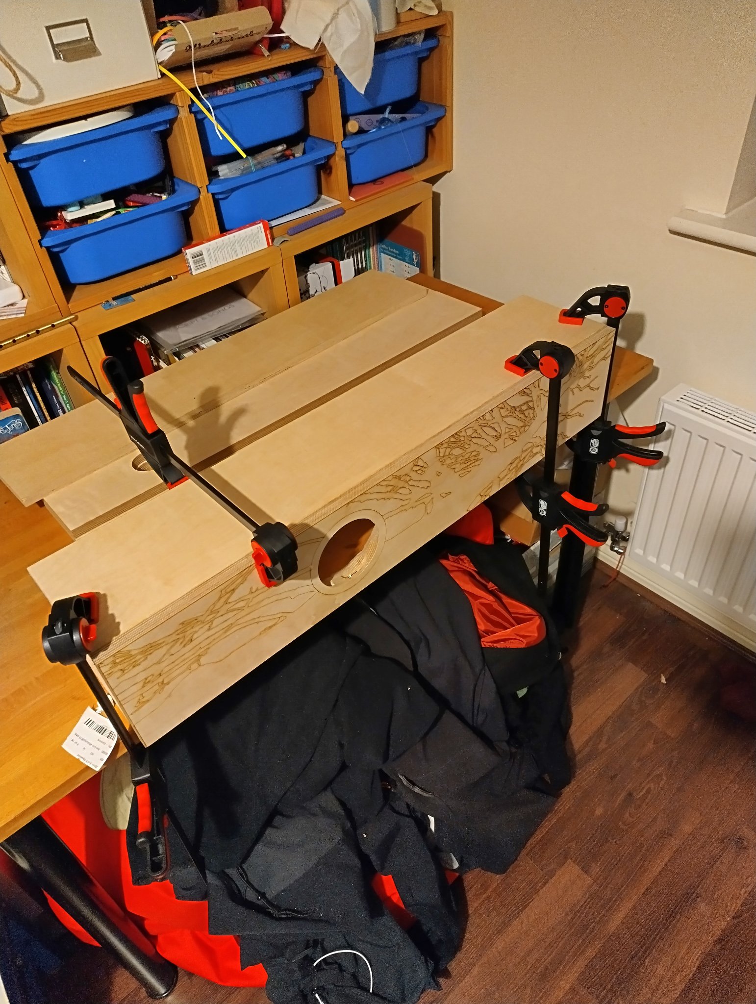

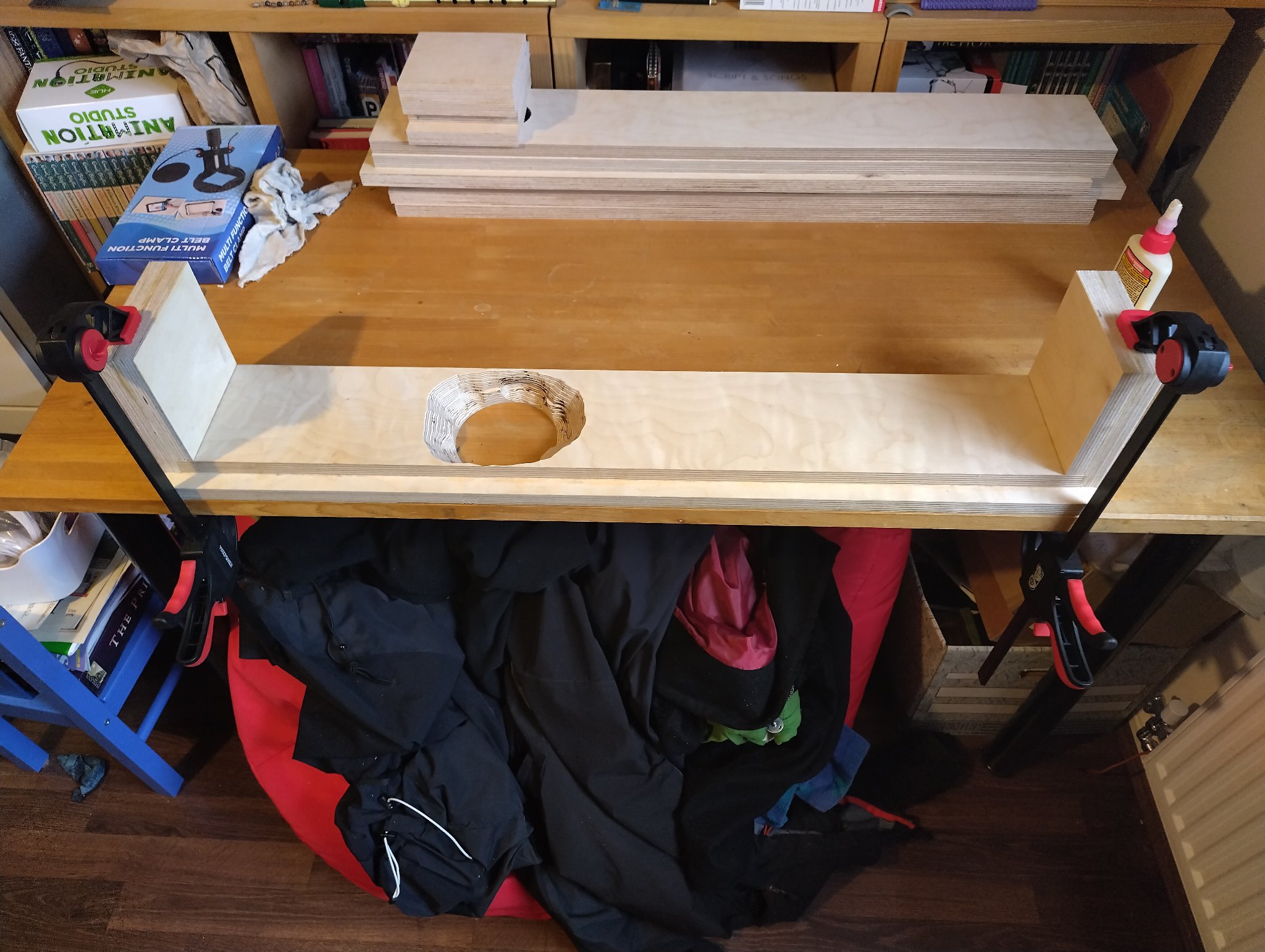

A more interesting challenge was the second layer of the baffle. The inside of the enclosure is quite narrow, so a 45deg chamfer is not possible towards the sides. I first glued the second layer baffle to the outer layer.
And then used the Dremel tool again. The sides of the holes became quite thin.

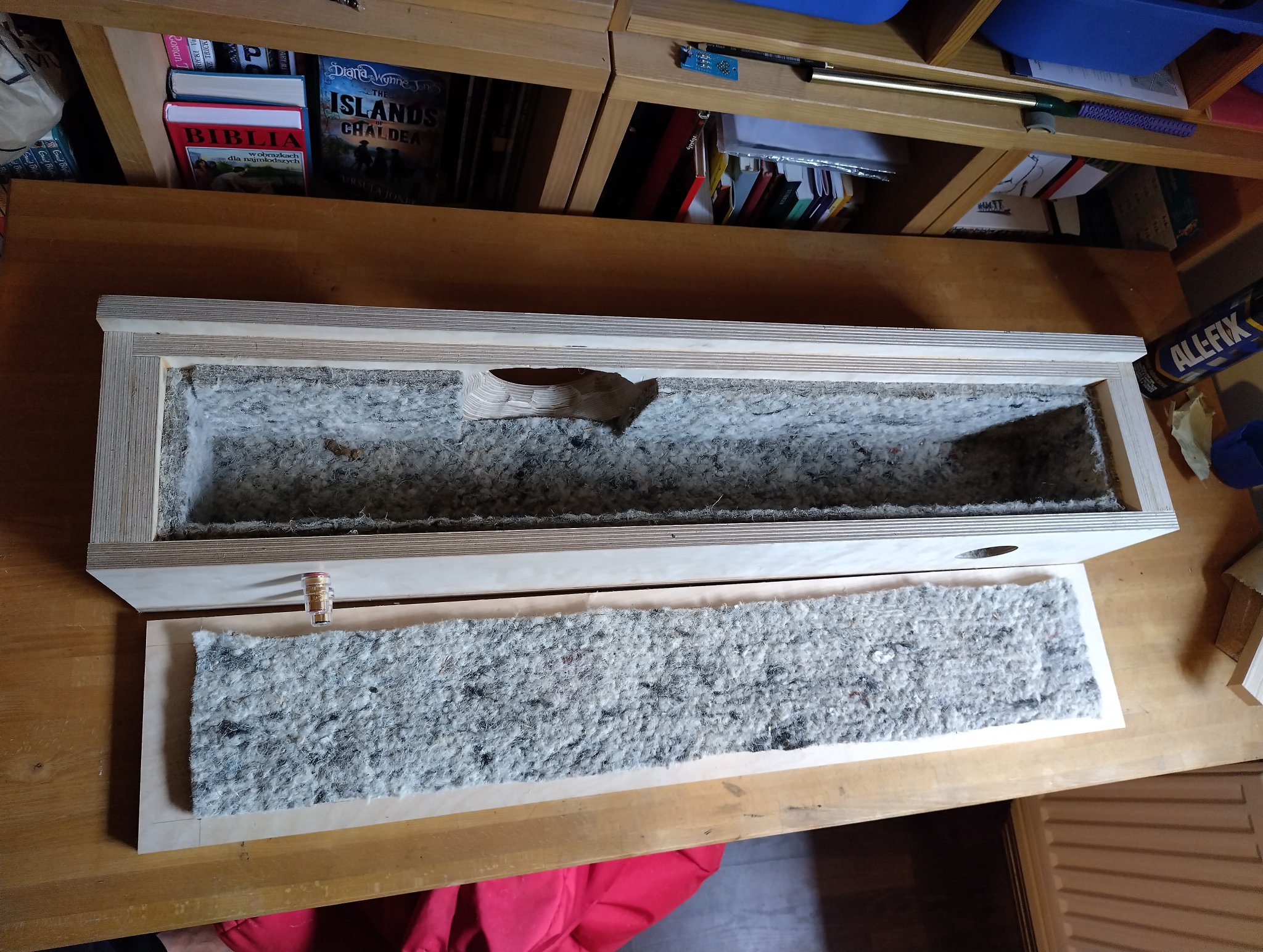

A few more steps towards a working Okapi. Damping is glued to the inside. I got the damping material and glue from KJF Audio in the UK. Word of caution: This glue is the stickiest stuff in the universe and the coated damping material needs to be handled with care (and preferably rubber gloves)!

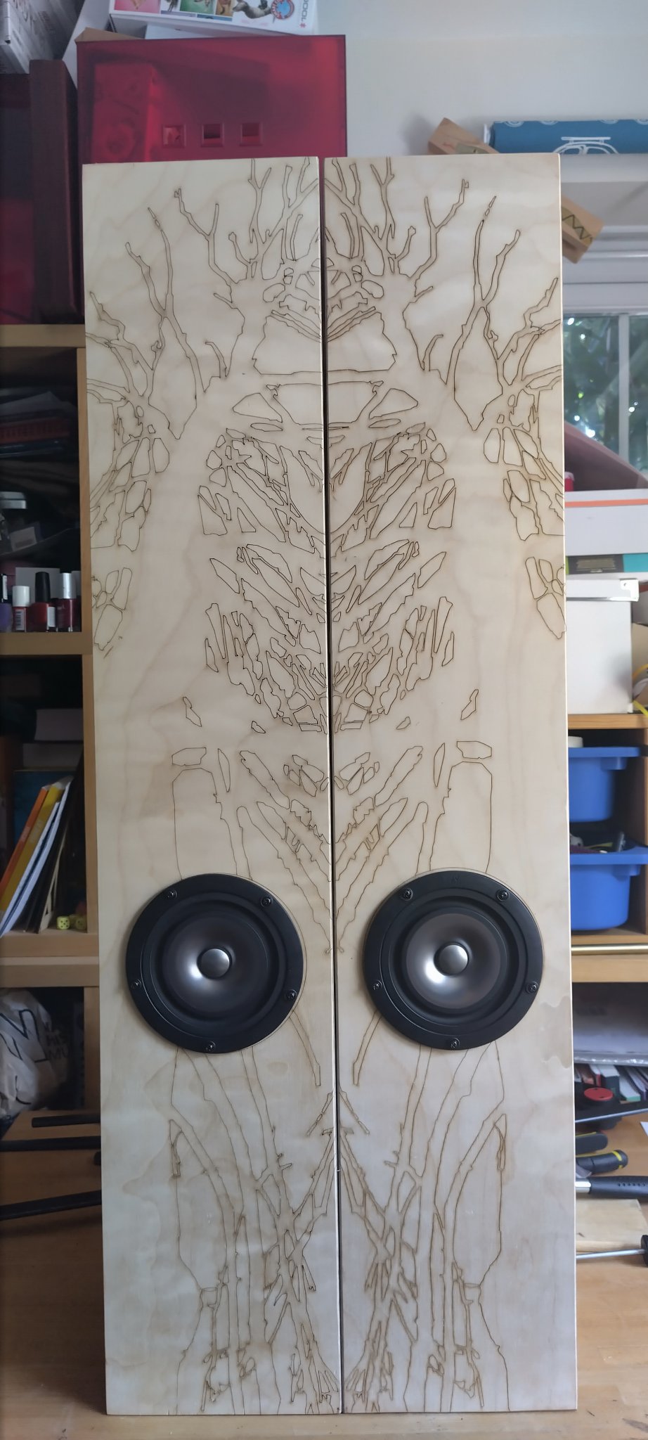

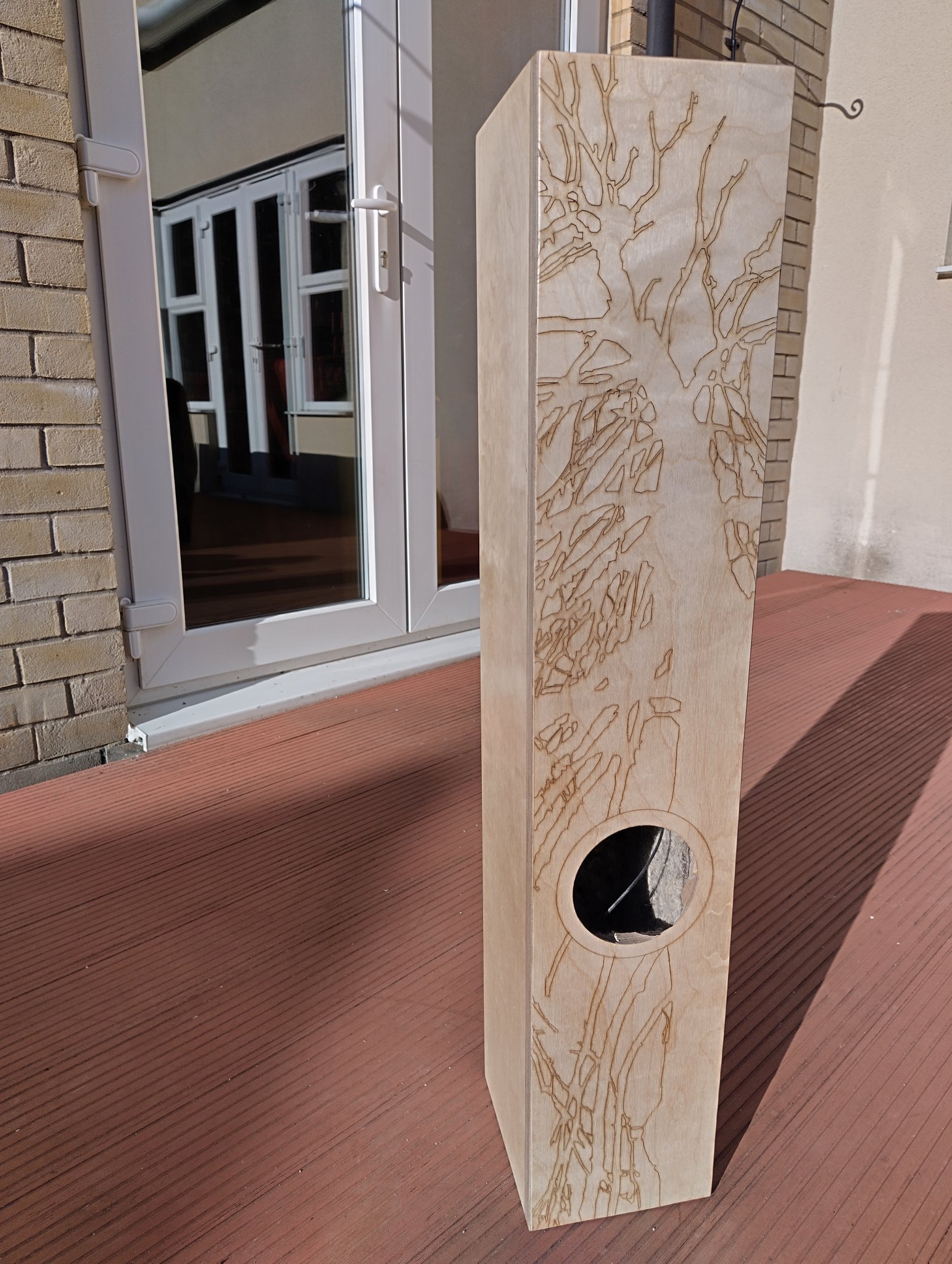

Next step (after soldering the wires to the terminals) was closing the box, sanding and applying some wax. One box finished:
one more to go...

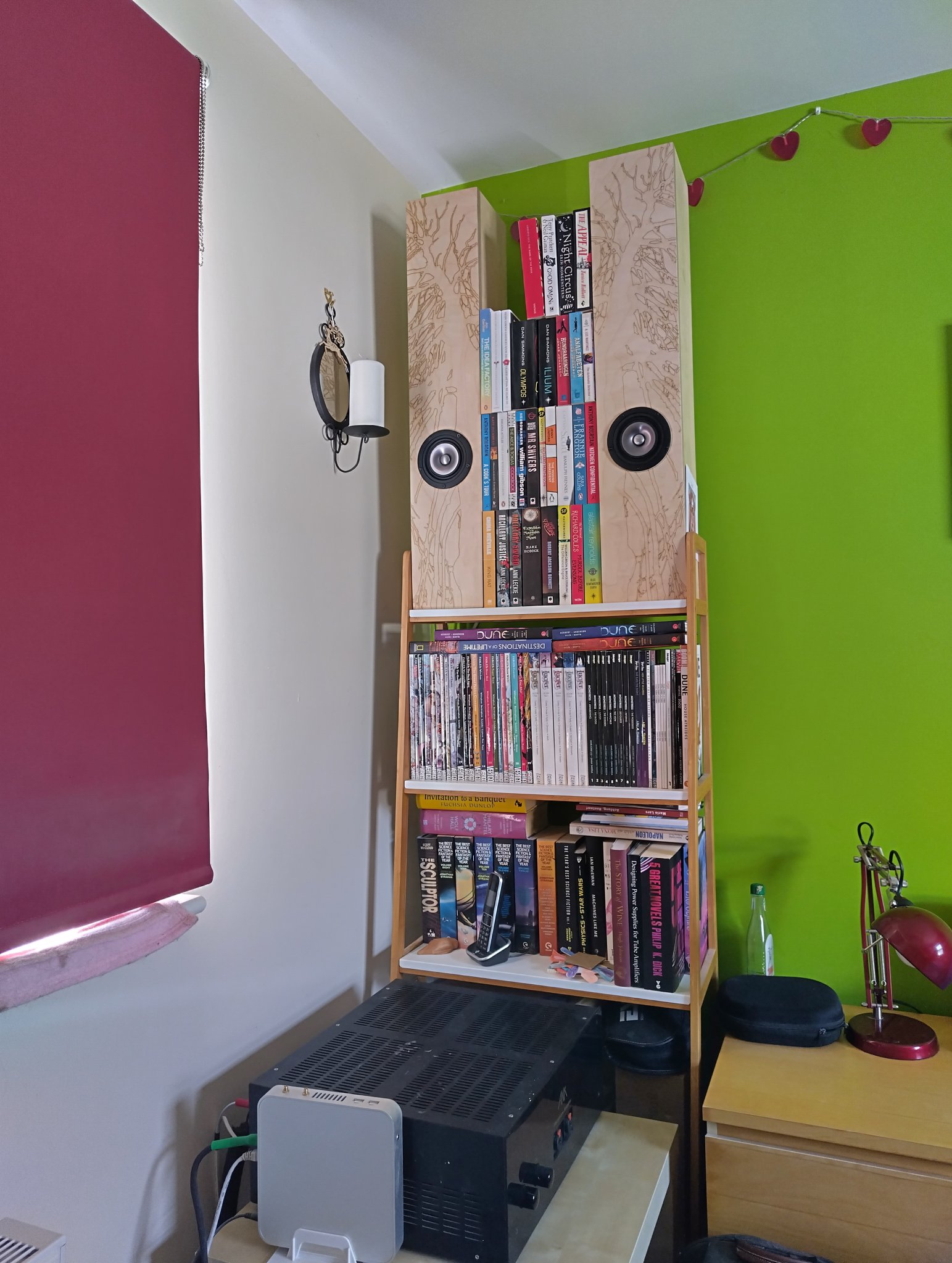

Thanks. The speaker have been completed (and listened to 🙂). I learned to solder when I was a teenager and I can still do it, but thanks for the tip. I have installed the speakers somewhat unconventionally in my bedroom/home office. I am aware that the location might not allow them to be used them to their best abilities, but that's where they need to go. With a bit of bass EQ in Volumio they seem to be doing fine.
