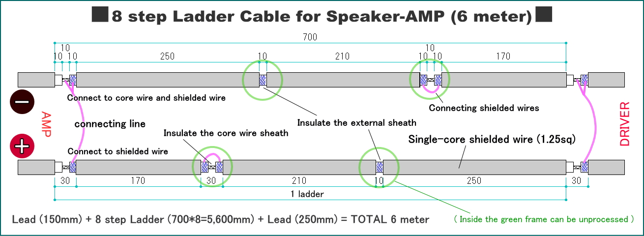

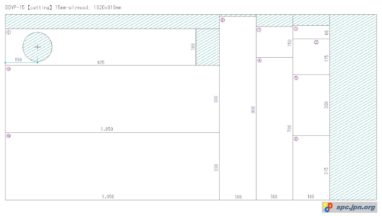

Dear JC Fardo,
There is no limit to the length of one step.
It is said that the effect is greater with more steps, but my verification shows that about 80 cm per step is sufficient.
The photo shows AMP-SP with 8 steps at 6 meters.
Inside the box is 4 steps at 46 cm.
For 2.0-2.5m, I think 3 to 4 steps are enough.
Reactions: 2 users

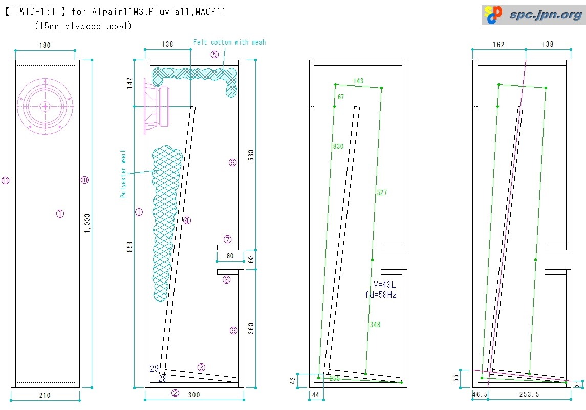

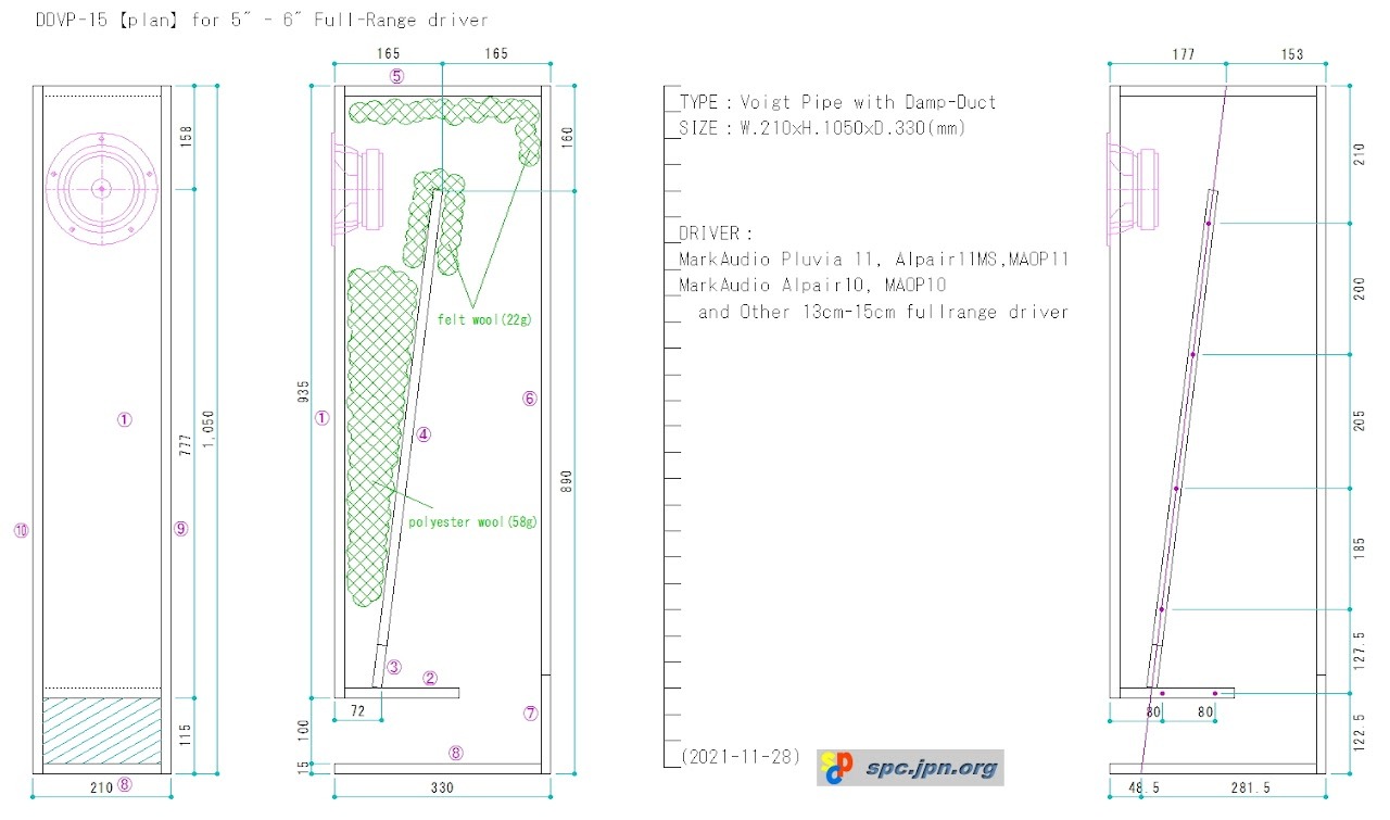

Reactions: 1 user
Dear nandappe,
I noticed that you use DDVP-10 box for number of 4" drivers. Do you change anything in box design or stuffing for different drives? Can this box or your TWTD be used with CHP70?
Thx

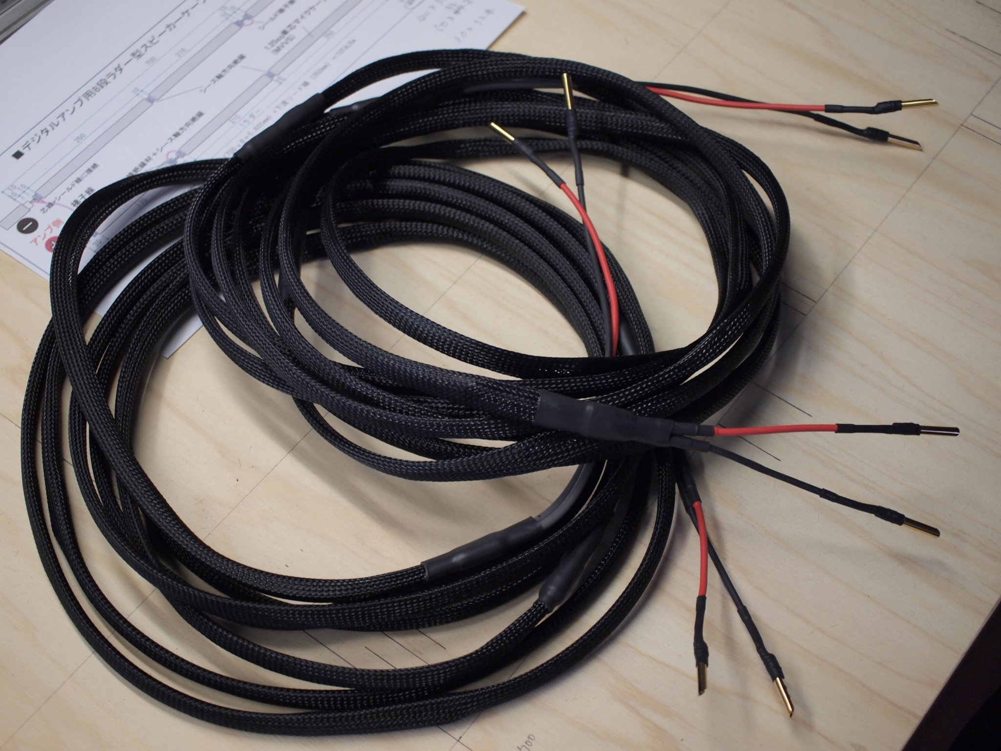

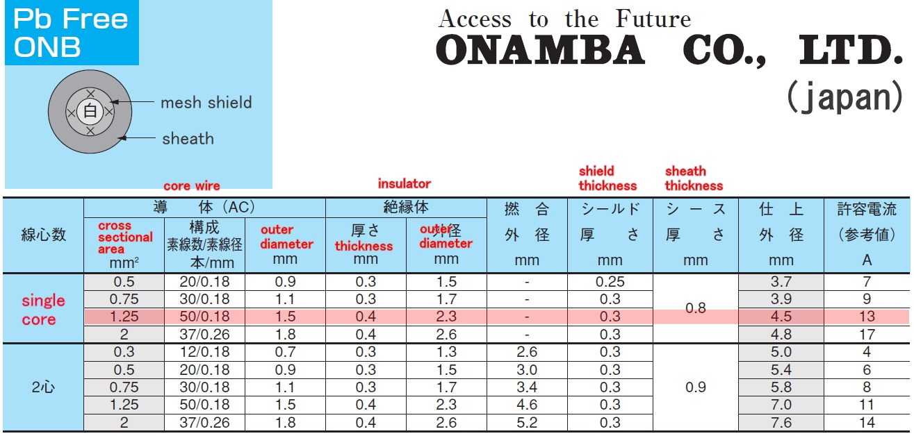

Dear LeifB60,
Please see the developer URL for the general effect of the ladder cable.
[Japanese]
https://laddercable.sakura.ne.jp/onsitu.html
[English translation]
https://laddercable-sakura-ne-jp.tr..._sl=ja&_x_tr_tl=en&_x_tr_hl=ja&_x_tr_pto=wapp
The biggest effect I feel is that "the audible distortion is small when playing at high volume in the fullrange driver".

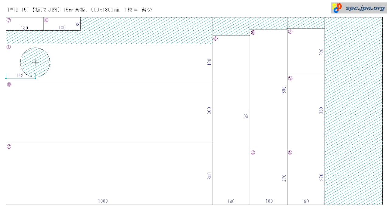

Dear wenlin,
For classical and vocal music, TWTD-15T.
For jazz and rock, DDVP-15.
Thank you very much for providing cabinet drawings. Are these items free?
