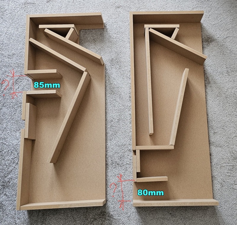

Standing waves are not a concern for this box.
Given it is an ML-Voigt, standing waves ar significant. With no damping the only lowpass filters will be the restricted terminus, the driver offset, and a little bit from the expansion of the line at the fold.
The bass extension comes from utilizing the primary standing wave, but all the harmonics will cause ripple. How much ripple can the listener live with? This question is complicated by the room.
I would be at least lining the box, if not adding a bunch of well teased polystuff.

The corners of 1 - 10 and 10 - 11 is better no triangular or square reinforcement.
As noted in my previous post, the expansion at the fold/corners are LP filter. Given no damping they play a greater role. Deflectors, as obvious as they mey seem, are counterproductive.

One last question before I started making my SDDBH T13.5 manufacturing
The two outputs are adjustable.
Can you tell me what are the distances between 7 and 27 and between 29 and 22, the usual distances from which have the adjustments in addition and less ?
Thank you.

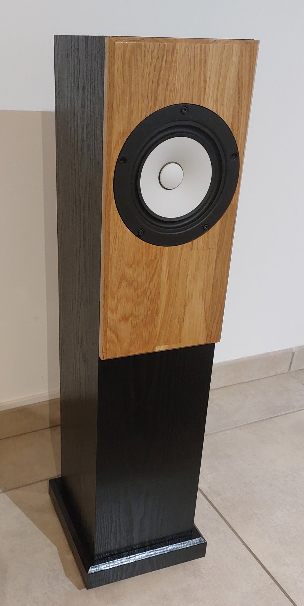

Hello everyone.
I made this SDDBH-T13.5 speaker with a MAOP11-2.
The result was not good at all: brilliance, resonance, frequencies too forward, others erased.
As you advised me, I made it work for more than 100 hours.
The result was always the same.
I abandoned this project.
I talked about it with a friend, a recognized specialist in speaker tuning.
He suggested that I develop a bass reflex speaker with this MAOP11-2.
In the end, I have a small 15-liter column speaker that sounds very good. I am very satisfied with it.

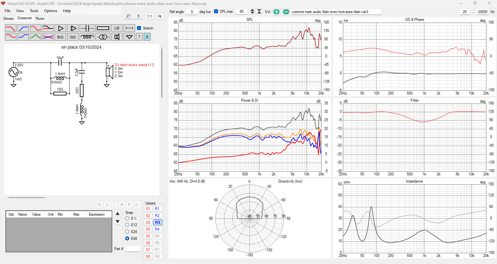

The treble response is attenuated by the room.
Look at the orange frequency curve which is the "in room" curve
It is made for a small room and listening to it at 2m or 2.5m.
The efficiency is not very high, but this speaker is not made to provide sound for a performance hall.
