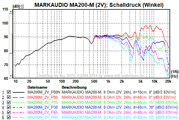

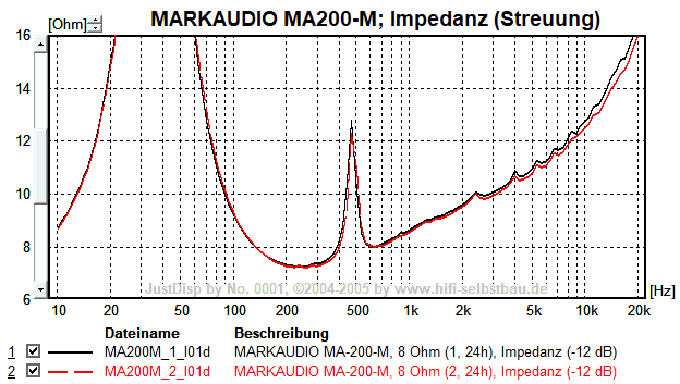

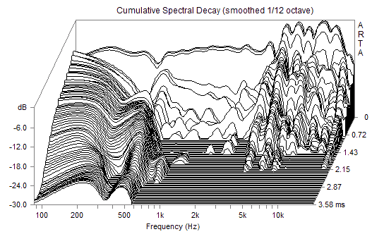

It's not due to the room if people in Germany can reproduce it under different test conditions. Graphs are from @Ivo 's link. I think Scott is correct, it's a transition zone. Look at the impedance bump and the ringing - that's not because of the room or the step response.I'm not convinced that this dip (which is also shown on the manufacturer's datasheet) can be dismissed quite so easily. Dips of this magnitiude are by no means universal. When I asked about it before, @Scottmoose suggested it is where the MA200 transitions out of pistonic operation.
The midrange looks fantastic and then the treble goes all crazy. I'll leave that debate for people who can hear that high. However, it looks like a lot of ringing.
