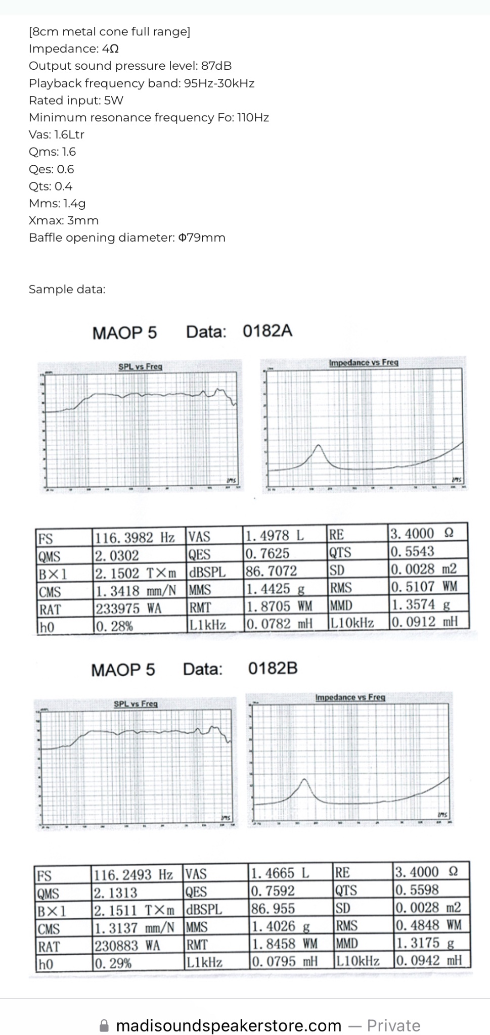

This combo looking better to me, especially if looking to take it up to 30k with MAOP5 and the MA200 doing the low-mid very nicely🙂 - a bit off topic, apologies
i continue the subject here: https://www.diyaudio.com/community/threads/new-markaudio-ma200-8-driver.416282/page-8
Leaving aside GM's 'outright' point that this applies to every wideband ever built (Lorelei aside if you had the power available) -you can probably draw your own conclusions from this thread, where Nandappe is using it in a single driver context, and thirteen of the sixteen designs for it that I've done for the MA site also run it in a single driver context. But this isn't the Stasi 😉 -there's no law that says you are obliged to use a wideband drive unit (any) by itself. You can, or alternately you can use them in a multiway context, as I did with that particular design, the big MTM and hybrid box / baffle semi-dipole.So the MA200, limited to WAW designs?

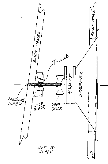

It gives more self-damping / dissipation of structural resonance at the price of usually needing to be larger for a given driver size, and being more expensive to produce than a cast metal type.
........and why me, P10 and others here and around the world historically have taken (some consider not worth the) effort to damp/brace them + align/bond the motor to it and then preloading it to cab to mass load it, which from ya'll's bracing scheme apparently does with maybe a bit of shimming rather than an early DIYer's pressure screw tweak.It gives more self-damping / dissipation of structural resonance at the price of usually needing to be larger for a given driver size, and being more expensive to produce than a cast metal type.
Getting a sufficiently snug fit between those braces and the enclosure panels without stressing the driver’s basket & motor assemblies was always a fun exercise; but easier for me than trying to assess just how much torque to apply to the mounting screws before those “imaginary” washers stopped spinning.

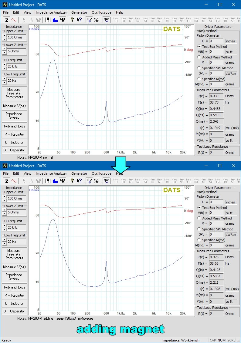

After 100 hours of break-in, I feel that the drive force is not strong enough.
I tried additional magnets, and 30φx3mmx5piece seems to be a good choice.
The TS parameter did not change much, but the clarity was improved and the sharpness of the low frequency range, which I was dissatisfied with, was also improved.
But the sound vector is different from MAOP10 and SB20FRPC30-8.

Always liked that pressure-screw method. 🙂 Probably next best thing to the rear-mount driver & the floating baffle...........and why me, P10 and others here and around the world historically have taken (some consider not worth the) effort to damp/brace them + align/bond the motor to it and then preloading it to cab to mass load it, which from ya'll's bracing scheme apparently does with maybe a bit of shimming rather than an early DIYer's pressure screw tweak.
The braces are pretty good too, if a bit harder to adjust! 😉 Dave will probably be after my blood, but when my friend & cabinet-building partner in crime Colin was still with us (rest in peace, my friend) we slightly oversized the driver cutout in the front-rear brace & used adhesive cork tape to shim it to the driver. Tiny amount of initial compression, then quite rigid.

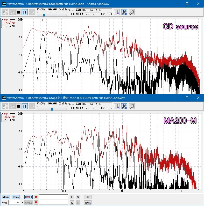

In Japan, Danny Boy by Jacintha is known as a high quality sound source and is often used for demonstrations at audio events, but MA200-M does not sound good with harsh consonants.
I was looking for an alternative and found Both Sides Now - Jeanette Lindström.
This song works well with MA200-M and gives a great voice.
