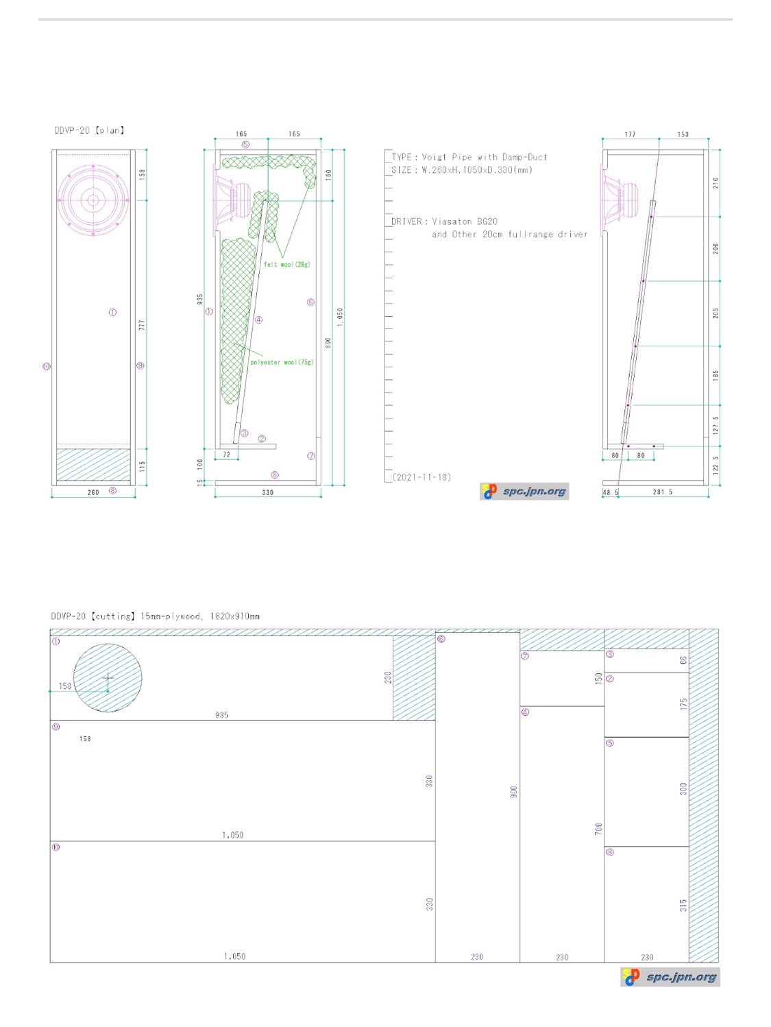

I have come to realise that @nandappe TQWT box plans being used by others to create Sibelius clones (10.2 driver) with good results - basically increasing the rigidity with thick oak wood. It will be interesting to see how these compare with something similar using MA200 …
- Full Range
- MarkAudio MA200-M + DDVP-20(TQWT)
