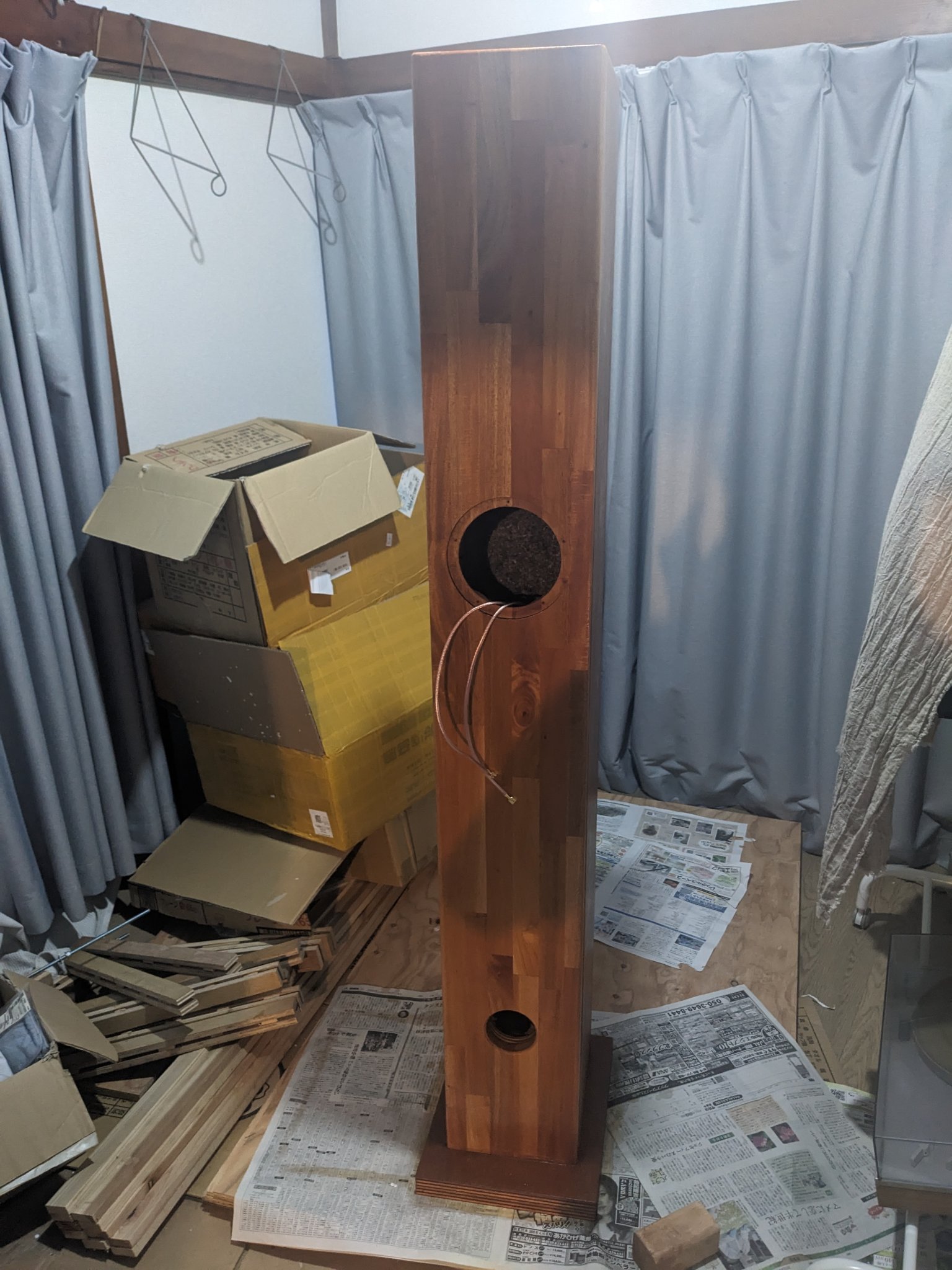

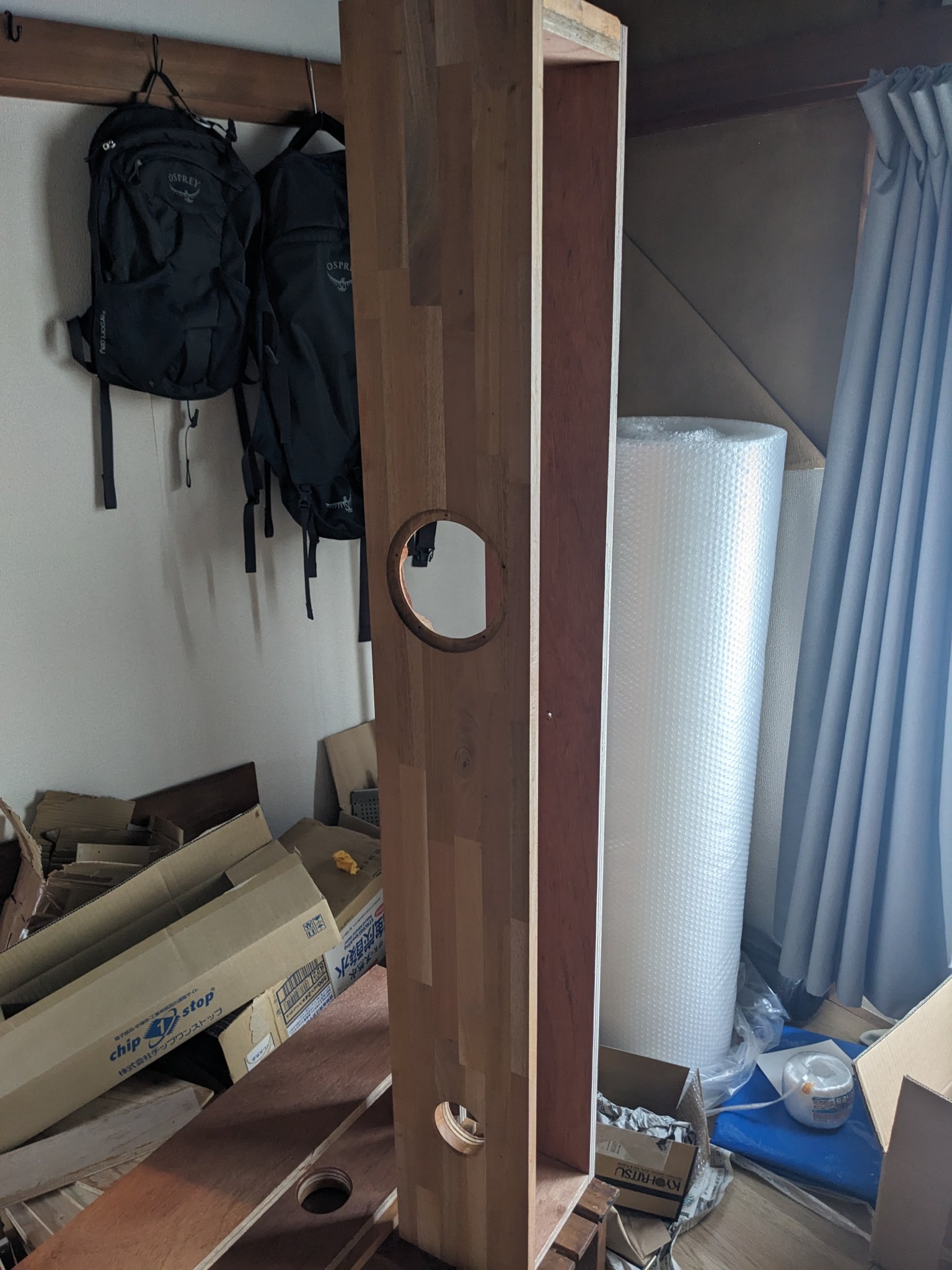

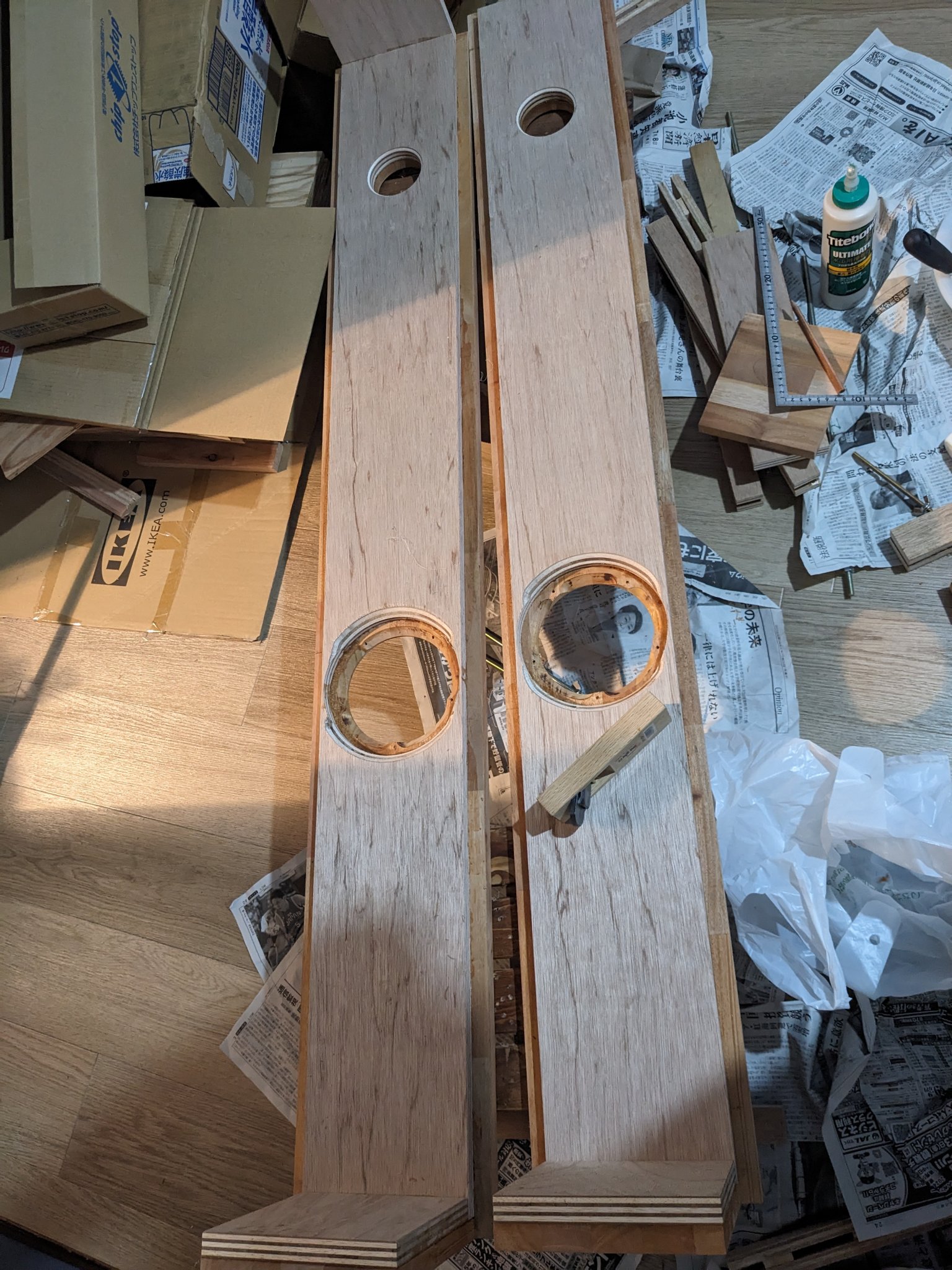

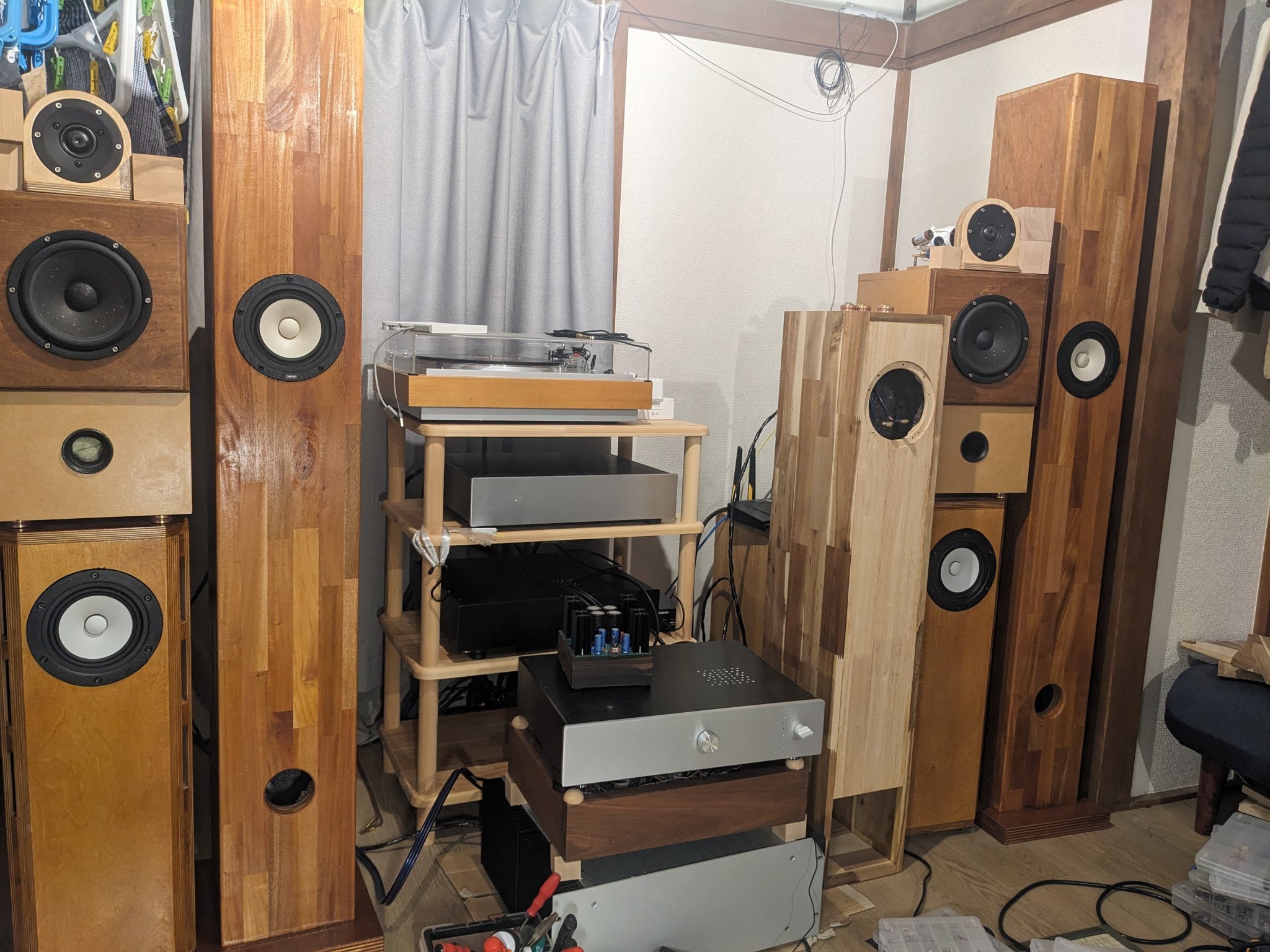

I bought chp90mica and waiting cut plywood(not best quality one but not poor) for Makalu.
I listened few hours with different enclosure,
This is amazing driver, detailed,no hash,have decent bass.
In my little experience,I prefer lower force enclosure so I choose Makalu.
I would like to have frugel horn but now,I don't want to throw bass to back thin wooded wall and large window....
May be in the future.
I appreciate Scott and Dave for so many designs.
I am so happy that I could post here for the Makalu sound impression.
I built it with cheaper material.I found cheaper mahogany for baffle for good looking.
Not only bass,treble and mid also good.
It making great sound stage,3D imaging and relaxed sound flowing in the air.

It depends on which box you choose. Maop10.2 works surprisingly well in the miniOnken. Disappears completely in the soundscape. But we all have different preferences and different electronics and rooms.
I like the CHP-90 a lot too.
Would be fun to try the CHP-90 in the miniOnken. Compare them in the same box.
I wasn't too keen on running Maop10.2 in a Pensil. But we probably have slightly different tastes.
