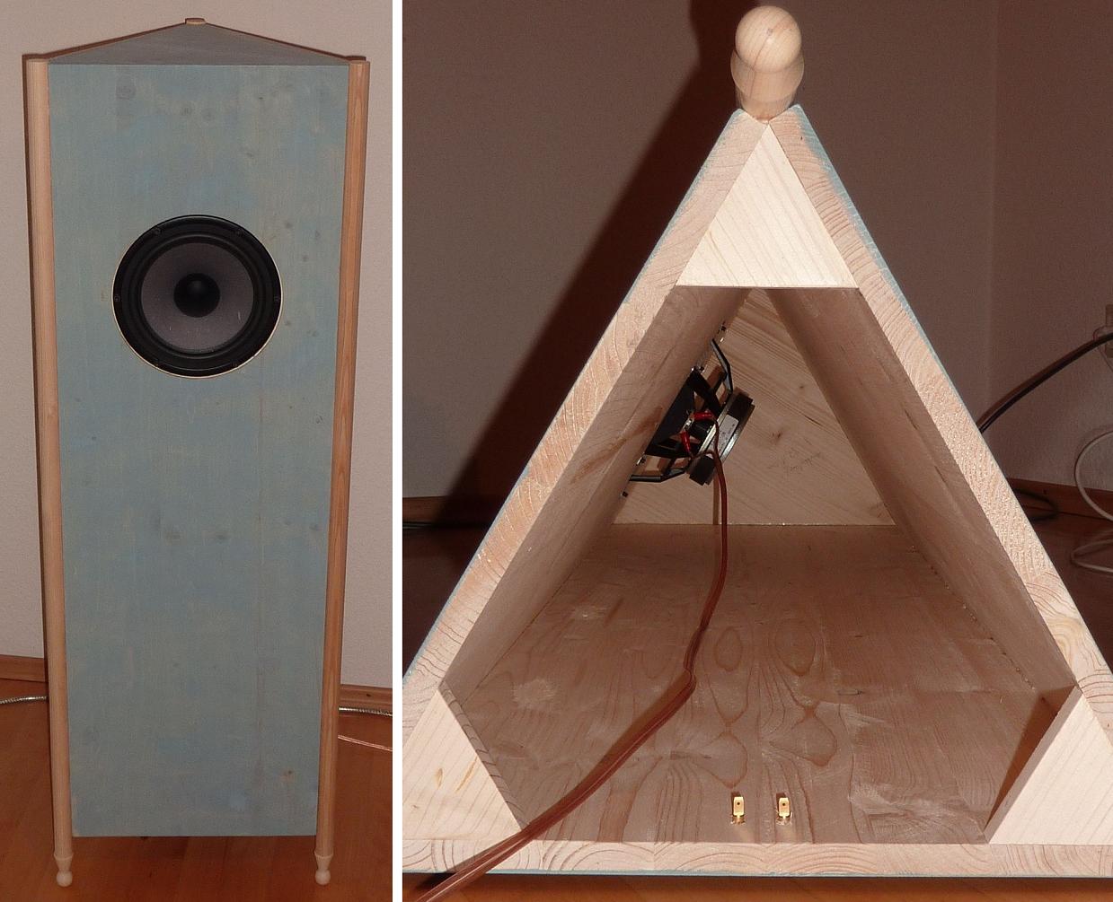

Seeking around for ideas about CHP-90 cabinet I bumped into this
http://diyaudioprojects.com/Gallery/displayimage.php?album=2&pid=685#top_display_media
for
Seas FA22RCZ Fullrange in Open Speaker Cabinet
another driver that I like very much but ... too expensive for me.
Elias
