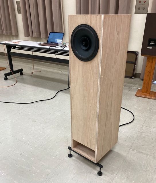

Recognize that type of box. It was called "Everest" in the 80s.
Fostex elements. But there was a rectangular opening at the bottom.
No idea who came up with that design. But it probably originally came from Voigt.

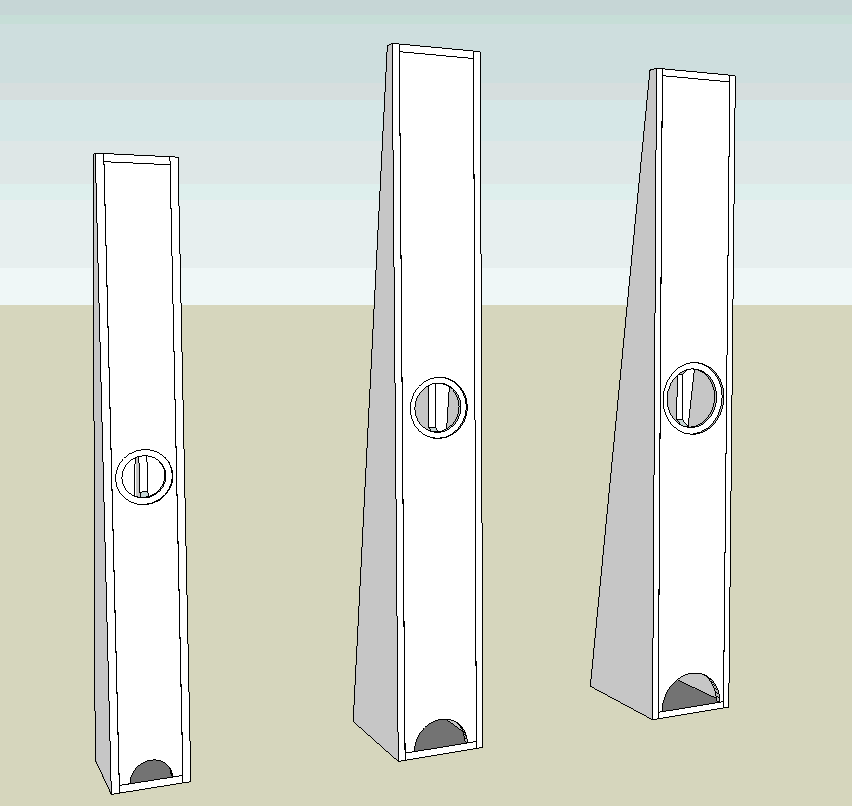

It's just an ML-Voigt (no 'h': P. G. A. H. Voigt), no more, no less. So was the Everest cabinet. Voigt pipe-horns (mass-loaded or otherwise) have been around since 1936. The above aren't folded because they were done purely for aesthetic reasons, and are in fact derived from a previous MLTL (so zero point in creating a folded version: the MLTL does exactly the same job for all practical purposes). If you're interested in the history of this type of enclosure, people here can tell you all about it.

A ‘crude” desciption of the simpliest is take a Pensil. Make it twice as tall and then run the back from the bottom back of the Pensil, up to the new top at the baffle. It will usually need a bit of tweaking from there depending on the goals of the design.

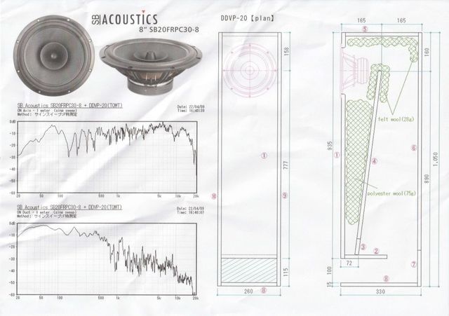

"Utsunomiya DIY Audio Meeting 11-2022"
Yesterday (November 12, 2022) I had an offline meeting with my audio friends.
I played my CHP-90 mica with my cell phone and AIYIMA B2D1957.
The room is 85m2 in size and the ceiling height is 4m, but the sound is loud enough.
This driver and box is very nice for small room and large room.

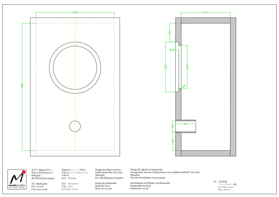

Bit stuck here on new builds for the CHP-90! 😕
Today I've made a Golden Ratio box for the MAOP 10 and right now I have on my desk both the slotted 14L of the CHP-90 + the same of W5-2143 and on top the old RS-100 haha 😆 Temporary of course (hope so!!!).
I'm almost spending more on clamps than on drivers!! 😉
The sound seems OK but wondering what are the problems of running multiple full ranges together this way, one close to the other in their own enclosure, but with multiple amplifiers...
Technical/physical laws problems? or not? Really newbie on physics of sound!
I did notice that the MAOP they seem to need more "power" then the others but right now of course I'm not pushing the volume at all.
The sound seems really so "clean" btw!
I think that a folded TL would be the best for me for the CHP-90 but I also think I would need some help to do it!
Any practical suggestion on how to proceed?
I've tried hornresp but really too complicate, then try following a vid on YT making some calculation wiht FS / SD (Quarterwave) and for the CHP-90 got a TL of 175cm with a cross section of 17.4 x 4.88cm but not sure if this can be correct and then it has also to be folded and got bit lost...

You're welcome!Thanx for yours answer.
As I understand it, the bigger boxes will lose confidence level in the mid-bass or can this be compensated in some way?
Have I understood this correctly?
If you tune it below Fs it will and if you want the max power available for [mid] bass 'slam', then the pioneer's Vb = Vas/1.44, Fb = 1.56x Fs prosound alignment dating from at least 1937 with the introduction of the Lansing Iconic recording/playback studio monitor is the way to go.
