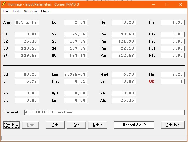

Sorry, this should be correct:

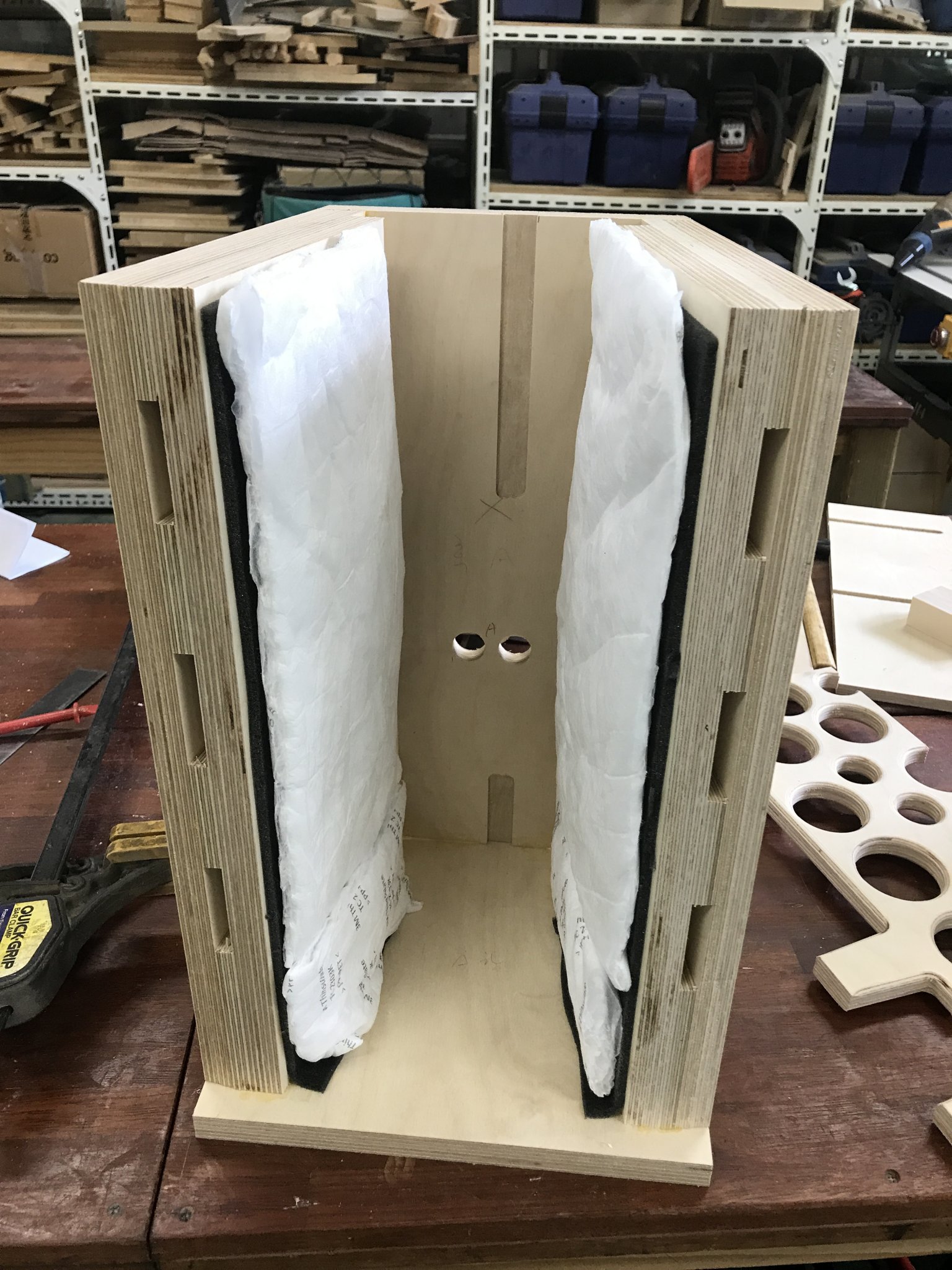

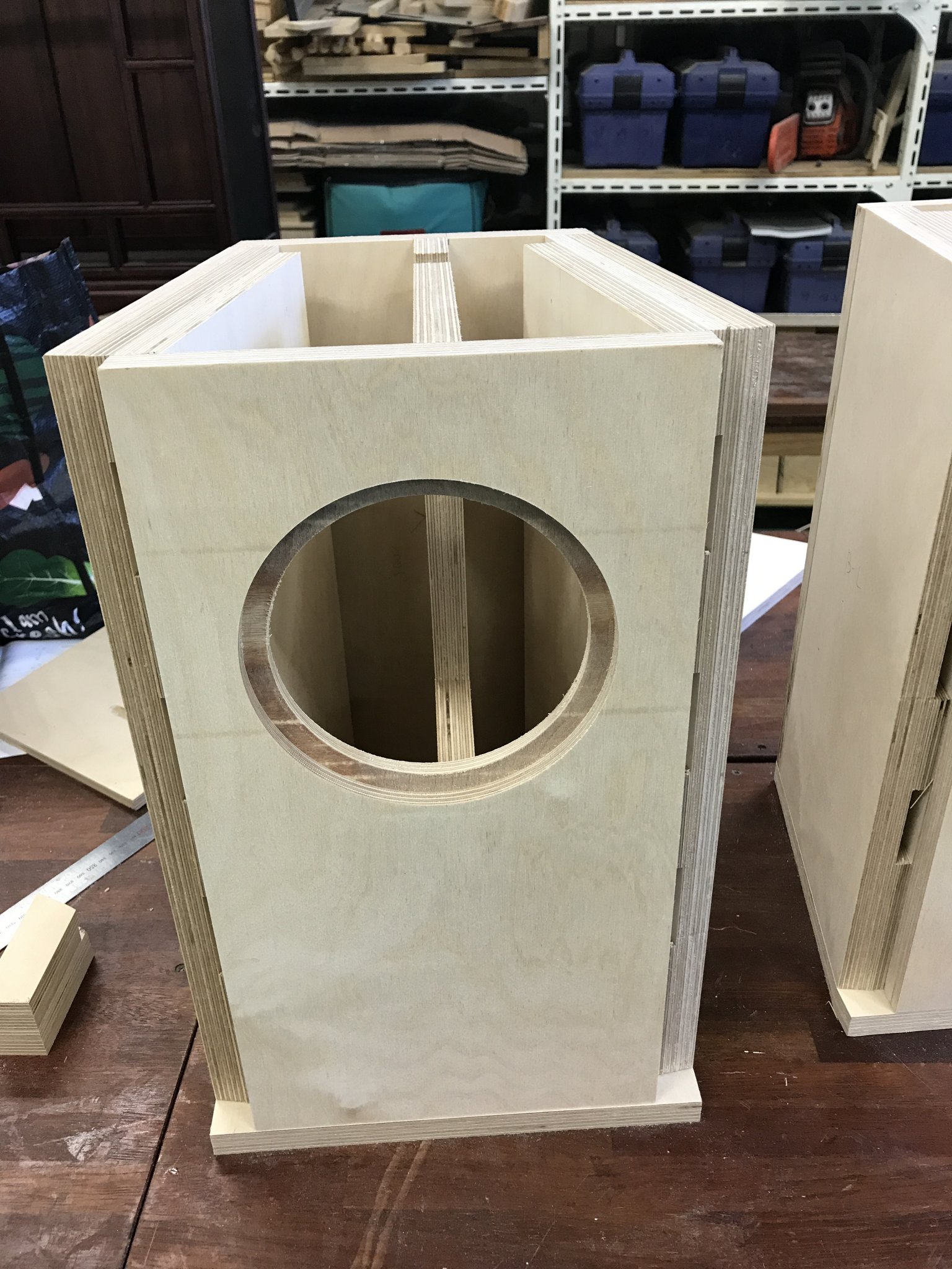

If you want to maximize bass, FHXL or Pensil. For a standmount there are my miniOnkens, the trapezoid a woodworking challenge (but well worth it IMO [i might be biased]), but includes quite a few other variations. For a more traditional reflex, Scott’s simple BR.
I don’t seem to have linked this page to the Woden homepage yet: http://wodendesign.com/Free.html )no more for the A10.3).
A10, A10.2, A10p specific boxes can be used as inspiration but are not suitable.

You don’t want to overload the room with bass, and if small FHXL footprint might be too large.
The trapezoid’s big asset is a low diffraction signature which contributes to good image/sounstage.
If your small amps are SETs with highisg Rout, you might want to look at something where it is easy to tune for that )often more stuffing).

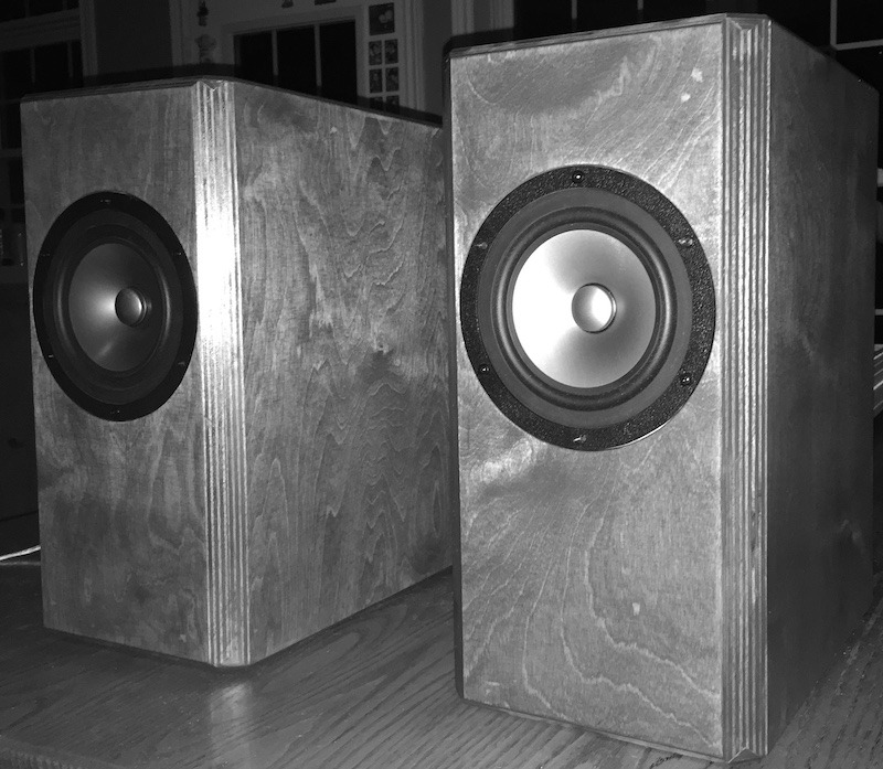

I think those boxes look very good indeed and with a table saw would be a very satisfying project.
What I did was simpler, I just built a pair of boxes, bass reflex boxes using the design criteria offered by Scottmoose who is somewhat legendary in his abilities in speaker design.
https://www.diyaudio.com/community/threads/bass-reflex-standmounts-10-3-10p.250751/
I didn't use the same dimensions but I did ensure the correct box volume and port dimensions which means the alignment is correct. I wanted a narrower speaker for aesthetic reasons and I chamfered the edges of mine for aesthetic reasons too. One of these days I'll post some proper information about my build but anybody who wants to make a box ('tofsound' ?) can make a simple bass-reflex speaker. There are plenty more examples of bass-reflex boxes for these drivers on the internet for those looking to make something simple albeit not as perfect as Dave's examples.
My boxes were finished with wood oil, using a rag and they have a green-grey colour but I've only got a B&W image to hand. The port is a section of 2" white plastic pipe from the local hardware store set in to a 2" hole in the back of the box.
These are really good drivers, I'm quite impressed with what I get from these speakers.

Looks great.
Lovely work. I am going to steal all your pictures.

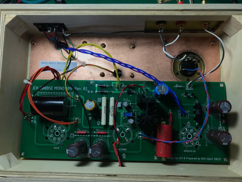

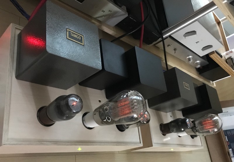

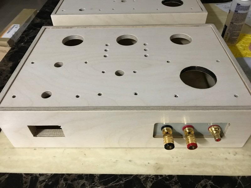

Here are photos of recently built 300B SE (Tango ouput and FM 300B) and I think it matches good with 10.3.
