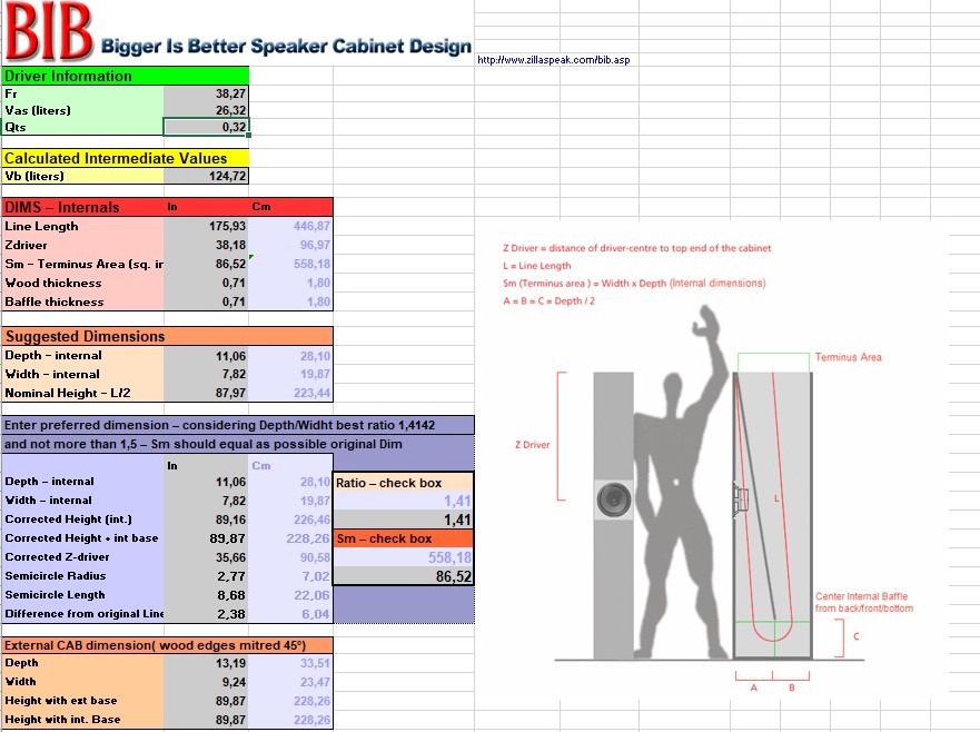

I've put the Alpair 10.3 data into the BIB spreadsheet ( https://speakerprojects.files.wordpress.com/2014/11/bib_calculator_v2.xls ) and I've got this data:
So it will be a 23.5 x 33.5 x h228.3cm cabinet, with the speaker at 131 cm from the floor composed by:
Is it correct?
- #4 panels 335x2283x18 mm (sides)
- #4 panels 199x2283x18 mm (front&back)
- #2 panels 199x299x18 mm (bottom)
- #2 panels 199x2124x18 mm (inner)
Is it correct?
