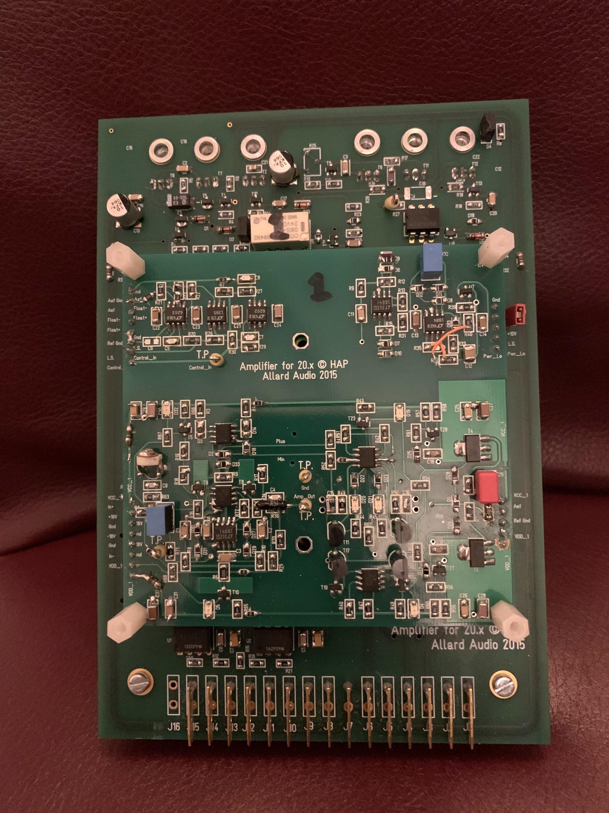

That’s why I took the hard way and gathered the knowledge by reverse engineering my ML20.6 at a time no circuit diagrams were available, not to make money, but just to be able to do the repair by myself.
The 20.6 had teflon PCB’s that where like chewing gum and had to be serviced almost every year, making me to decide to develop my own boards based on smd technology and higher integrated level of components.
At a later stage it was a surprise to see that all ML amps are very closely related and are still using similar “family” technolog up to class D.

Ah, yes - I remember you telling me you designed it for SMDs. Lots of fiddly soldering there, Hans, but they look great. I'm sure the measured performance is better than the 30+ year old boards!
Here you are
Hans
amazing job! How does it sound compared to the original?

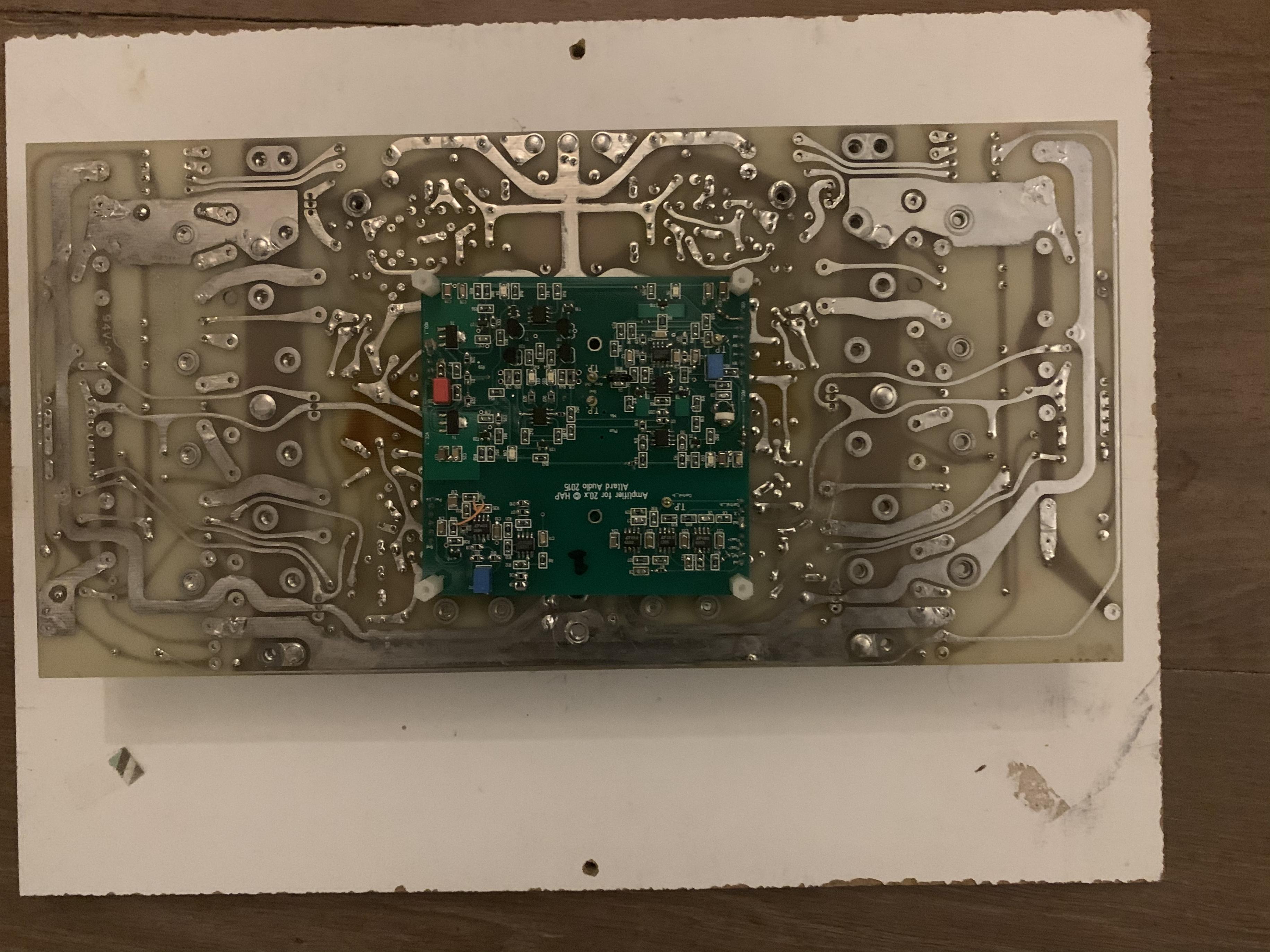

Sooner or later all teflon ML PCBs will need replacement. Restoring my 23.5 I found horrible previous repair job that really damaged the traces and the boards.
Yes, the quality of those 23.5 boards are not very ruggedized and are easily damaged.
That’s why I offered 23.5 users to produce a more service friendly and modernized set of PCB’s, but just until now there’s only one person interested.
And because it has to be plug compatible, special hardware has to be produced to let everything fit.
To give you an idea, the set would roughly look like in the image below.
A base board with a pluggable modern amplifier board on top that can be simply removed without any soldering.
Hans

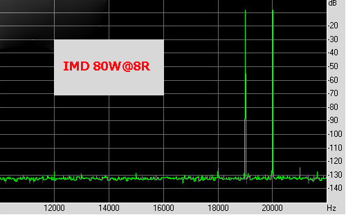

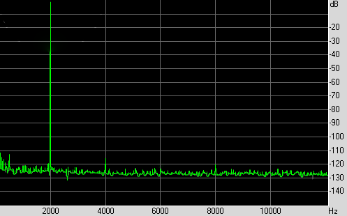

P.s. Yes I’m very happy with the sound of my amp, to my very subjective opinion it’s the best amp I ever heard including the original 20.6.
But it is quite a different desing, a 26dB gain voltage amp followed by a 0dB gain current amp with dual nested feedback resulting in a very low distortion.

Here you are
Hans
Very interesting. That would be the bottom board of the 23.5? How would you connect the output transistors and the aluminum bars?

It would be a new board but have the same size but now with a ground plane and thicker copper traces.
The bars are not aluminium but tinned red copper which have either to be produced or taken from the old board which is relatively easy to do with a heat gun.
All transistors sitting on those large heatsinks will of course have to fit exactly the same way to the new PCB, just like all cables and copper bars, completely plug compatible.

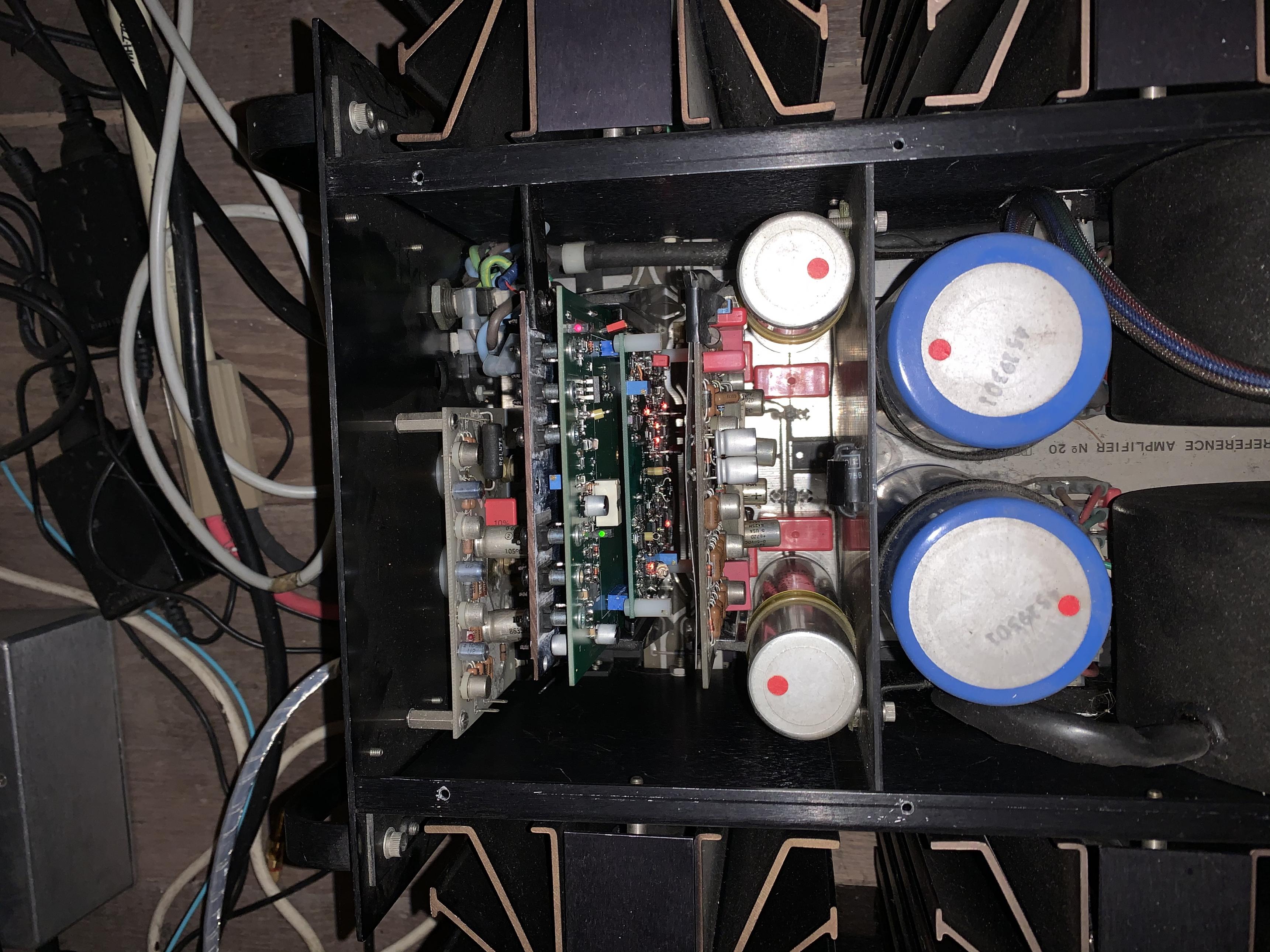

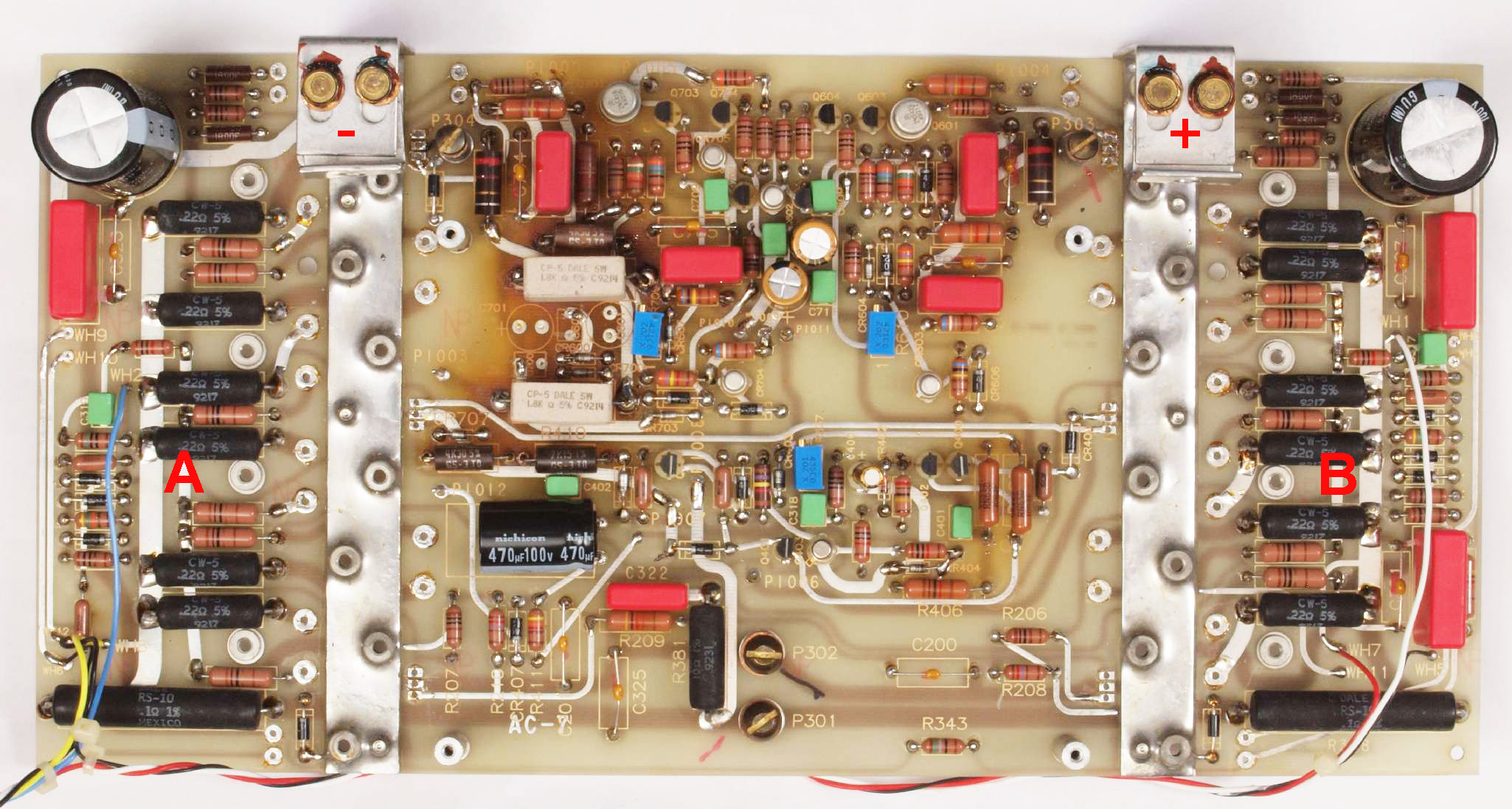

hi Hans, bad news unfortunately. I reassembled the left channel main board and connected everything as you told me. with the short between P1006 and P1007 voltage across the two 150R resistor was 1V (same as the other channel I previously tested), voltages were all good (± 85 V on the large unreg caps and ±84V for Vreg), so I removed the short between P1006 and P1007. When I did so I measured voltage across the two 150R resistors and it was 4Volts on both positive and negative sides. Voltage across on of the 0,1Ohm resistors was 0V... I disconnected everything and was looking for shorts on the PCB but my meter is acting crazy and is totally unrealiable for resistance measurments, will need to get a new one. I did use the meter to check the solderings on the heatsink transistors (since it cannot be checked visually) but at this point with the meter broken I might have missed some shorts there. all heatsink transistor measured good before assembling everything back
Be glad that most likely you did not blow up anything.
So next step is, tell me what voltage you see on P1006 and P1007 with short circuit removed.
From there we will go step by step.

Thank you Hans for being reassuring and for assisting me. Voltage on P1006 and P1007 would have been the next thing I'd have checked too, just wasn't sure it was safe to leave the amp on. That's good, means that I'm starting to understand something about circuits.
P1007 is -2,6V while P1006 is 0,47V.
Those voltages are perfect.
Now measure the voltages on the two points that I have marked as A and B.
Hans
