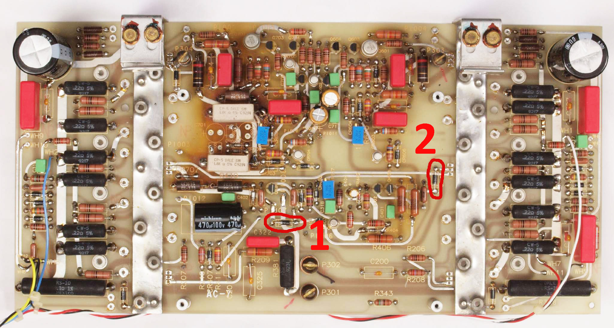

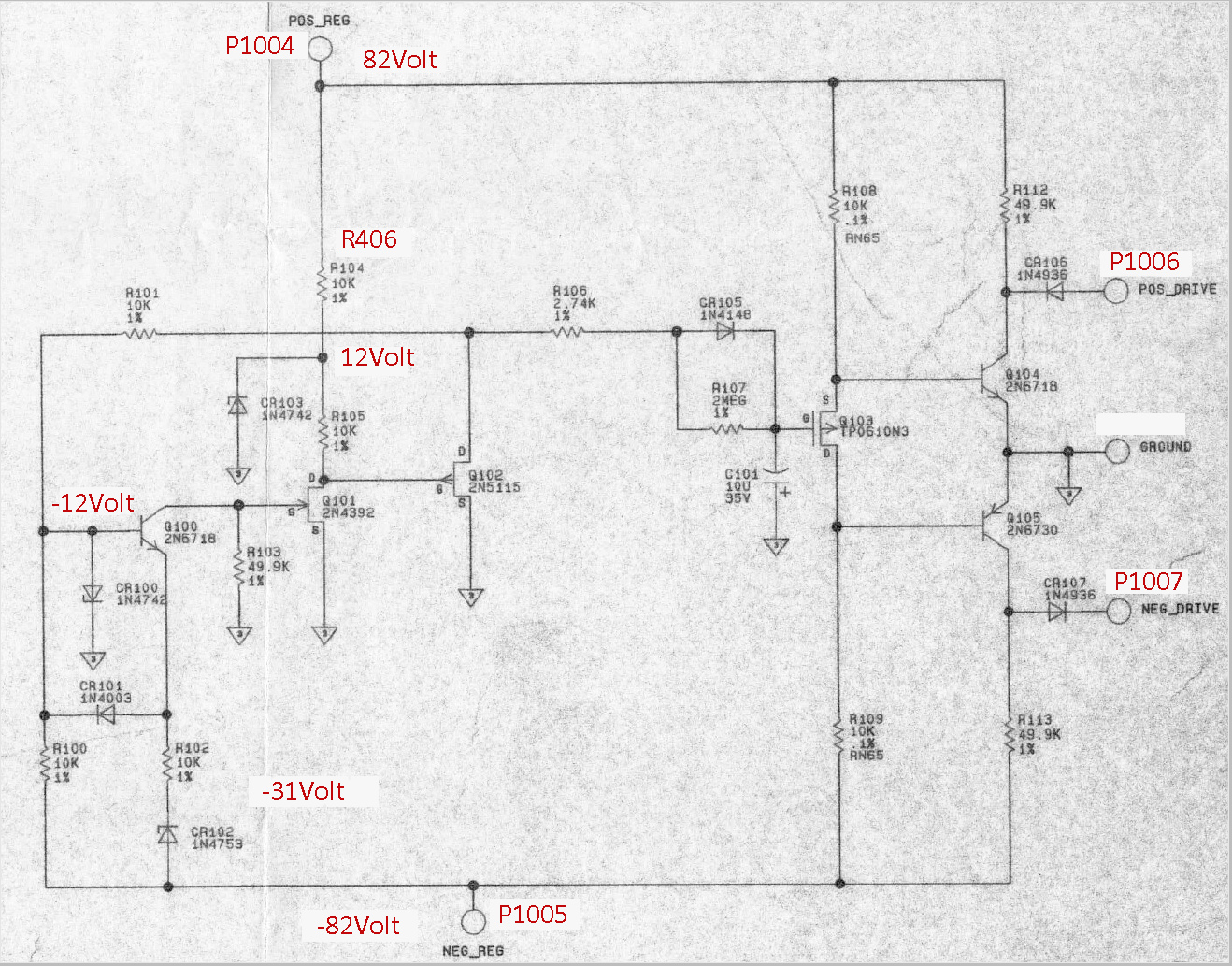

Hi Stefano,
Let me explain the circuit responsible for soft start and shut down.
First a basic version of the circuit in the most left image below.
The mosfet at start up is non conducting, causing the two transistors to conduct, thereby pulling P6 and P7 to gnd through the diodes D1 and D2.
This will stop any bias current from flowing through the end stage and at the same time forcing the output to zero volt.
After a few seconds, the mosfet is turned into conduction and the amp will become operational.
At switch off, very soon after the regulated supply is going down, the mosfet goes into off state again, forcing the output back to zero volt.
In both cases this prevents any plops or whatever sounds coming from the speakers at switching on or off but also preventing the protection to become activated.
The complete circuit is in the 2nd image below, now disclosing the steering circuit for the mosfet's gate.
However only the numbers in red in the circuit diagram are correct, the others do not correspond with the numbers on your board
The third image shows the position of the two diodes that are connected to P1006 and P1007 (in the first image called P6 and P7)
Working your way back you can find the two transistors and the mosfet.
When any of these components malfunctions, you have a problem.
These components can be checked in a passive way by removing and testing them.
An active test is a bit more complex but can be done without the piggy back board but with the board mounted on the heatsink and the TO3 transistors in place.
Hans

Thanks again for your help. I think you were right about C324 as I tested it and it appears to be faulty. Yes I removed the PS board because I wanted to replace the cracked RIFA paper caps that can go bad and explode (better sooner than later). I am skilled enough to take everything apart but wasn't able to figure the circuit out and point to C324 as the faulty component.
The protection circuit seem to work well otherwise, since I once tried to turn on the amp with both channels disassembled and protection didn't let me do it. Probably because the disconnected wires from the amp boards to the OL-2 boards triggered the signal to the protection circuit (I think normally the thermal sensor is supposed to be shorted and disconnecting it's wires opens the circuit right?). Disconnecting the wires from the OL-2 to the PS board allowed switch on. Anyway it seems the protection is functional.
I know am worried about the turn on and turn off spike protection mechanism that is on the amp boards that could be faulty, but would be very hard to diagnose. The amp sounded just great so the audio path is intact I think. Possible that the large filter caps initially failing could be causing such small transients on the outputs during switch on/off?
I have ordered replacements for them as well but will ship in a few months.

Thank you so much for the explanation, I had read some about it in the available 27.5 service manual, but wasn't sure about it's actual implementation in the 23.5 since I dont' have documentation.. I can definitely check passively and actively ( in this case I believe I should connect the ground blue wire that is normally connected to the AC7.5 board directly to the P10010-P1009-P1011 pins right?).
One interesting fact, I believe the board you showed is a later revision, mine is probably earlier and doesn't have the 470 uf capacitor and the 4,32k resistor and the 1n4936 diode connected to its negative terminal, nor the P1012 pin to the upper board. However these revisions have been at some point implemented by someone (picture on this page L'Audiotecnico: Mark Levinson - N°23.5). I see these components are connected to the diode you circled in your picture, do they have something to do with the circuit you described. The 470 uf cap doesn't look good (initial bulging) and I have replaced it already.
You are right that many versions do exist, with additional components, with different components etc., etc.
But the general issues are similar and the alterations are rather random and removed or replaced at a later stage.
I can't tell the reason, nor the effect these mods had.
I have even repaired amps with 2 generations of boards.
When you are ready, I can tell you how to actively test the slow start circuit.
Normally, passively testing the 2 diodes and the 2 transistors will do.
Hans

Anyhow, I did some further measurements on the PS board before hooking up the amps and I found 120VAC on the front panel chassis! (60VAC with the power switch off)...then I hooked up the front panel chassis to the main chassis with a cable (it was disassembled before) and I got 0 VAC..measuring current through this cable showed 0,1 microAmps... is this normal behavior? I don't think so. I double and triple checked all the wiring. DC voltages seem ok (±86-87V for unregulated lines and ±117-118 V for pre reg lines).
I think 100nA is nothing, but you have to assemble the whole chassis together and always connect the amp through a mains cable with PE.
Between the alu bar on the big blue caps and PE you should measure 10R and 20R between both alu bars of R and L channel.
Now let's go on with starting the power up procedure.
1) Discharge the large 4 blue caps with a proper resistor.
2) Connect P1006 to P1007 and switch on the Amp.
No current should flow through the external 150R resistors, if current flows there is something not o.k., that's why these 150R resistors are there to prevent a disastrous blowing up of your TO3 transistors.
3) Measure the voltages on the blue caps and on P1004 and P1005.
These voltages should be resp ca, +/-83V, +/-117V and +/-84V.
4) When that's all O.K. discharge the 4 blue caps
5) Remove the short circuit between P1006 and P1007
6) Turn on the Amp.
Voltage over both 150R resistors should now be ca 40Volt, If not stop here and tell mne what's going on, but when o.k.,
7) Turn off the amp and shorten the 150R resistors.
8) Turn on the amp and measure on one of the two big black 0.1R resistors on the outside edges of PCB.
Here you should measure ca 27.5mVolt.
9) now measure all 12 slightly smaller black 0.22R resistors, they should measure ca 10mV +/- 2mV to confirm the TO3's are well matched in Vbe.
Give me a sign when all 9 points have been succesfully passed and I will guide you through the next steps.

I connected everything. Current across both 150R resistors is about 7 mAmps with the short between P1006 and P1007.
Other voltages are about ok, Vcc unreg ±85,5Volts, pre regs ±115,5Volts and regulated voltages ±80 Volts. If you think it's ok I'll remove the short between P1006 and P1007 and proceed with the measurements.
p.s. resistances between grounds and earth are ok.
