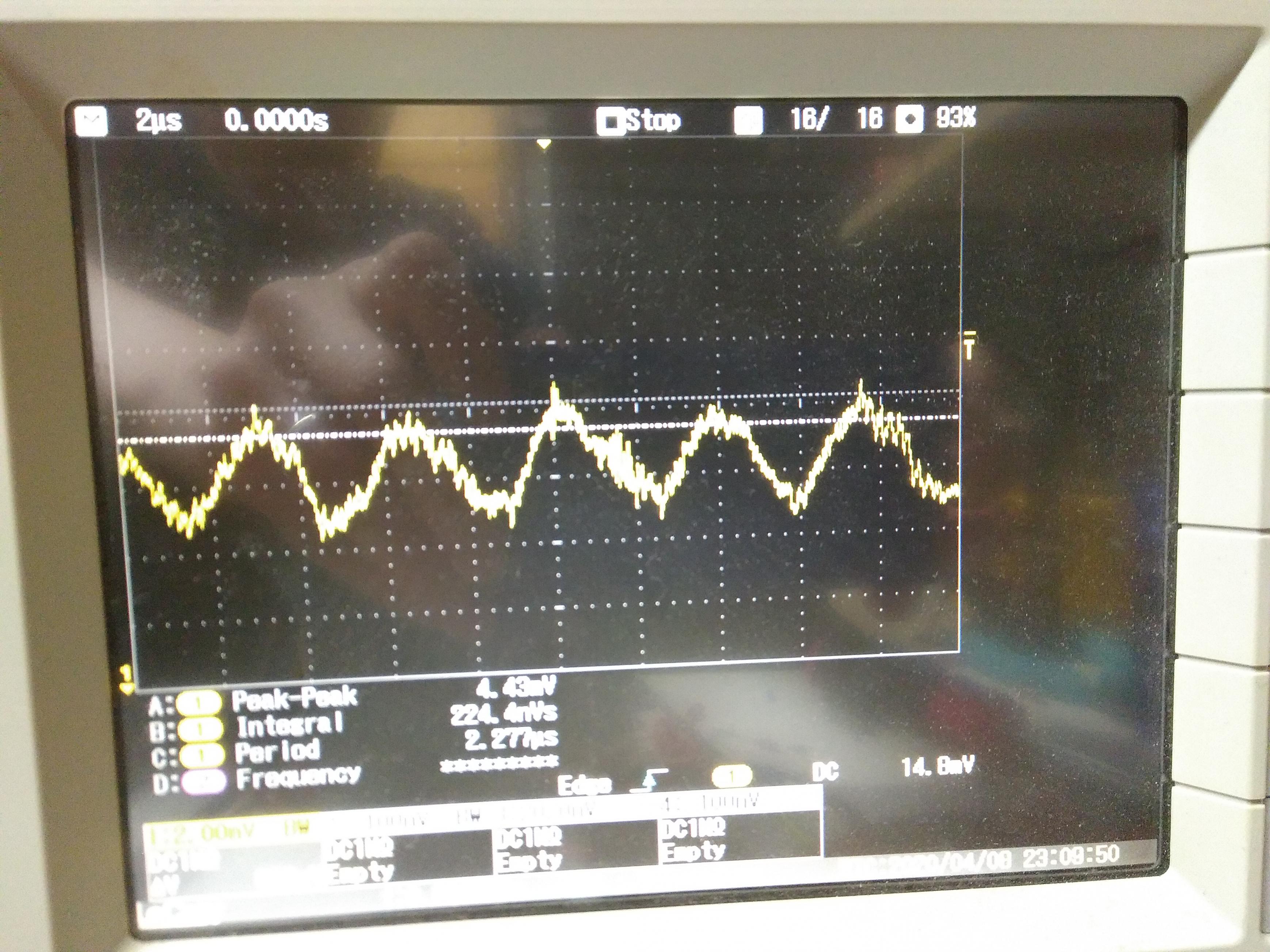

1) When you reduce the voltage over the lamps to 25volt with the pot, does the amp then also switches itself off ?
2) And do you have a scope where you can see that the amp is oscillating ?
3) What protection system does the amp have that decides to switch of your amp, do you have a circuit diagram of this part ?
4) You could also try to connect a load to the output to suppress oscillations, for instance a 12volt 40watt car lamp.

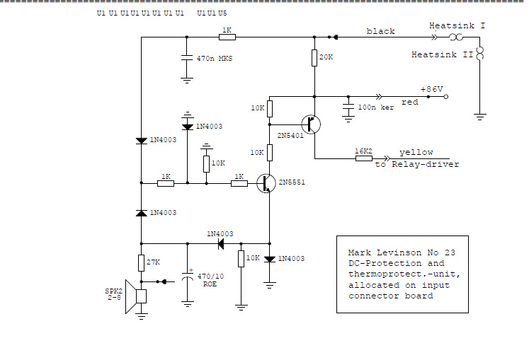

I found this on the Internet.
This is the circuit that permanently switches of your amp.
The base of the 2N5551 is connected to a 1k resistor, that is again connected to a 10K resistor.
Short circuit this 10K resistor and your amp won't switch of anymore.

Looking at your scope signal, this can’t be the reason for switching off.
When the DC protection is on the OL-2 board, it can’t be the reason either for switching off because this board is not connected as you said.
The only remaining reason can be a heat sensor that interrupts the power on state.
So is there something getting very hot ??
That brings me back to the question, what happens when reducing with the pot the voltage over the lamps to 25Volt.
Does the amp stays on then ?
Hans

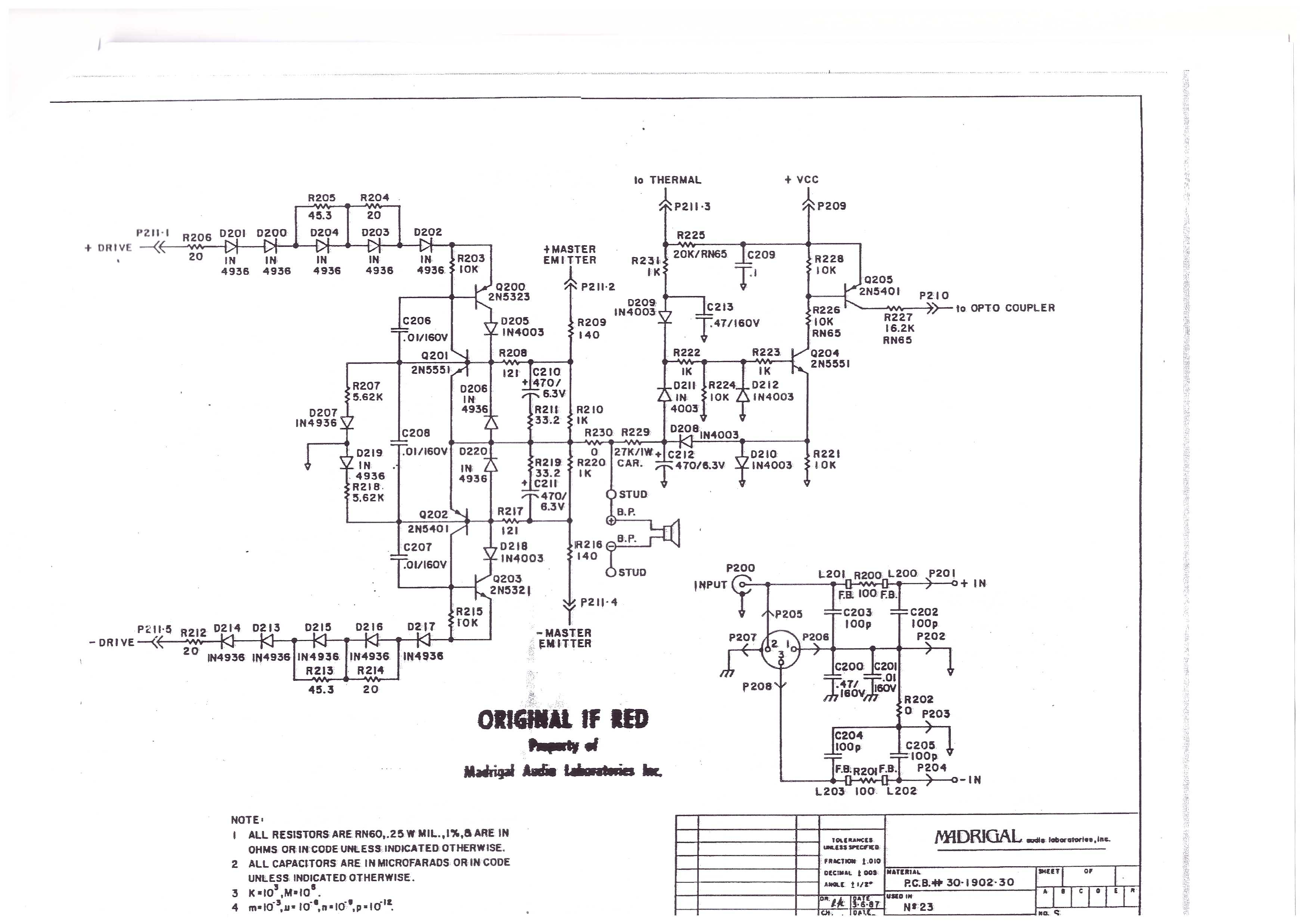

And here is the OL-2 board in total, including your schematic.
I would love to short that resistor but it is in difficult place, might need to take the board off. Need to think.
The complete OL-2 board is disconnected, right ?
But I see connection points going to “thermal” and another to “opto coupler”.
Can you show the missing circuit diagrams where those two signals are coming from.
Hans
In your posting #2 with the complete circuit diagram, I found two thermal switches on the bottom, TS1 and TS2.
They are only connected to the OL-2 board.
So this board must still be connected to these switches and to the “opto coupler” line.
I guess that you only disconnected the 4 connections to “master emitter” and “drive” but that the other connections ate still there, correct ?
So it seems that one of the two thermal switches is activating the “opto coupler” line causing the amp to switch off.
Where are those two thermal switches located and what is causing so much heat that they activate the opto coupler line ??
Hans

To confirm what I said about the thermal switches, you just have to connect 211 to gnd or unplug 209 from the OL-2 board and the amp will no longer switch off.
But that doesn’t solve the question why the thermal switch gets activated in the first place, that has still to be found.

Ok. I've got it.
In the mains line there are two switches that are relay activated.
K300 is the switch that is used to switch the Amp on and keep it on.
SW300 is the second relay, and this one can switch the Amp off when acitivated by the optocouples that triggers a triac below the relay.
So the most obvious reason that the amp switches off:
It become a signal to the optocoupler from Board OL-2 caused by a thermal sensor.
This can be checked by disconnecting P332 and P333, first one and then the other.
So when nothing is getting hot, we first have to solve this switch off problem.
Hans
