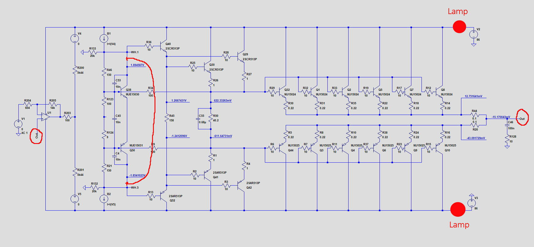

Again, So I think I am having a short somewhere in the ouput stage. If I power up the the board I hear some hum from the amp. Also the unreg voltage drops to somewhere 78V. I turned it quickly off. Without VCCunreg amp seems to work ok. For example the predriver is ok. Also Heatsinks were a bit warm.
How can I start checking where is the problem? Can I just disconnect some of the output transistors? Pairs of course. I have one suspect because the PCB was a bit ripped and I am not sure if the pin is really soldered from the other side of the board.
Short WH.1 with WH.5. and tell me if there is still a large amount of current flowing and if not what is Vout ?
Hans
Hans
And in case there is still a lot of current flowing with WH.1 and WH.5 shorted, insert two 40Watt 230V lamps. One in the +Unreg and one in the -Unreg line.
This will limit the current so you can measure the voltages on several critical points without the risk of burning components.
Hans
Hans

I have shorted WH.1 and WH.5. I have also put the lamp between unregs. The current between WH.s is now 1.1mA.

1) That you have inserted lamps can only mean that with WH.1 and WH.5 shorted you still had a large current flowing, right ?
That sounds very alarming, but I'm sure we will get it right at the end.
2) You mentioned that only 1.1mA is flowing from WH.1 to WH.5.
Without knowing the voltage at the WH's that doesn't tell very much.
So with the lamps still in place and WH.1 and WH.5 still shorted,
what are the following voltages:
1) On both sides of both lamps, so 4 voltages
2) +Vcc reg and -VCC reg
3) Voltage on WH.1/WH.5
Hans
Sorry Hans, I was not clear enough. I have only one lamp that I have connected between + and - unregs, like before. Then I shorted the The WH.s and measured the current.
Should I measure first the current and voltages in WH.s without the lamp?

What should have been done with the two lamps is to insert them in resp the +unreg and the -unreg supply.
See image below.
20Watt lamps are also O.K..
