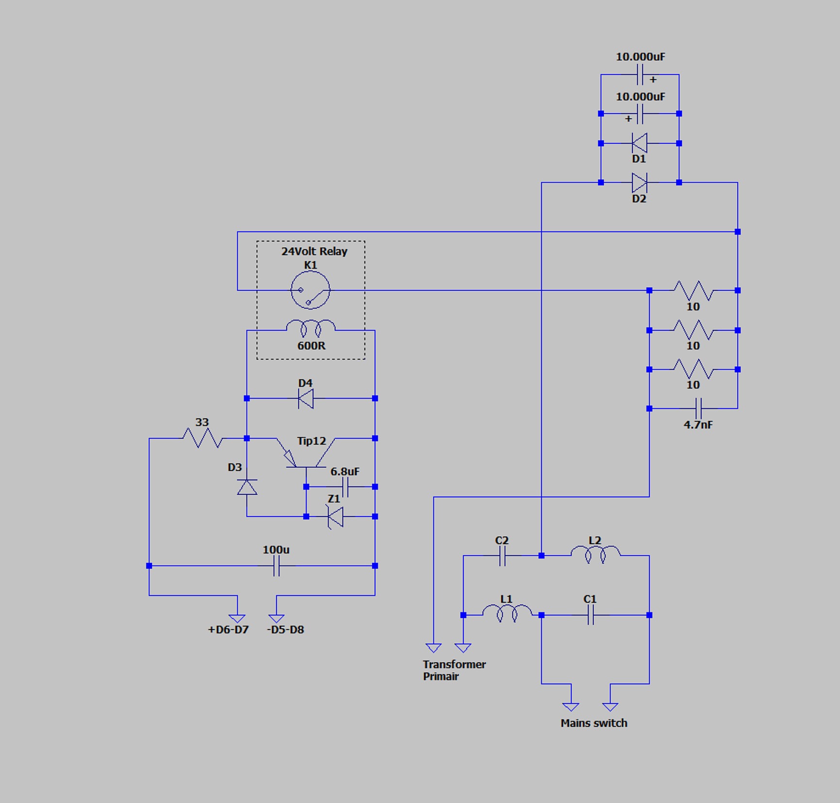

With the info on the PCB pictures I could complete the schematic.
The two 10.000uF are not in series but parallel, so positioning is correct in the picture.
I have re-arranged D3 and D4, to make it more obvious that D4 is to catch the flyback pulse from the relay when switched off and that D3 is to discharge the 6.8uF cap through the relay resistance at switch off.

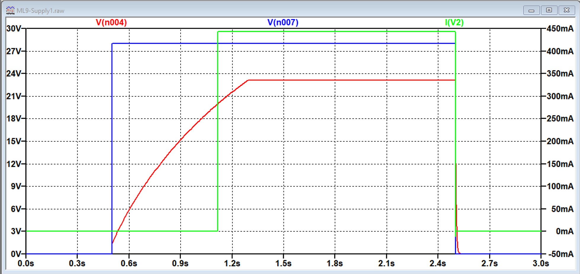

With the given component values and knowing that the 24V Relay has 600R DC resistance, I could simulate the on/off time, see second attachment.
Blue is the rectified voltage from TR1 at switch on and switch off, I assumed it to be 28V.
Red is the voltage on the Relay, limited at 24V by Z1.
Green is the current through the relay while switching on and off.
Switch-on time is ca 0.8sec and switch-off is almost immediate.

You're incredible Hans!
Your schematic is absolutely right, and its presentation is much more "didactic" than mine. And much easier to understand. And your calculation of the off/on time is probably exact too. I'll try to check with a chronometer if I can 😉
And it's also exact that switch-off is nearly immediate, as far as I can hear.
I don't know where you found the coil resistance value (data sheet?), but it is correct since I measured it at nearly that (597ohm if I remember). I should have this figured on the schema.

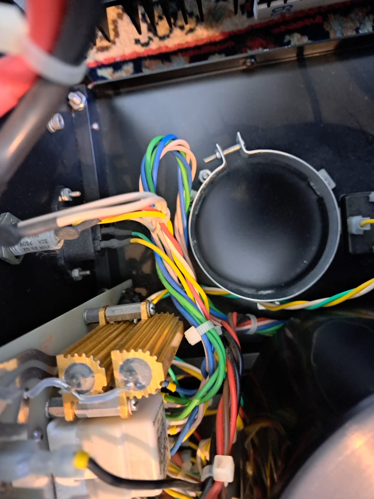

First question should be: what are those diodes doing ?
They are to block a possible DC voltage offset on the mains supply, thereby preventing the transformer going into saturation.
But since the on-off switching of these diodes may produce HF spikes, the two 10mF caps are there to suppress these spikes.
When using soft recovery diodes, this effect may be diminished but it will not completely remove the spikes.
So maybe ML has been experimenting with different diodes.

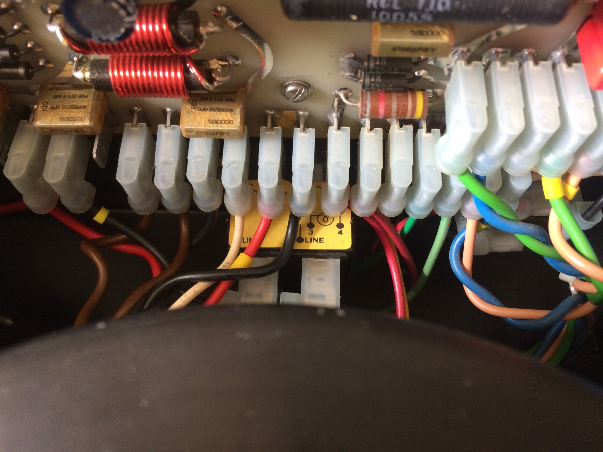

Probably from a given time on they decided to suppress the little network at all. In the case of my amp the Frako caps as well as the two diodes are just and simply missing, they have never been soldered. I also saw another board from a ML9 in which the area of the caps and the diodes D1 and D2 was occupied by the 33Ohm resistor which is normally right below the relay.

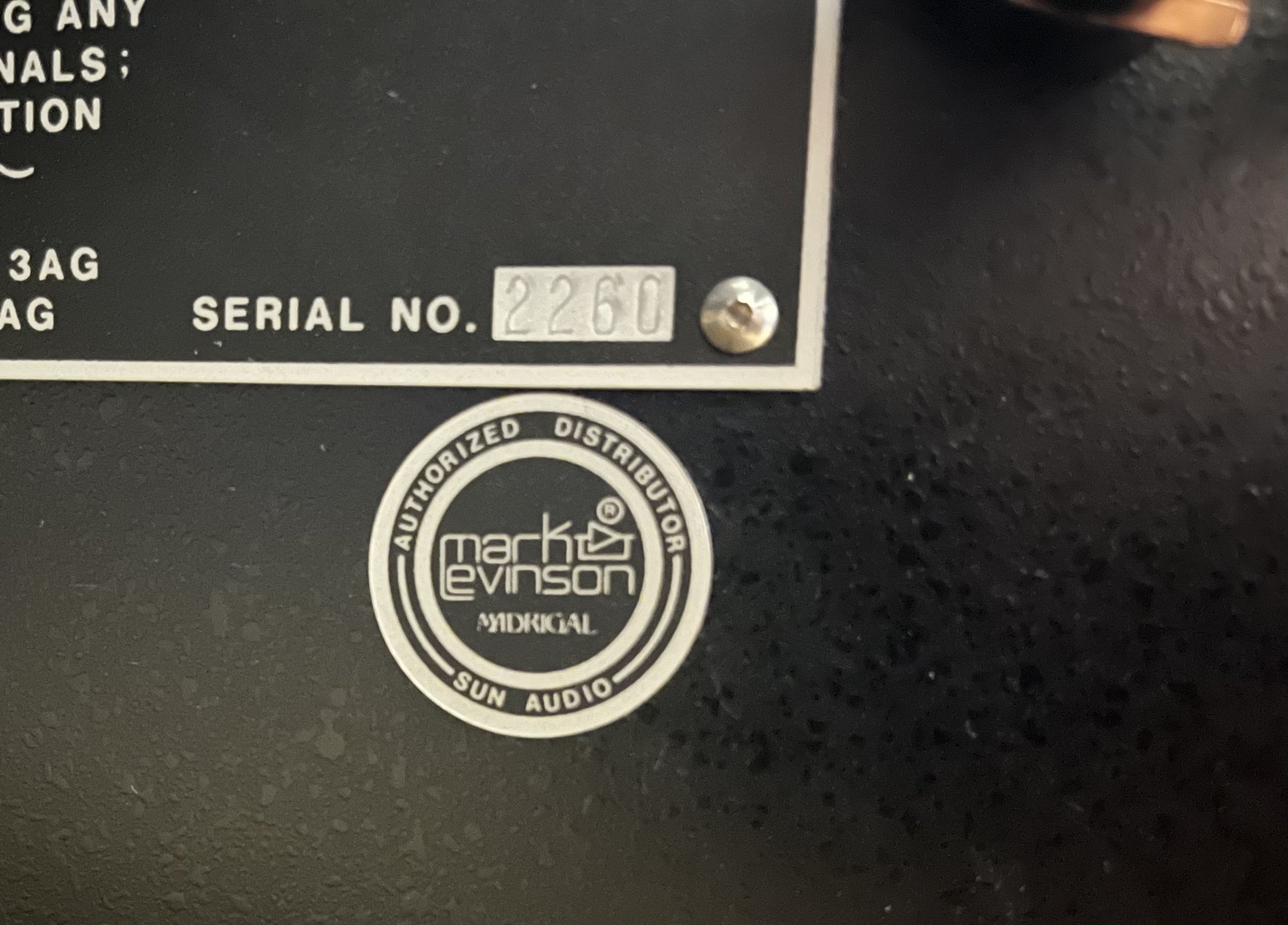

Jerome, given that your amp dates back to 1985, mine probably is from the same year or from 1986, which is already in the Madrigal era. One more little confirmation is coming from a little sticker on the back cover of my amp saying "Mark Levinson" and "Madrigal" right below
Yes Gaetano. Mine has no sign at all of any Madrigal signature. The faceplate is purely Levinson, old address. Madrigal took control of MLAS end of 1984 or at the very beginning of 1985, so I guess it's a madrinson. But I suppose they had numbers of faceplates already made in the factory.

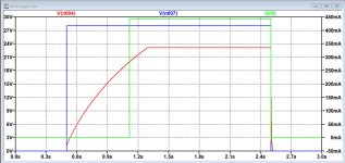

Hans
In my case, trying to estimate relay activation time by a chronometer, I obtain about 1.8 s to switch-on and 0.5s to switch-off.
Gaetano

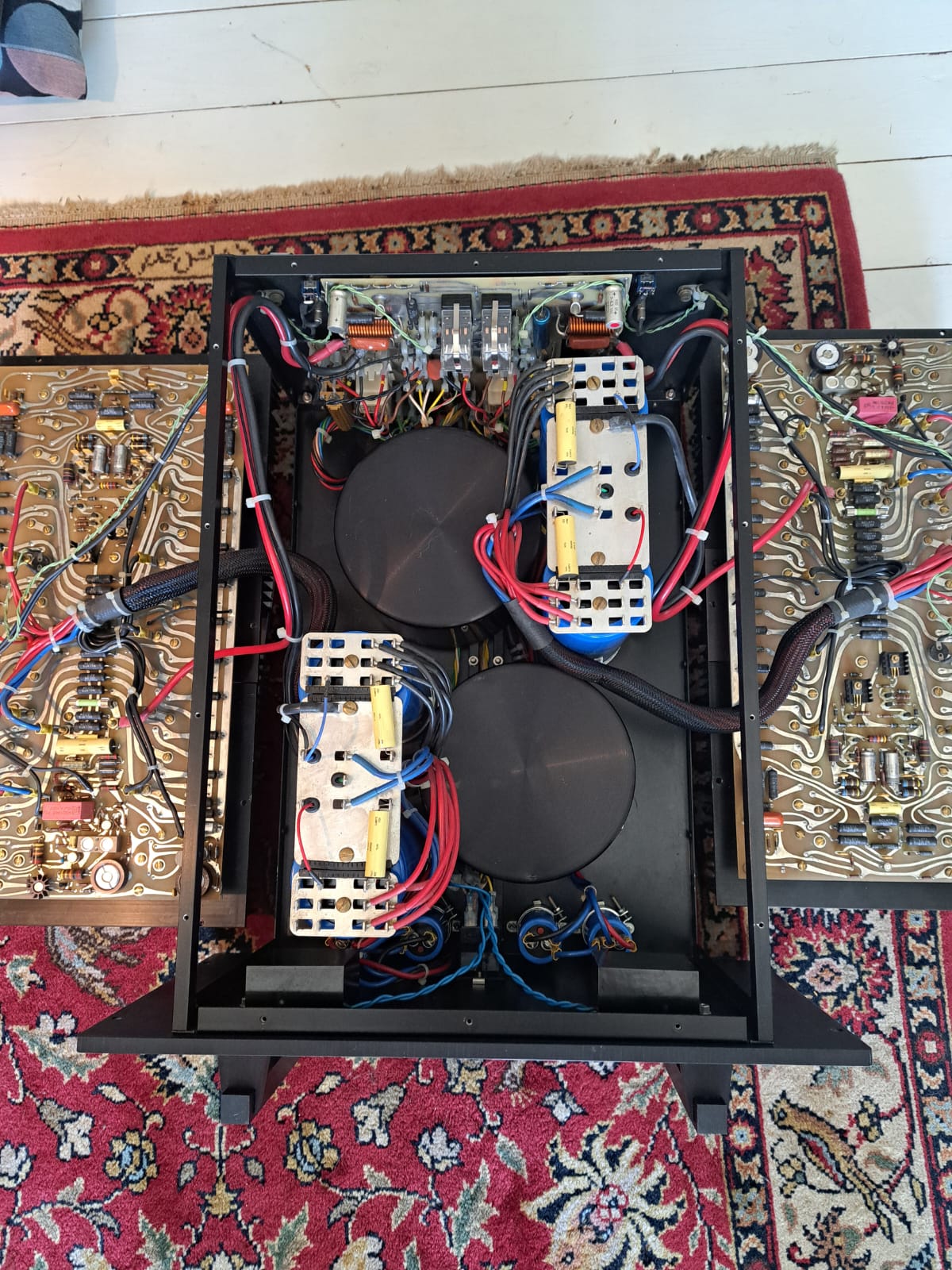

I've read this thread with much interest and little knowledge/insight on my part that is. 😉
I will get its bigger brother the Levinson ML-3 next Friday and will replace all 40 years old lytics also the big blue Spragues.

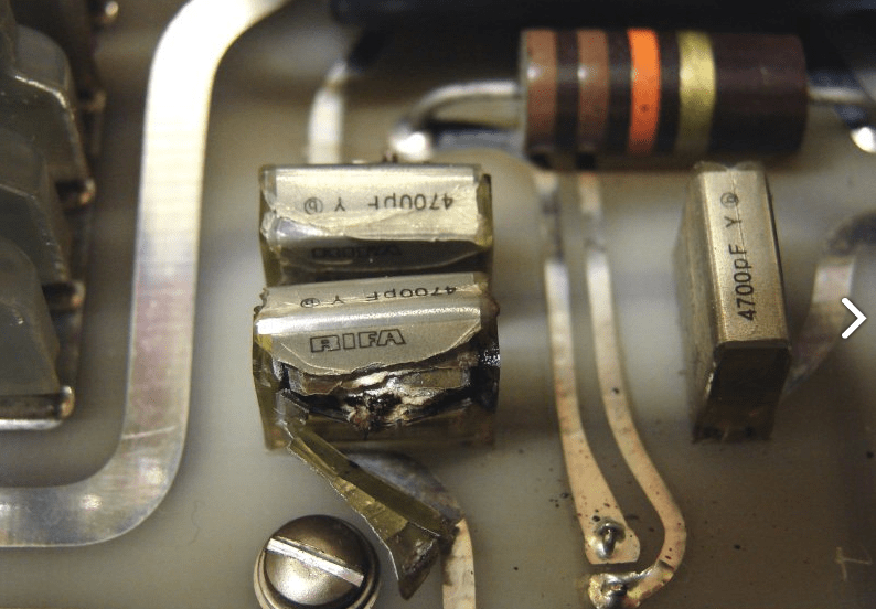

So far as I know I do not have those yellow/brown plastic RIFA 4700 pF caps inside:

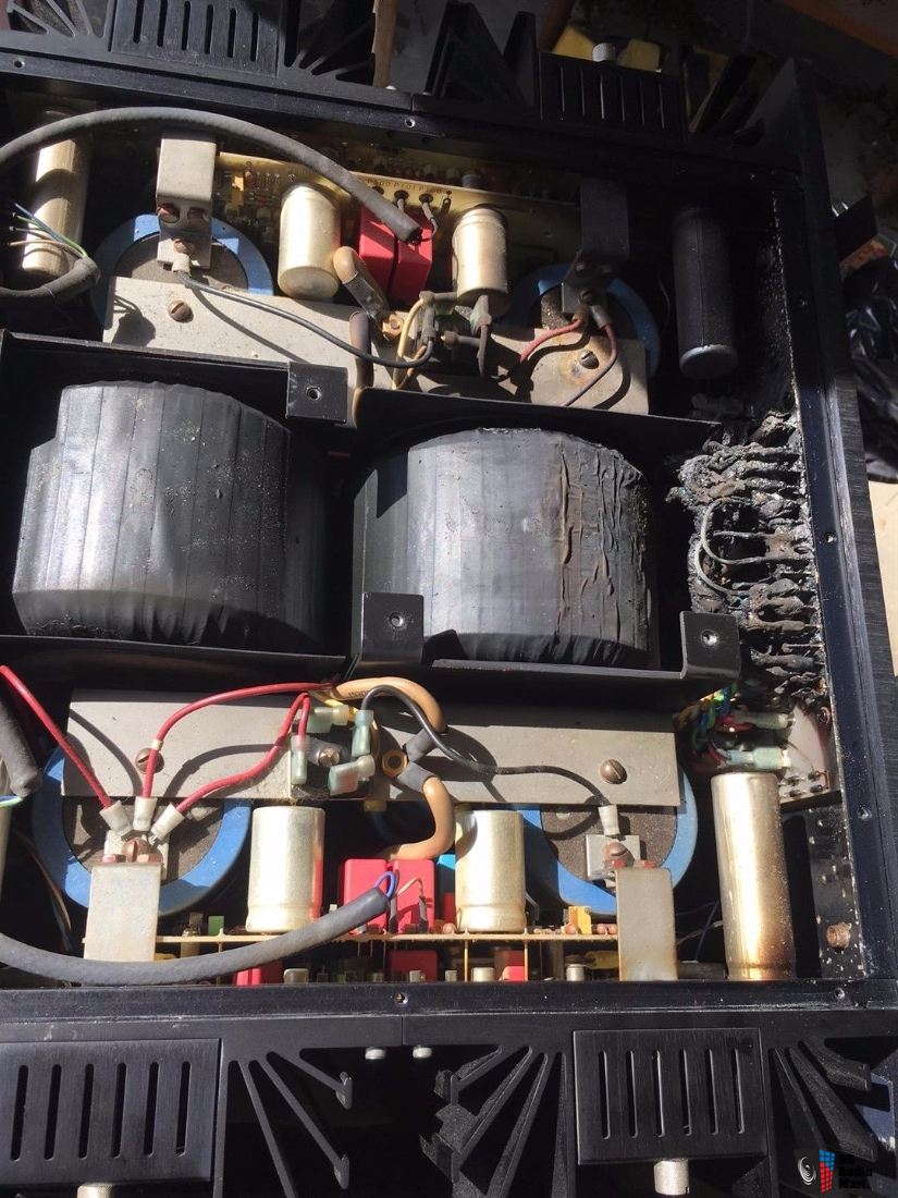

Madrigal kept on using these caps in their No. XX successors and allegedly they could destroy an amp like the No 23.5.

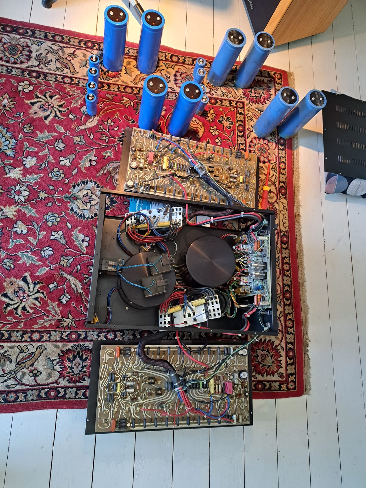

Thanks. I just finished the revision of the blue Sprague filtercaps.
It's a complete mechanical job of course but it took me 4 hours with this big amp.
The unit was complete original only very dusty so I could clean the inside and the faceplate and handles.
I find this amp very intimidating to work on because everything is so big.
Starting meant a household circuit breaker went out. Had to use a variac...
ML3 revision pic12.jpegML3 revision pic2.jpegML3 revision pic4.jpegML3 revision pic6.jpegML3 revision pic7.jpegML3 revision pic8.jpegML3 revision pic9.jpegML3 revision pic11.jpeg
Impressive, yes!
I remember for the much smaller ML-9, and it was the first "big" amp I was touching.
I would recommend to check the two 672 Sprague on the DCO board. 680µF/6.3V on the ML-9, I guess not much different on the ML-3. If they're old, they are possibly crunched.

i think this functional description is a bit off.
it's more that the caps are doing the blocking of DC to the transformer. the rectifiers are there to protect the caps from excessive reverse voltage. we've had long discussions on these circuits in the past on the site. Rob Elliot has a pretty good description of the circuit function with comments about parameters to be careful about here: https://sound-au.com/articles/xfmr-dc.htm. To lend some confidence to the concept, Bryston uses this approach in their amplifiers. Yes, those same amps with the 20 year warranty!
