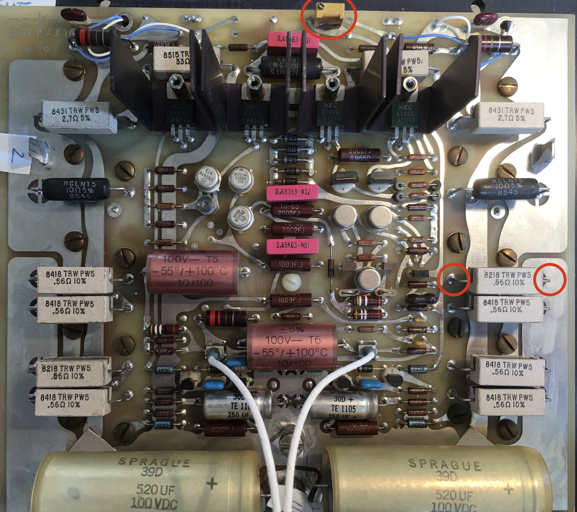

Yes, you are absolutely correct. Actually I was referring to the missing components, the resistor is just burnt in an evident way. I have also found a picture on the web depicting another board from ML9 with a layout different from mine and @perelman 's too.
Honestly this makes me feel a bit more relaxed because this means that the board I have is not the result of someone playing the little electronic engineer 😀

I can say that the relay is not - at least on my amp - warm or hot. Which seems normal. Just in case, I've got one spare, bought in the US. Not easy to find at a reasonable price I must admit.
Indeed, much fewer components. The 10Ohms RCL T10 get very hot and also the TIP, I touched them after afew minutes with power on.
The shell of the relay is brown probably for the spark that came out when the pin of the 33Ohms resistor underneath melted down.

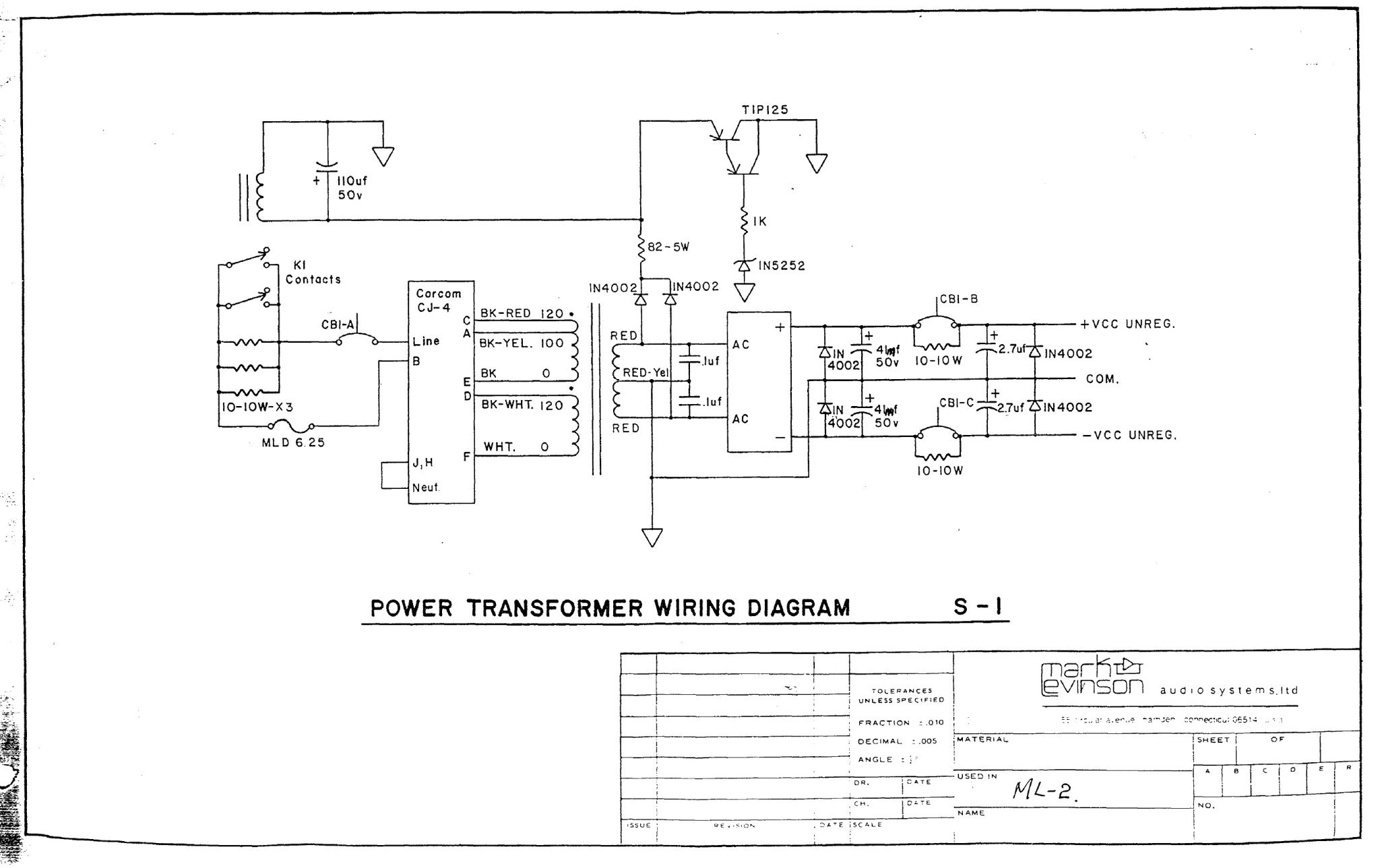

It's the power supply from the ML-2.
You see the same 3x10R resistors for surge control when switching on.
And also the two diodes and the Tip125 to switch relay K1 on after some delay, thereby shorting the 3x10R resistors.
So the assumption that the circuitry was meant to block DC was wrong.

Dear @Hans Polak , this is much appreciated. I think now it is almost consolidated that this circuit is to limit the inrush current and the schematics from ML2 confirms this.
Hi, I decided to open the case again to adjust the bias according to the instructions above. At the beginning I measured 12mV across the resistor on the left channel and about 33mV on the right. At the end of the adjustment I had about 24mV for both with a temperature on the case so the finals of about 45C.
After about 90 min of low volume sound the voltage drop was around 27mV for both. Is this raise normal?
Stabilization takes at least one hour and Bias increase from 24 to 27mV while stabilizing is to be expected.

After about two hours the left channel is at 24 mV while the right 23 mV, I will give a very small turn and then I will close the chassis, It's fine, isn't it?
I understand, I'm always very cautious when doing things inside when power is on.
You can do that but just put the cover above without putting the screws back right now. The cover won't be perfectly closed but you don't mind. The trimmer sensitivity is not easy to feel exactly so sometimes it's too much or not enough, you'll see that tomorrow. Even if a 1mV delta between the 2 channels is almost nothing and cannot be really heard I'd say (at least with my old ears 😉. If it is satisfying for you, then it's OK, and il seems to be OK like it is right now.

Good morning. It is now fun time with the amp, I moved the bias up a little bit, now it is about 28mV across the emitter resistor 🙂. It is holding the value quite well, at least for the time being. The temperature on the dissipator is about 48C so, given @Hans Polak 's suggestion I should rise it more.
The sound is somewhat dry if compared to the Quad previous power amplifier I used, do you have the same experience?
Moving to the broken resistor that @perelman highlighted, I still wonder what can be the consequence of using the amp without it, as I am doing it now 🙄
What I understand by examining the available pictures is that, the missing 33Ohm resistor makes the relay always open so the three resistors RCL TIO 10Ohm are never shorted (by the way, they are quite hot during the amp operation). This means that the current is always flowing through the resulting 3.3Ohm resistor down to the board connector array. This is definitely not nice

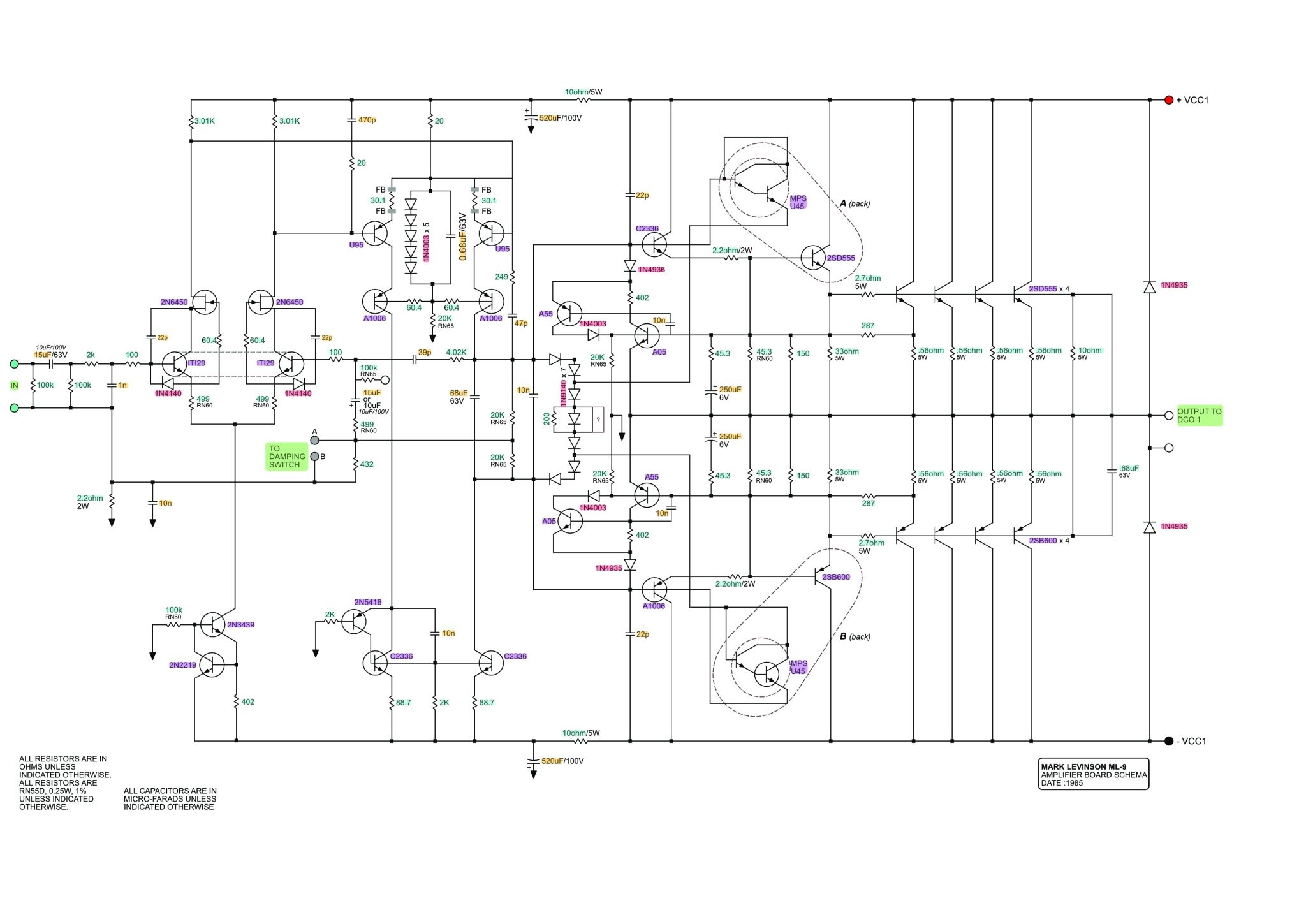

One more note about the bias topic. In the thread Mark Levinson ML-9 bias (thank you @perelman ) it is said that the idle current of the power stage should be 260 mV. Then "This is divided over 4 transistors giving 65mA", why 4 transistors when I see 5 of them? Probably I am misunderstanding...

Hi Gaetano, you're right, there are 5 transistors, but as far as I understand the schematics, one is a pre driver. This would let 4 transistors as the output stage. That's what I understand, more experienced and experts will correct me if necessary. But anyway, this calculation would give around 36 mV which seems little bit high to me. As much current will make the amp heat quite a lot. I would stay below 30 mV, at least that's the maximum I went to on mine.
