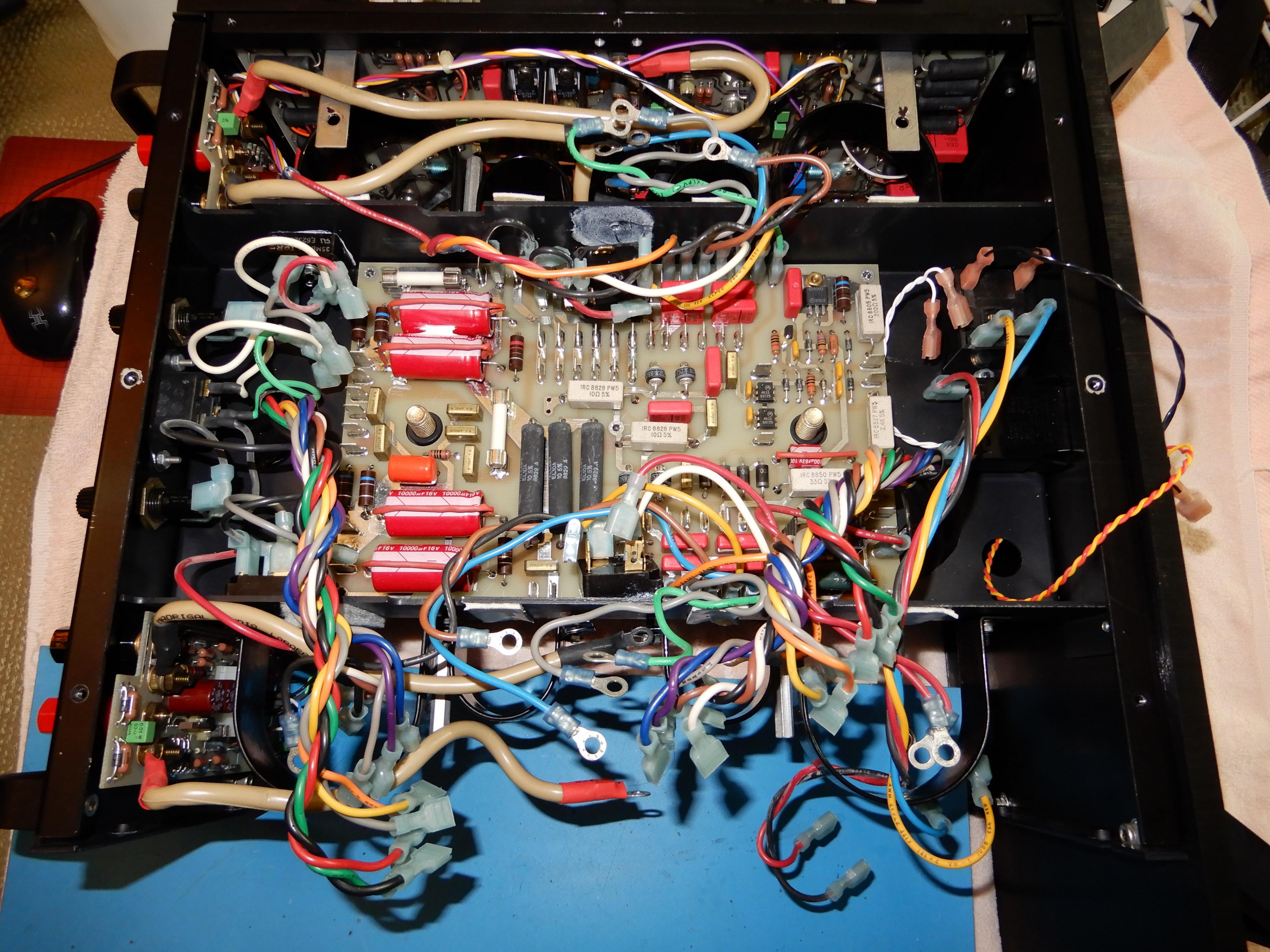

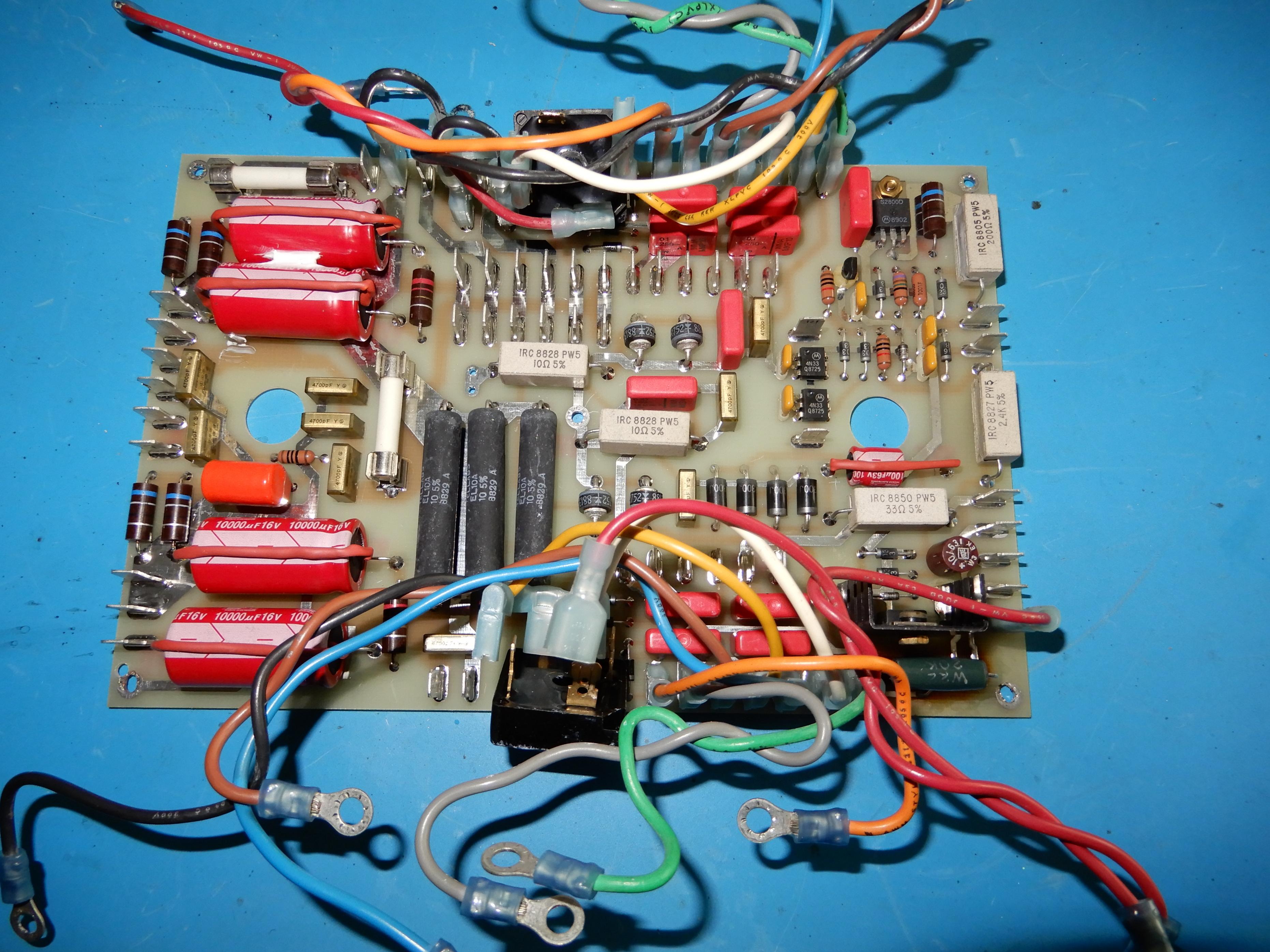

By the way, I just took the transformer out (with the proper adhesive tapes to locate the 20+ contacts when I'll set up all things together later). I could take the regulation board out (the one with the Frako caps) and I add a picture of it.

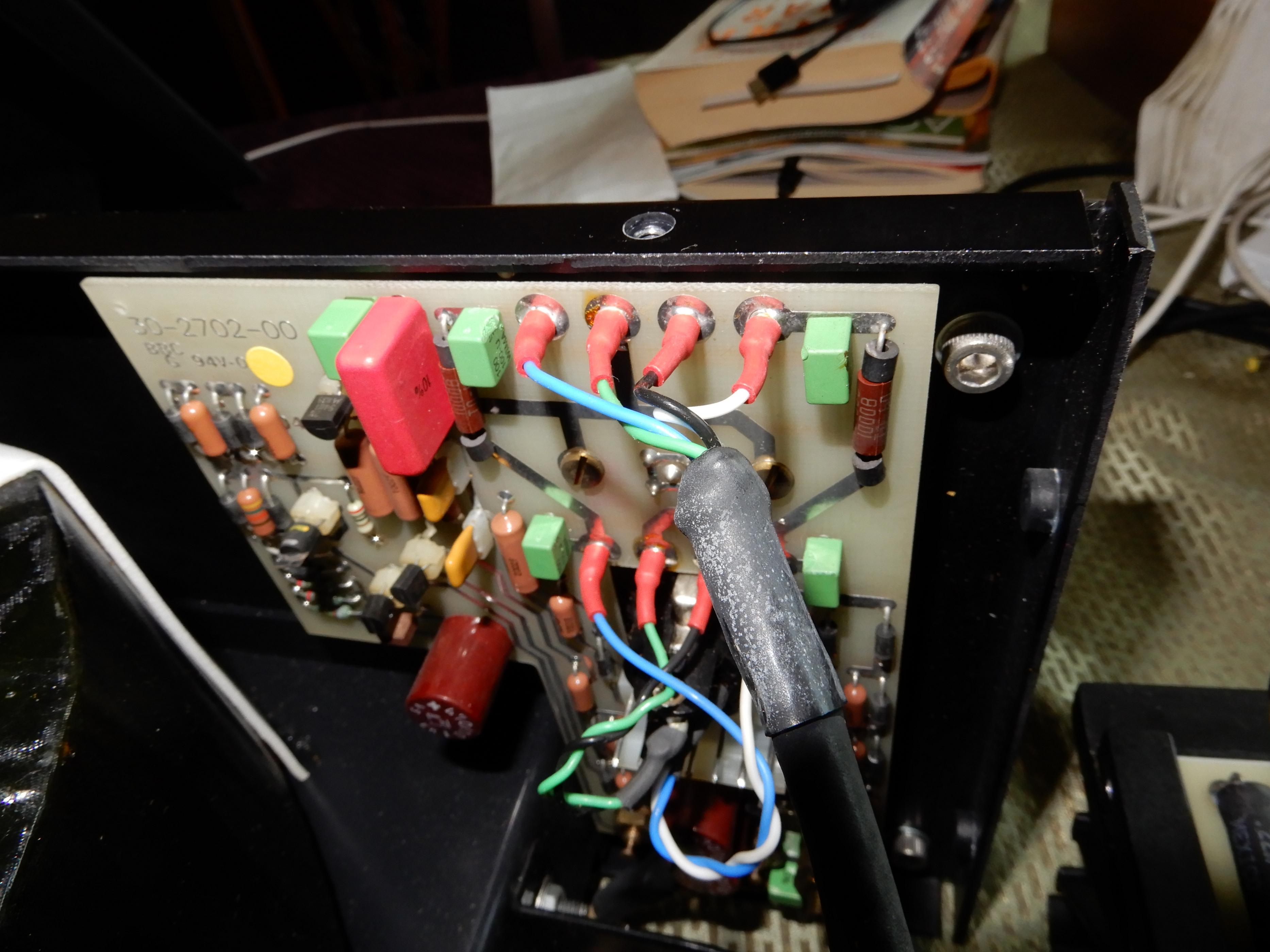

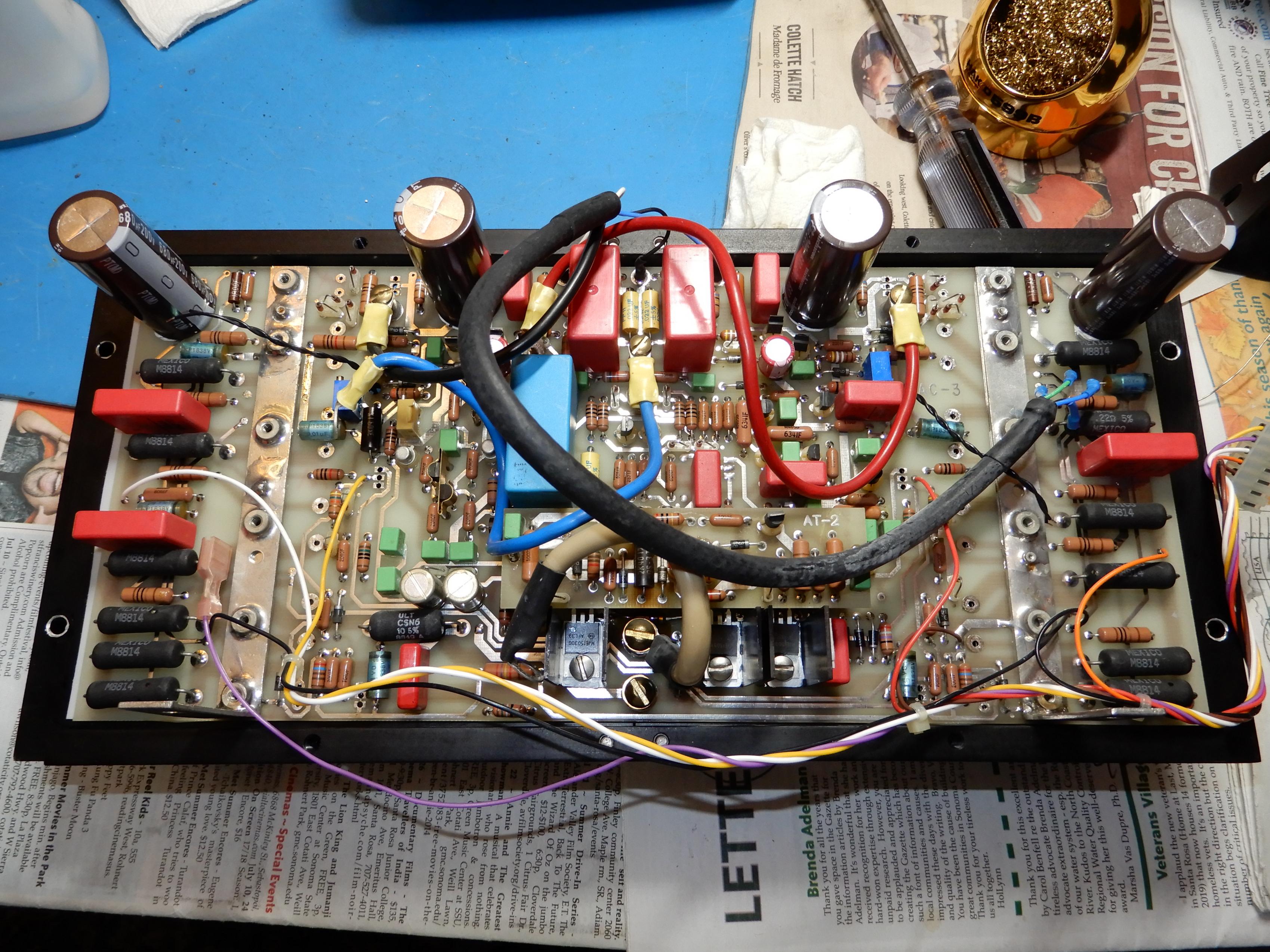

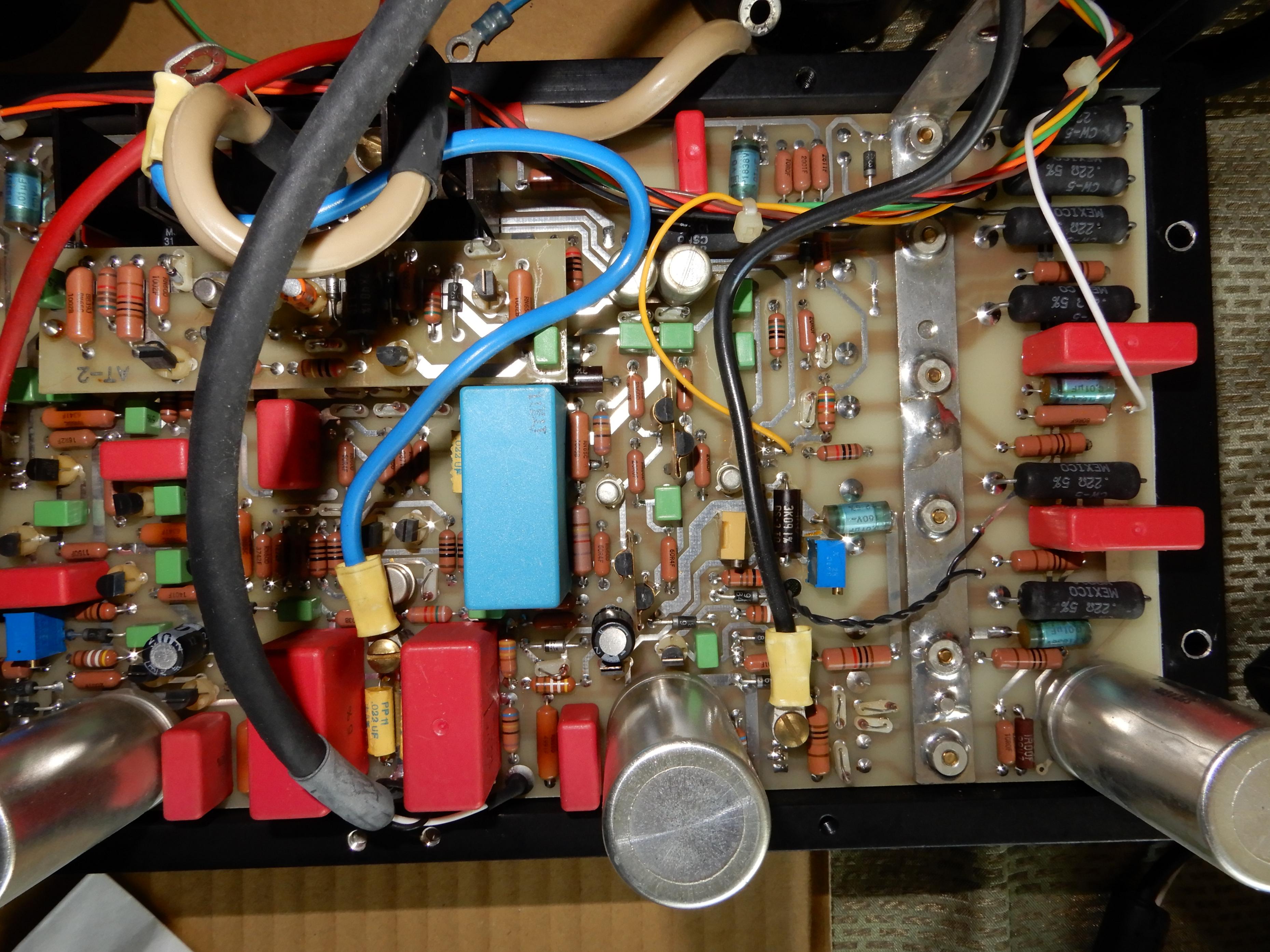

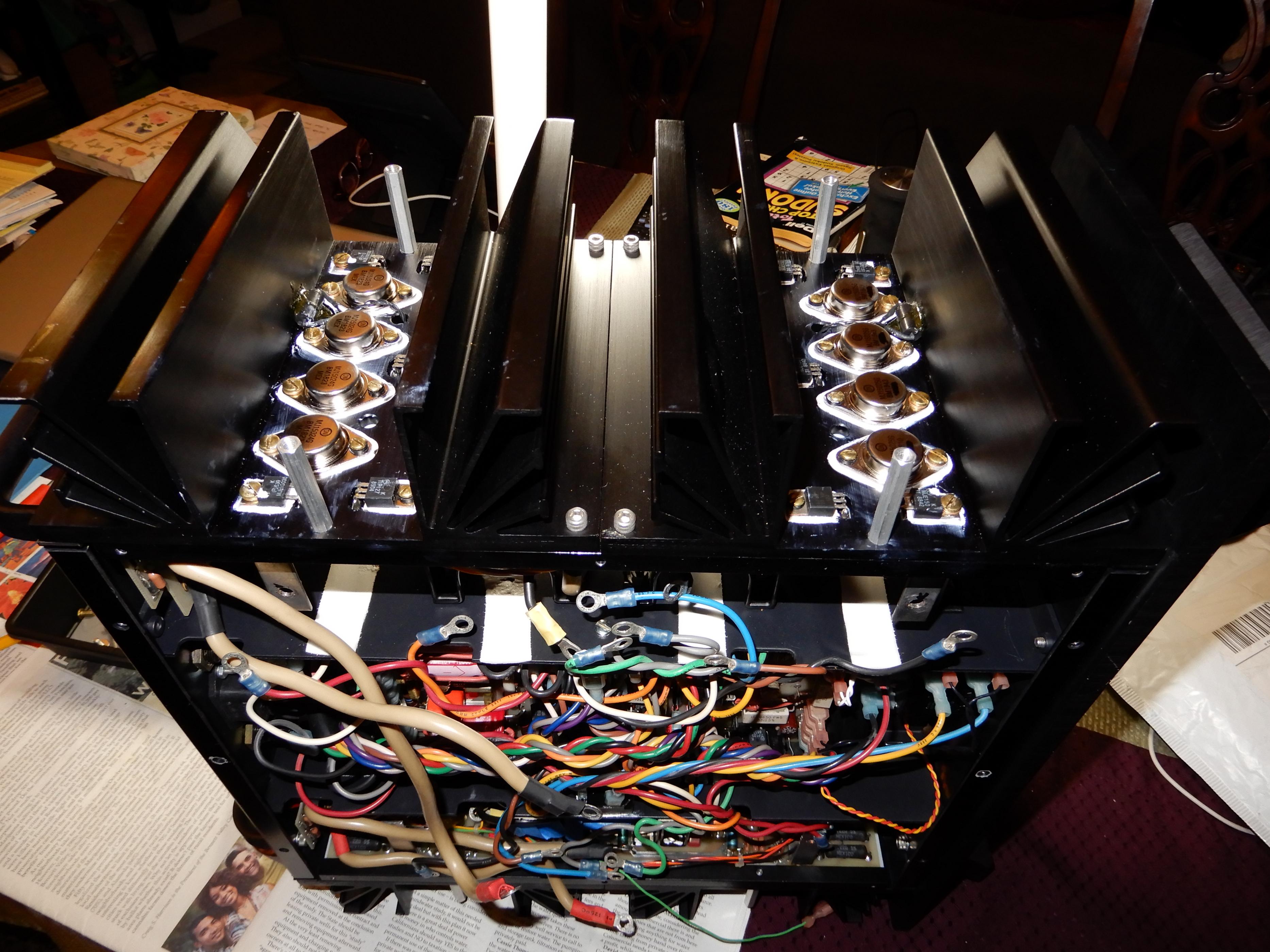

Although my Levinson No. 27 is a bit different from your ML-9, there are many similarities as I'm sure you know. I recently completely replaced all electrolytic caps, even though some still tested fairly well. I did remove the modules from the chassis, and desoldered all of the transistors to allow access to both sides of the boards, because trying to desolder caps from the top would not have been possible.
It was a lot of effort, but paid off because I was able to test each of the output transistors and drivers out of circuit, and found that there were many output transistors that were way out of range, substantially below and mismatched compared to the others. I had only one through-plate for a cap let go on me, but I was able to ensure proper solder connection with the new capacitor.
The main filter caps had to be manufactured, and that took about 3 or 4 months. They are the same used by ML service facilities, but with larger lugs, so I had to enlarge some holes in the ground bars connecting the caps, which was no big deal.
It was a LOT of work, and ML service shops charge a lot for the parts and the work (I was quoted $2,500 - more than the amp cost me), but they also do some updates to the boards which I did not do, and they would not describe.
End result is that the replacement of the bad output transistors probably had a greater positive effect than replacing the caps, only 4 of which were way out of spec., and the amp sounds truly wonderful now. It was a great disappointment to me before this work.

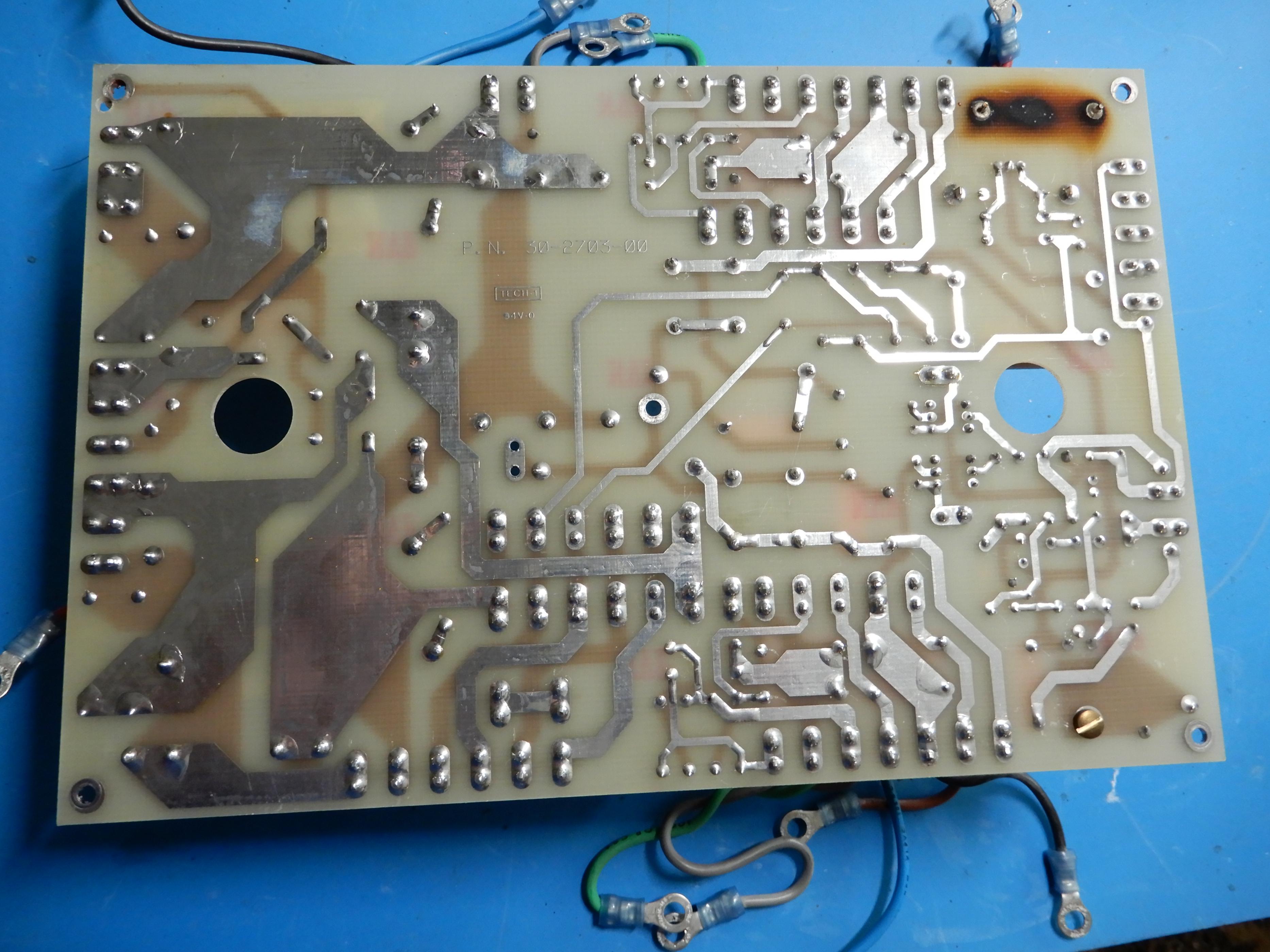

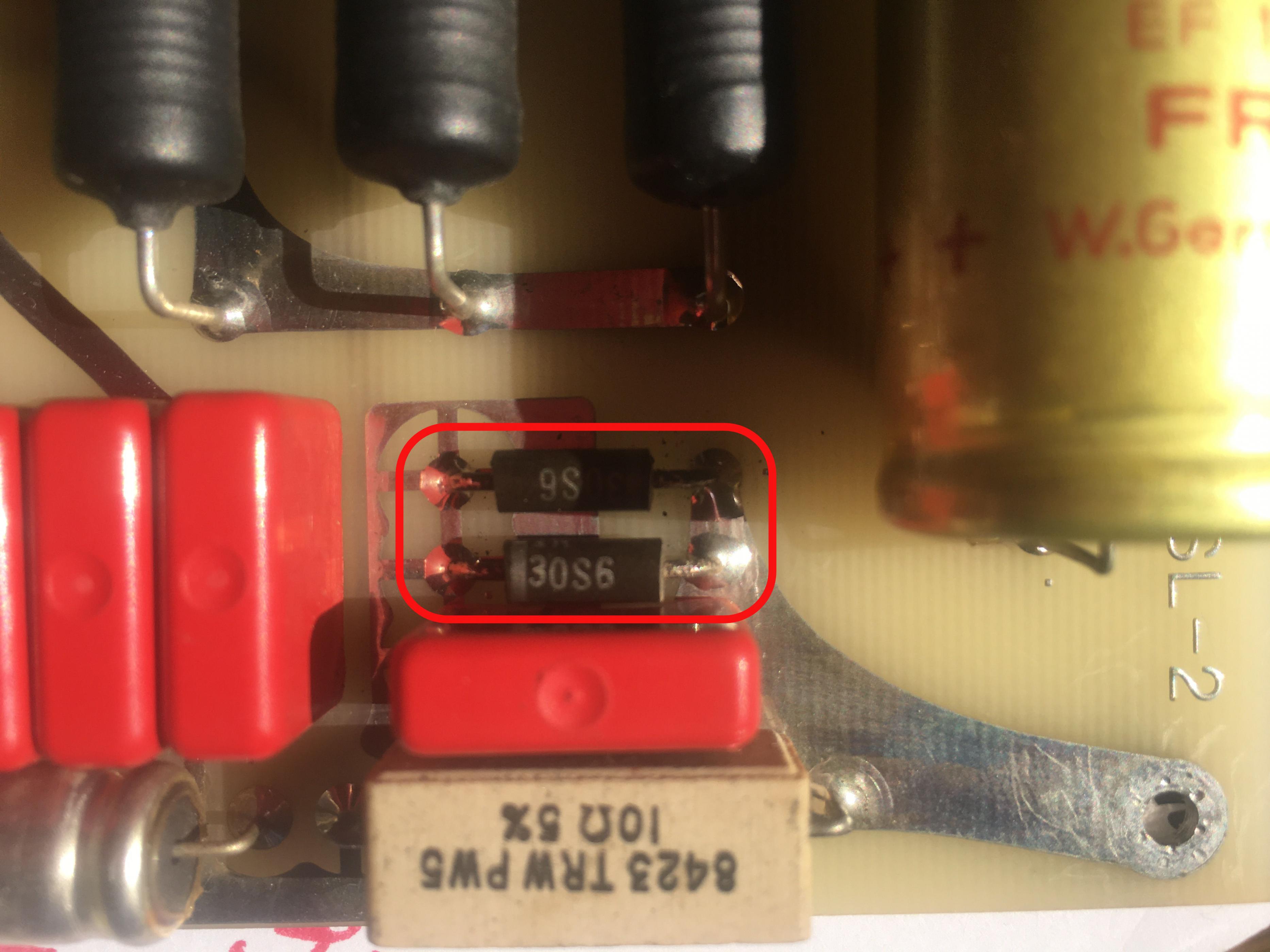

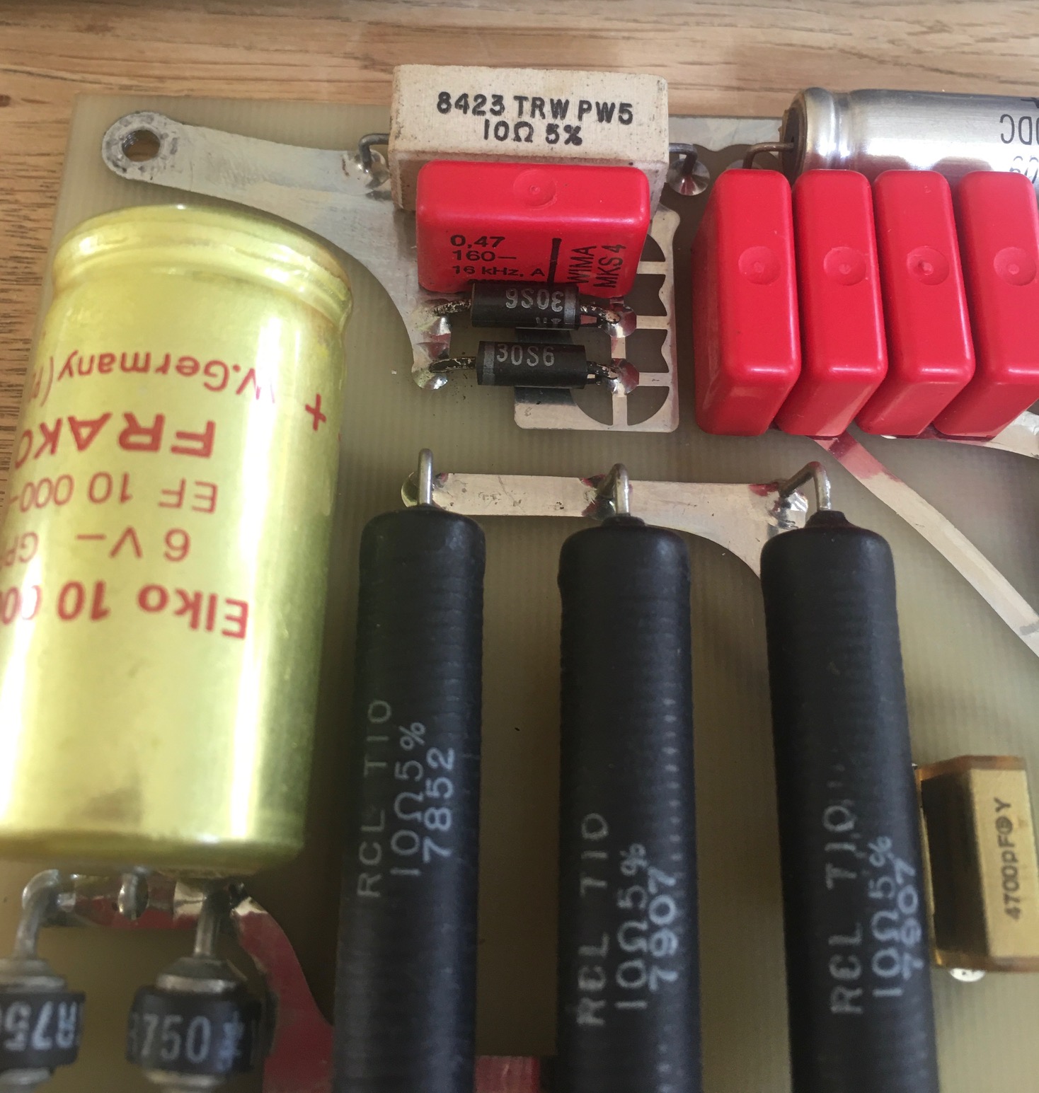

Other subject: diodes on the power regulation board (30S6 rectifiers) . One is dead (at least one). Next message with picture.
The out of order diodes on the "power regulation" board (dunno of it's a correct designation?)
the two 30S6 marked rectifier diodes are out of use. more generally, some of the leads of the diodes on this board are "blackened" like they would have been heating too much. But except tase two, the others seem OK. But I could change them all.
What references would I go for? (datasheet here)

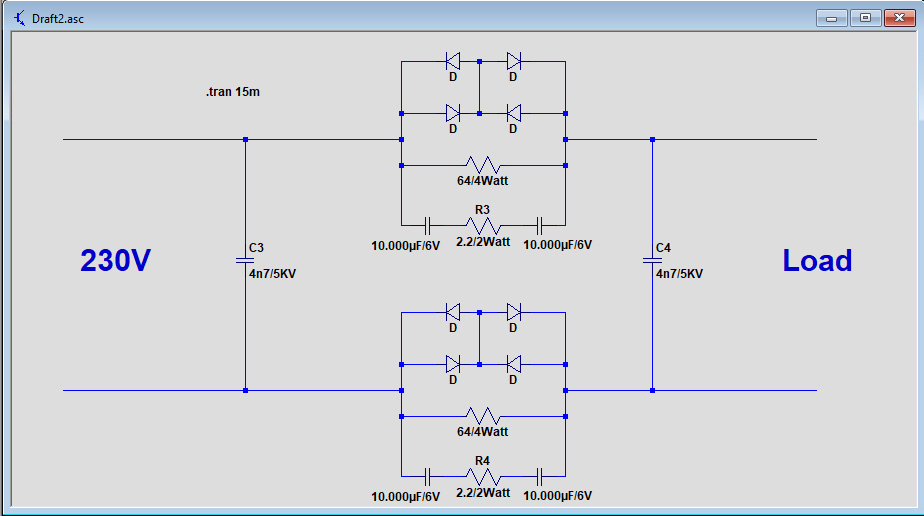

You showed a circuit diagram for the Amp, do you also have one for the power supply ?
Two anti parallel diodes in a power supply are mostly used in parallel to a resistor that's in series with the mains supply to suppress DC.
If that's the case, it could mean that your supply is only working on half of the 230V/50Hz sine wave !!
Apart from that, there's nothing special to these diodes so easy replaceable.

Unfortunately no, Hans. What I can do is take a good picture of both sides of the board. I could even - if I take some time to do it - draw the schema. It could help beyond my own problem 😉
Here is a photo of the 2 diodes with their immediate connexions.
Beside, if my supply has been working on "half" of the sine wave, does it mean that half of the power is delivered? and/or that it could create some "tensions" on other components?
I'm curious to know more about this. As I was surprised to discover these faulty diodes...

Hi Perelman,

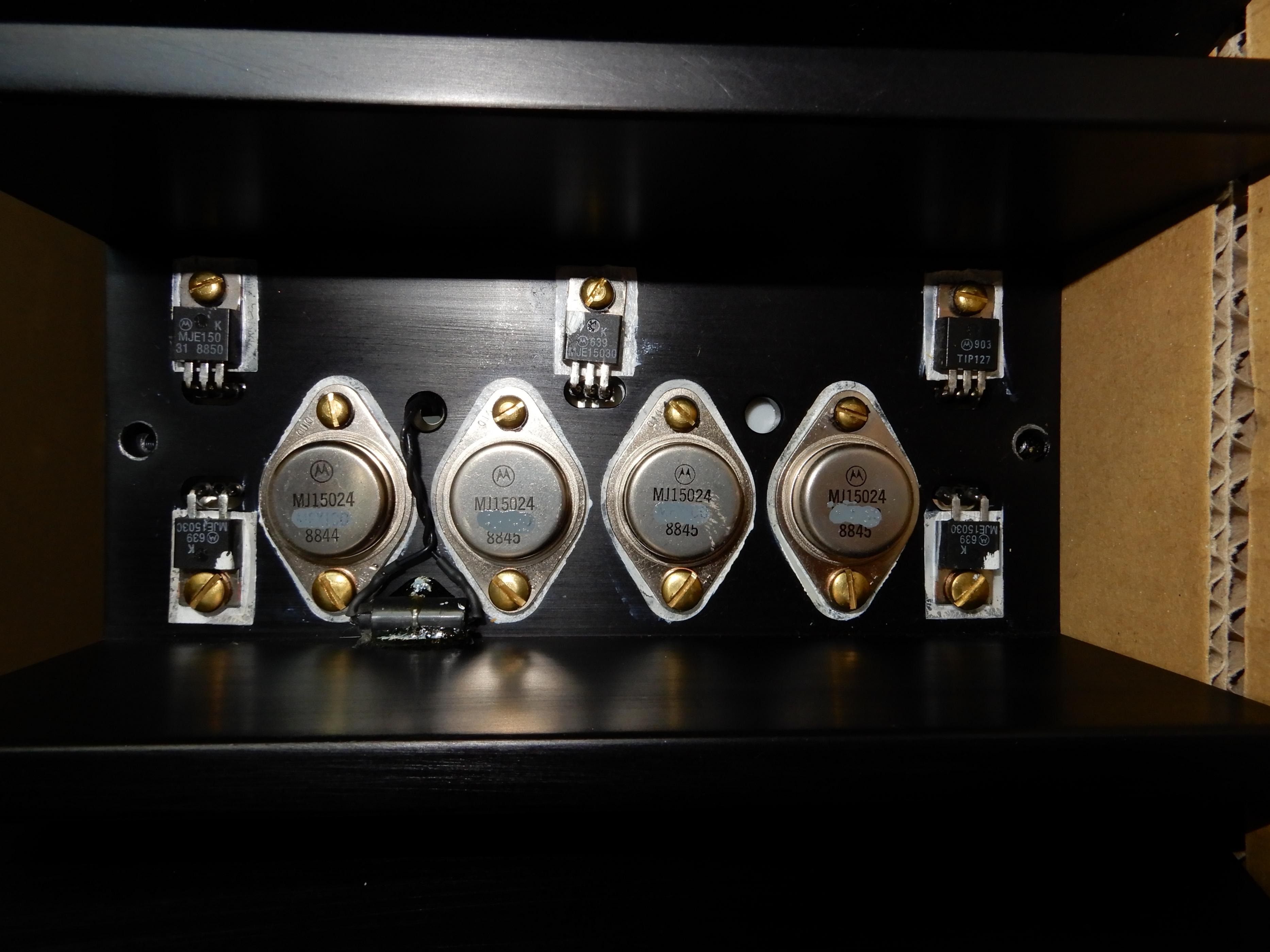

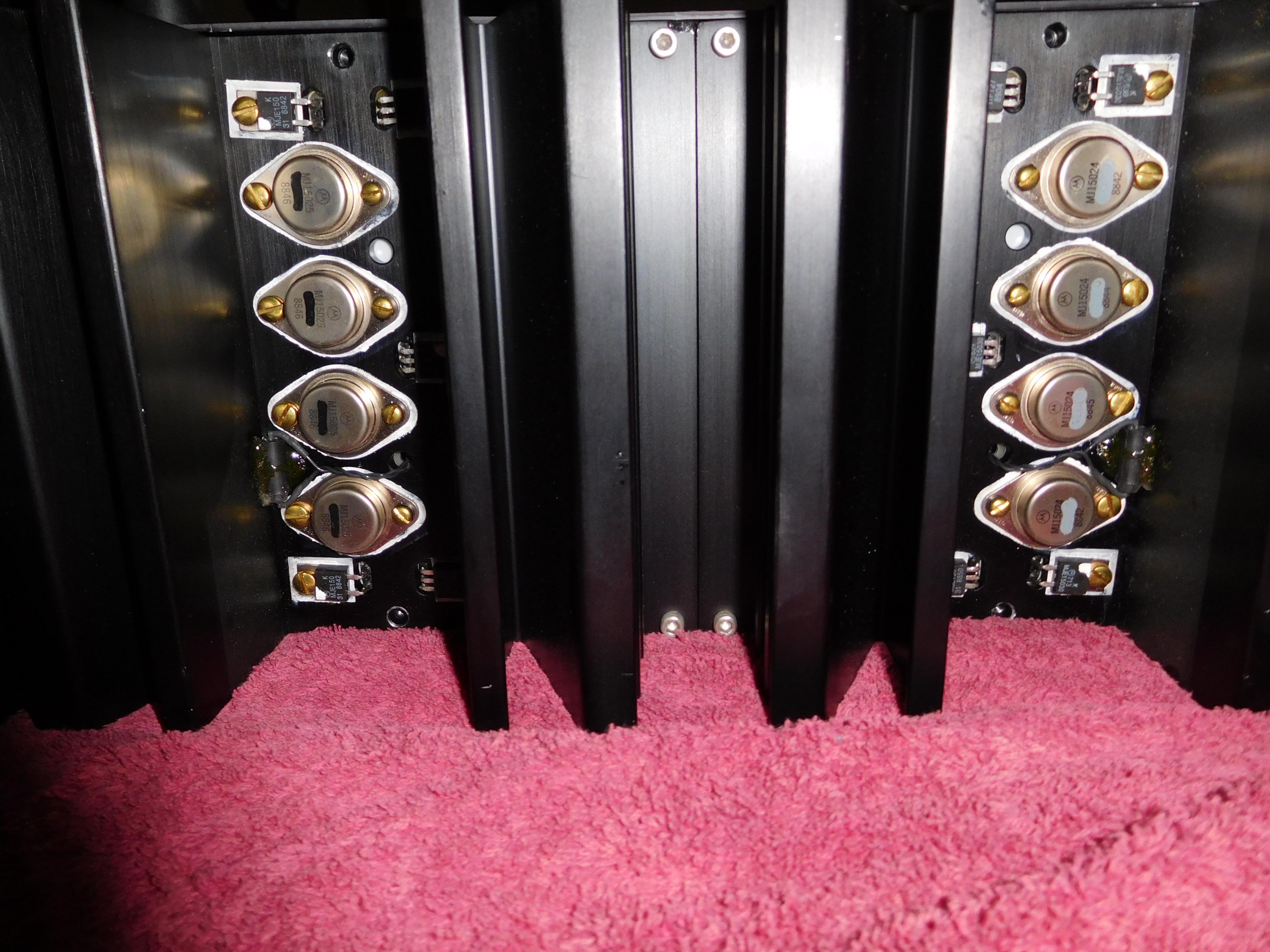

Though the layout differs somewhat, particularly the main filter cap arrangement, the mainboards appear to be very similar in the way they are mated to the heat sinks, and in the mounting of the output transistors through the exterior of the heat sinks. There are other similarities as well. Photos might help. these are just before and during disassembly, showing original caps and transistors.
Fortunately, the output transistors are still in production - MJ15024 and MJ15025. I figured my repair costs were so low compared to what I was quoted for re-capping and updating the input boards but no other parts replacements, that I bought enough replacements to put together matched sets. At first I just replaced the weak/out of spec parts after selecting ones that matched the remaining originals, but then I decided I still had enough money to just replace them all.

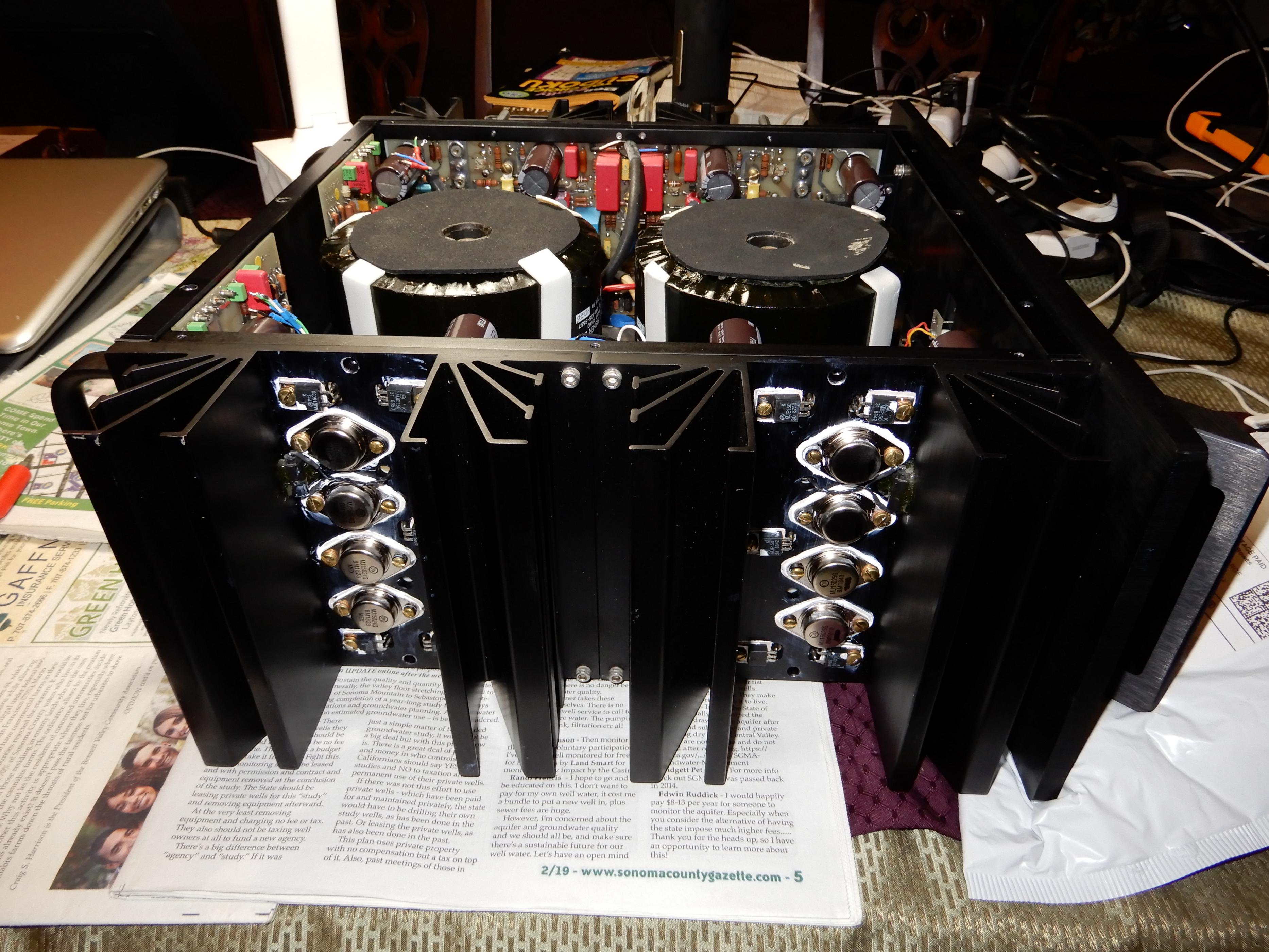

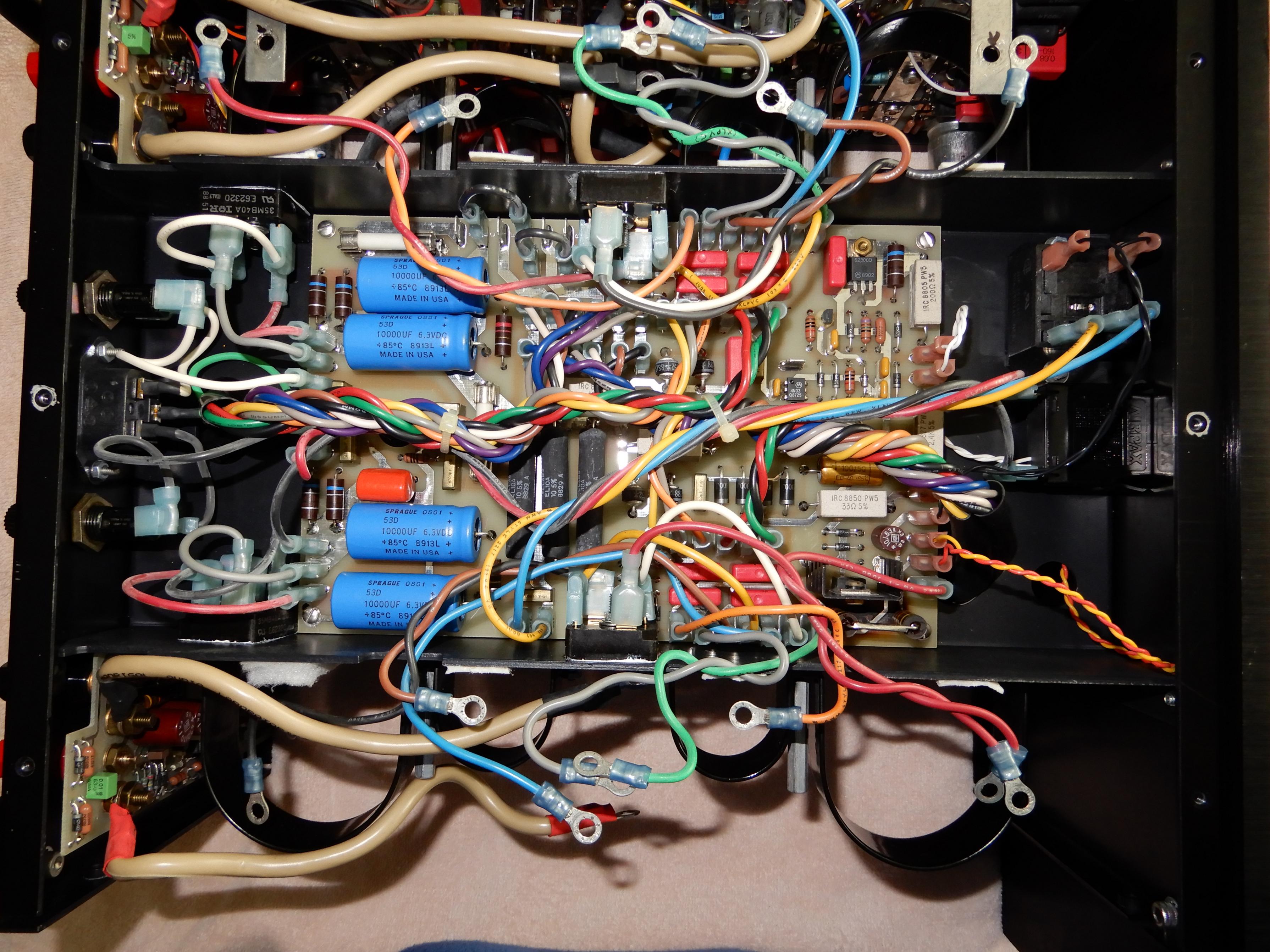

More photos. further disassembly. Burned mark on power board is from LED resistor, which I changed for a higher current one, slightly higher resistance, and elevated off the board, which I sealed with conformal coating.

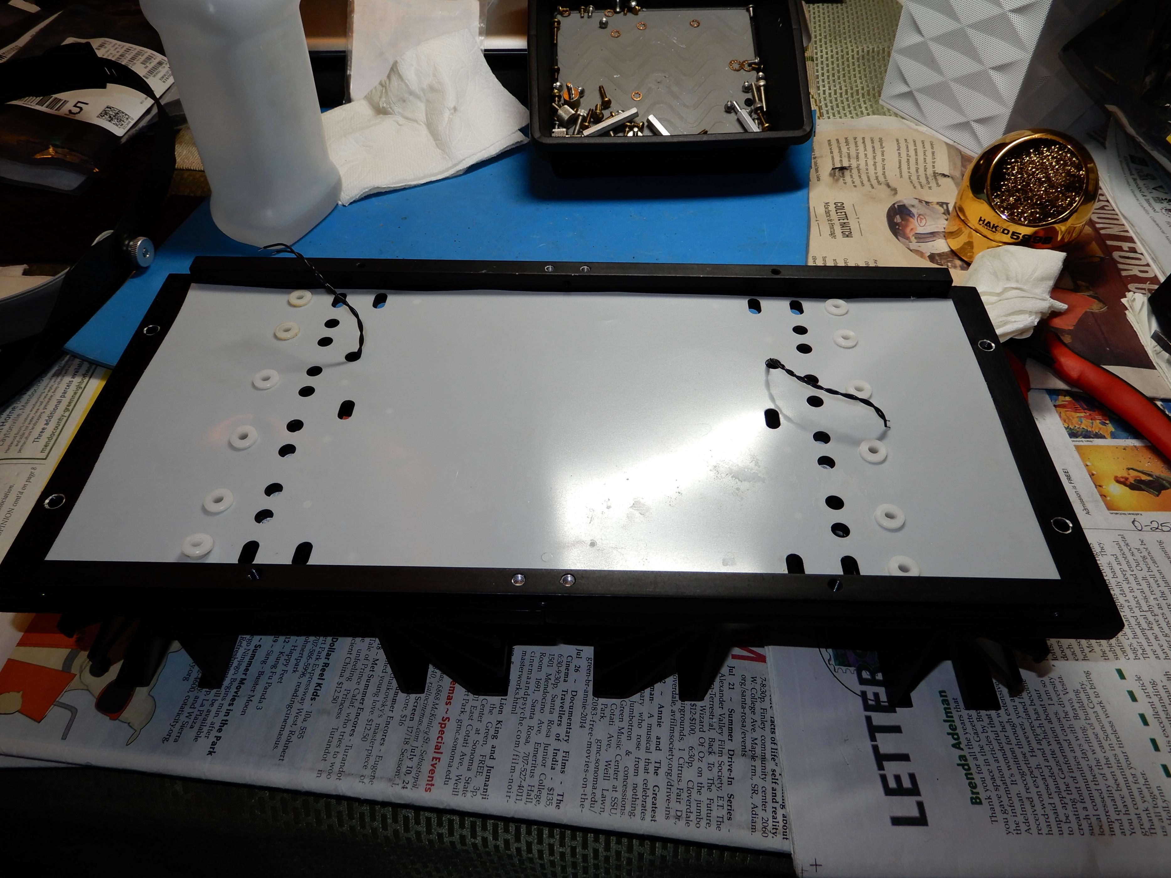

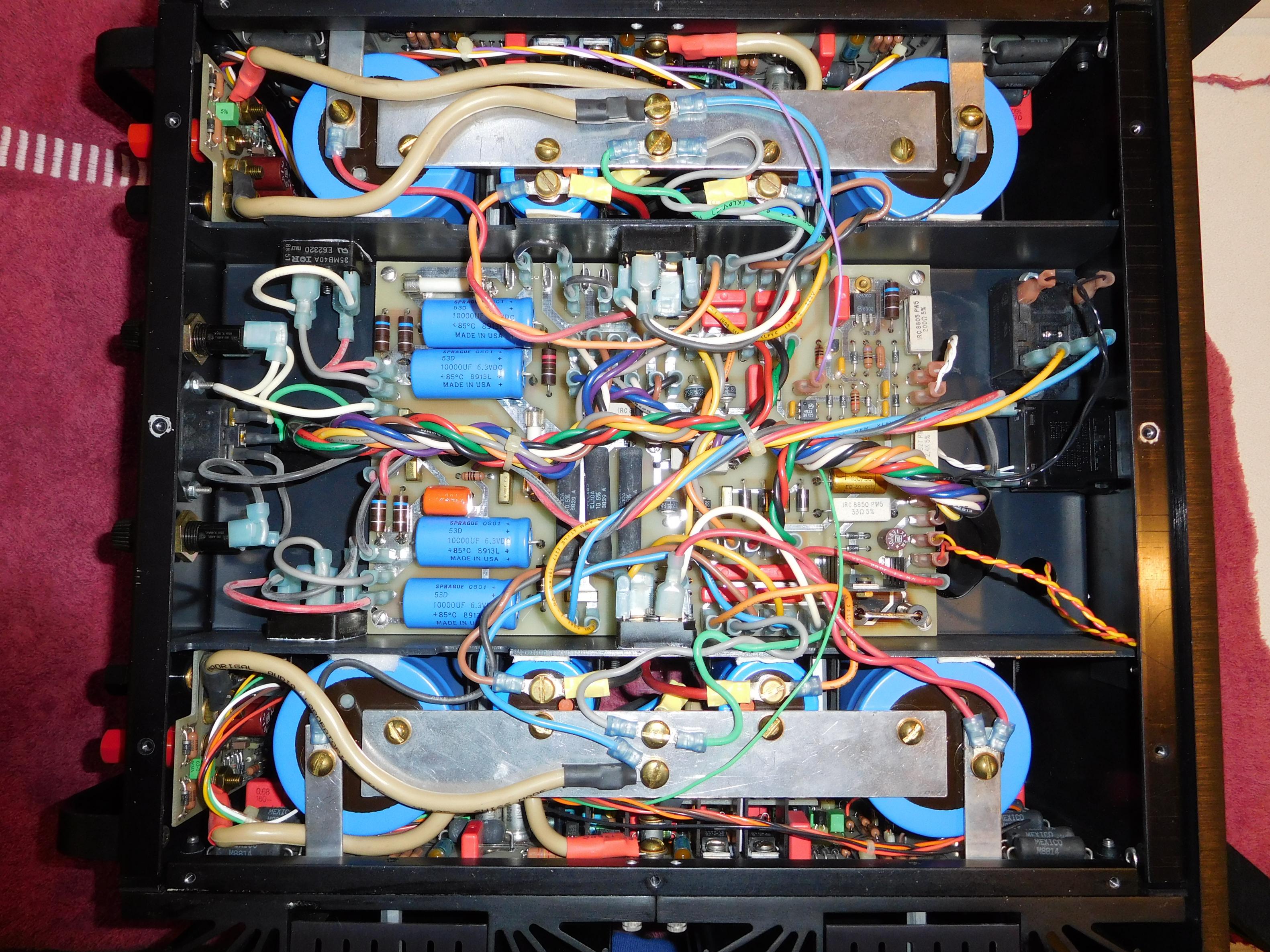

More No. 27 photos. I removed the transformer covers before starting work - they are too pretty to damage. After removing main boards from heat sinks, I completely cleaned the insulating sheet and heat sinks.

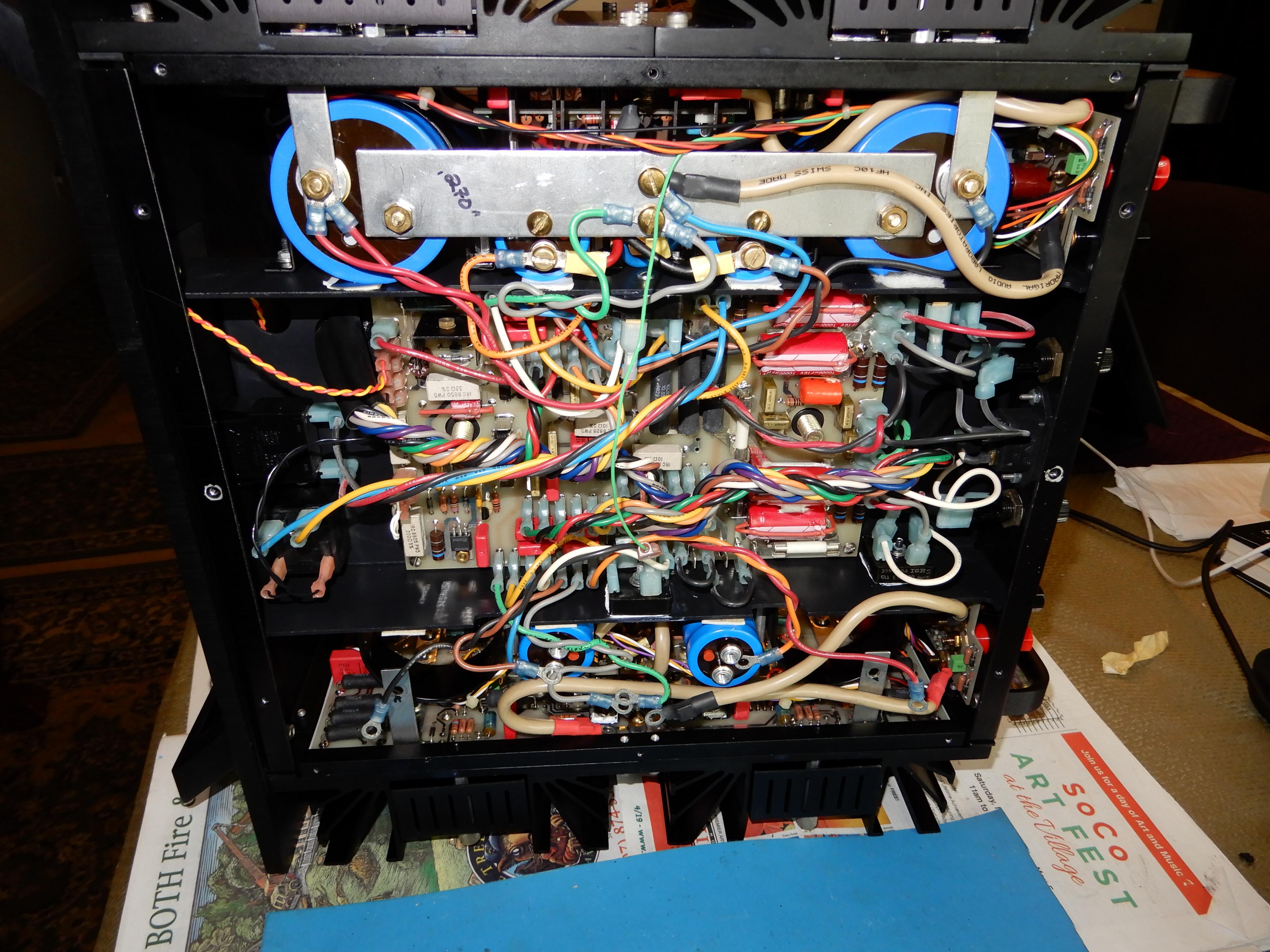

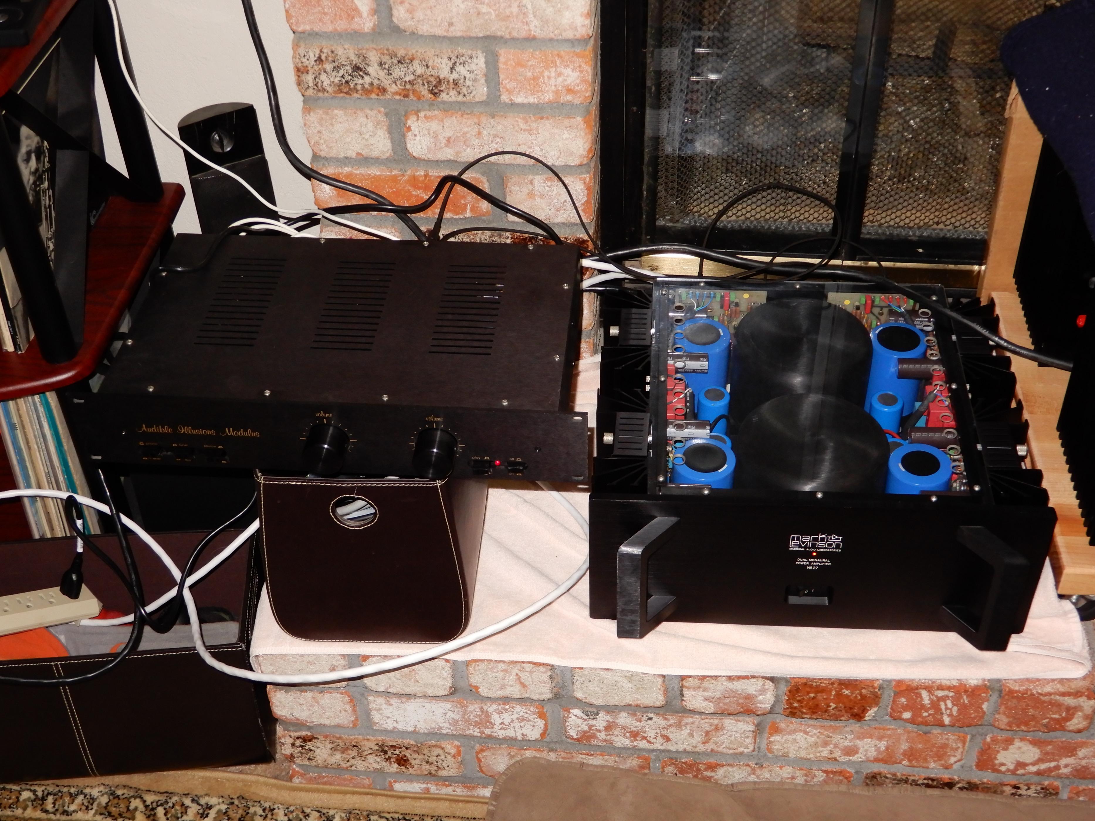

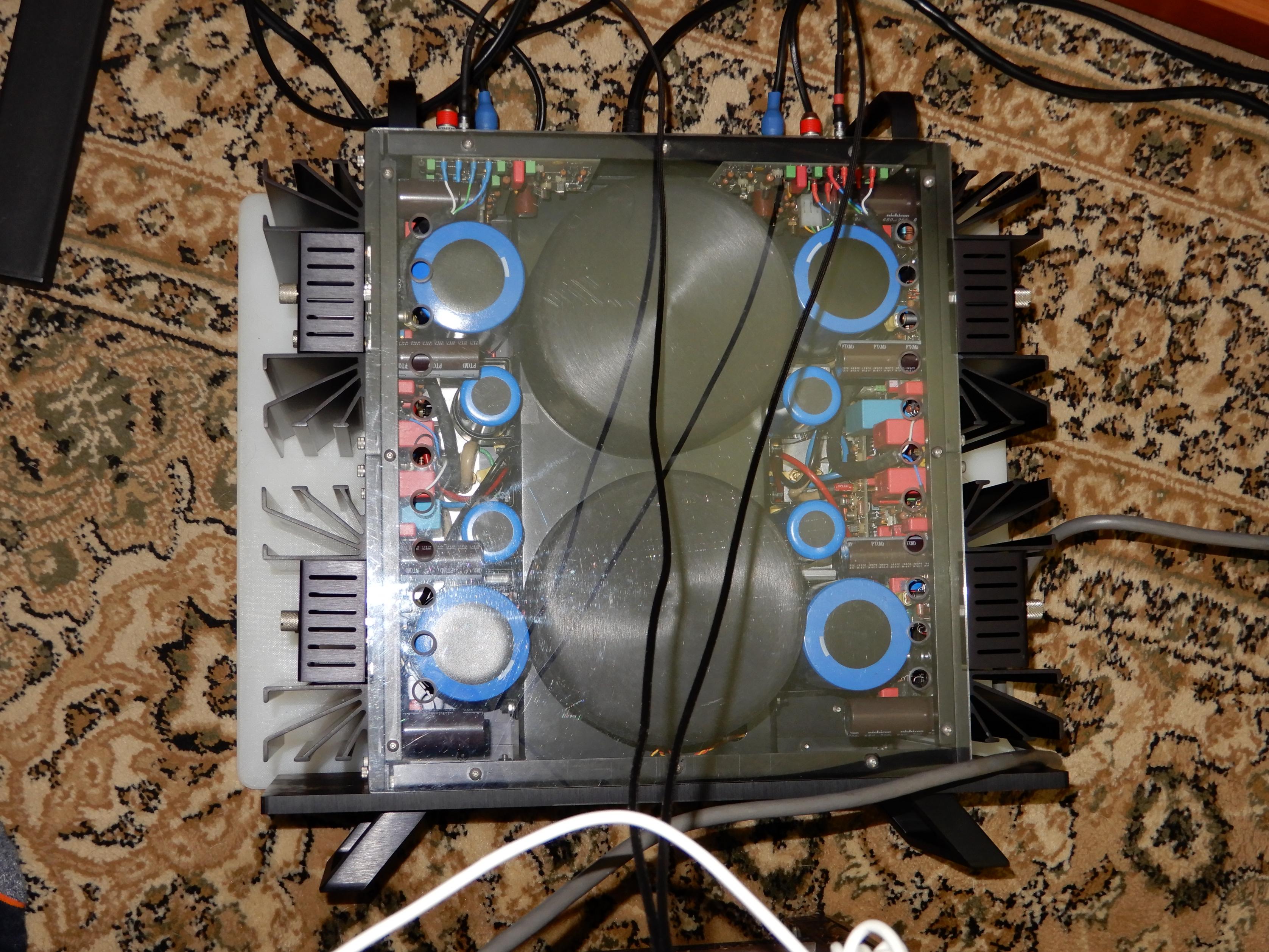

More No. 27 photos. Last two are of the finished amp after initial testing on the bench. The amp is so heavy and large for a 100 wpc amp that it was funny to see it dwarfed by my Conrad-Johnson Evolution 2000, just visible to the right of the amp while I was conducting tests of different preamps with the newly repaired and recapped No. 27.

In my amp it's configured like in the image below.
This of course also works with 2 instead of 4 anti par. diodes.
So If one of your 2 diodes is gone, chance is that more components around these diodes are gone, since voltage on these components is no longer restricted to +/- 0.6Volt.
So first try to find the similarity with this circuit.
Hans

Thank you, Hans. It was entirely no fun doing the work. I'm not a fan of the physical design of these amps compared to most others I've worked on. Just too complex and time consuming. However, it was very satisfying when completed, and it's our daily driver. We have 4 systems in rotation just for variety, and this is the lowest power amp we have, but it does a great job with our only moderately efficient speakers and consumes less power.
Perelman, I have a layout drawing for the No. 27 power board which may be somewhat similar to yours, and I think a schematic of that board as well. It might be best if you removed the board so you could trace the diode connections, and you might even want to desolder the diodes to check out of circuit. My main board had 2 diodes that checked as shorted when in circuit but fine out of circuit, due to the parallel connections.
One helpful thing is if you have another amp to use for enjoyment, so you don't rush the repairs. I waited 4 months for caps, then 2 months to finish other projects, then really took my time to work on the ML. The only time I got anxious and rushed was when reassembling and testing, and let a probe slip, which blew out a trace, a diode, and a current source transistor on the main board. That's when I decided to completely disassemble both modules again and replace all of the output transistors, then quadruple-check my work.
