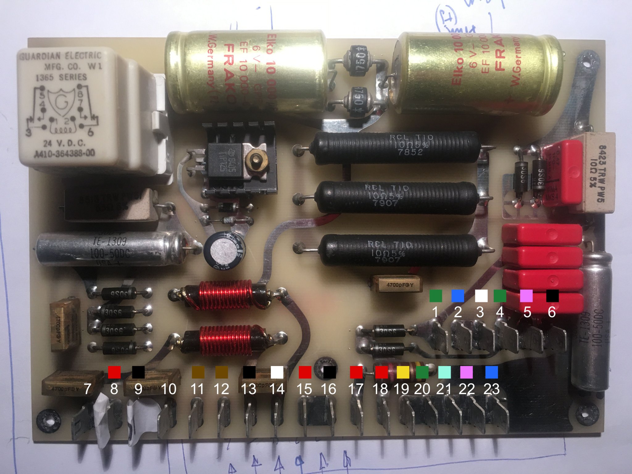

I have 2 ML-9 amps, and I'm getting ready to repair one of them. I am fairly sure this is a power supply problem. Before I start, any diagrams, disassembly advice, part sources, etc you can provide would be incredibly helpful. Thanks so much.
Hi lbairn, welcome on this thread.

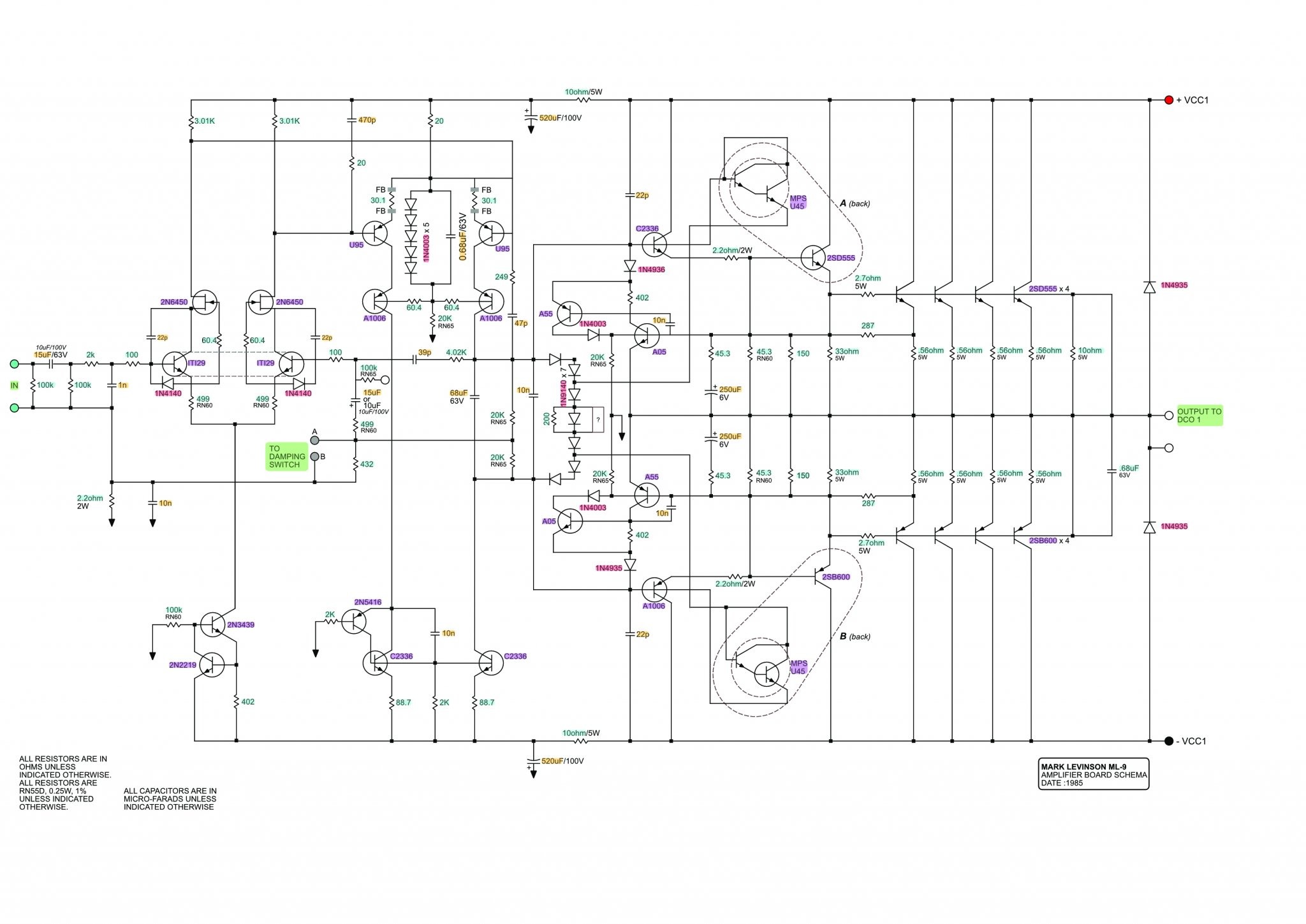

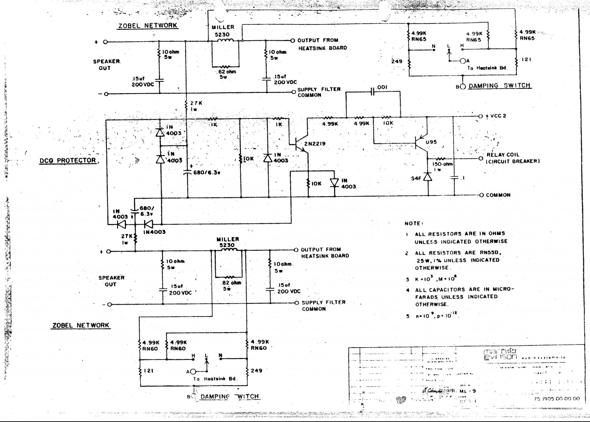

I attach 3 files that could help you... You write about a PSU problem, is there a specific detail which makes you think about that?
I'm guessing PSU because the amp was working fine, I turned it off and about 60 seconds later, turned it back on, and it was just dead. The power light on the front doesn't come on. In most amps, this problem would be a blown fuse, but this ML-9 has no fuses. (I'm not familiar with the power switch, but some threads indicate that it might also be some type of breaker...instead of using a fuse?) Because neither channel works, I'm guessing that neither +15 nor -15 is working, but I haven't measured anything yet. If that's the case, then the problem will be something in the PSU that's common to both + and - rails.
OK, I see what you mean. No fuse you are right. If no light comes on the switch, then I suppose you won't find any current inside. I would suggest (but I'm no specialist at all) that you investigate what I called "regulation board" where you'll find the relay. Get some voltage measurements in and out the relay. I've read somewhere that it could fail. I bought 2 as spare parts just in case (I'm not living in the US where they are easy to find). Merry Xmas, by the way.

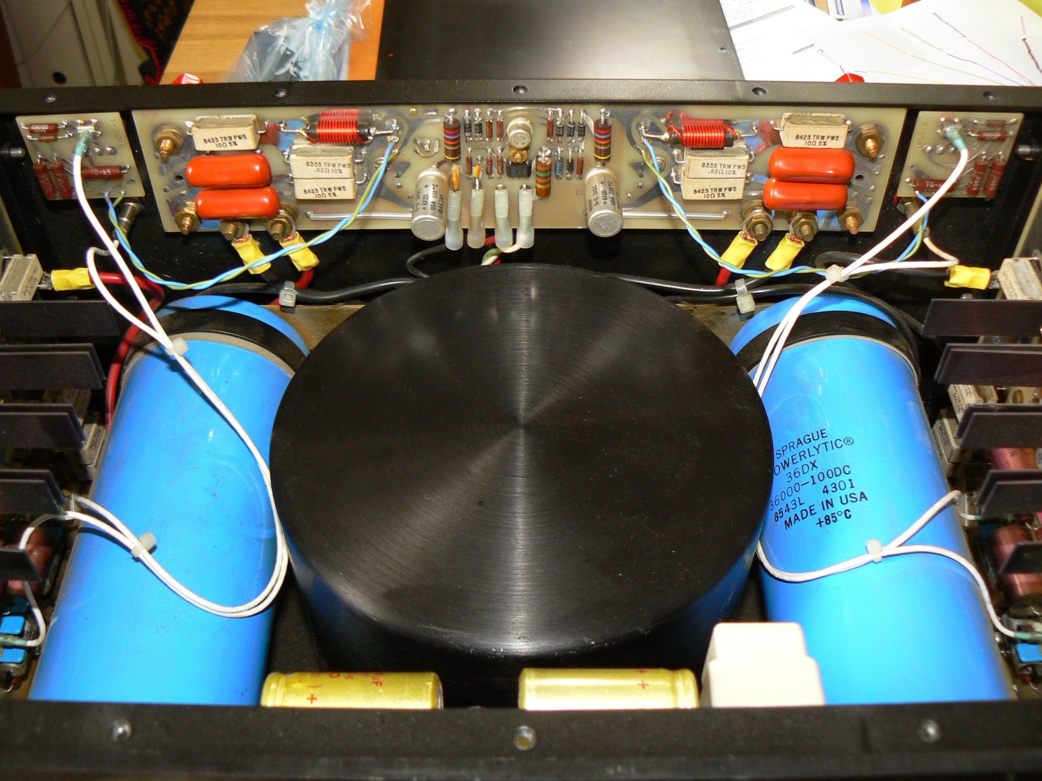

Absolutely. You have to unscrew the black transistor’s covers (2 on each side), then “release” the 2 or 4 (don’t remember and not home) screws that fix the whole amp plate (one on each side, radiator and PCB hold together). You don’t have to unscrew them completely to let enough free space to be able to lift the cover.
It's normal to get some dust after a few years, with the vented cover. Easy to get rid of, with some blow gun or sort of. I doubt you'll find any leaking capacitor...
It's easy to access to the amp circuits, by unscrewing completely the two sides.

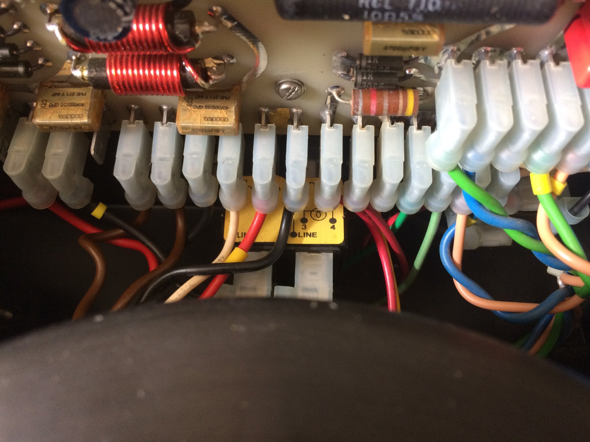

Then you should see something like this :

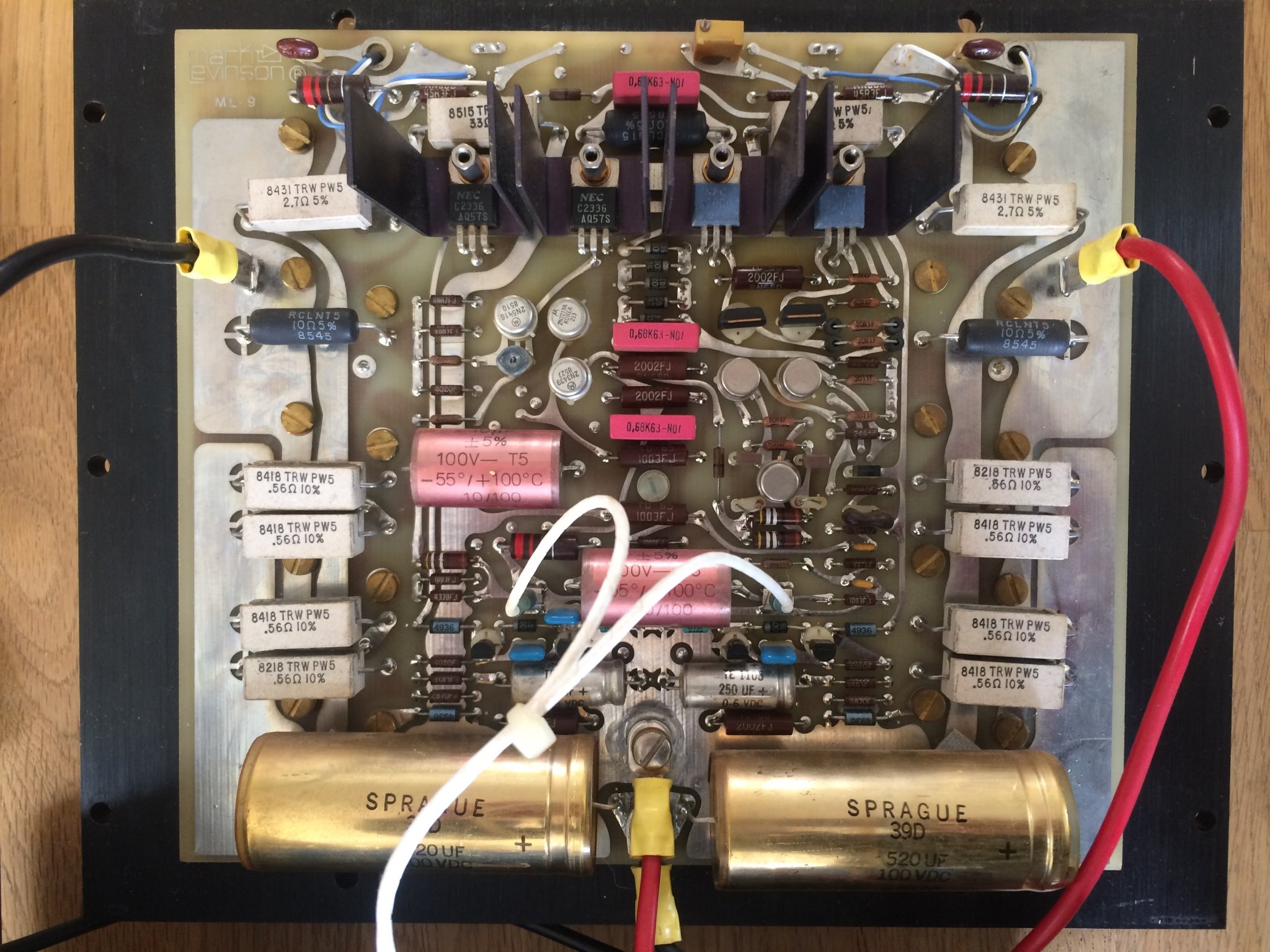

and the amp circuit :
If you have any question, just ask. I did some (light) recapping 2 years ago (all capacitors except on the amp board which is quite difficult to dismantle and get access to the solder side), after a complete disassembling. It works fine. I tested caps on the amp boards and they were fine. There was one big can (36000µF/100V) which wasn't in the specs and I ordered 2 from Nippon Chemical (at Mouser), waited for 6 months to have them, but I wanted same size/same colour 😉. Finally, I could reform the one that was wrong and it is perfect now. But replacement was done already and the one I bought are perfect and will last 30 more years...

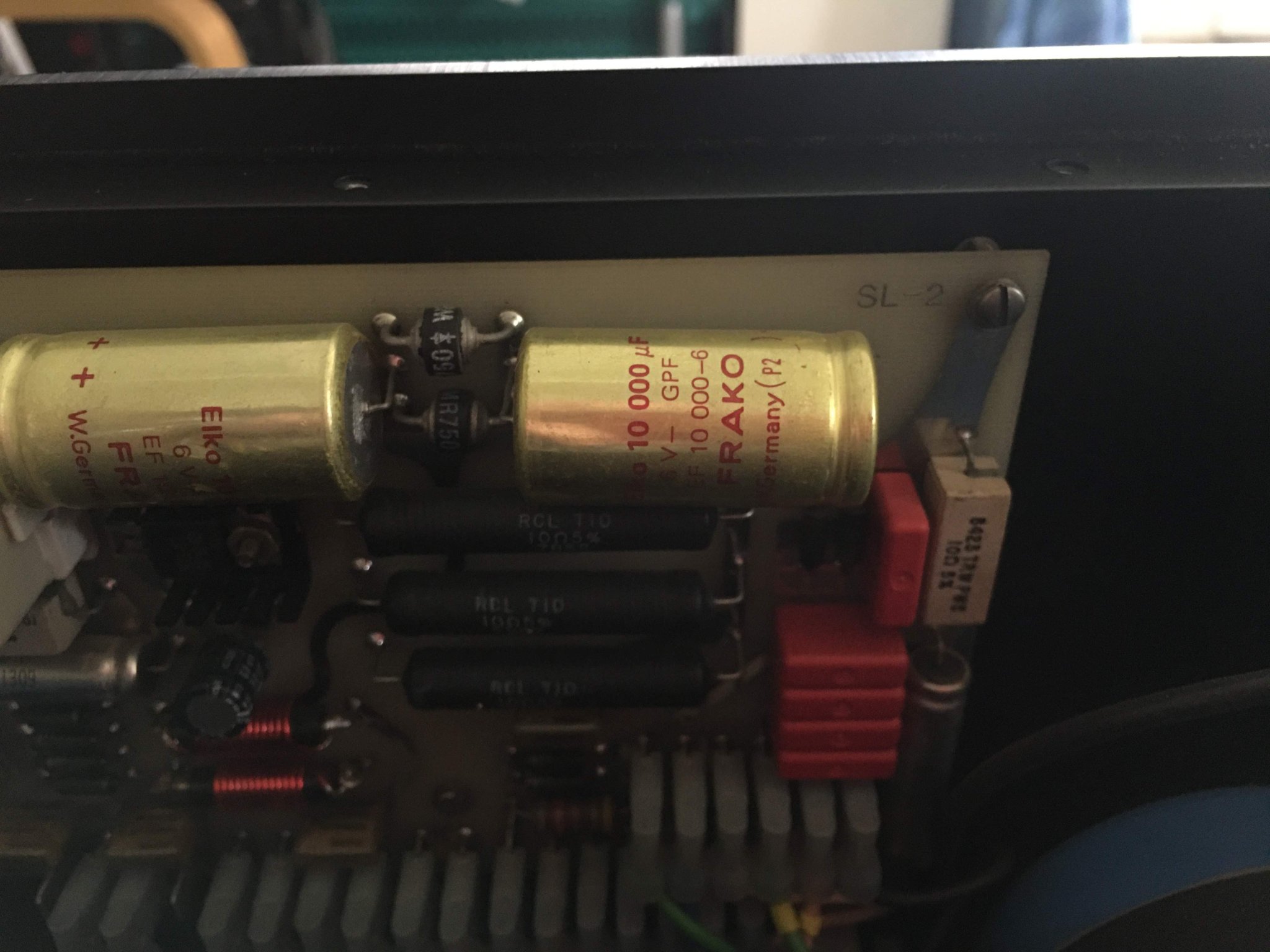

The only caps I wanted to replace absolutely are the Y Rifa caps on the PSU board (which are not known for lasting a lifetime) :
and the 2 Frako's (10000µF/6V) on the same board (and same reasons) :
While I was there and the amp open, I replaced all others I could with good quality caps from Vishay or Sprague or Nippon Chemical bought at Mouser. So I know what's inside.

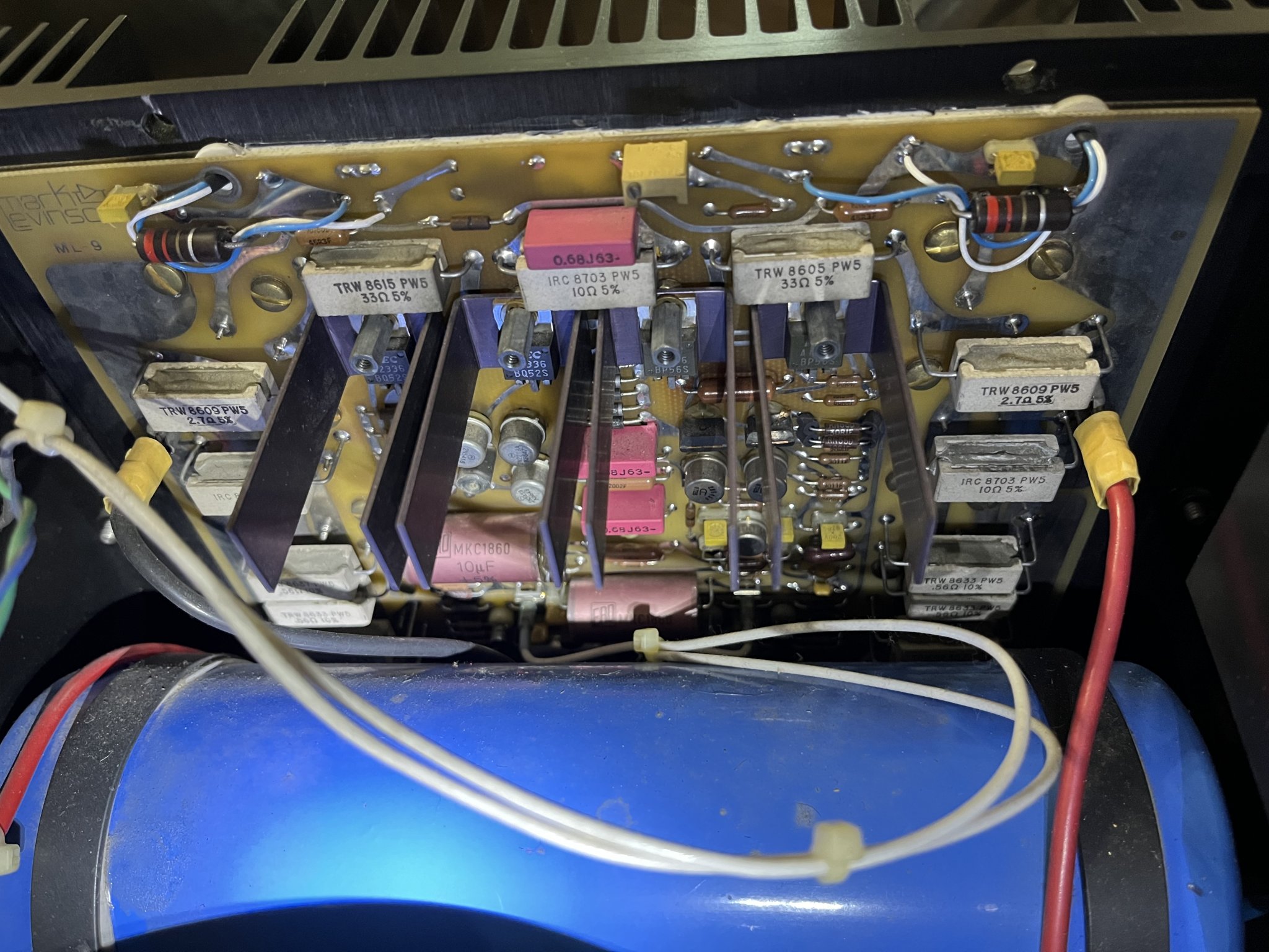

Let me say it is a real pleasure talking to you, thanks a lot for the advise and the information. I will open the amp and post pictures of the interior so, if you have time, you can give a look and tell me if there is anything urgent to be done

Please do, I'll try to do my best to help or assist. Remember that I'm not a professional, so take advice from others too, there are some really tough guys here). I'm sure many people read this thread, and ML fans are numerous.

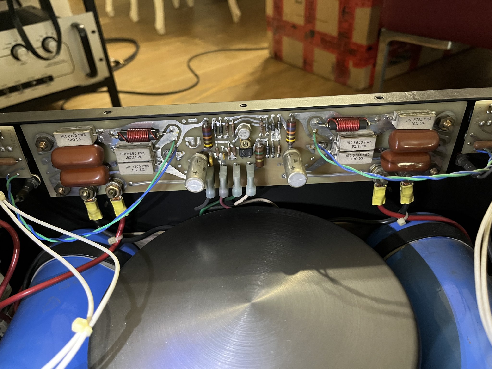

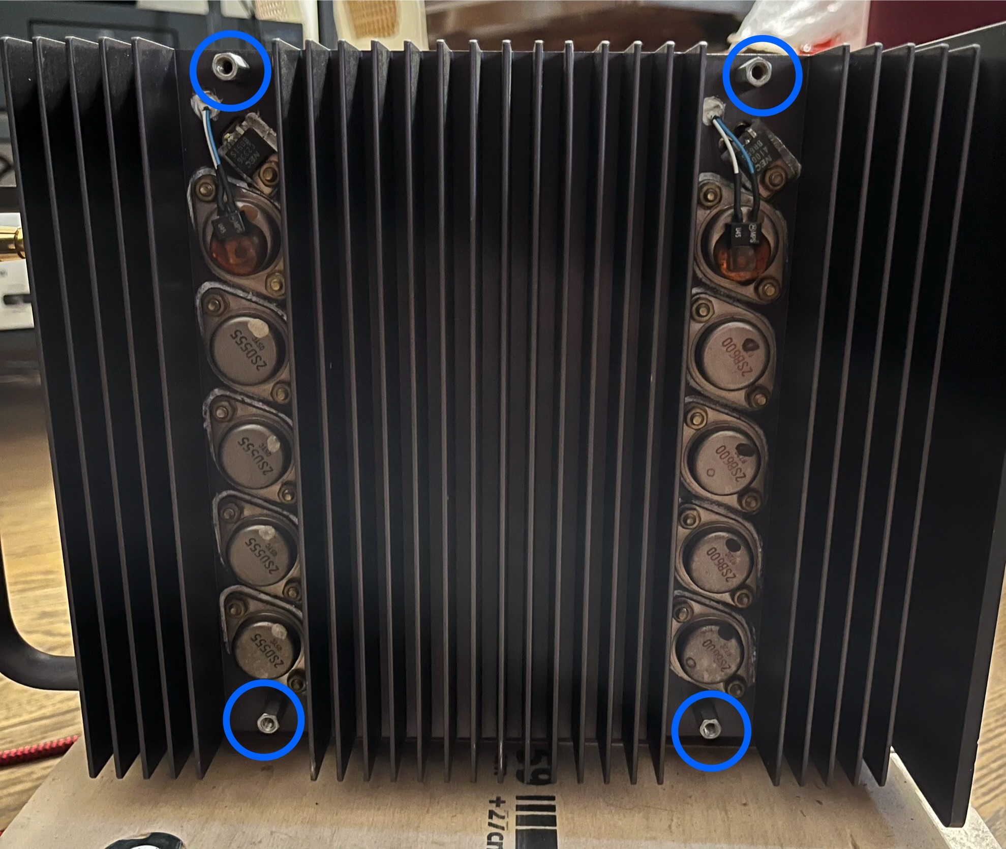

Good morning. I just started the opening but I think I stepped into an obstacle.
I removed the 10 screws from the top panel, uncovered the transistors on the side and released the 6 screws on the lateral panel but still this one doesn't want to move.
Should also the four posts marked in the picture be removed/released?
Yes gaetanov, you have to unscrew (lightly is enough) the 4 nuts you circled. They're also part of the board fixing to the chassis.
Beware, they are imperial size, not metric. Not a problem if it comes easily, but be cautious. And remember, if you take this 4 nuts out completely, the amp board/side is not held anymore, so it falls on the side (not good with the cables...).
Good day.
Yes, they are imperial size, I realized that their size falls between metric 6 and 7 but I was easily able to unscrew them with a metric 6.5.
Actually I took the nuts out completely, I read your post right after, but the sides were held in place by the cables that are quite thick 🙂

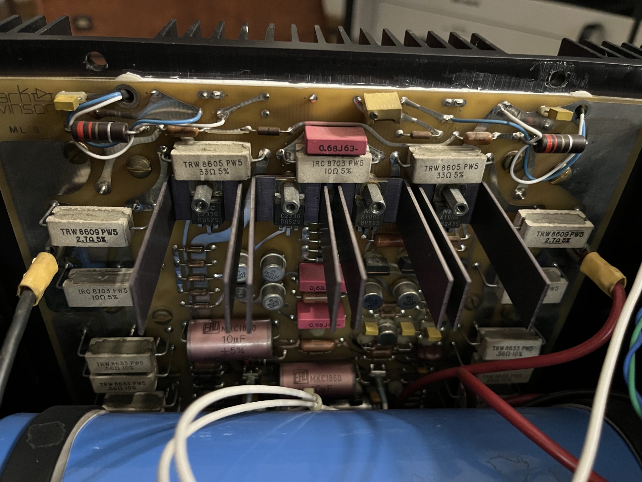

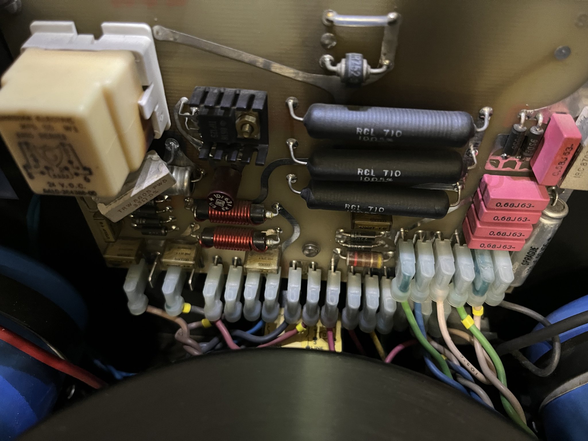

Please find here after some pictures of the internals after a little bit of dust removal. If you have a little time to check them, please let me know if you see anything weird. Once again, thanks in advance for your precious suggestions.
