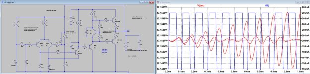

Hans I confirm that the emitter resistors are 10R and 20R. Resistance between emitters is 30 ohms.
In the negative regulator:
Voltage across the 20R resistor is 4.2V (other channel is 3.9V).
Voltage across the emitters is 4.5V (other channel 3.9V).
On the positive regulator side, the voltages are:
Across 20R: 4.3V (other channel 3.9V).
Across emitters: 4.5V (other channel 3.9V)
O.k. 4.3 volt over 20R means 215mA.
And 4.5 minus 4.3Volt over 10R means 20mA.
So the Amp is drawing 215-20mA=195mA, quite a lot for just one preamp channel.
I didn’t expect that.
The second channel however is suppplying also 195mA but the second transistor is not doing anything.
Later today I’ll make the sim and let you know what the optimal setting is.
Hans

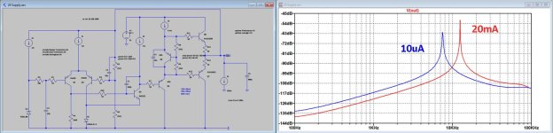

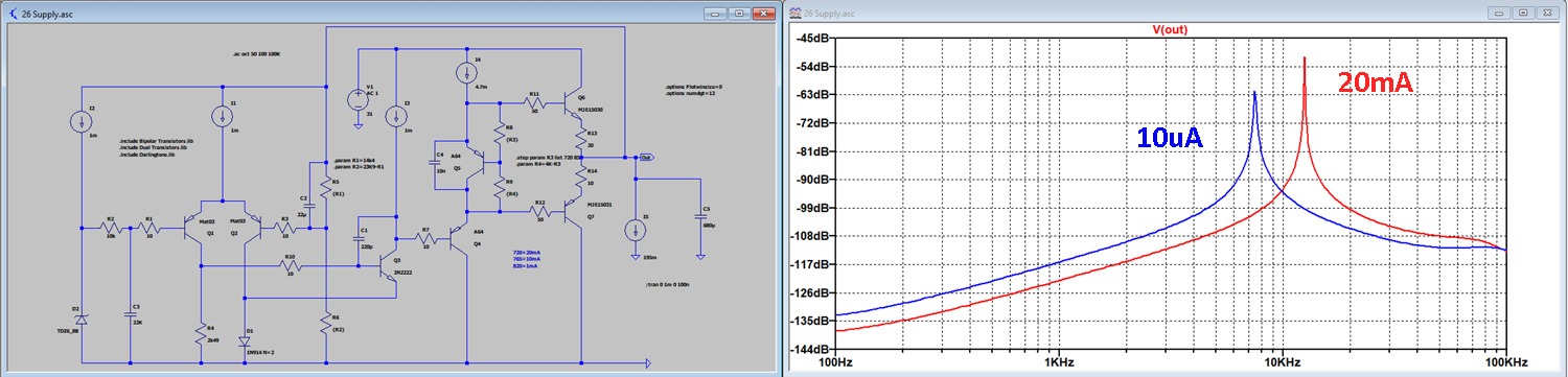

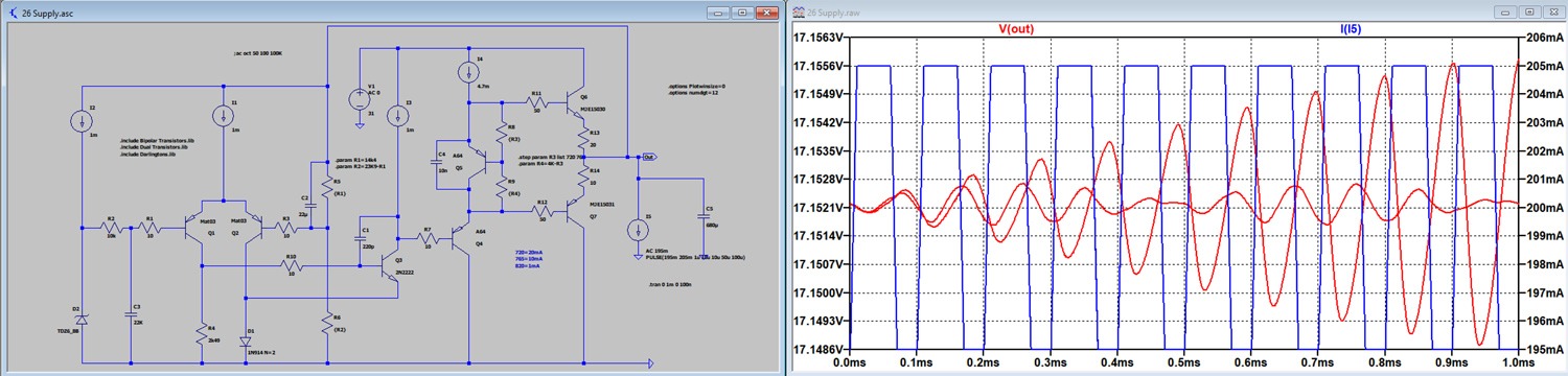

The answer is quite simple.
With 10mA DC current flowing in the 10R resistor, Output voltage becomes unstable when switching the output current between 195mA and 205mA.
With 20mA or with below 1mA output stays stable with this switching load signal.
See first image below showing the output voltage with resp 20mA and 10mA DC through 10R.
Blue is the switching load current and Red the effect on the output voltage for both 10mA and 20mA DC.
Looking at the Power Supply Rejection Ratio for 0mA and 20mA, its obvious that below 10Khz, PSRR for the 20mA version is superior.
See second attachment.
Conclusion, set the pot to 20mA DC current for the 10R resistor.
Hans

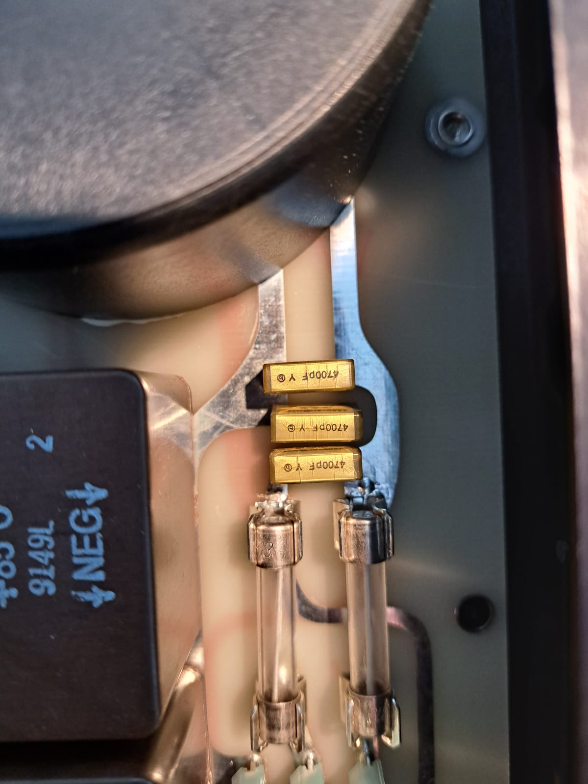

You mean the Type 88D in the PLS-226 powersupply?

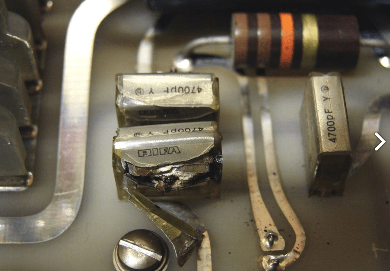

And how about the EMI suppression caps (Rifa PME271) that gave problems in the powersupply PCB of the No. 23 amp and that are also in the PLS-226 powersupply for the No. 26 and No. 25?
Okay I will download some datasheets to get a drop-in replacement for them.

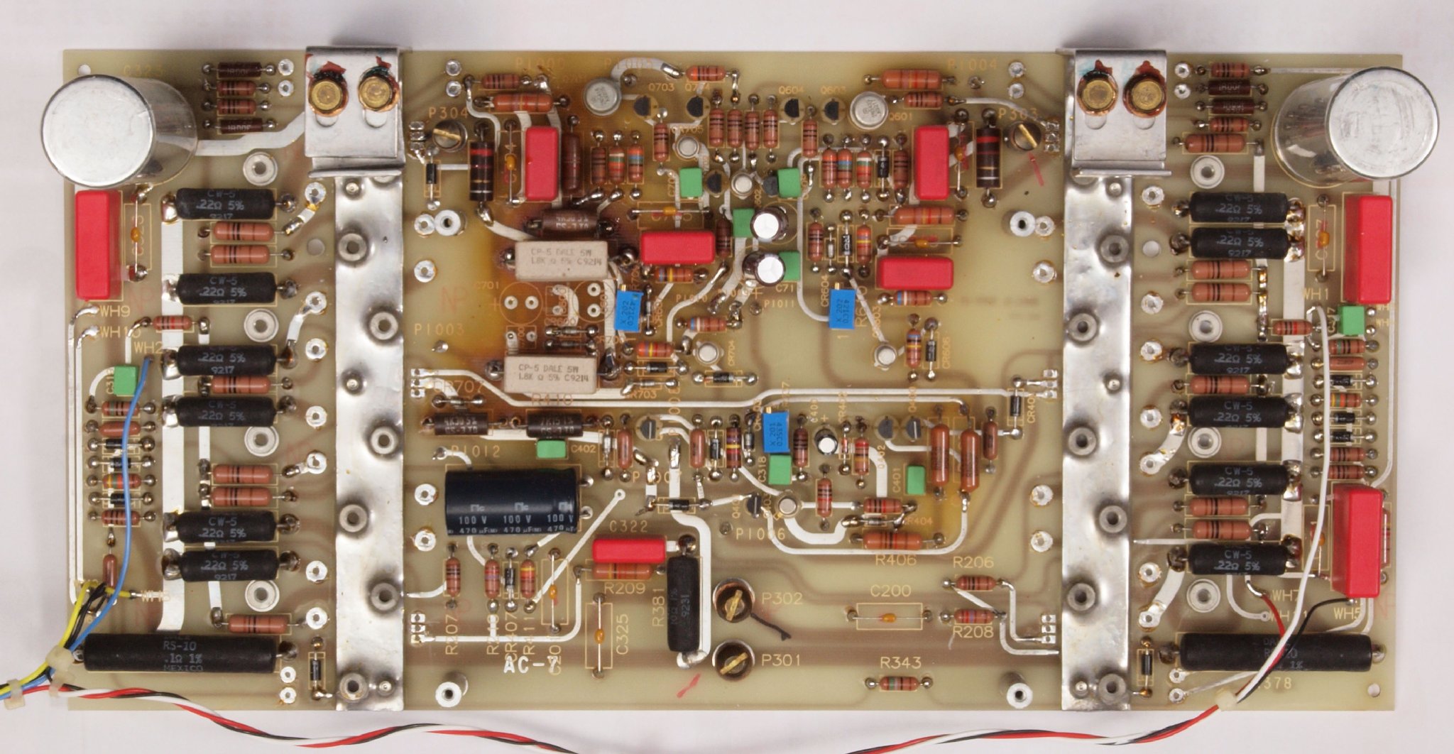

Do you have any experiences with the No. 23/No 23.5 amps.
I've had the Levinson ML-3 it's predecessor which was very easy to service because of its size but the No. 23 looks to me very cramped and servicing could become very timeconsuming if you would like to perform a caprevision on the outputboards with the silver (672D) Spragues.

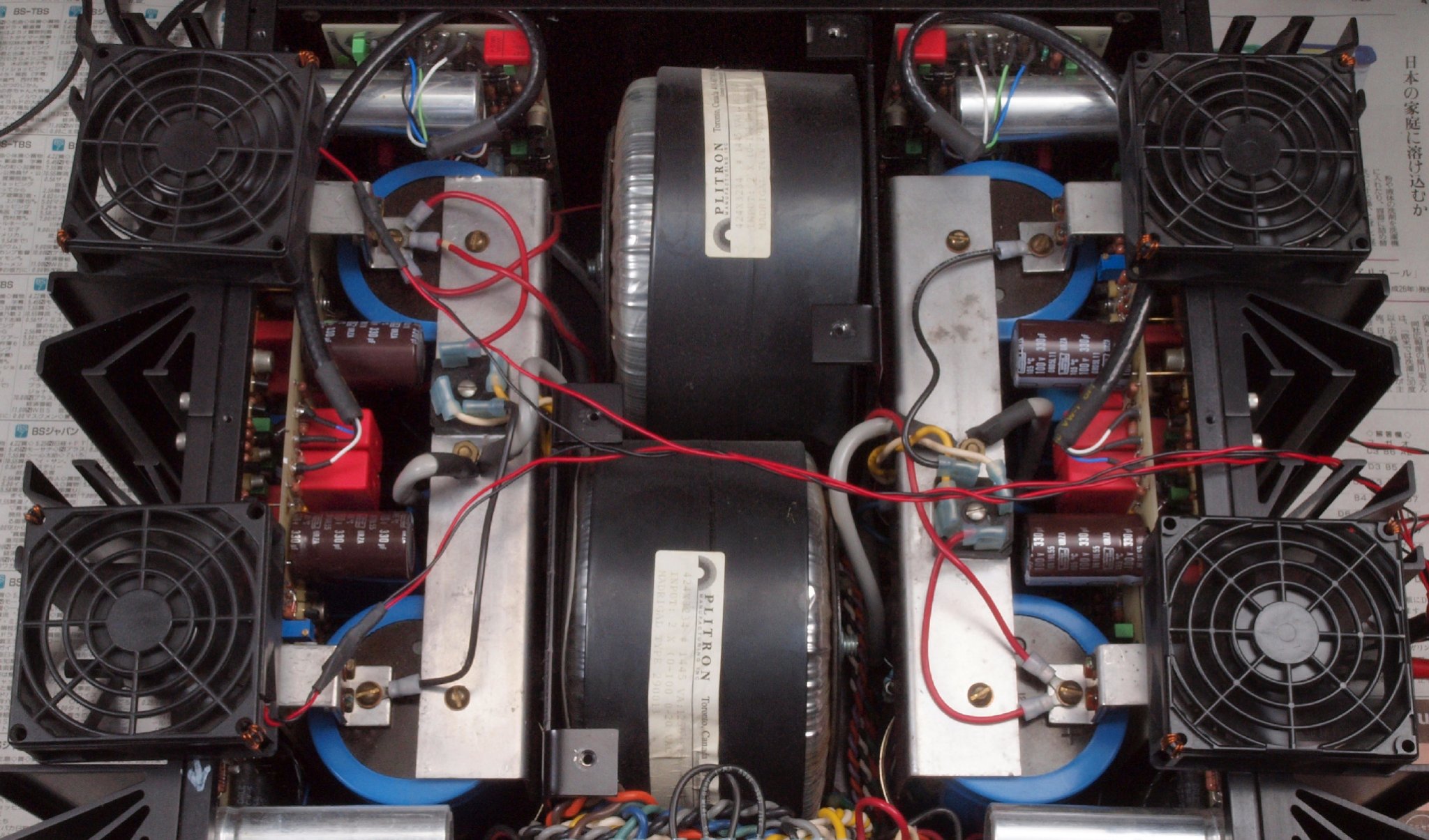

Yes, I've quite some experience with these amps.
The 23 is easier to service, because the 23.5 still has an additional piggybacked board on top.
Keep in mind these amps are rather old ladies, never made with serviceability in mind and PCB's aren the best in the industry.
So repair can be quite challenging.
Hans
