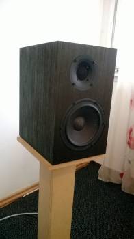

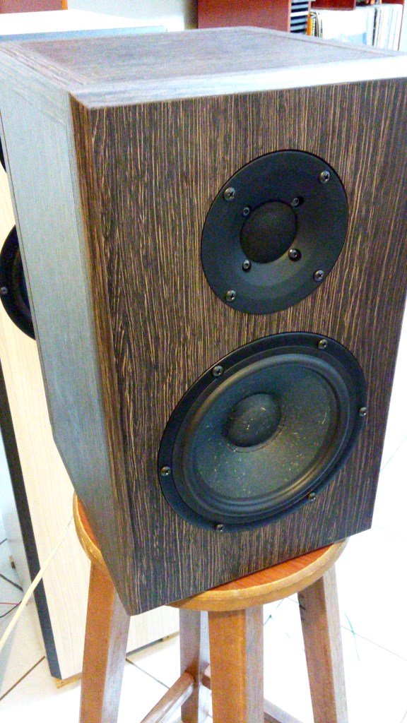

Apparently I made right decision using 3 dowels on every side of every joint, plus dowels for the brace ! I did not use any sound deadening sheets (once suggested to me), only damping sheets from europe audio.
Silicone along corners.
As well front and back baffles (25mm thickness, walls are 18mm) recessed (flush mounted ?) into enclosure.
Hopefully it will reduce resonances.
Weight is significant

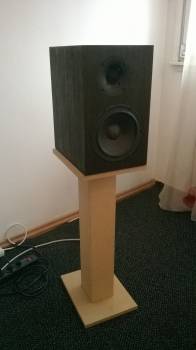

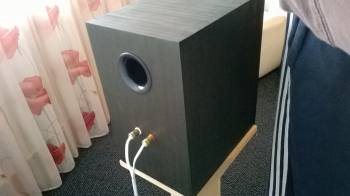

My DIY build of these excelent speakers
Hello,
I just finished these speakers according to plan. I build enclosure from MDF. Sound is excellent. I enjoy them a lot.
Source path: Squeezebox receiver -> DAC with trofo output -> Pass buffer -> Class D based on IRS 2092 with SMPS 500W.
I highly recommend this design.
Hello,

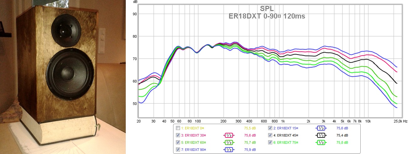

I made a version with the Zaph ZR71 dimensions (by "accident"), and I will check the response but I feel since the baffles are very similar, and since we have drivers with well-behaved integration probably ony a minor modification is needed.
Some impressions (with some conclusiuons but some things all people already knows
The sound are the most neutral and life-like at same time I have heard to date in a bookshelf with 2 way. For me is difficult to find a system neutral and vivid, resolute at same time; most "neutral" systems are depressingly boring and muffled or sometimes clinical or harsh.
Is clearly perceptible the great DXT dispersion and the very good integration between drivers. At proper volume setting, voices are very convincing when I walk along my home. Since this system have a so linear frequency response, it don't emphasizes certain things in recordings; all are here in correct proportions, except the bass, but this project excels in its own class, revealing the great ER driver linearity. One only notice the SEAS ER distorting with bass when it are making very large excursions...
Maximum clean volume is above average for this project type and again is a testament of driver's low non-linearity.
The DXT tweeter handles very well good power levels even with this low order crossover.
Maybe this remember a little the famous Grimm Audio LS-1 speaker, using same tweeter but other SEAS driver (8", magnesium cone). Reviewers says good things about it. Of course, a very different project but at least one or two targets in common: wide dispersion and exceptional frequency response, along others.
PS.: unfonately I err a little the tweeter diameter, and becomes off center when I attached it (the screws become slight off target). But the speaker recess are in perfect diameter.
...but this project is actual/current, and a good project survives the time test.
And strangely, about the "presence" sound, I found this "wow" factor before only in some fullranges or speakers with messed response (generally with HF rising response/"tilted up"), but it seems the wide disperion now is my personal preference to "ruler-flat" systems not sounding "flat boring"...
(I checked the response before completion at a test panel and seems to be perfectly OK, but my limited acoustical measurement gig maybe hide some gremlins to sight, and I consider only ~500Hz upwards).
