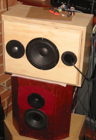

finally got them up & running. My xover is fairly minimalist zero BSC, .68uF & Mark's filter on the woofer, single resistor & 2nd order LR on the tweeter.
I was going to do a rave about how they have a much more forward sound than the Peerless drivers they're sitting on, 'till I realised I'd put the tweeter inductor BEFORE the cap... oops, luck I didn't fry my amp... That sorted they sound pretty damn good, better lower mids than the Peerless, & they integrate very well with my 10" Peerless woofers. I haven't tuned the port yet (currently ~ 37Hz), I think they need a bit more running in, but as stand alones they'll need more BSC, bass is there, just needs a bit more level. But I suspect I'm going to stick with using them as part of a 3 way...

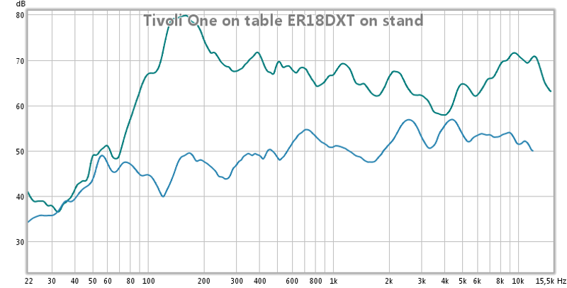

I've finished putting together just one of my speakers for this project so far, and the bass seems to be severely lacking. I've turned up the bass on my receiver and it's still kinda missing... maybe I am expecting too much, but I get more bass from my clock radio - PDX-13 - iPod Series - Yamaha - Australia
tandata, you are right! Most speakers, especially clock radios on a table have a huge up to 20dB boost at 80-200Hz. The ER18DXT doesn't.
Most bass-reflex speakers are tuned to give maximally flat response (or boost) to the low limit - the ER18DXT is not.
You can download some RTA or FFT widget to your smart phone and see how they measure! If you use the tone control in your amplifier you'll get more bass out of ER18DXT.
