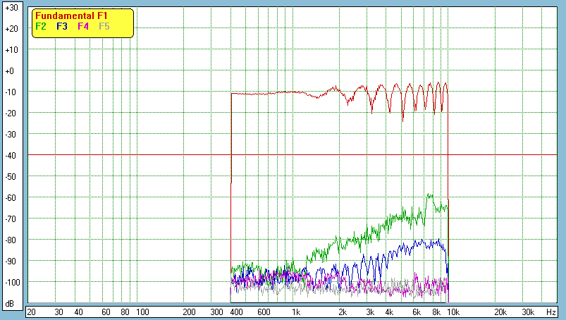

looks like different efficiency between the tweeters. The off axis performance of the DXT (on the bottom) does show.
