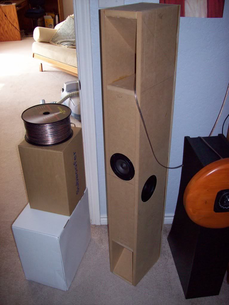

And a quick picture of the progress. I need to go ahead and finish them up. I've been slacking.

Version 2.0 with the modification that Dave suggested. With the top ballast removed they become a lot less top heavy and I don't know if they will even need a base. I've got some sanding to do today and I'll test their stability later as well.

Even with sand or other heavy ballast material in the lower cavity, these will still be very tippy - I'd suggest a base plate at least 10" wide.

What a fantastic idea! I'll see what i can find locally. Immediately I'm having trouble coming up with ideas about how to attach that to the bottom of the cabinet but I'm sure I could come up with something.
chrisb said:Even with sand or other heavy ballast material in the lower cavity, these will still be very tippy - I'd suggest a base plate at least 10" wide.
