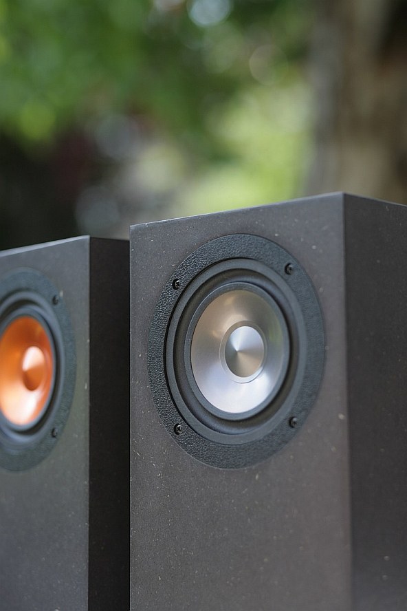

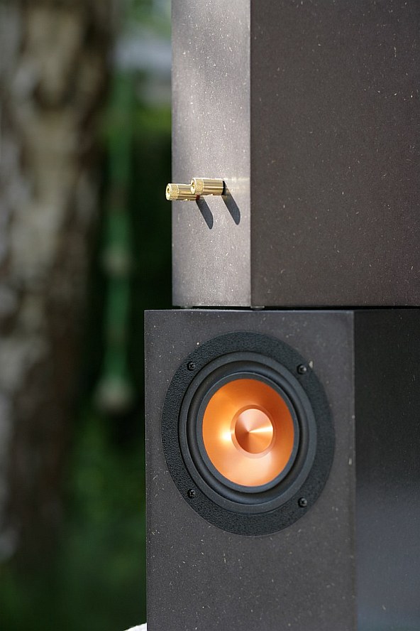

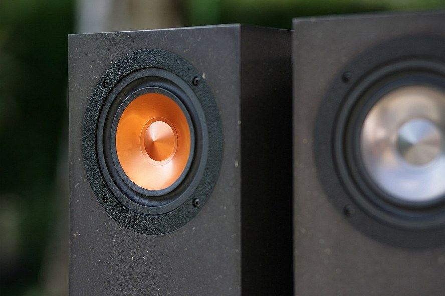

I have made some more pictures of the Black Beauty mini monitor
Very elegant Henkjan!

Henkjan, on the Black Beauties, there, very tidy woodwork! In fact, I'm curious exactly how they're assembled, because I can't seem to find any seems anywhere, at least not anything that would indicate 16mm thick panels. Are they all miter joints? Any in-progress construction pics?
yes, they are miter joints. what I did was lay out the panels on the floor (outside up) then tape it together with what we call "painter's tape" (the paper type tape) flip it over, apply normal white wood glue (spead it out with a brush) and then close the whole thing, apply some more tape where needed, let it dry for 15 minutes, remove the tape and clean any excess glue, and done. (then sand and varnish of course)
I had the panels made by a pro woodworker, he used a CNC router to make them :smash: the trick is to make the angle of the miter just a bit 'lean', so that the outside is certainly tight together
