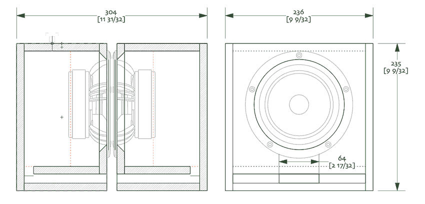

Converting a medium Nostromo into a small one.
Is is possible by adding a suitably sized block of something into the bottom of the cabinet, and if so, what should it be made of? I ask because my solid-state amps have a lower output impedance. Thanks.

Hey folks
After building alpair 11ms on fhxl, now I'm considering to build the same drivers in nostromo series as a setup on my work city abroad.
Some things i couldnt understand is the 3 size nostromo builds. I will be pairing these with allo volt+D amp which produce around 35 to 50 watts per channel.
Which size from the nostromo series would be suitable for me. And what is the approximate F0 and F3 of these in nostromo series.

My understanding and experience is that the lower the output impedance of your amp then the smaller the cabinet needs to be. Even then you may need to add further series resistance say for a modern solid state amp.

Yes the reason is to keep it compact so that when i travel i can take it in my bag.
Which build do you propose. I have decent size room here 16x16x16ft. And corner loading cannot be done as its a studio apartment. I do not want to sacrifice too much bass.

A quick simm and sketch shows that the A11ms can fit 5 litres. With 15mm material, 24x24x15 cm, so could be packed face-to-face, 24x24x31 before a protective casing. With 12mm or more exotic material that allows for thinner panel material it could shrink even further (at these box sizes mreterial starts to take up a significanr of the gross volume. With a bit of juggling it could be printed on a Form 3L.
Of course one gives up a bit of bass wrt the optimum 9 litre. A bit better damped response and it gives up 7-8 hz F10 (ony hits 50 Hz)

The Allo has a low output impedance, certainly low enuff one does not have to worry (unles s hooking up to somethng lke Fostex FExxx for ehich it would not be suited).
I have a similar (diy) amp, i use it with uMar-Ken 6 and the whole lots into a 3-4” haliburton briefcase — speakers ar ehalf the net volume of the mMar-Ken11ms sketched out above above.

This looks amazing.. I would prefer a front firing port aswell. Because the rear wall of my speculated speaker placement is not symmetric.
Also im planning to do it in 2 months. So by the time i believe the entire plan will be out.
Only concern is bass only to 50 hz. My current setup has acoustic energy aegis 2 speaker and they have similar spec and the result is i get not enough bass in my room. Sounds a bit thin

Is there any other compact options which can have bass response to lower 40s.
Maybe some change in driver other than 11ms is also acceptable as long as the compromises are not huge.
One of the kool things about the A11ms is that it ca work in a small BR box, but it doesn’t go all that low. It takes something like an FXHL (25-30 Hz) or Pensil (not quite as low and not as much gain) to get down.
Hoffman’s Iron Law.
A10.2 was the bass champ in a BR, EL70 not far behind. The Pluvia 7 is really close to the EL70. A10.3/p do not go as low, A12p even less so. A12pw produces tremendous bass, but is a bassWide and wants 4x as big a box as the A11ms.
If you want to go low tha usually means a big box or helper woofers.

The issue im facing is i cant find skilled carpenters at reasonable rates who can do something like a frugel horn or pensil here in abudabhi.
In india i have a carpenter who made fhxl but then shipping it from india to abudabhi is gonna cost a fortune.
So what im looking for is a simple box design which either i can make as flat pack from india bring it in my luggage and assemble myself in abudabhi or ask a carpenter in abudabhi to make it for me. but it has to reasonably simple for both these options and has to reproduce to lower 40s frequencies.
