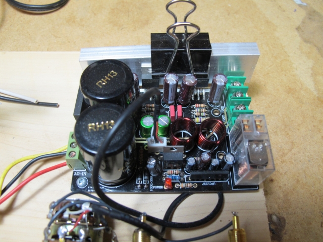

currently using them on a Onkyo TX-1500. not a lot of dynamics, but is fine for everyday listening. the RH-84 amp is next on the bench, just drilled and punched all the chassis holes...taking the build slow, I want to do a nice layout and not a messy wire nest. the lm1875 is a ebay buy, it has the inductors on the pcb, so i hope its a step up from some... nice punch and dynamics, running on 24-28vdc. it was built by some else and he sold it cheap. the SMSL amp lack low end, but is fine on 3" dekstop speakers.

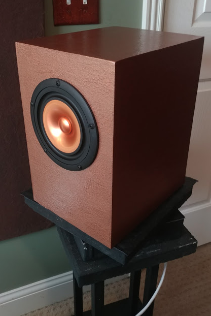

Looking to possibly building the Nostromo build my self for computer desk setup... Would moving the vent to the front of the cabinet be a huge deal?
and I'm wondering how a front ported Nostromo would sound placed flush in a large bookshelf. Or any speaker for that matter. I've got a small room with large bookshelves on 3 sides.
The A11ms CGR looks just like this but for internal & venting details.
I have some details to finish and then i will post that plan as for free use.
Placing it as you describe may require some anti-baffle-step-correction. ie too much bass. 1st thing i would try with these is open cel foam in the vents. Start with a little and add more until the bass is tamed. Very room dependent and your amp will play a role as well. And taste.
dave
dave

I built one with the same cabinet, inserted one lateral brace. Huge improvement in sound with coating two walls with faux dynamat damping (bitumen with aluminum cover dampener).
