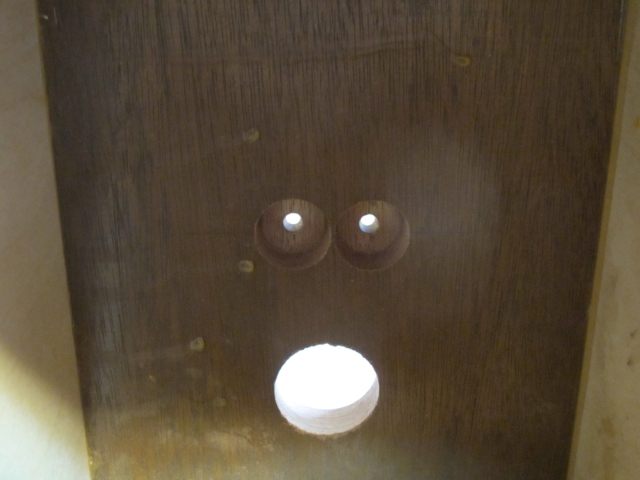

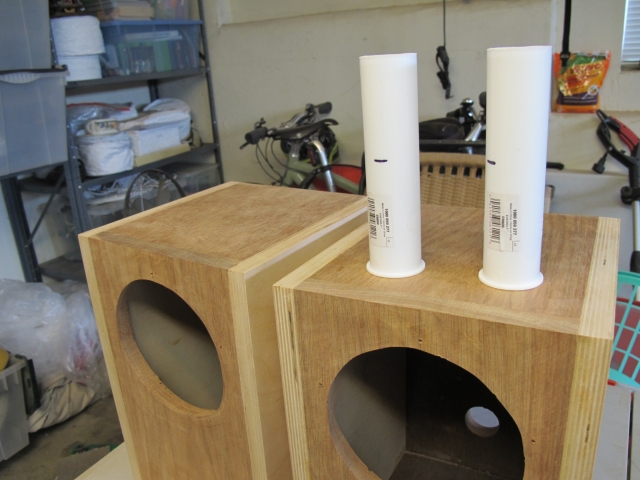

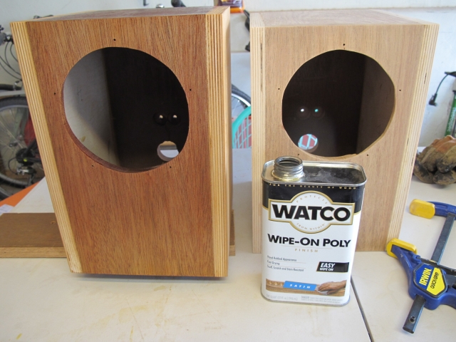

Taking advice...remove drives from box, so as to finish them and not have them incomplete.
found ports tubes at hardware store. using watco polywipe...here are some pics.
btw- hooked the speakers up to an lm1875 amp and the bass was waaaay better than SMSL d-class amp....I think chip amps are next on the list to explore. I also took apart my JE land 2A3 and plan to build the RH84 v1 ....fun ahead.

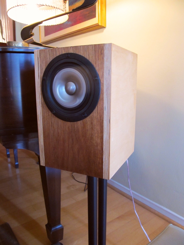

here is the speaker completed. 3 coats poly wipe with sanding between 2 and 3.
with ports, lining and in living room, bass comes alive for sure. they sound very nice. some times a little forward ( i think that's the term). might play with eq or dsp to see if its worth tweaking. plays great on jazz, vocals, ambient and opera.
fun easy project. easy box and no fuss speakers. get'em while they are still on sale 🙂
