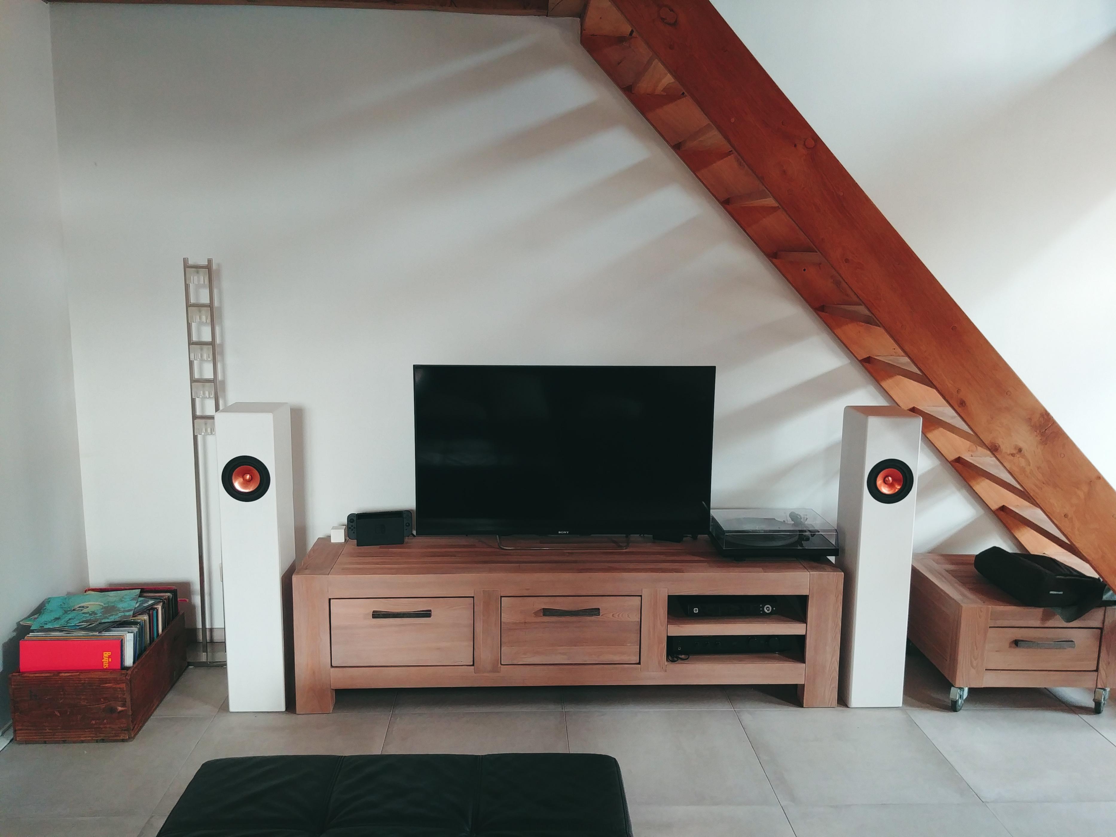

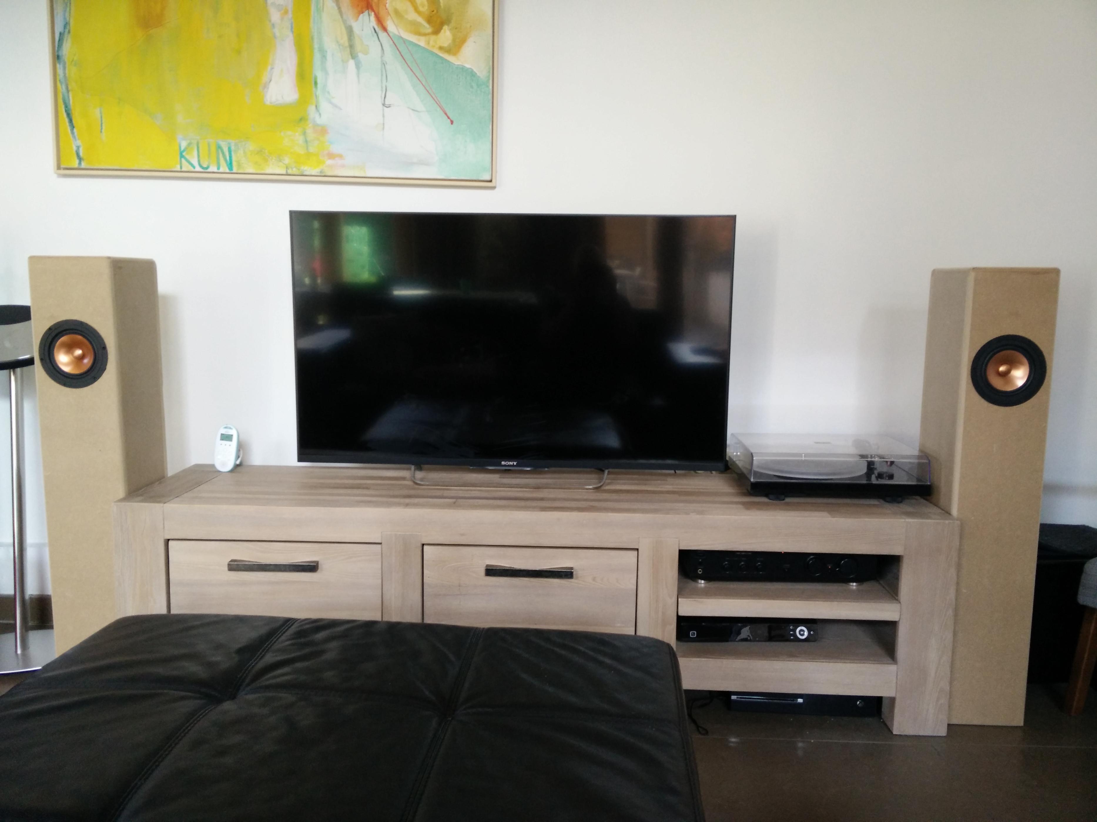

My cabs are almost ready, stil have to perform a edge smoothing and a paint job but so far I can test run them. The drivers need more burn in but they sound absolutely amazing to me! Plenty of low and that sweet full range sound. Loving them! Big thanks to the OP. I will post pics as soon as I'm done finishing them.

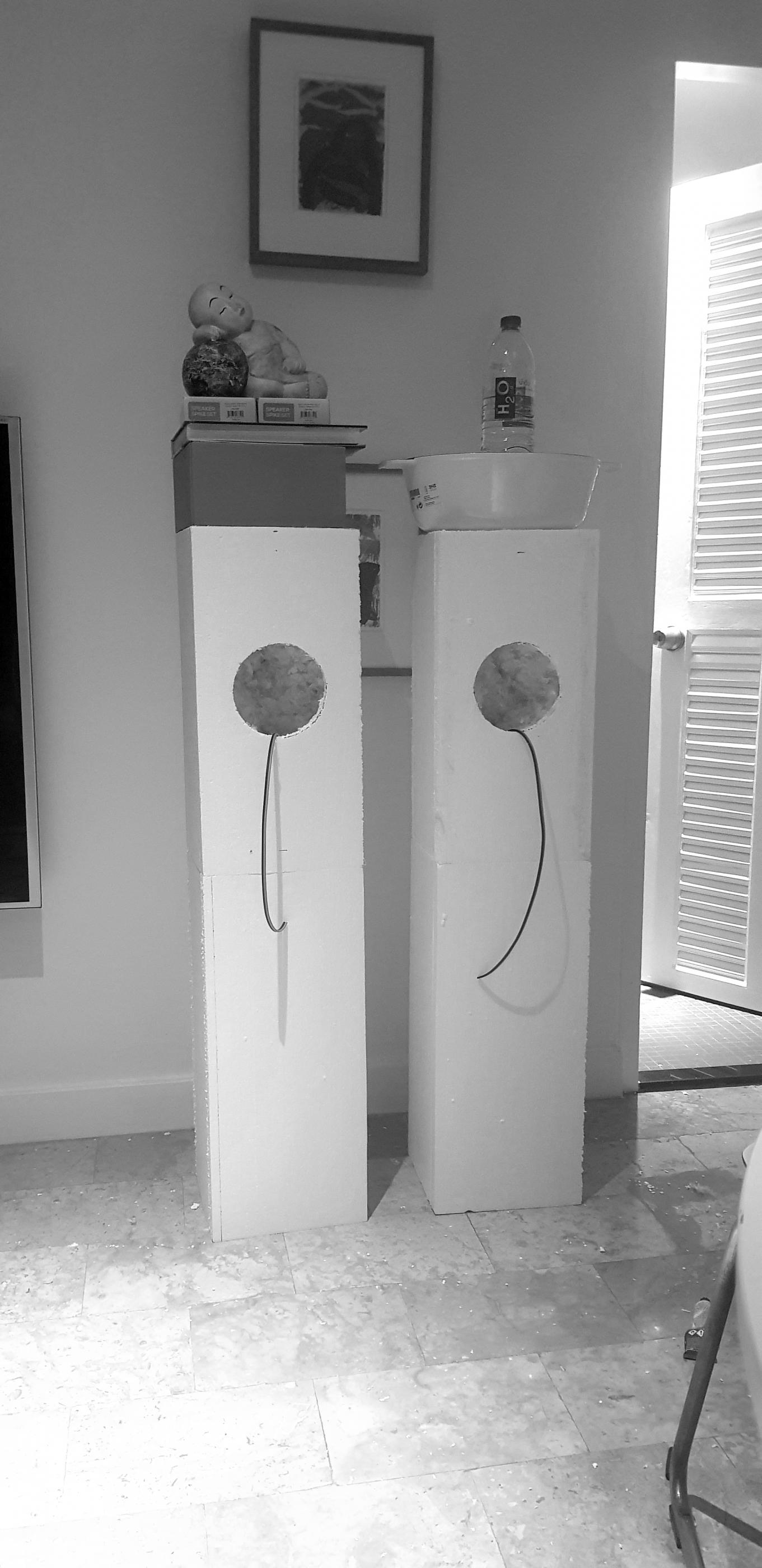

Building these today, hopefully have basic cabs finished tomo. Made from high density polystyrene. I've flipped Jim's dimensions ie baffle is the wider section
almost finished basic cabs. The high density polystyrene is v thick, so baffle width turned out at 25cm. Cross section area is over very slightly. Pillow stuffing to the central brace
Port is downfiring, with a small cavity and cones for clearance(internal height is still 40 inches).
Couldn't find 2.5 tubing so will make do with toilet rolls, until Friday..
