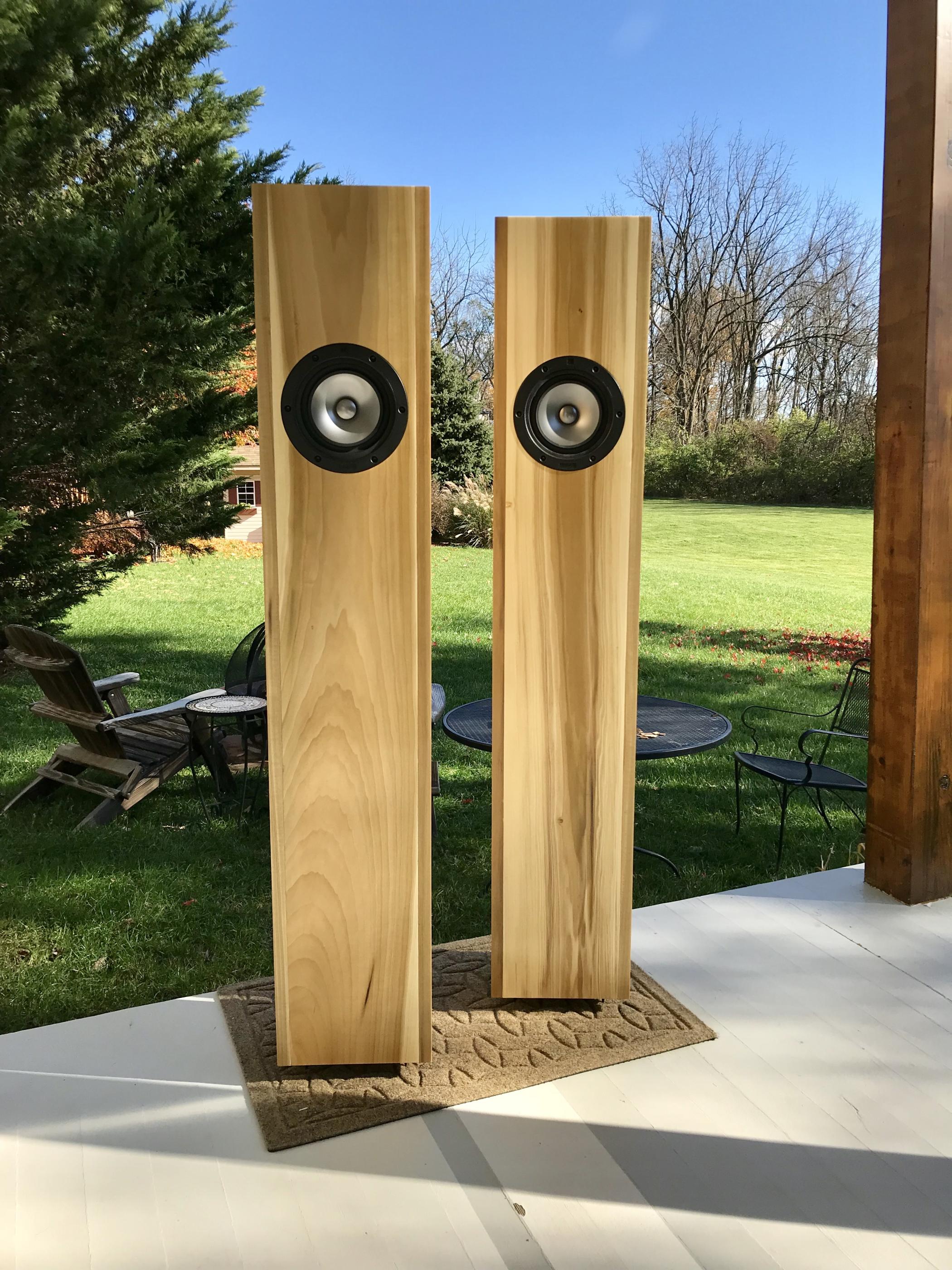

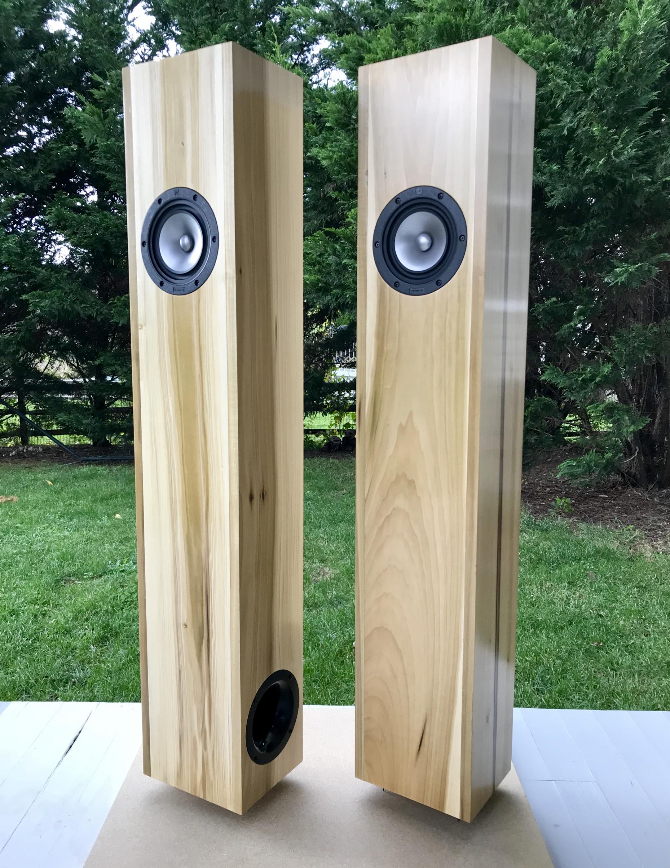

I have just completed a MLTL design for the Mark Audio Alpair 10.3 (metal cone) and 10P (paper cone) driver. This design with the one change mentioned below will work with either cone variant. My model (internal dimensions of 40", width of 6", depth of 7.5"). The driver is centered an internal distance of 8" from the top. The port is centered and located an internal distance of 36" from the top. The port has a 1.25" radius (2.5" diameter) and is 6" long for the 10.3 and 5" for the 10P. A stuffing density of 0.75 lb-ft3 is placed in the top half of the box.
Thus the overall box size (with 0.75" thick material) is 41.5"H x 7.5"W x 9.0"D.

Your speakers look and sound very good per the YouTube video. I'm happy that you are satisfied with the results.

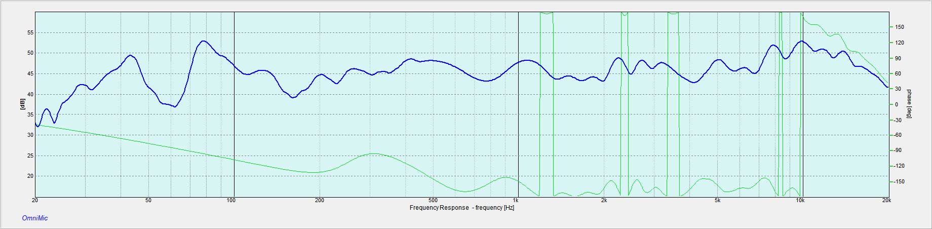

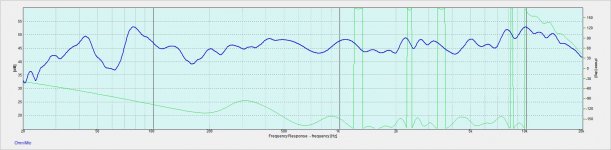

Hi Jim, concerning sound, I'm never happy !
Only my main system is the one I can live with, even there are flaws, it's globally enjoyable. When the content permits, the feeling of being there is amazing. This doesn't usually happen on studio music but on live music, with a minimum of reverberation from the recording room. It is more obvious on video content. The French often do real sound recordings during filming, which allows you to hear the ambient sounds. This is perfect for judging the quality of a system. These Alpairs are excellent but don't achieve the same degree of sensorship of being there. I'm thinking of leaving the high frequencies to a ribbon tweeter. I also need to experiment with an open baffle topology. My first impression with this driver was the good midrange, then I was surprised with the bass quality, specially in this MLTL configuration. The highs are detailed, can sound even better than dome tweeters on symbals, therefor I recommand the little FX-tube01 preamp as it seems to restore some substance, sounding more realistic, at least, to me.
Snapshot is done with the mike on my listening place, facing directly to the drivers, quasi between them, no angle to the boxes. Under the 200Hz, the typical modes of my room, nothing unexpected there.
