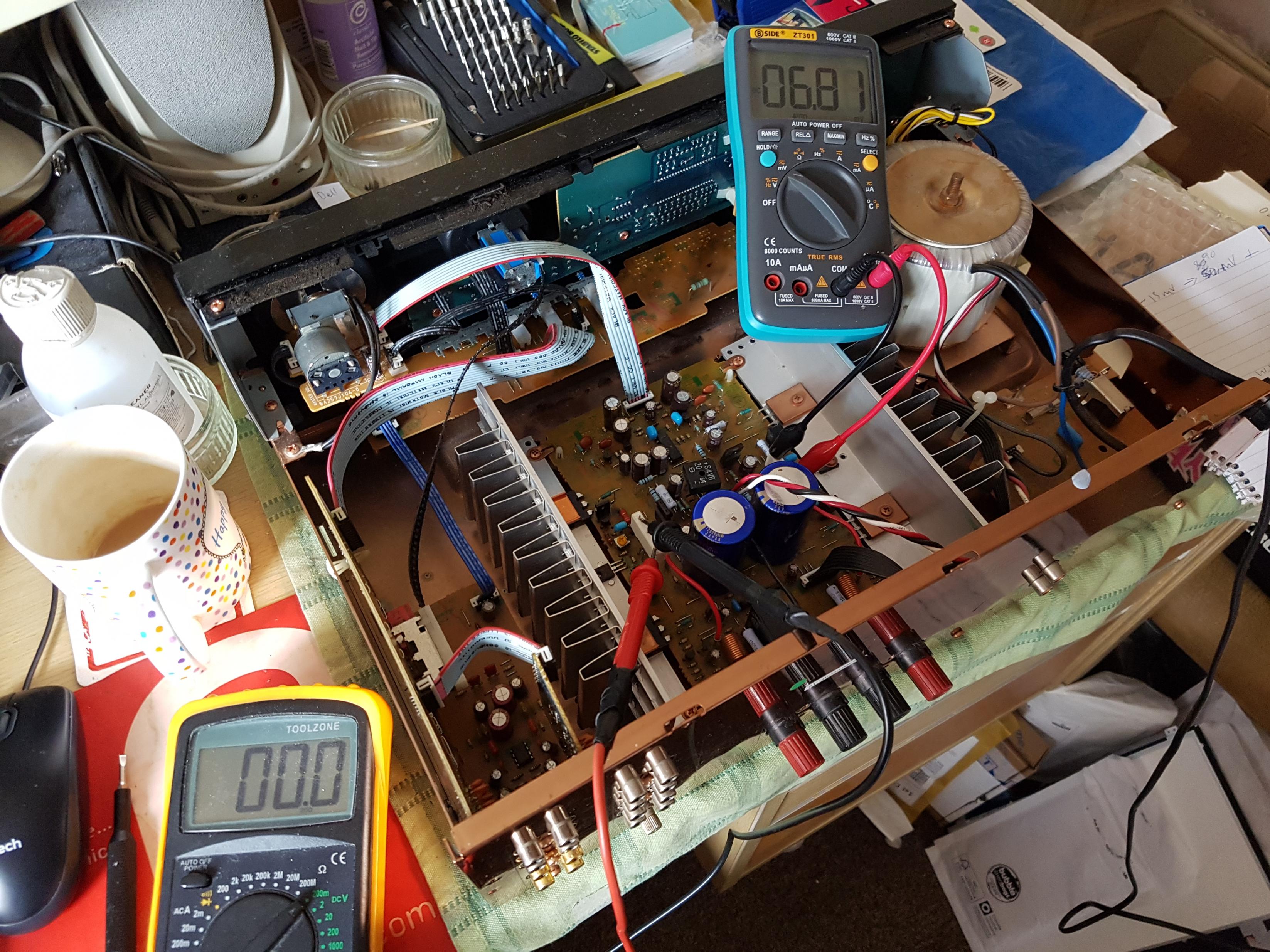

Here are my results:
With the series lamp limiter on:
Left channel
R767 = 6.79mV across the resistor
Right channel
R768 = 0mV & no change when R766 trimmer is adjusted from MAX to MIN resistance.
With the series lamp limiter off:
Left channel
R767 = ~10.97mV across the resistor
Right channel
FYI:
no speakers are connected during the above tests. Its the RIGHT channel that we are working on.
Right channel
Right channel
FYI:
So it looks like your Vbe stage has a fault somewhere.
Maybe Vbe transistor gone short.
Maybe fault in constant current source or VAS.
Start by checking al those components in situ.
So we are back to post #69, that the available bias voltage is possibly marginally low for the modern semiconductor replacements.
Follow post #69 and swap the resistor mentioned. Use the bulb at all times for this.
I have swapped R752 for a 3.9K and here are my results:
R768 = 0 V across the resistor and no change wheen R766 is adjusted from MAX to MIN resistance.
C752 = 4.756 V to 3.731 V (when R766 is adjusted from MAX to Min resistance).
FYI:
I have attached photo showing how i'm testing both R768 and R767.
