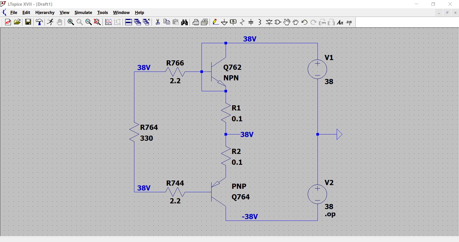

Questions:
Could Q760 be faulty?
Could Q758 be faulty?
Any sources of reliable and good parts?
Continuity (in-circuit):
Q760 b-c - NC
b-e = NC
c-e = NC
Q758 b-c = NC
b-e = NC
c-e = CON
R764 output to Q760 emitter = CON.
R764 input to Q758 emitter = CON.
From underside:
Q764 base to Q760 emitter = CON.
Q764 collector to Q760 collector = CON.

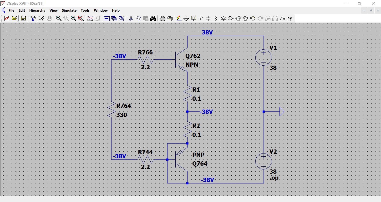

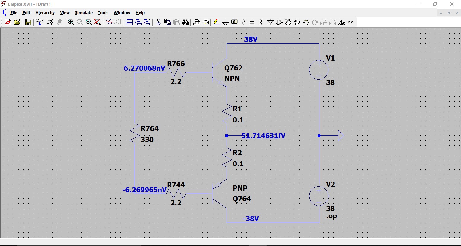

Based on your results:
So with Q758/760 removed and R764 replaced the resistor burns when power is applied. Look at the attached diagram. This shows the configuration and theoretical voltages. The units femto and nano can be taken as no voltage (zero volts).
That means both output transistor must be faulty to burn up R764 and/or you have a physical short somewhere.
If even one output transistor were faulty and the other good then the resistor still would not burn.
Look at the second and third image. These show the upper and then the lower transistor shorted. The voltages change but there is still no current flow in the 330 ohm. The resistor sees the same voltage on each end, so no voltage across it.
So this is the first stage of fixing the amp, getting it to this condition.
I would order parts from the likes of RS, Farnell and CPC but you would be looking at modern replacements, not original type numbers.
MJL21194 and MJL21193 could be suitable output stage devices.
Try CPC, they do free delivery on orders over £8
