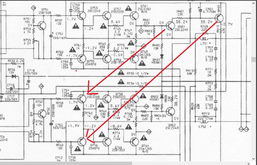

P.s I have replaced the MJL, BD devices, and the burnt resistor so far. Won't power on until the third pair has been replaced.
If you are worried over these transistors then how about using these as a swap and fitting the KSA/KSC's in their place. The parts list shows these to be the same type number.
Are you saying that if I use KSA/KSC transistors for Q754 and Q756, I should also replace QN02 and QN02 with KSA/KSC devices too?
Which of the follow 4 options would be best?
1) Replace Q754 and Q756 with MPSA devices and swap the B and C legs; and NOT change QN01/02.
2) Replace Q754 and Q756 with KSA/KSC devices and NOT change QN01/02.
3) Replace Q754/756 AND QN01/02 with KSA/KSC devices.
4) Replace Q754/756 with some other transistors.

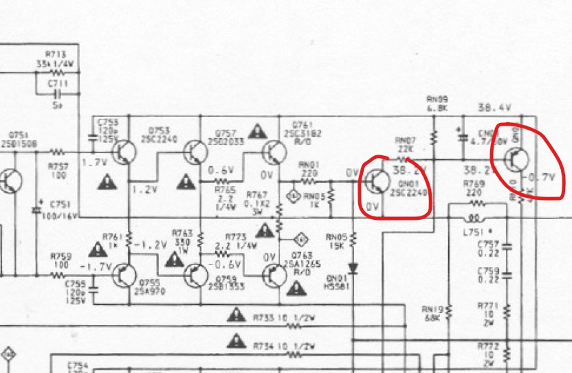

The circuit shows QN01 and QN03 to be the type as Q754 and Q756 and so I'm saying that to remove any doubts on your part over fitment you should do a swap for these devices. Fit QN01 into the Q754 position and QN03 in the Q756 position.
Having done that you can then fit your MPSA devices into the vacant QN01 and QN03 slots taking care to orientate the leads correctly. These two transistors are in the protection circuit and because its all high impedance circuitry nothing bad would happen if you did get these two wrong in some way.

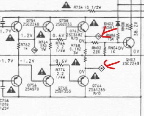

Any swapping of legs necessary if I fit the MPSA devices in QN01/02?
Yes, look back to post #38. You have to bend the collector and emitter leads to suit.

Hi
Crappy Q754 & Q756 removed and replaced with transistors from QN01 and QN03.
AND
Vacant QN01 and QN03 replaced with MPSA devices.
Also I replaced C752 (with good good brand cap. from RS) as it had a slight bulge.

I have checked all replacement components are in the correct positions.
Results of checking:
Q754 - 2SC2240
Q756 = 2SA970
Q758 = BD139
Q760 = BD140
Q762 = MJL21194
Q764 = MJL21193
QN01 = MPSA42
QN03 = MPSA92
